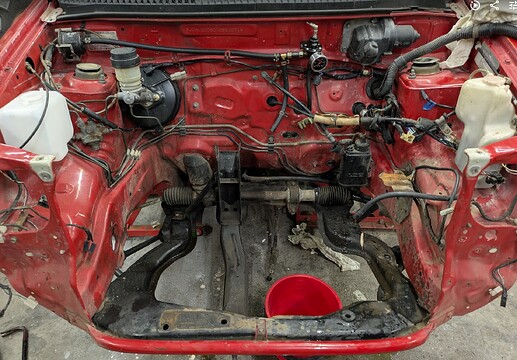

Been a while, had a few side projects take up time over the last couple months but the diesel is now back in the workshop.

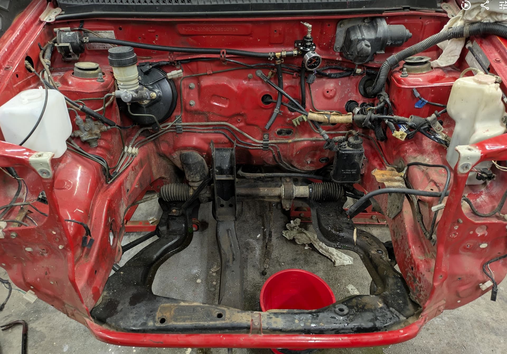

EJ gone:

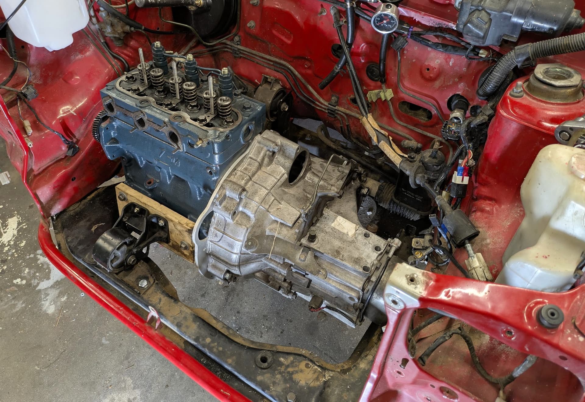

D950 test fit:
Clearances look really good, will hopefully be able to get the gearbox in the same location so I don’t need new driveshafts again. I only recently did the shafts to suit the 4x100 conversion. Engine is much shorter than the EJ as it is pushrod. I will also lean the engine back as far as I can. Over the last few months I have collect 4x of these 70mm stroke kubotas. I have D950, D850 and 2x D750 so I am ready to kill a few engines finding the limit.

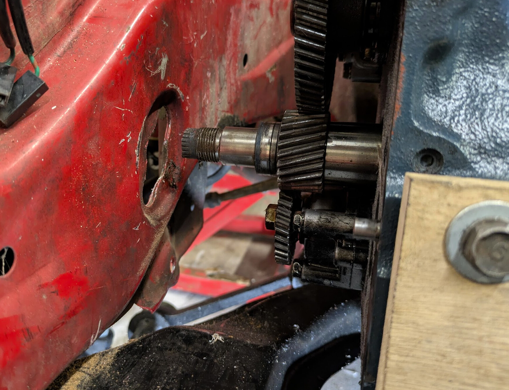

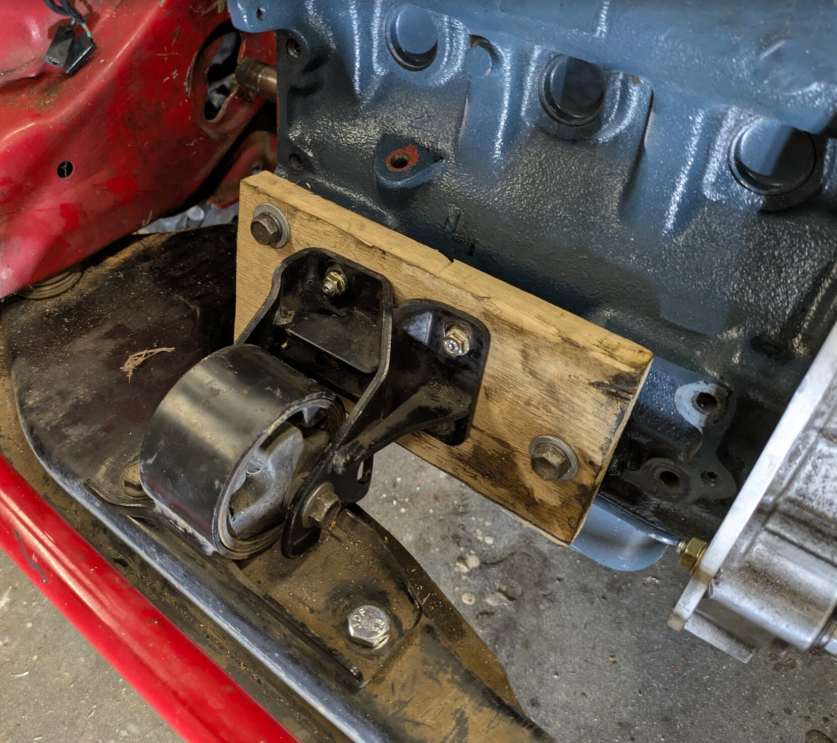

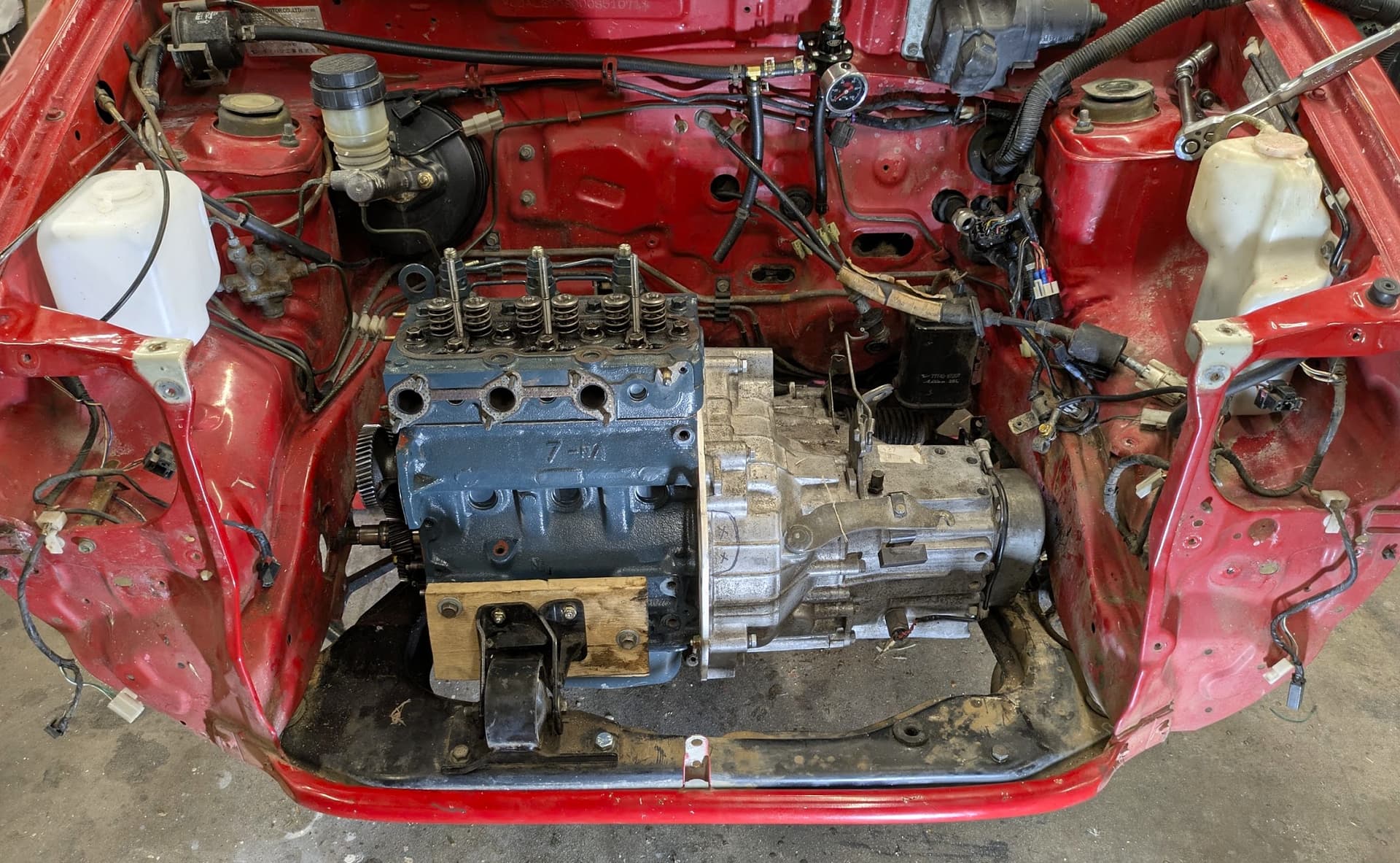

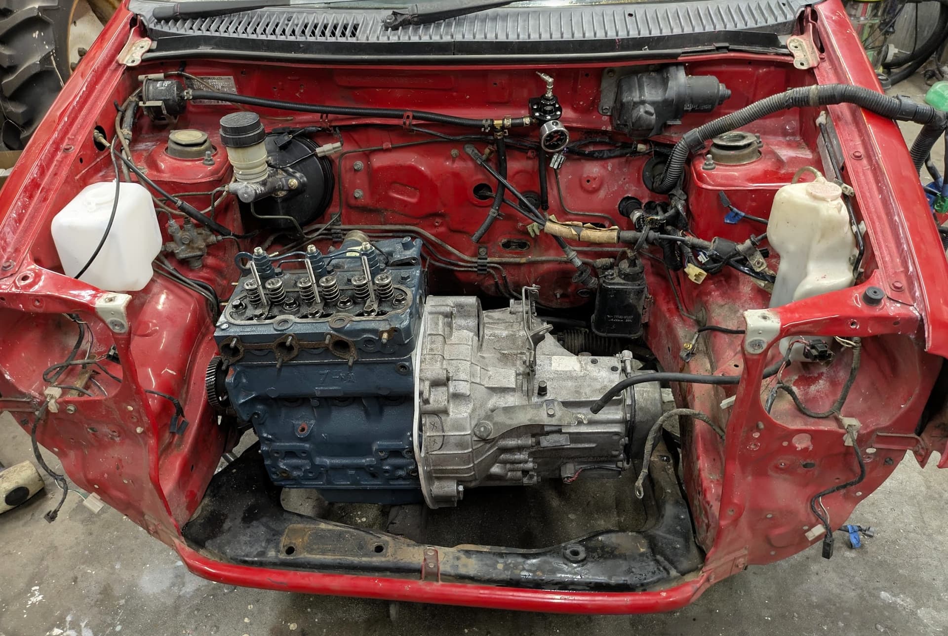

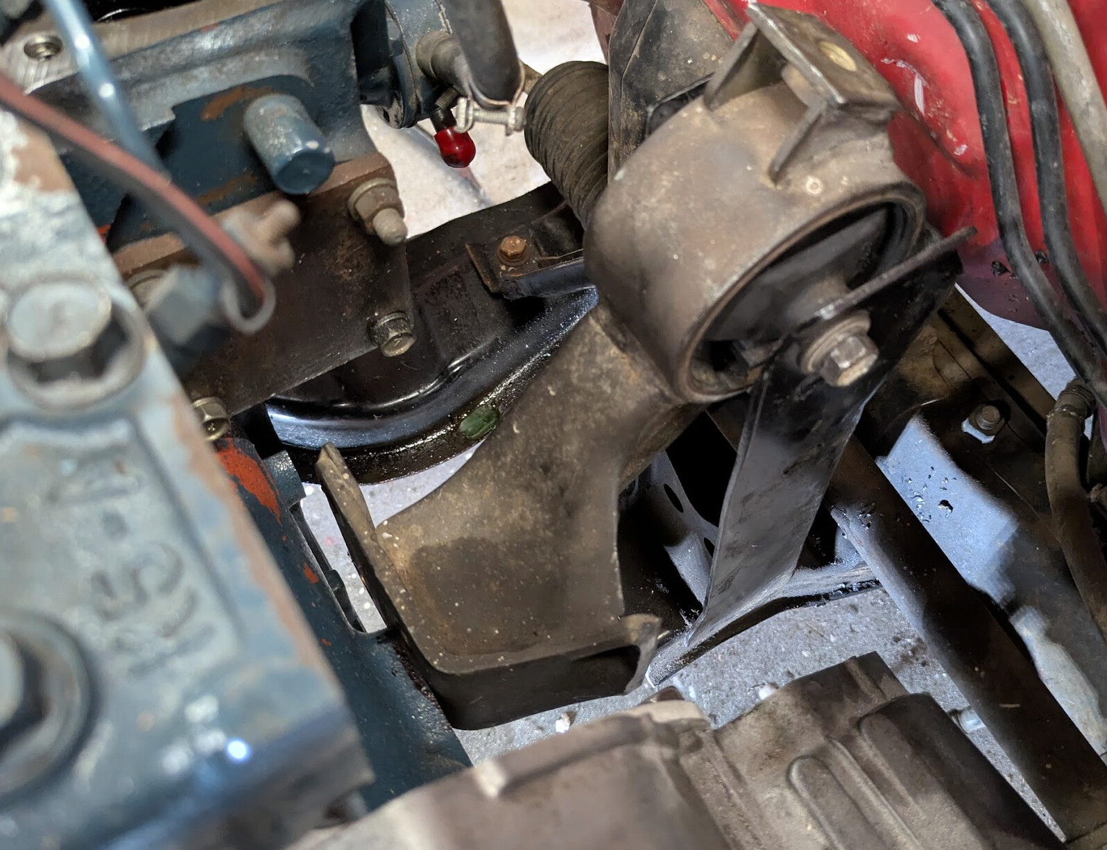

Righto engine mount prototypes are done. Will use/modify these to suit. Was able to use the EF engine mounts all round, hacked the EF gearbox mount a bit to suit the L251 box. The front mount just needs a 15mm spacer, will use 2 layers of 8mm steel laser cut with the appropriate holes. Rear mount will need a plate added to engine side as well, which I will weld all around the EF mount. Engine sits really nice, good clearance all round.
I am going to need new driveshafts as where I want the engine is across to the passenger side, and also the L251 diff must be offset a fair bit compared to the EF diff. These things combined make up for about 40mm of driveshaft mods, shorter on passenger side … longer on drivers. Lucky I have a set of sirion shafts which are both longer than I need so I can cut/weld them to the right length.

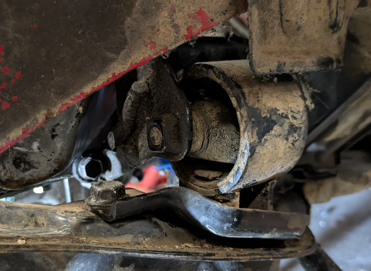

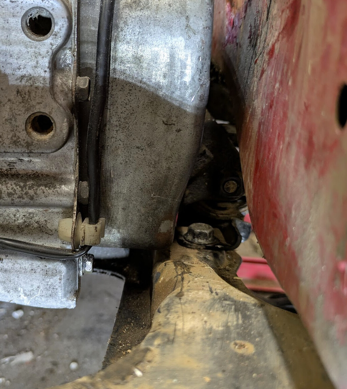

Will need to remake the longitudinal reinforcement that runs under the engine as it interferes with the sump, I will do this last once I know where my exhaust and shift linkages go. Have also ordered new mounts for front and gearbox as they are cooked, pretty much collapsed.
Pics:

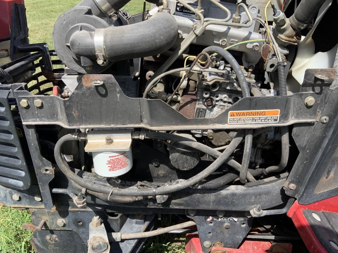

You could save plenty of weight, through opting for a 15 mm thick aluminium plate which would be much easier to trim, not requiring laser cutting. Wasn’t your oil filter located right where that plate would’ve gotten in its way?

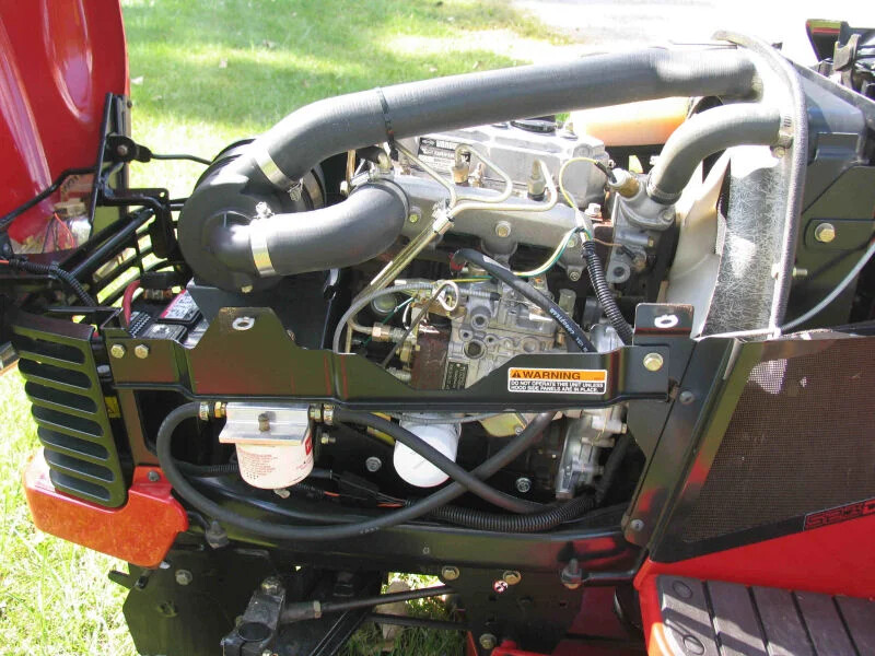

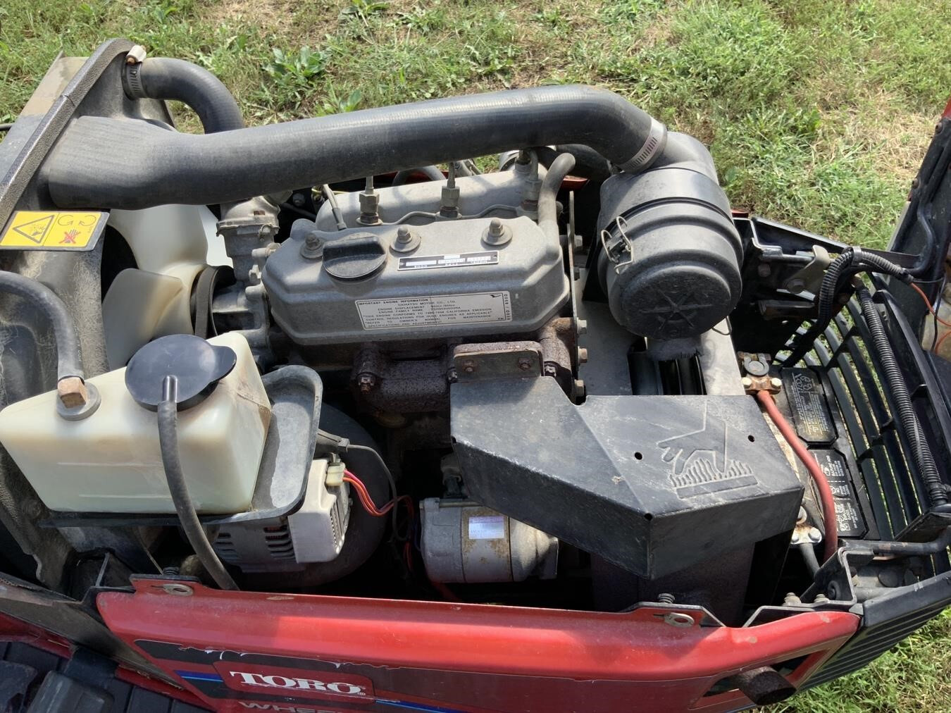

While searching for a replacement ED-20 camshaft, I stumbled on a Daihatsu Diesel similar to your Kubota. here, a 950 cc Toro 5xi 523 dxi garden tractor engine:
Here’s one in some sort of vehicle:
This one’s already turbocharged:
