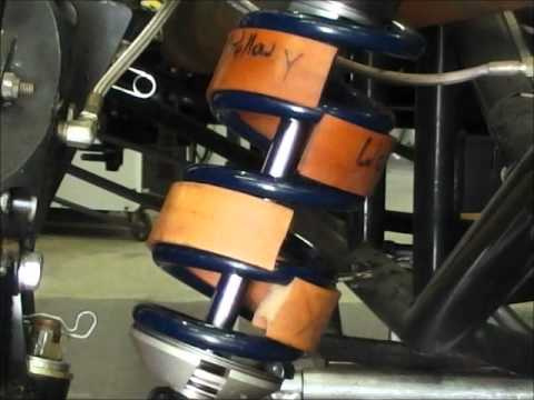

For testing spring rate you can aim to get the same effect as in this image.
By making some hard wood chocks that go through the spring/coils. Secure firmly. I’ve used jumbo zip times through holes I drill. Take great care and on a liability note I would not suggest testing on public roads. Leave the fronts std and untouched and chock the rear. Test, a short drive will reveal much. This is not a permanent solution. There are online spring calcs that will help you figure out the rate of the spring without the chock and then just redo the calc subtracting the number of coils you think were blocked out. I’d say you prob started with a 200lb spring as std and 400lb - 500lb will work best. I’ve used https://www.dfaulknersprings.com/ in England for custom springs and Kings in Australia. I’ve not played with L700 springs but I have done so with M100 3cyl front springs which from a casual glance seem about the same and were about 140-150lb per inch. Cost wise you may, as you are aware, need to find springs from something else with the same diameter and end types.

I found a set of 6 spring blocks for 15,- euro. So i won’t bother making them myself.
Tomorrow i’ll contact my parts supplier to see if they can get them for a similar price.
Cause i’m pretty sure they’re a bit quicker with delivery.
I’ll keep you guys posted.
Picked up 2 sets of spring rubbers. My parts supplier had them on hand and were even a little cheaper.
Put 2 blocks per side for now. Didn’t get to drive much with it today, but it does seem to help a bit.
