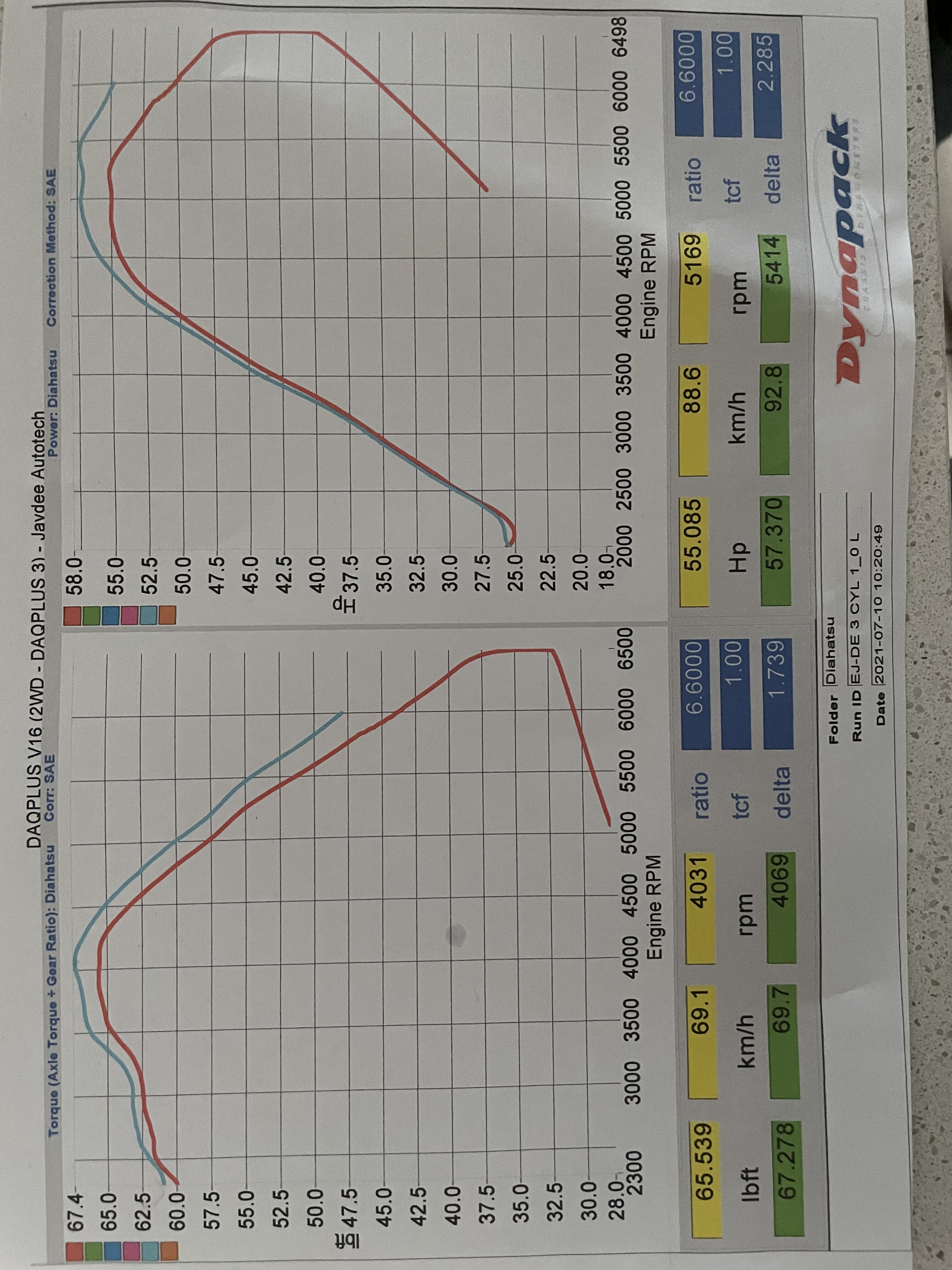

So finally after many of my $$$ spent and many hours of hard work thanks to my father, plus a tune from a bit of a legend… I finally have an ej swapped l500 Mira tearing down the highway with no issue at all. Driving to the sound of the engine I hit the freeway at around 130kph and I was a little shocked, I wasn’t trying to go that hard. Then she just cruised at 110km albeit revving quite high.
It time to stop fussing with anything major and just enjoy it. Since I’m only going in to work a few days a week and there are no highways in between I’ll probably daily it to work for a bit of fun. In the meantime, to complete what I want to call stage 2 and stop spending or working on it, I’ve got the following wish list based on budget and somethings that it really needs before it can be fully enjoyed.

Haven’t plugged my computer in yet to look at all of the tuning things. I might do some data logs during the week and I’ll definitely post some of the final settings that ended up in the haltech
