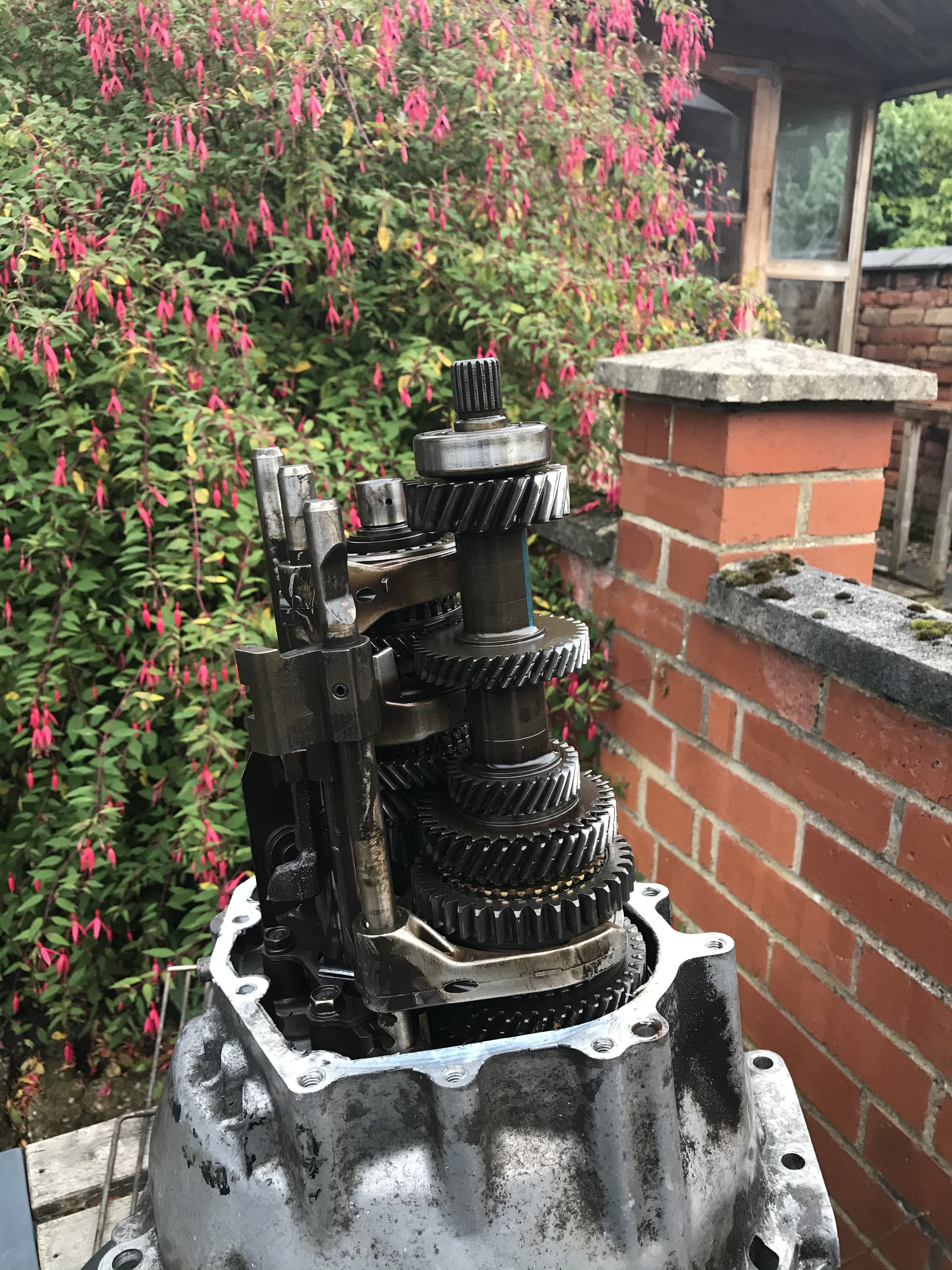

My stock Terios gearbox has had a lot of abuse, and unfortunately recently it broke. It was difficult to get into 1st and second gears, and the shift fork for these gears broke. I managed to find a new genuine replacement gearbox to put in. With the old gearbox out, I will take it apart to see how the components look and the potential improvements that can be made.
Been quite some time. But it’s been 4 months since I’ve boosted my Terios. The replacement gearbox is holding up very well. Also I took my old gearbox apart that broke and it was the easiest fix ever. A pin that goes though the aluminium shift fork and the steel shaft for 1st and 2nd gear has worked its way loose and therefore I was locked out of gears.
The gearbox is very compact by the gears are surprisingly solid, with the exception of 3rd gear that looks quite small comers to others.
Currently my Terios is on 20psi of boost in a 16G TD05R and the engine, gearbox and diffs are holding up very well. I am using redline MT90 oil in the gearbox which helps, but it’s very expensive. The clutch however is not holding up. But I will have something sorted out for it.

The gearbox held up well for roughly 6 weeks of abuse including a drag racing and lots of pulls in the street. But 3rd gear finally gave up and disintegrated. But it is the smallest gear compared to the others, so was kinda expected to happen. Gear 1 however holds up perfectly with ~12 psi 2 Launches.
So, the Terios gearbox is not as weak as others are claiming. It will last forever with the stock k3vet swaps and probably up to 200 up at the crank. Not sure how much power I am making, but will find out in the next few months.
