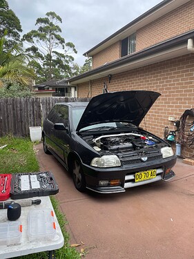

Hi all, thought I’d get a thread started on my 1994 Charade DeTomaso that I picked up in December 2024.
When I bought the car it needed a bump to start and it does have some rust (planning to get it rust repaired and re-painted).
Started off taking out the spark plugs and leads, unfortunately on the way out one of the leads broke and I had to find replacements. Replaced the leads and plugs with Eagle ignition leads E54461 and NGK spark plugs.
I have also refreshed the front-end of the car, taking out the lower control arms, giving them a good wire brush and fresh paint. I have also re-painted the brake calipers a nice red and put some new brake rotors and pads.
As for getting the car starting, I have changed the oil and oil filter, and super happy to say that the car starts with the turn of a key without any hiccups. It turned out to be part of the security system that is installed in the car which was preventing it from starting.
For now, next up for the car is changing the left engine mount as I found it to be pretty rusty after removing the battery tray (which was broken). Also sorting out what to do with the rear brakes as replacements don’t seem to exist. Hoping to get the car blue slipped and rego’d this year!
Thanks for reading! Any questions, advice, etc is appreciated!

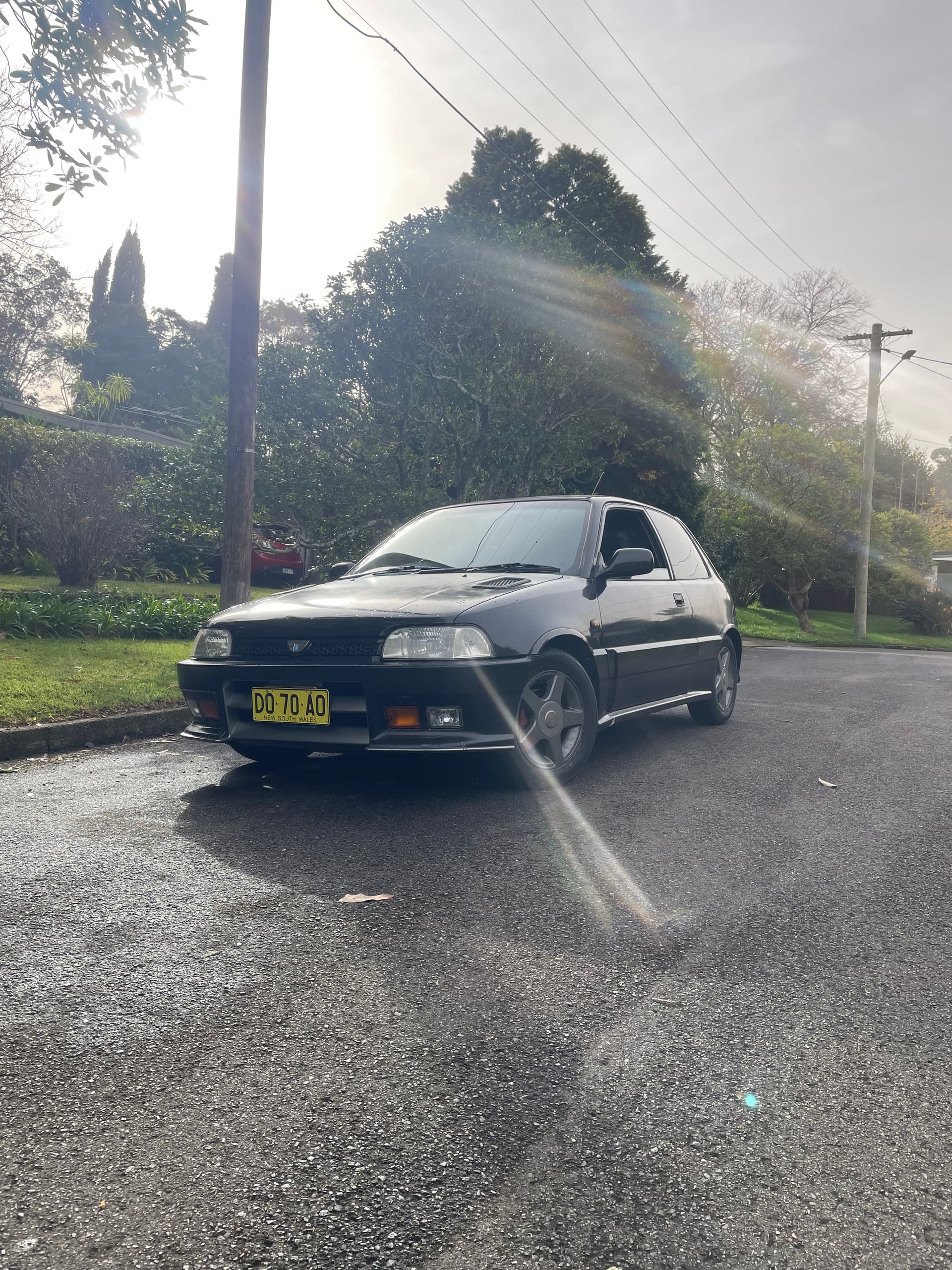

Big update here, finally the DeTomaso is registered in NSW. It’s pretty crazy to think it hasn’t had registration in about 10 years up until now, I’m super happy to have brought this car back to life and put back on the road again.
Thank you to all who answered my posts on the various FaceBook groups and sorted out parts for me.
No plans other than to drive this car and enjoy it!

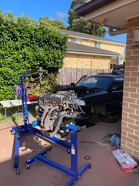

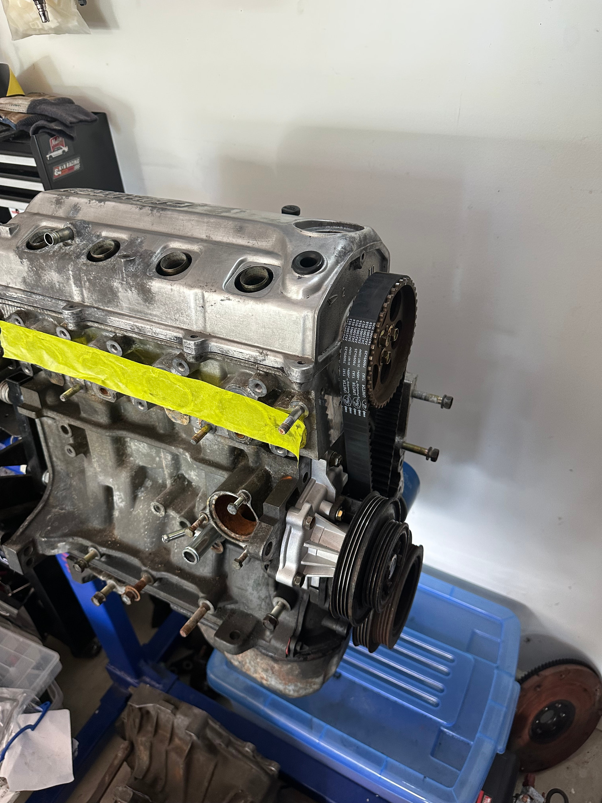

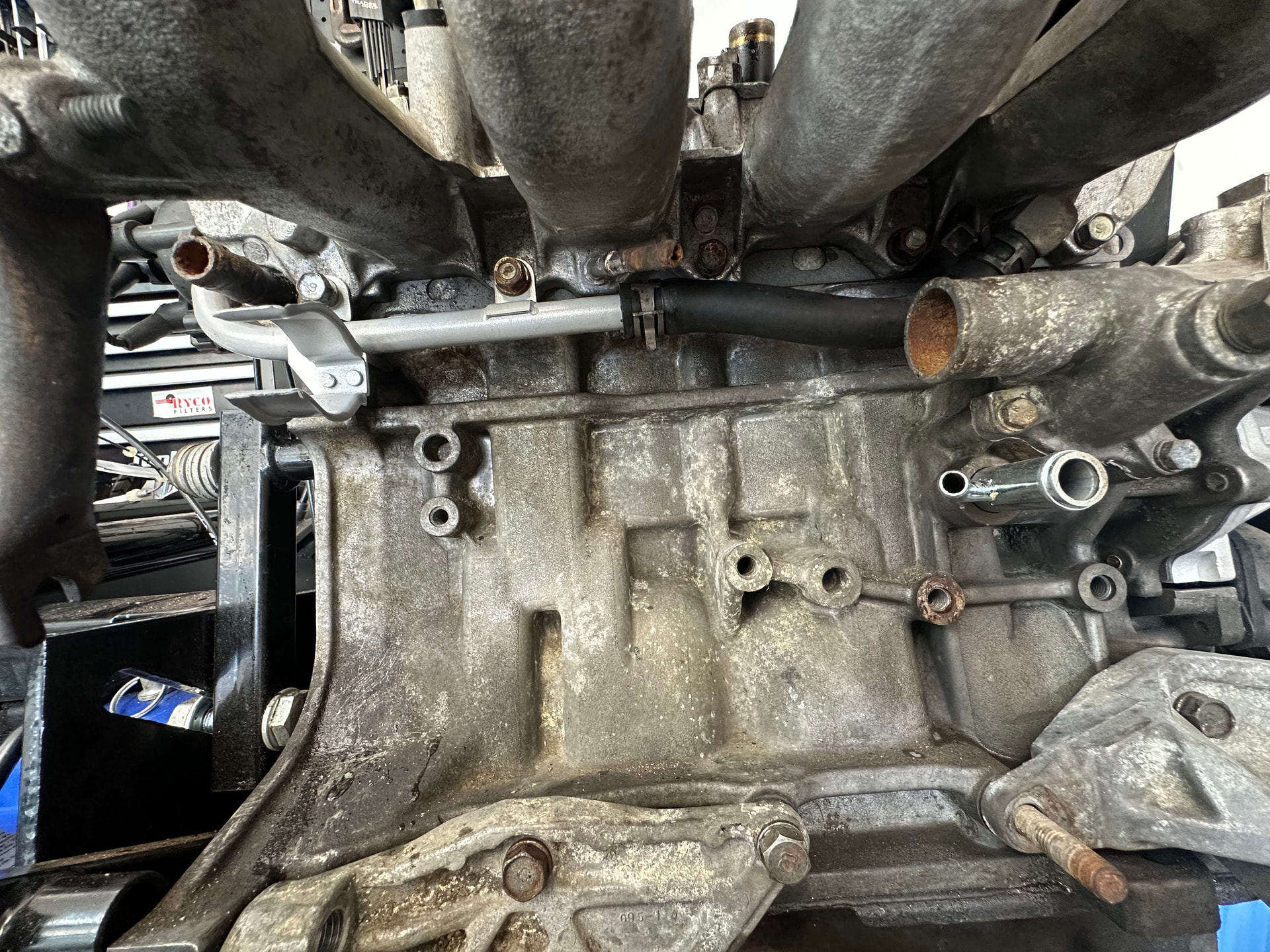

So, the motor has been pulled and I’m working my way pulling it apart.

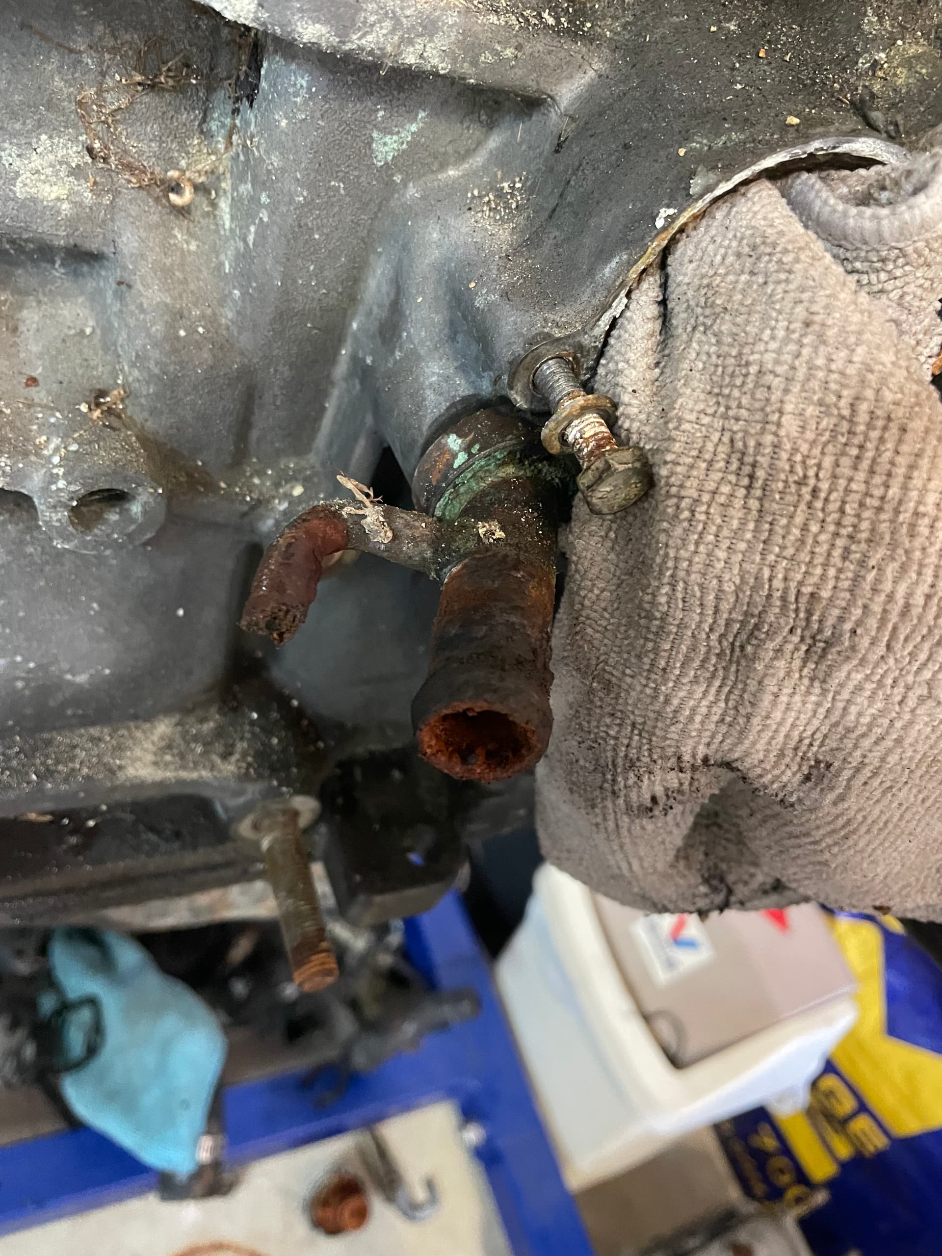

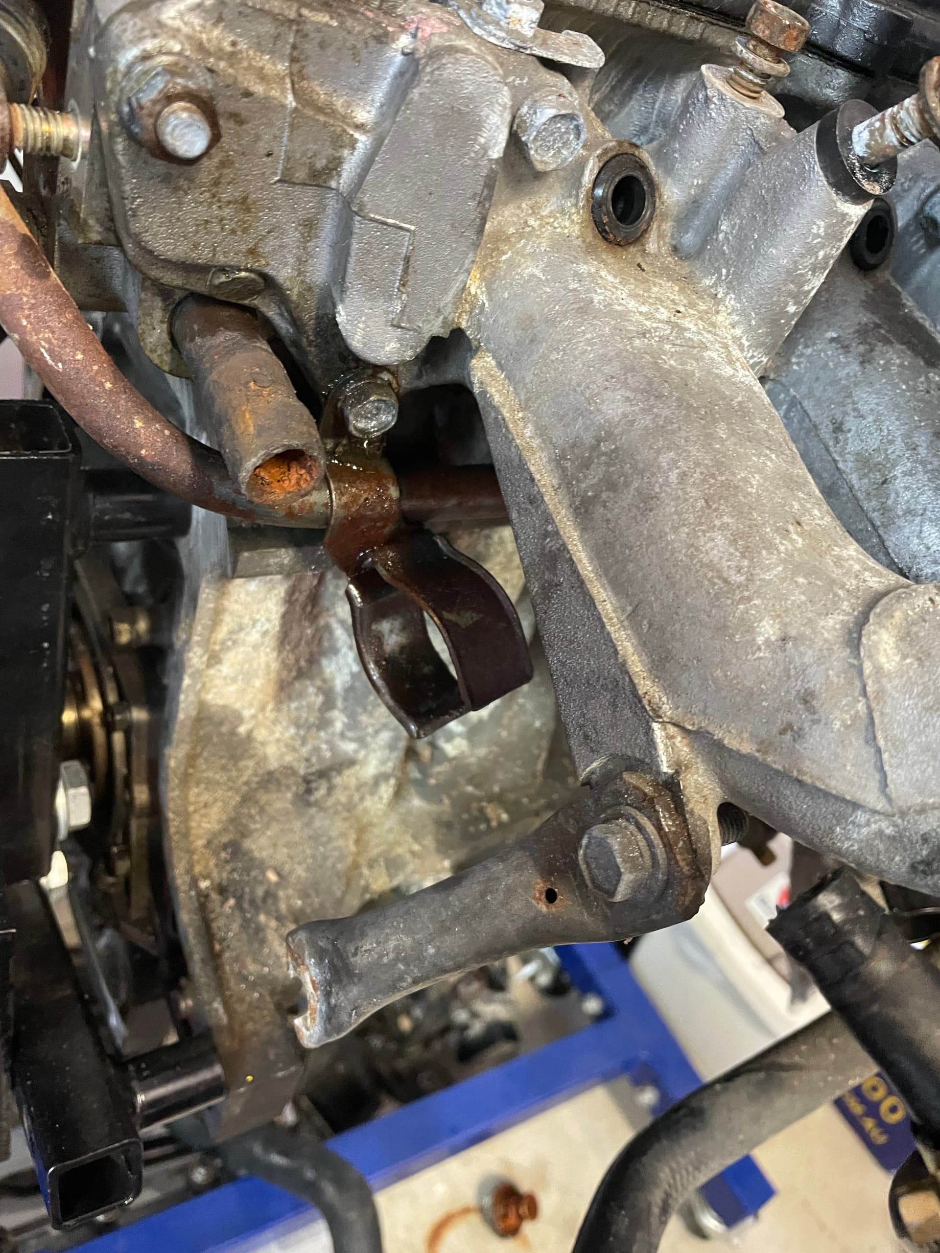

A couple of concerning rusty hoses on the block
“The next guy here can deal with this”

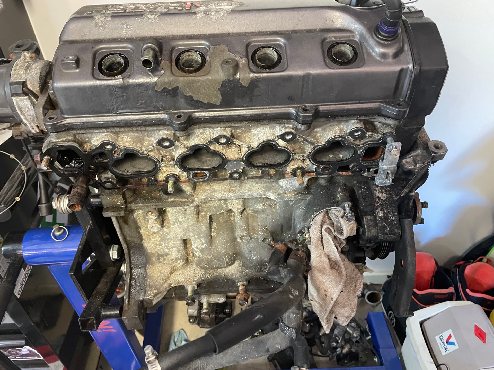

Intake manifold is off.

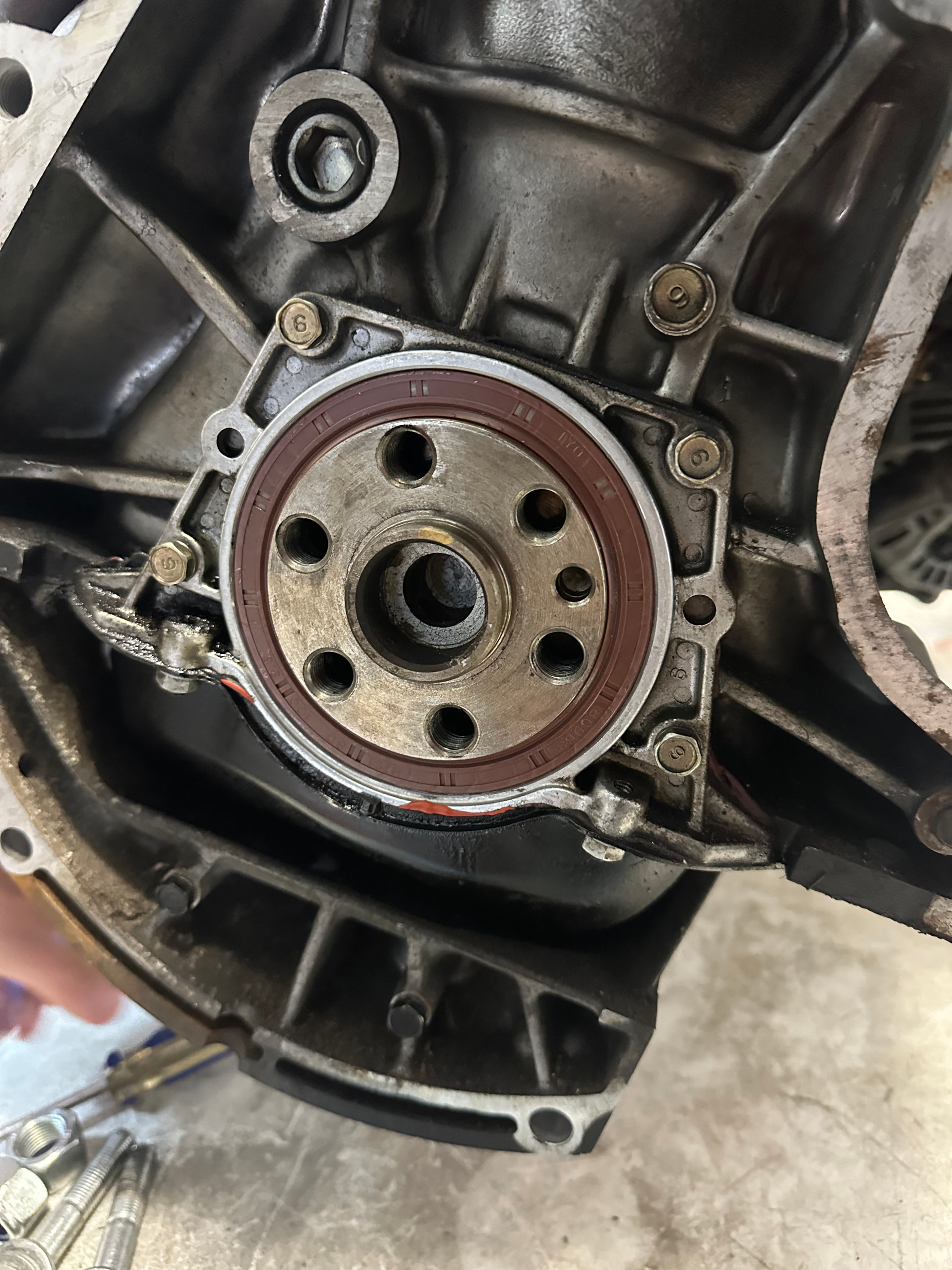

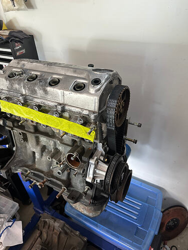

Lots of new stuff and a lot of cleaning went into this,
  • All new engine mounts
  • New clutch, rear main seal and machined fly wheel
  • New water pump and timing belt

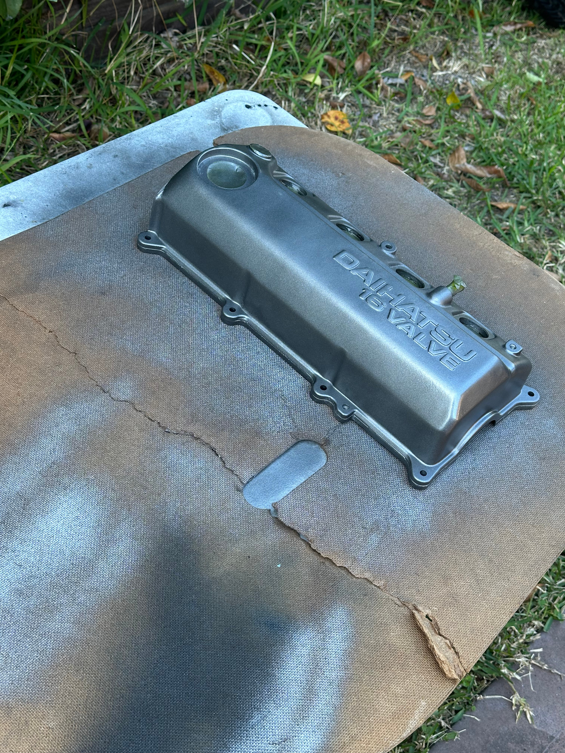

  • Painted and new valve cover gasket

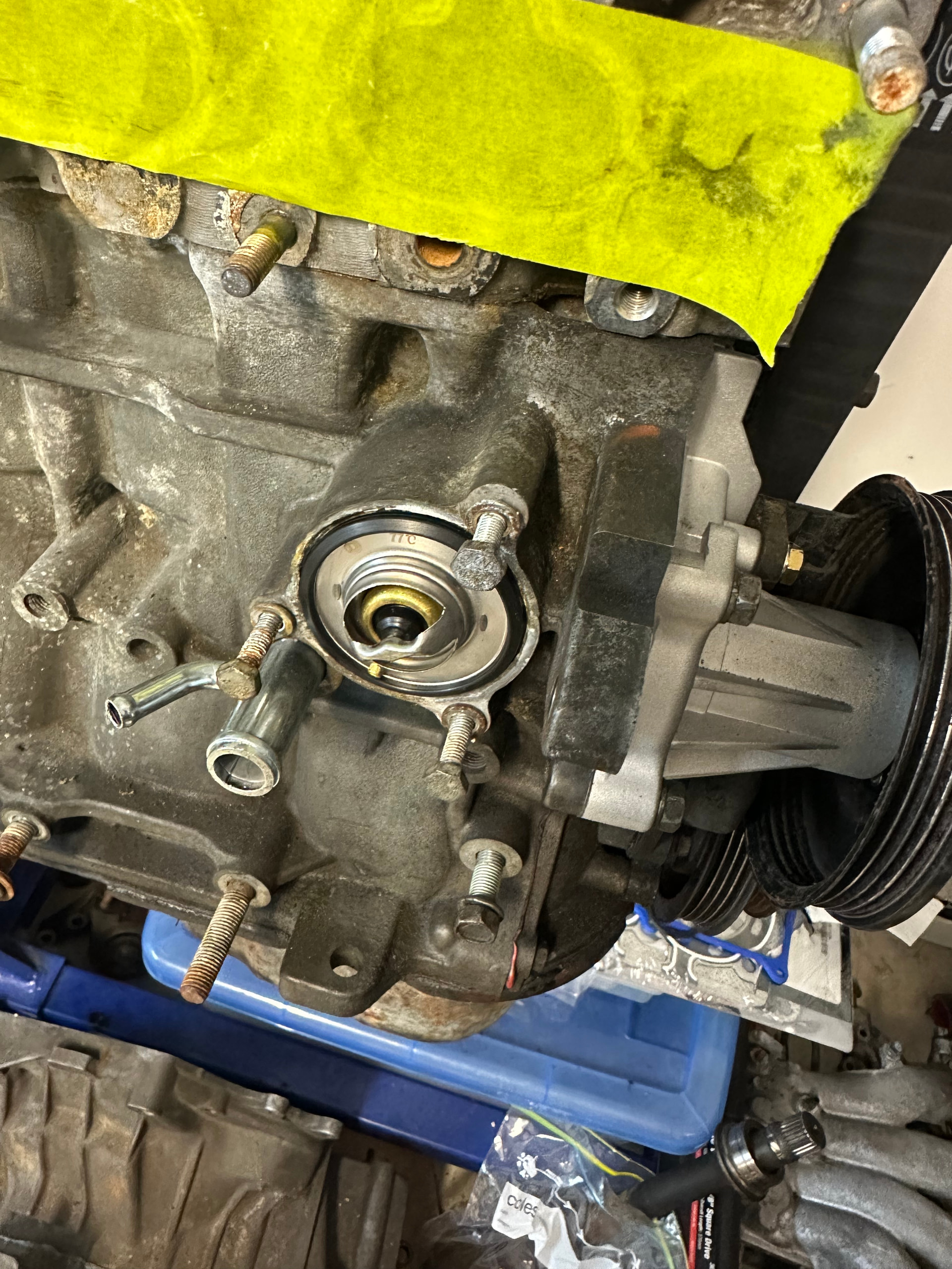

  • Coolant fitting and hardline
  • New thermostat
