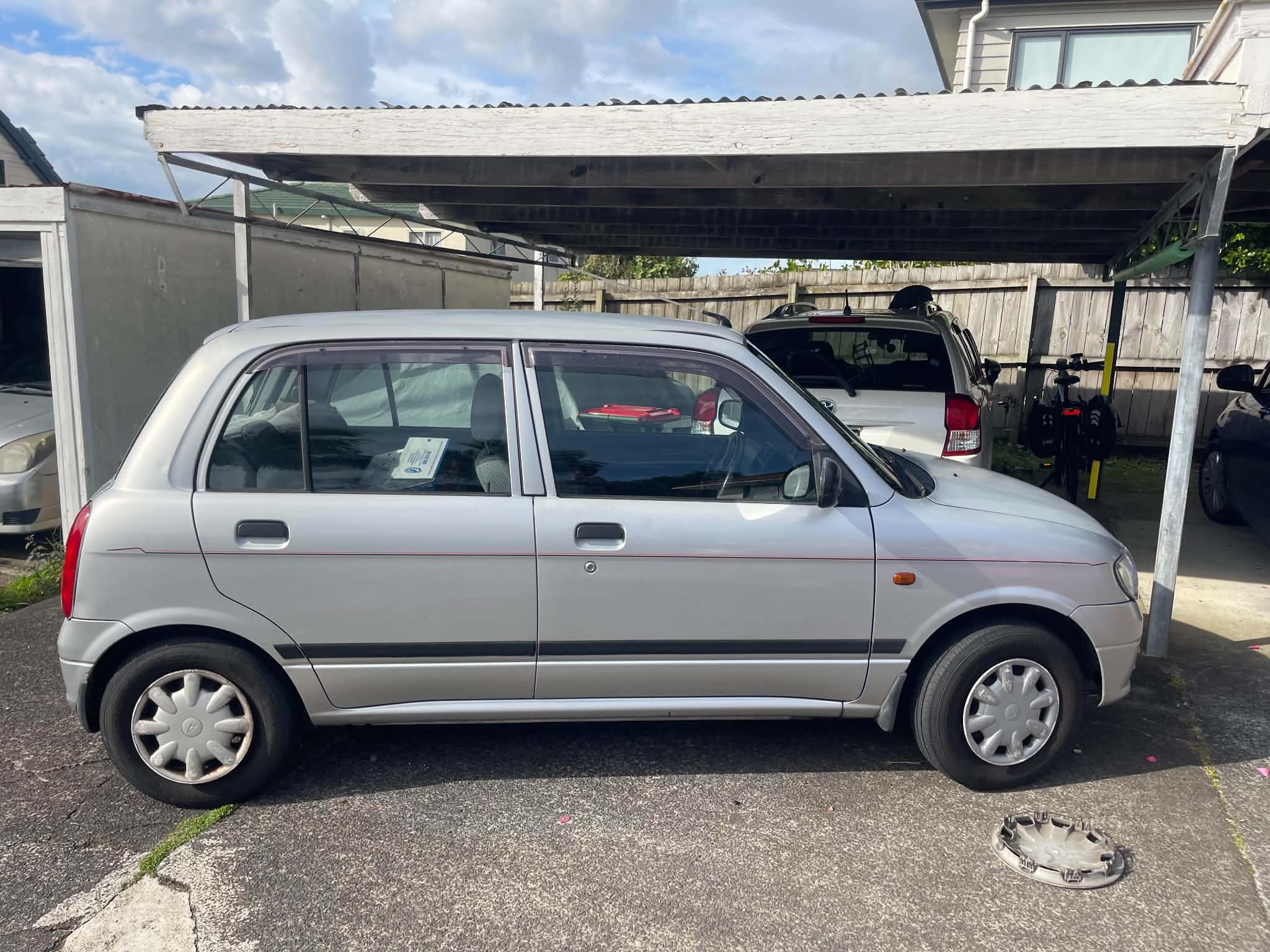

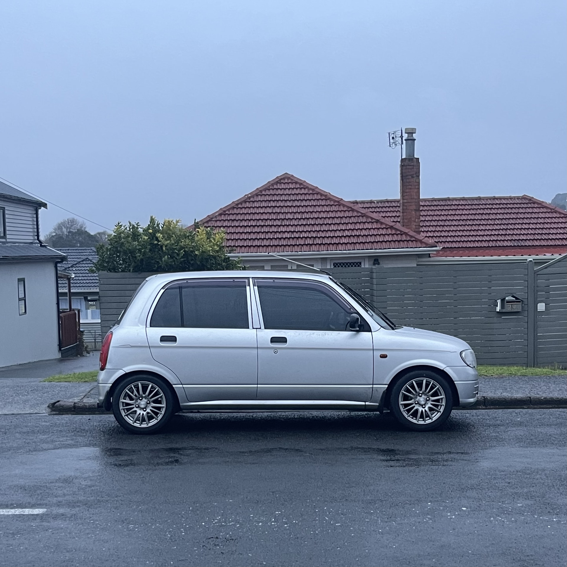

Started with a pretty standard 1.0L EJ-DE and slowly been doing bits to it. Fitted lowering springs which dropped it around 45mm, and changed the wheels to 14s with 165/55 tyres.
35% ceramic tints all round, deleted the black trim on the doors.

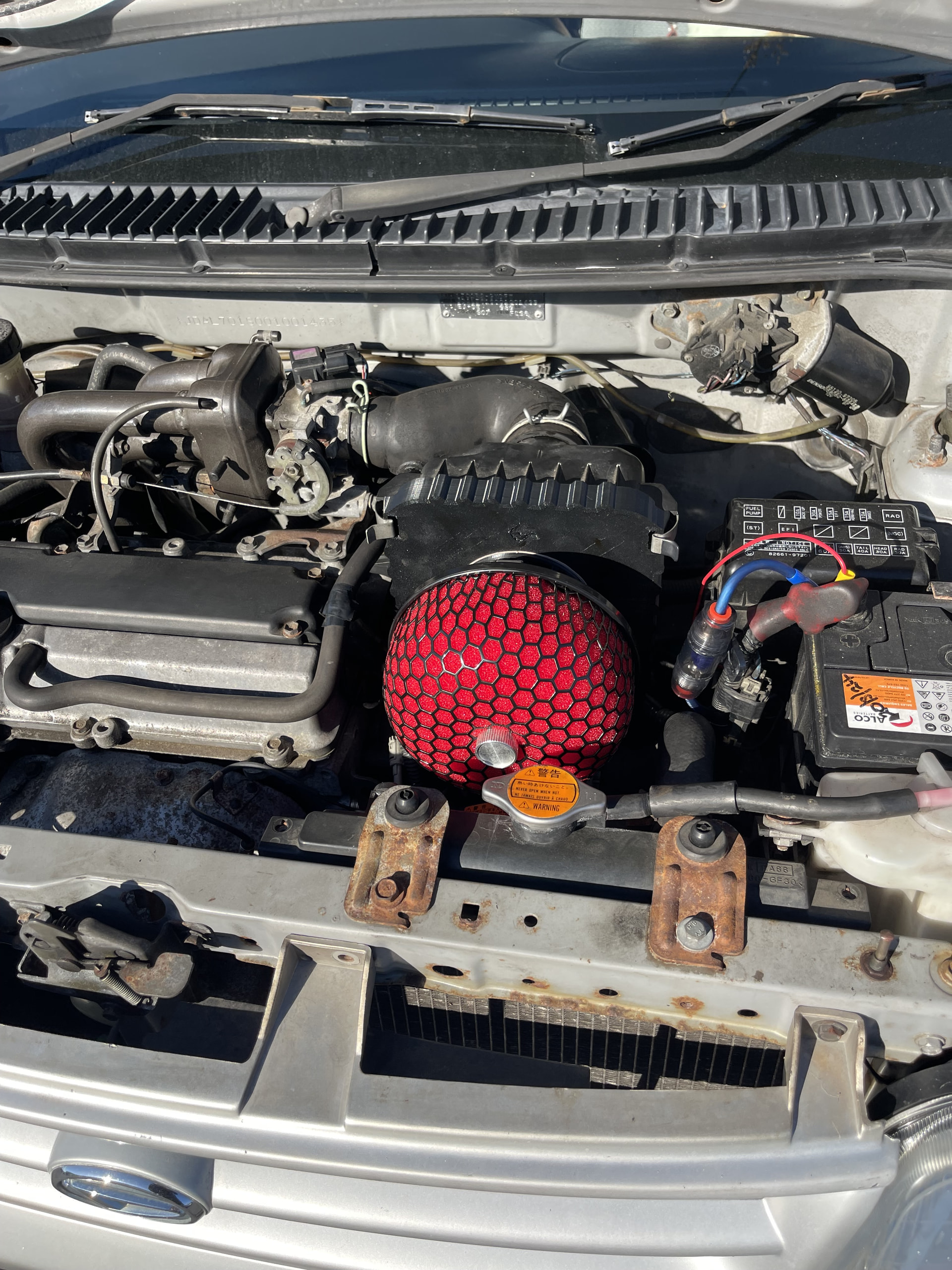

Fitted a pod filter which gives it a much nicer intake sound too.

I have a pod filter on mine also but I have about 130cm of intake piping before it. It does a U-turn goes across the top of the engine and down to Infront of the engine behind the front bar and I have a heat shield behind it to stop heat from the engine etc. It doesn’t do much but it slightly shifts the torque to more mid range rather than as low as what an ejde is.

This is how I have my pod setup, 3D printed adapter, I should really run some pipe like yours
thats better than some I have seen.
