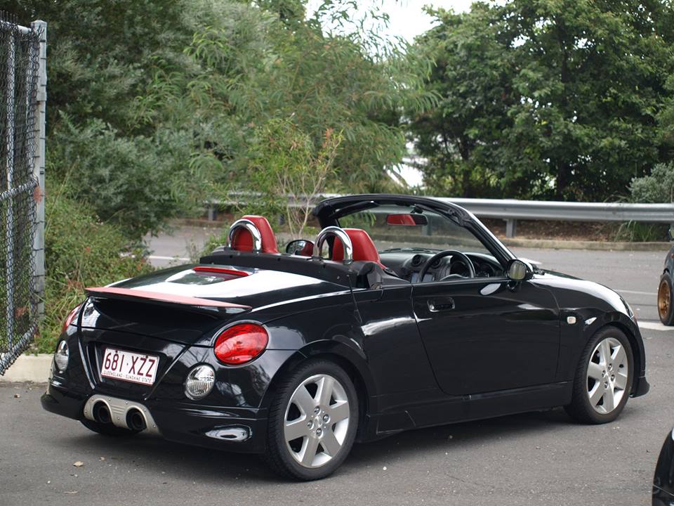

My daily in a Copen. I have owned it now for about 2 months give or take. It is a head turner thats for sure. James and I have at least a few comments a week when out and about.

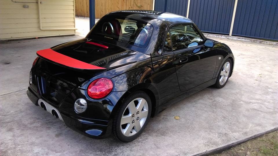

I brought my Copen with the body kit, which makes the body look so much better. Being black, it does need a regular wash, it just shows up everything.

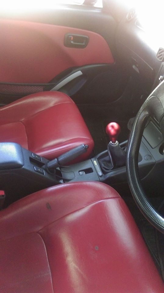

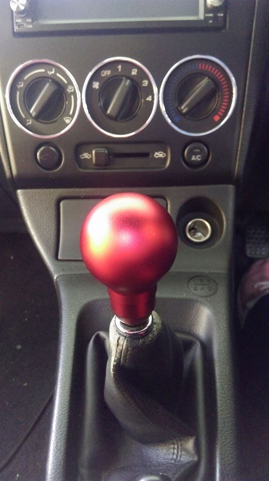

Gearknob looks the goods, are you leaving the exhaust pipe plastic cover silver?
Good question and one I hadnt thought much of till now, how cool would that look in red???

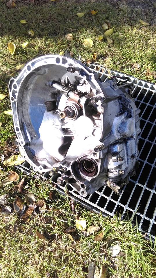

For now, I started by taking off the gear box and gave it a good clean, and I took off the intake manifold.

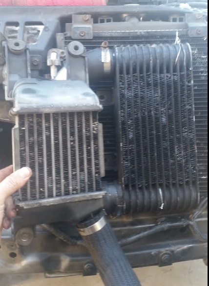

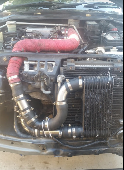

With this in mind it was slightly overdue for a oil and oil filter so I decided to do that and ended up putting in a slightly larger intercooler using one I previously have used. I have a bigger one than the one pictured below which was the one I want to put in but it was slightly too big. As for piping I just made do with what I had at home. Sure it dont look real pretty but the idea was to try and get cooler air coming in as heat soak is terrible with the copen. After a 20-30 min drive ( After warming the car to temp) It did feel slightly cooler than what it normally does but in future I would like to get a better suited intercooler and route from IC ti TB completely different as going across the top of the engine is just counter productive in the first place. I do reall think ots a bad design floor with the copen engine bay.
Here is a pic of the new current set up and the size difference between the intercooler’s. Keep in mind however that the copen intercooler is slightly thicker also.
