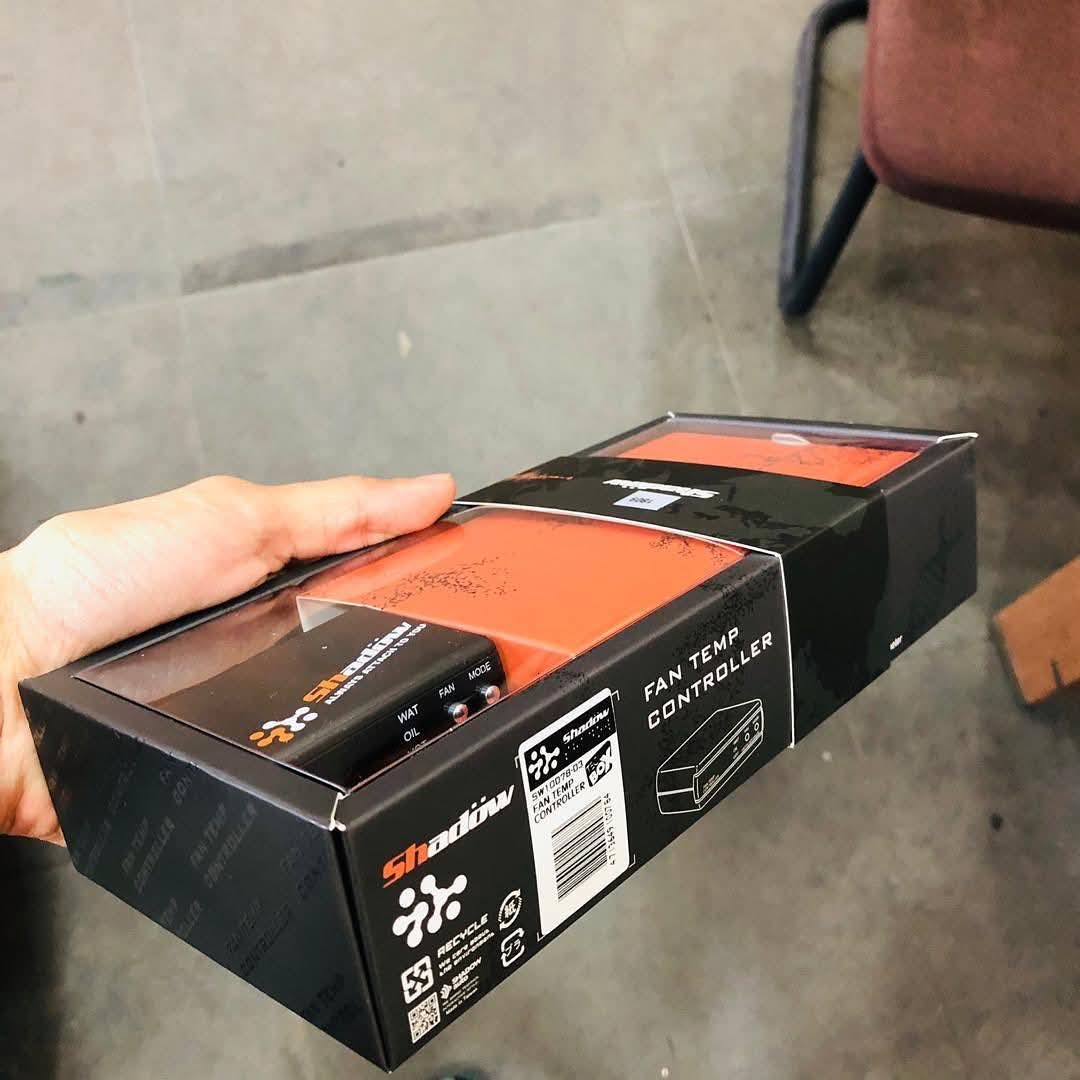

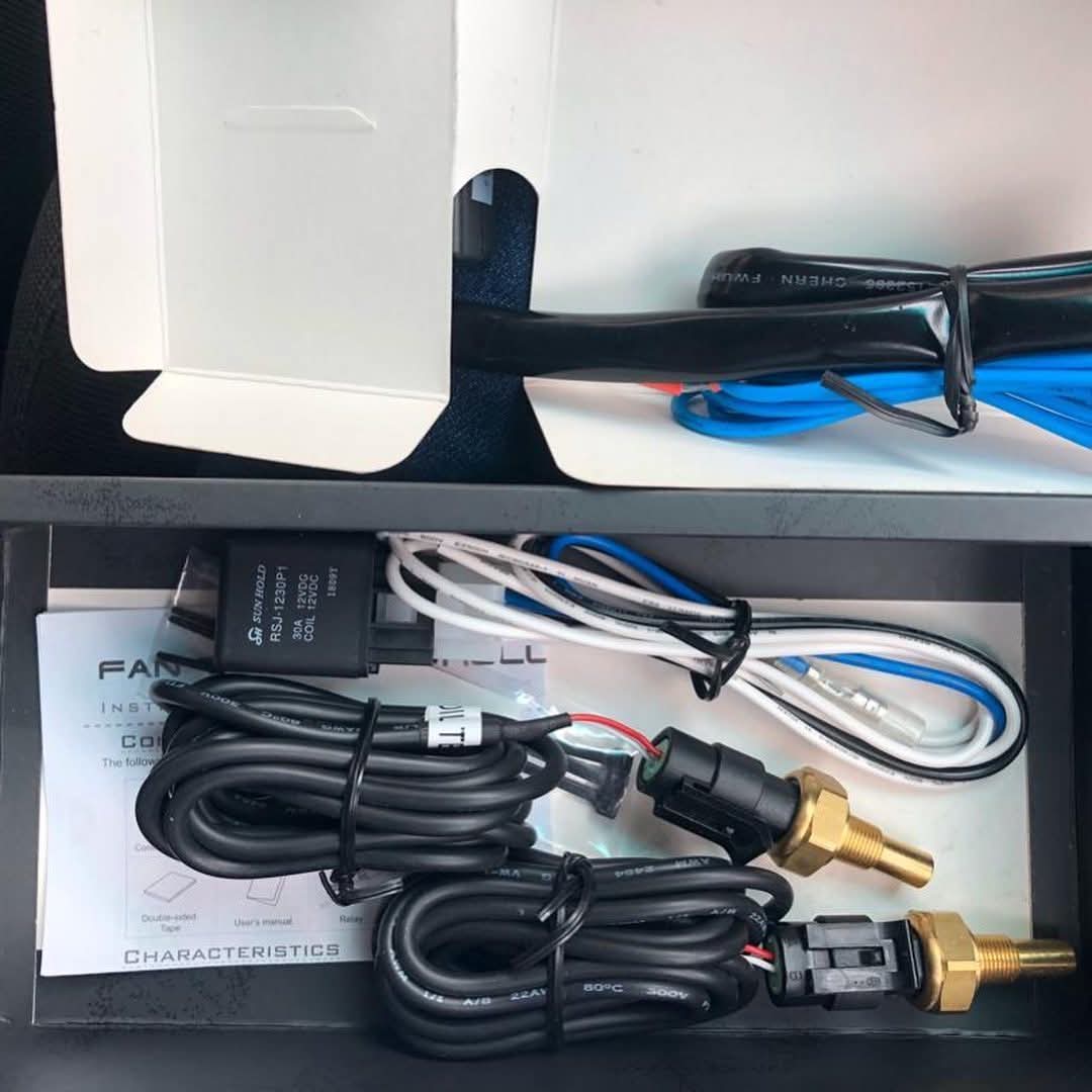

Hi, this is the popular option in Malaysian Myvi, adding radiator fan controller unit.
