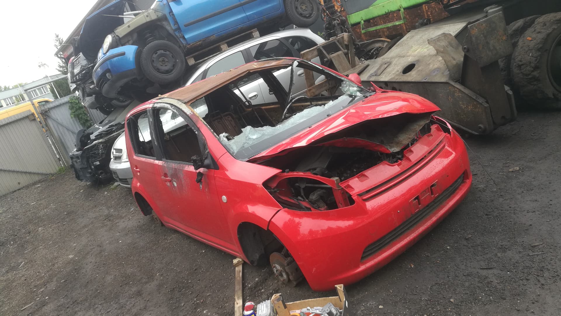

Found burnt M300 at scrapyard, good thing that some of them post auctions or info when they have something interesting or uncommon.
Looks like I was a while before sending this to foundry, because it was moved far back of the yard where giant jaws puting dead bodies at back of the trailer….

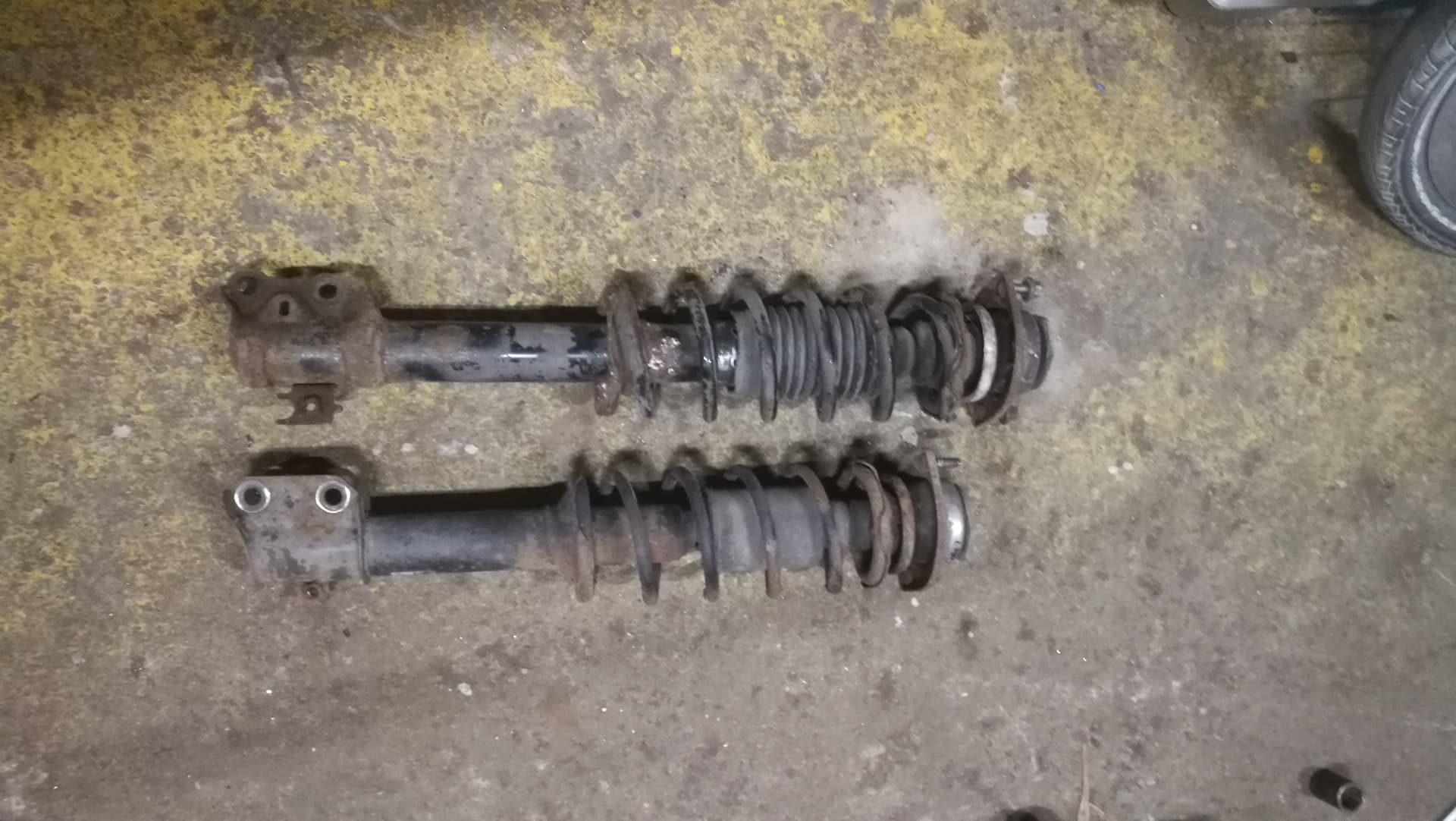

Salvaged:
-complete both front struts (dont fit, too long, more info later. Plan to use all strut elements, but with daweoo matiz shock)
-rear swaybar (too wide, more info in salam-s topic, or later when I’ll be moding this)

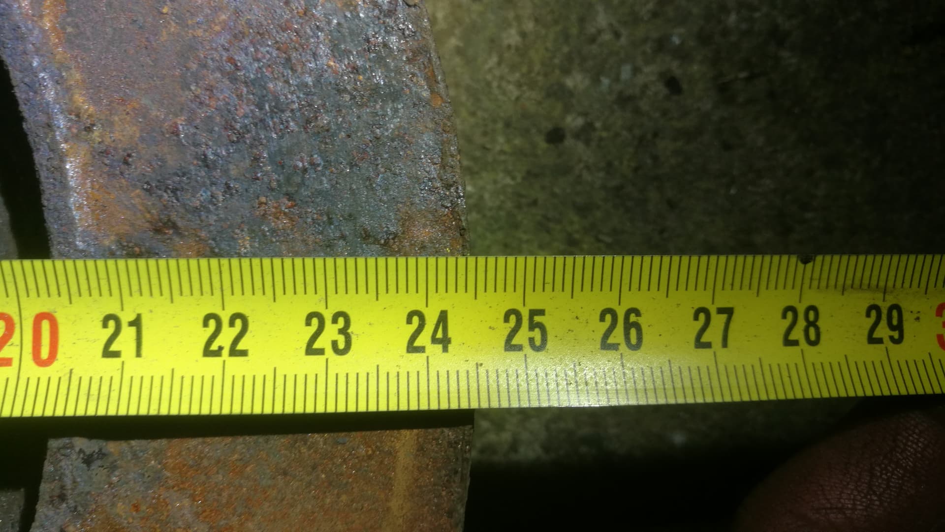

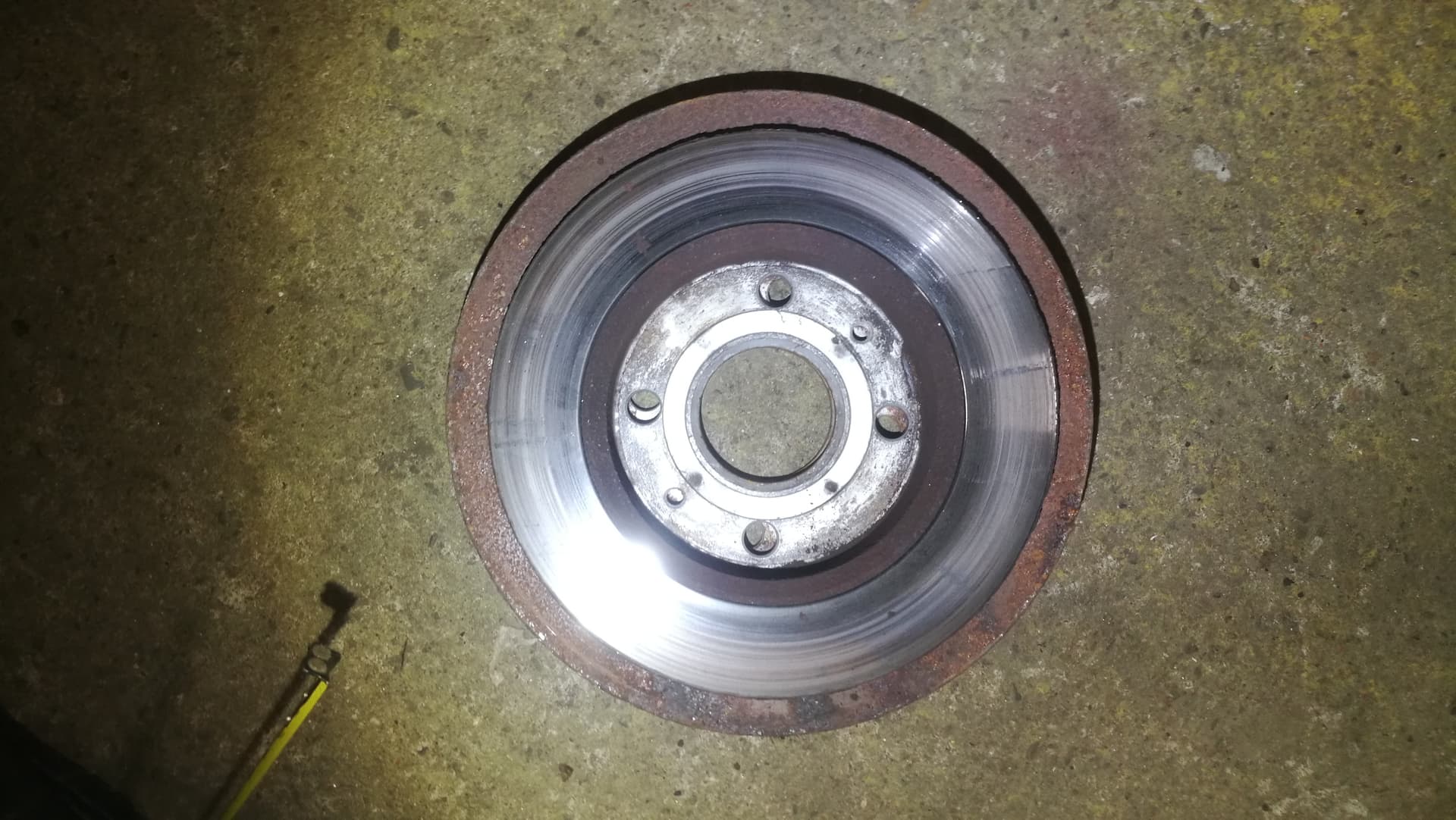

And biggest question, am I old and miss-matching info, or EU M300 have 243mm brakes instead 234mm?
Oh, brakes fits no problem, info from webs confirmed!

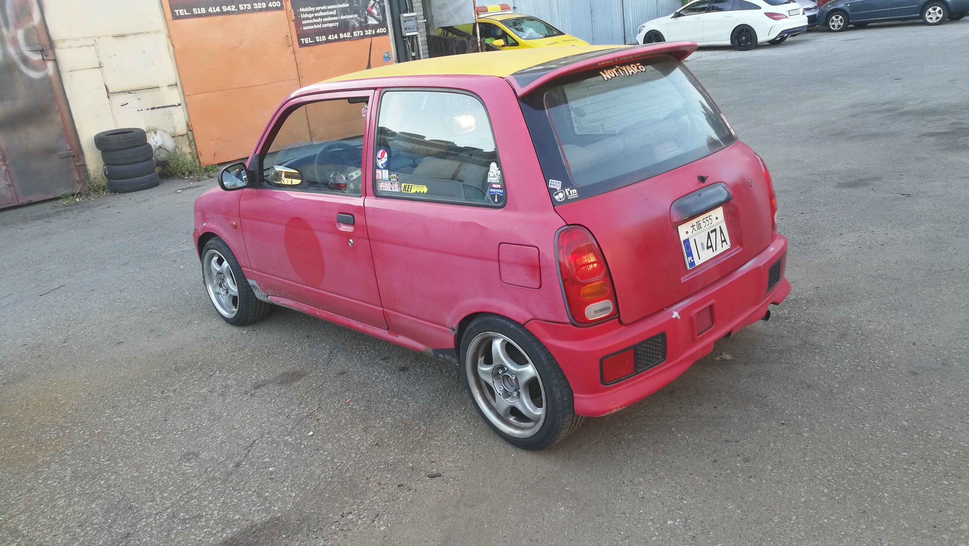

Oh, you may noticed that roof is yellow. Tried paint roller paiting, but gave up. Not happy about results. I will try air gun with 2K poliurethane paint (so called “top coat”, paint without clear, a bit oldschool) instead acrylic “hardware store, fence paint”
Mentioning this because color is chosen since begining, so I think we may official change the tread name, and nickname this car Daihachu or Mirachu.

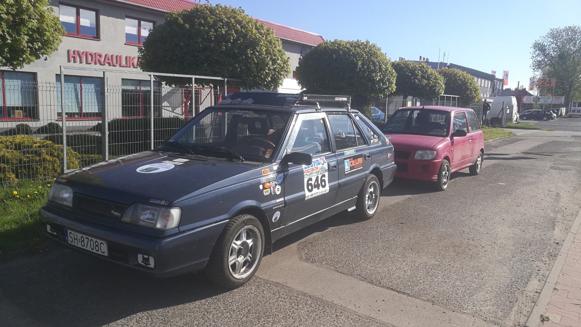

Car that my Dad finished 2015 Zlombol Rally at Passo del Stelvio (ITA). Still in use by teammate. FSO Polonez Caro (called “minus” to separe from facelifted Caro Plus) was last production car Poland ever made :face_with_head_bandage:
Notice old polish black plates, considered only and true historic by polish peteolheads. Plates are non reflective, so goverment tries to suffocate these by changing registratuon rules (like: you cant transfer these plates during buy-sell)

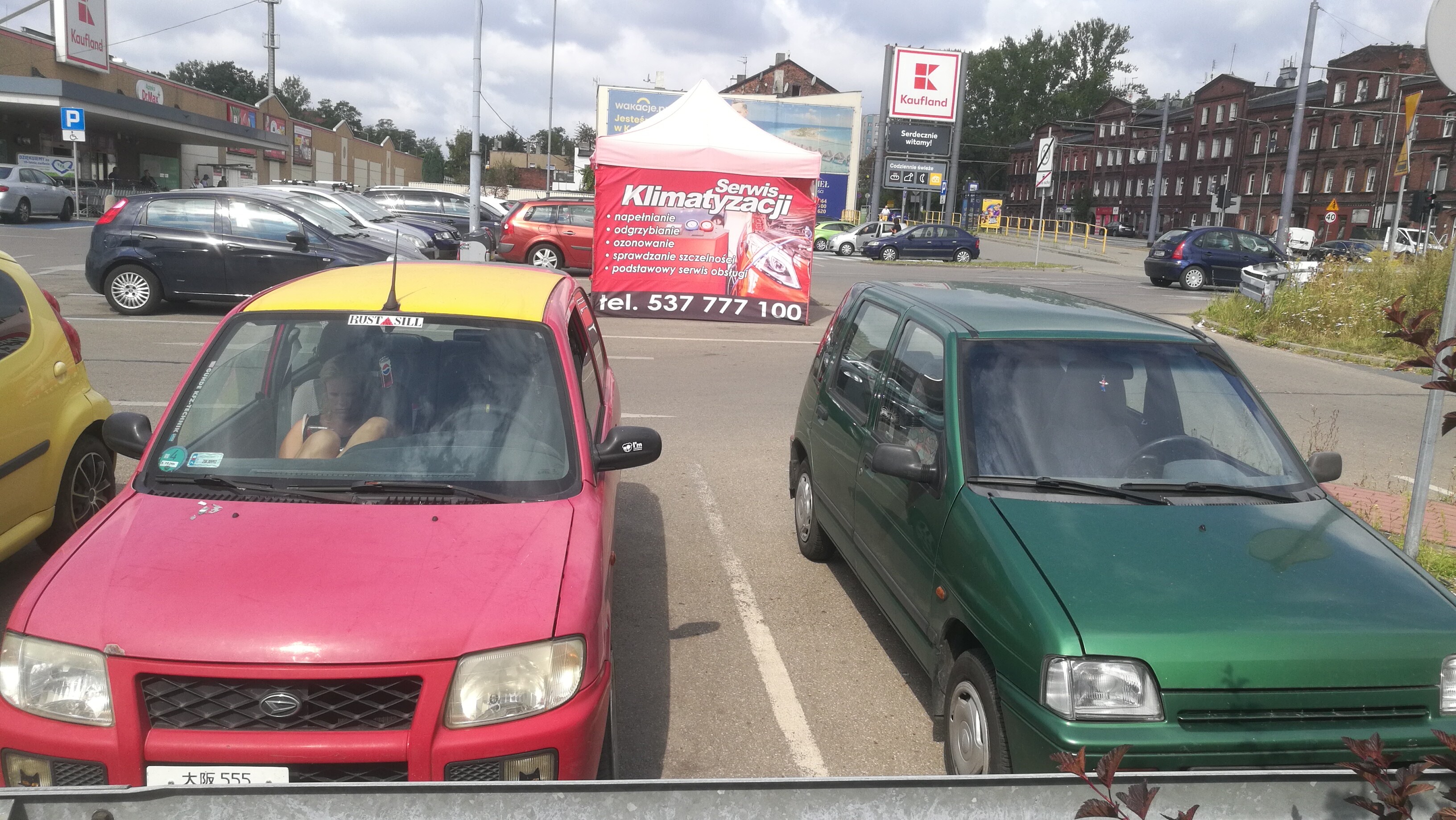

Daihachu with materia. Surprised how many of these are here. Second place after M300 sirion

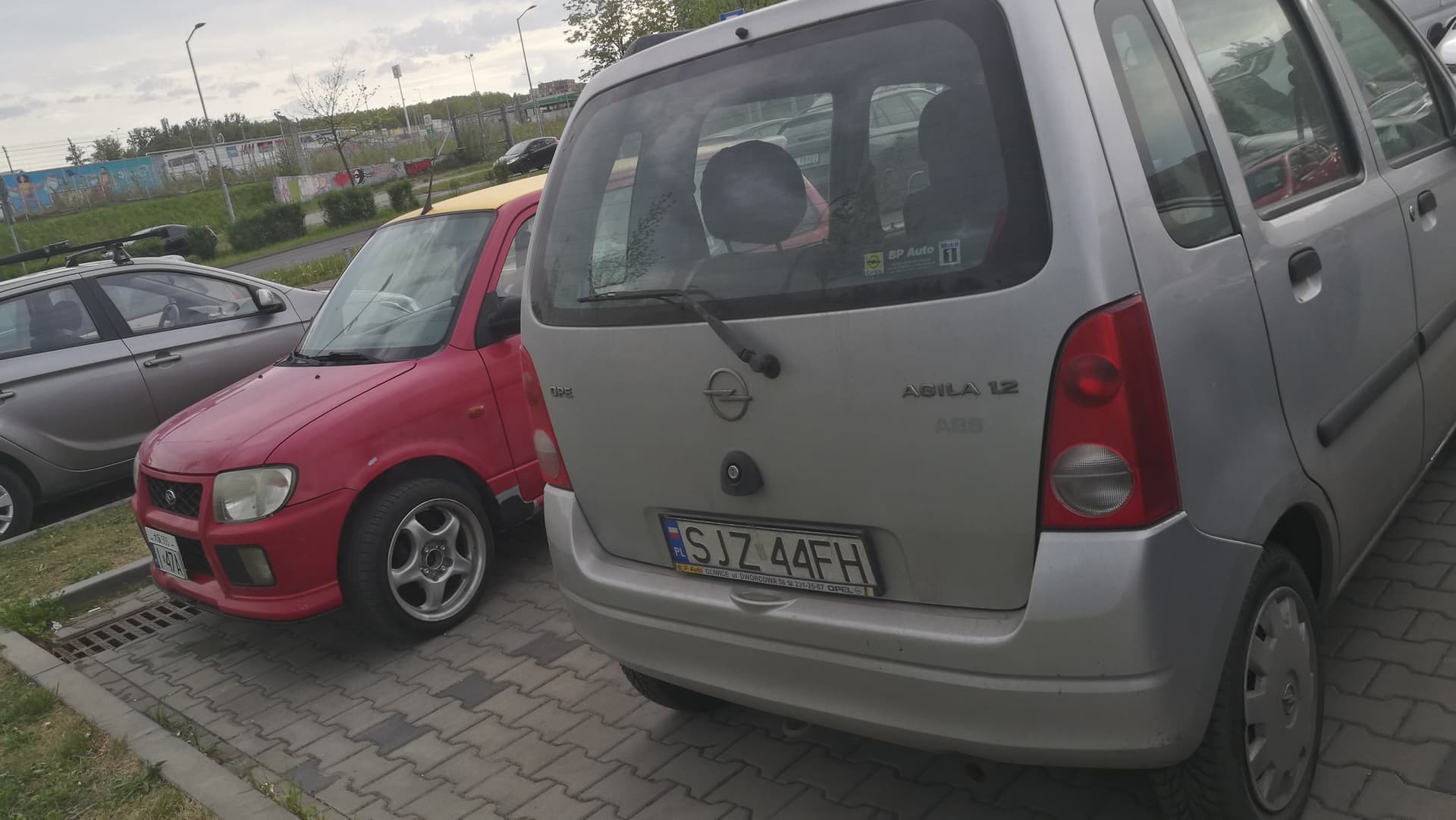

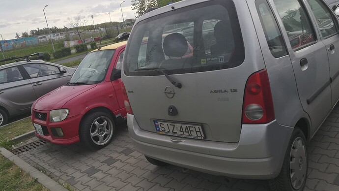

Daihachu with european opel agilla. Propably from our opel Gliwice plant that is only 20km away

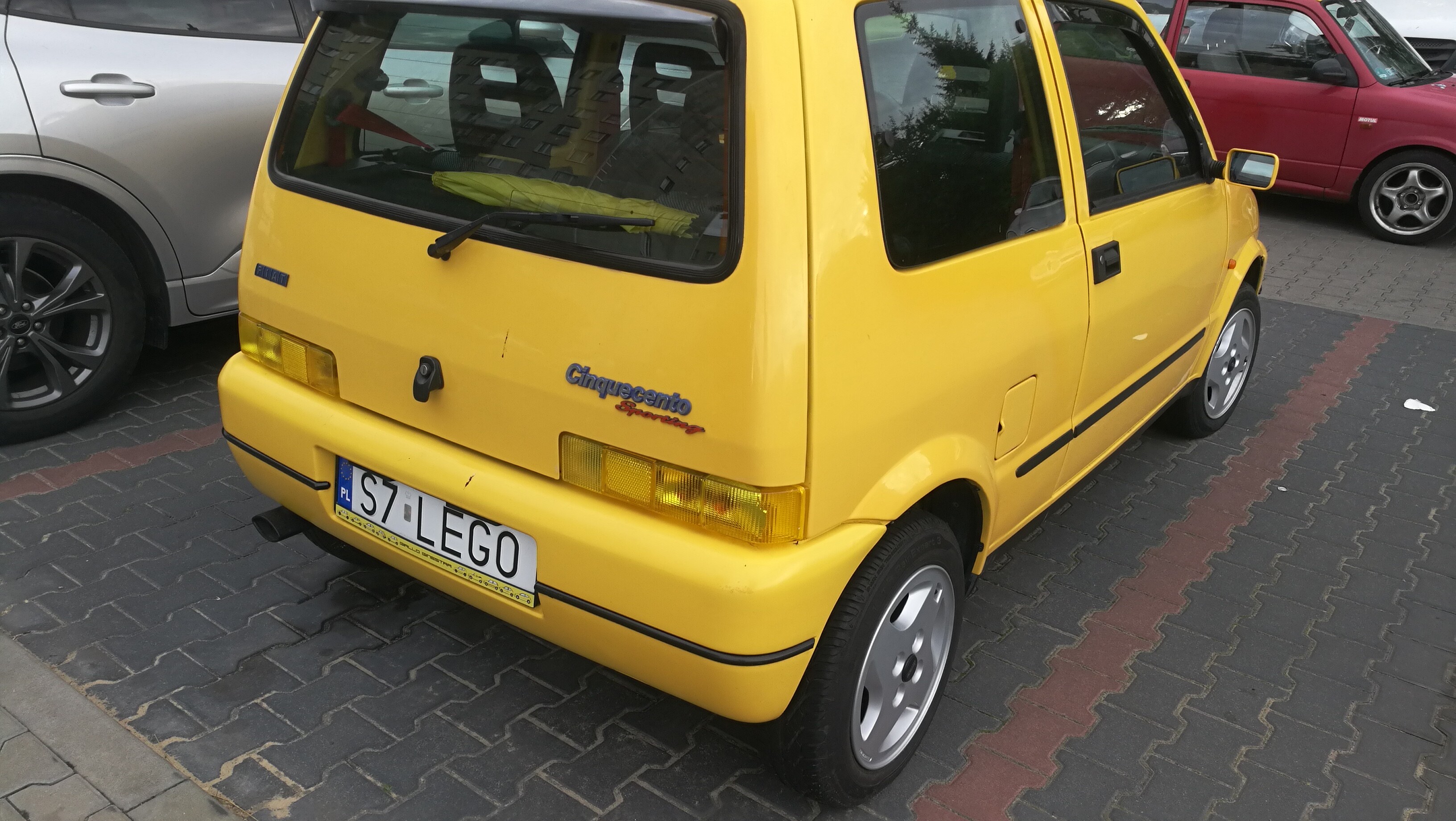

Heres some heavy hitter- fiat cinquechento was produced in poland, FSM factory, Tychy, or Bielsko Biala (cant remember) first versions had FSM badge instead Fiat and had 700cc two cylinder engine, somewhat related to Fiat 126 bis (watercooled) earli model with black plates are last of these kind…

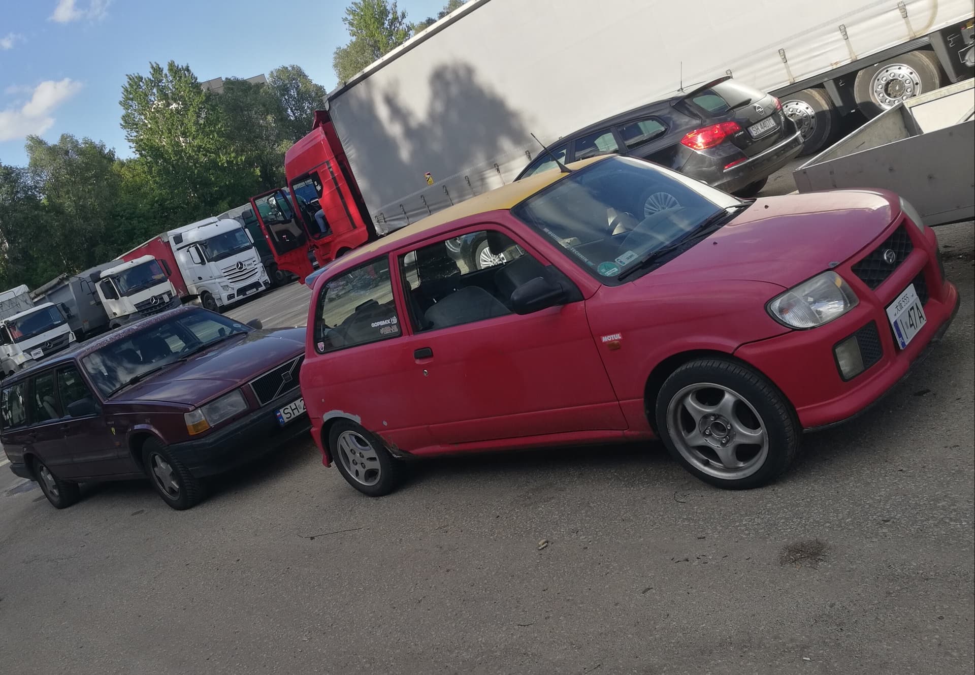

Lastly: : Daihachu with my friends volvo brick. He finally had to gave up daily driving this 740. Bought legacy BP for the time of brick restoration

That’s a desireable item. If the price is right, I would buy it for later re-sale, if I were you.
It looks like somebody attempted to open the bonnet and couldn’t. Is the drivetrain still in there and is the transmission an automatic?
Head was disasembled Butch, but dont know what was taken, looks like one of camshafts.
Really? When I was browsing around webs it seems that many of M300 had swaybars. You can lurk at main polish parts sites: otomoto (hard to navigate, parts auctions are new there), allegro or olx
Butch, I tried to fit some other car swaybar, but dunno where to find dimensions. Cardoc+? From photos some modeo or focus-related models had similar swaybar, but it will be more custom. Brackets modified to swaybar. Who knows how big these needs to be….Narrower bar is better that too wide in this case.

That sirion sway costs me about 25EUR, so I ll rather modify this one. But yeah, someone on the other side of the world may cry about this…
Another catchphrase comes to mind: one mans junk, anothers man treasure… looks like theres not much demand for dai parts. I’ve paid around 400zl (about 95EUR) for all mentioned parts

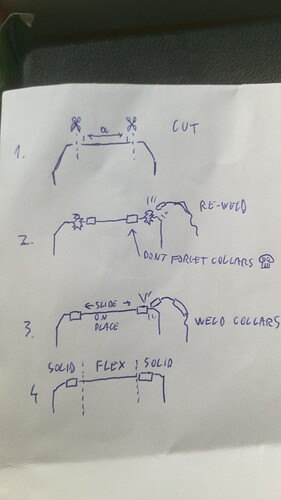

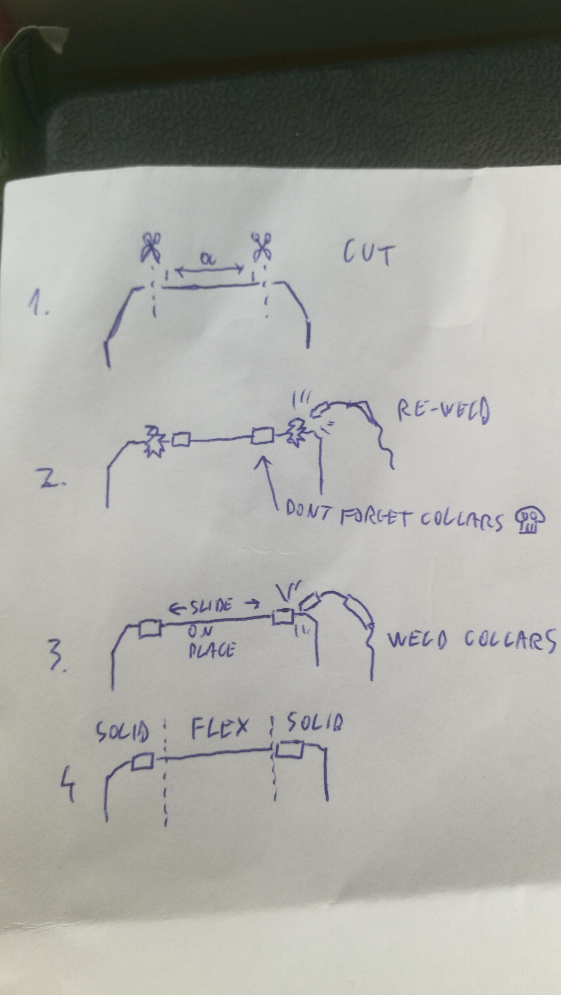

If the bar is too wide, you could cut it in the middle, shorten each half to fit and then weld both ends into a tube whose inside diameter measures the sway bar’s outside diameter. You will need to weld everything in spots, allowing each spot to cool down, before filling in the joint with more spots, perferably through pouring cold water onto each spot. The welding and cooling of each spot is necessary. Otherwise, you could soften the bar, through overheating
You literally reading my mind Butch :grin:

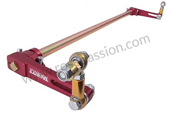

It should work like these racing swaybars mentioned earlier

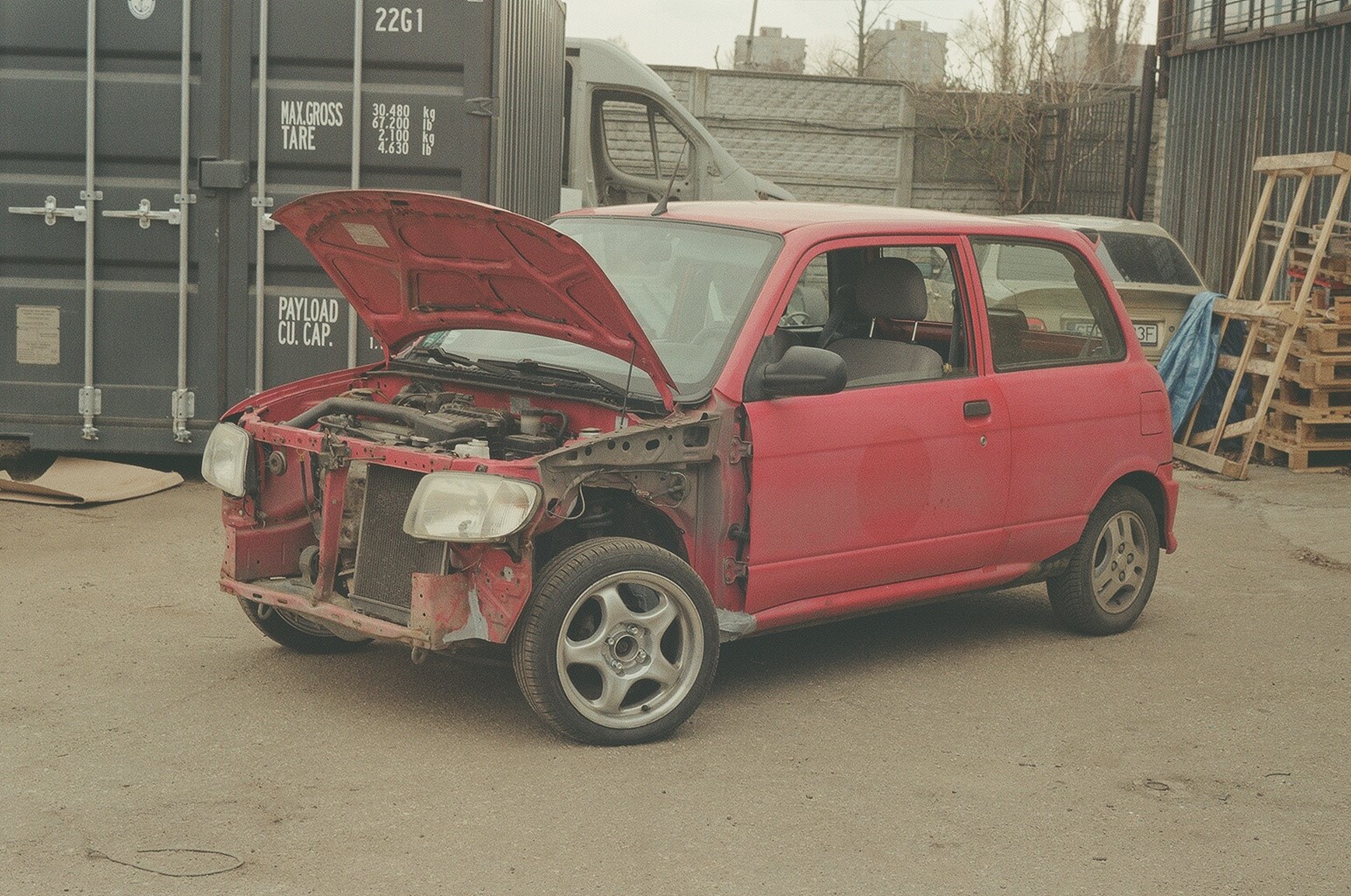

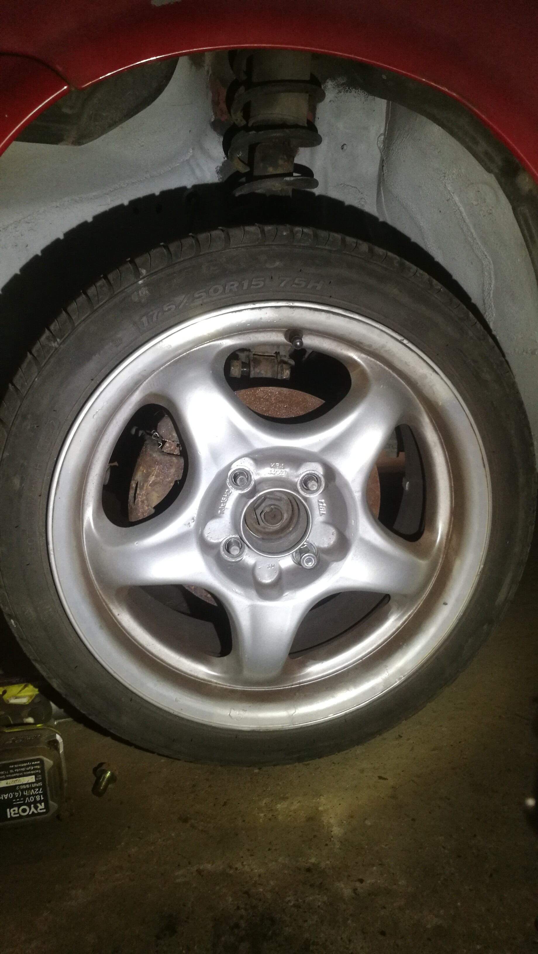

Finally we have lows and all 4 alloys!
Heres current suspension setup:
I decided to buy cheapest matiz shocks as proof of concept mule.
-matiz shocks
-standard L700 springs, trimed about 3/4 coil. Barelly captive. But not much to gain
-L700 tophats
Rear:
-Hyunday shocks is straight fiasco, these are too short. Zero negative travel, car was going airbone at bumps. Luckily I’ve bought chepest ones. Also sellers looks like wanted to get rid of these (these cars are dead here)
Curently theres stock L700 shocks, but condition is not too good. Next idea is Matiz M100 set. With lenght info from webs looks like these should be ideal
-micra k11 springs seem olright in rates, but rubs dramatically on spring seats. Looks like i ve got to get set of lowering springs at some point…

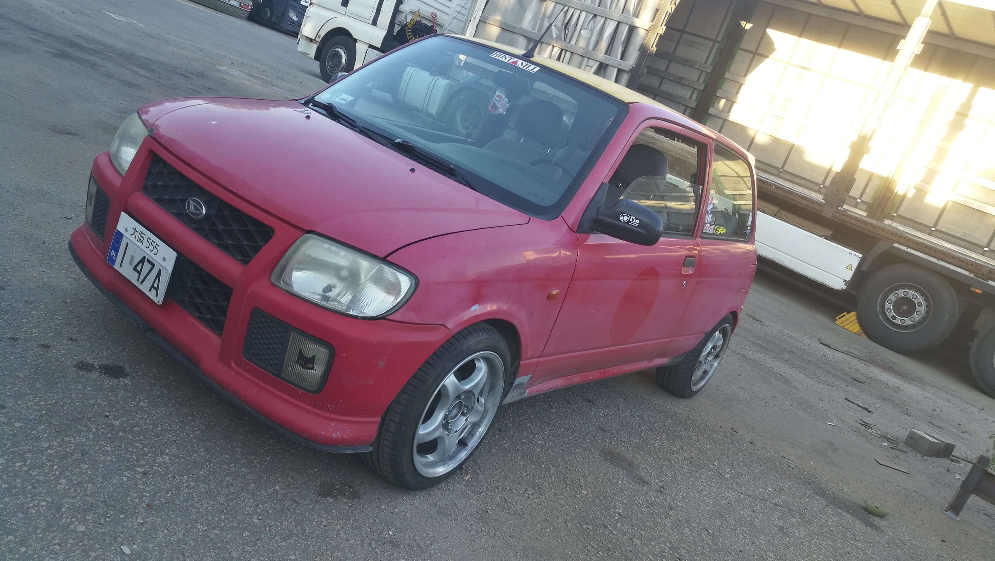

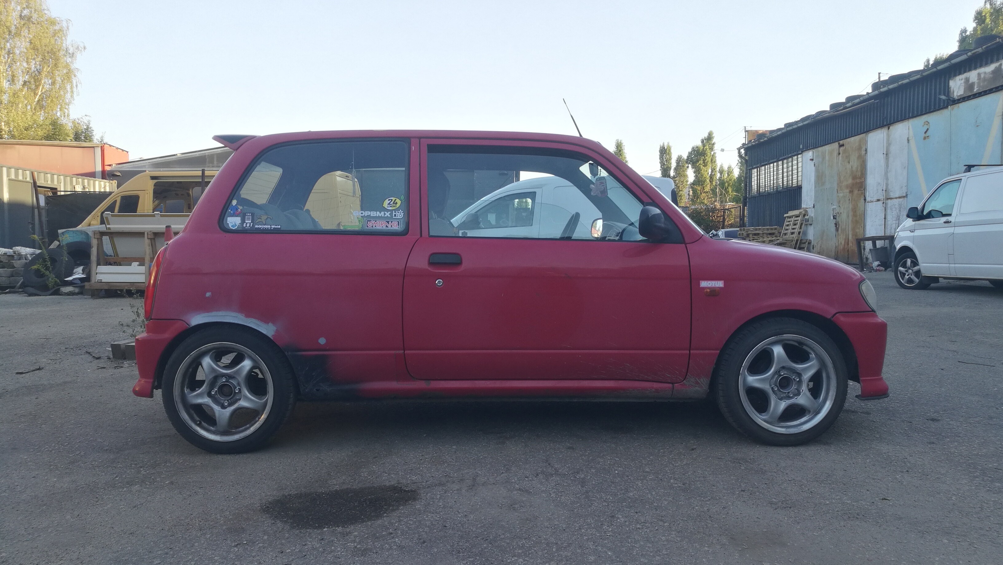

Heres how she looks like, it begs for some side skirts:
As you see arches work in progress. Right one is worse.
Needs some free time to finish rust spots and finally paint it!
I cant get more lows in this setup. M300 suspension is sacrificed as tophat donor. Ill erlange the upper hole and give front polo 6n setup last chance. 20mm more lows should be ideal
Some stickers added, like 24h of lemons, nugget nationals, I like how vibe of this car is mixed. Comes from japan, loved and raced in aus, cult following in malasya, daily driven in Benelux…
Kei to the City is inspired by martycarmods, Im fan of this phrase, great pun :grin:

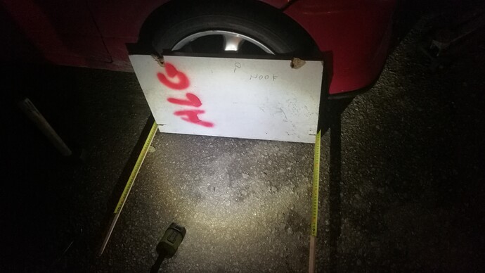

Shed alginment , oh btw. Matiz struts needs to have 2’ camber to hide tire tread inside arches. A bit too much for daily car, but with whole kcar globar racing vibe will be nice. Also cornering imporved dramtically. Still dont trust Mira as much as K11 or impreza, but corners wery well. With widen tires and lows, weak shocks and loosy bushings are noticable

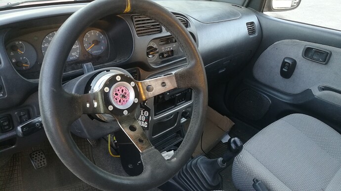

Hayashi Sakura steeeing wheel center cap

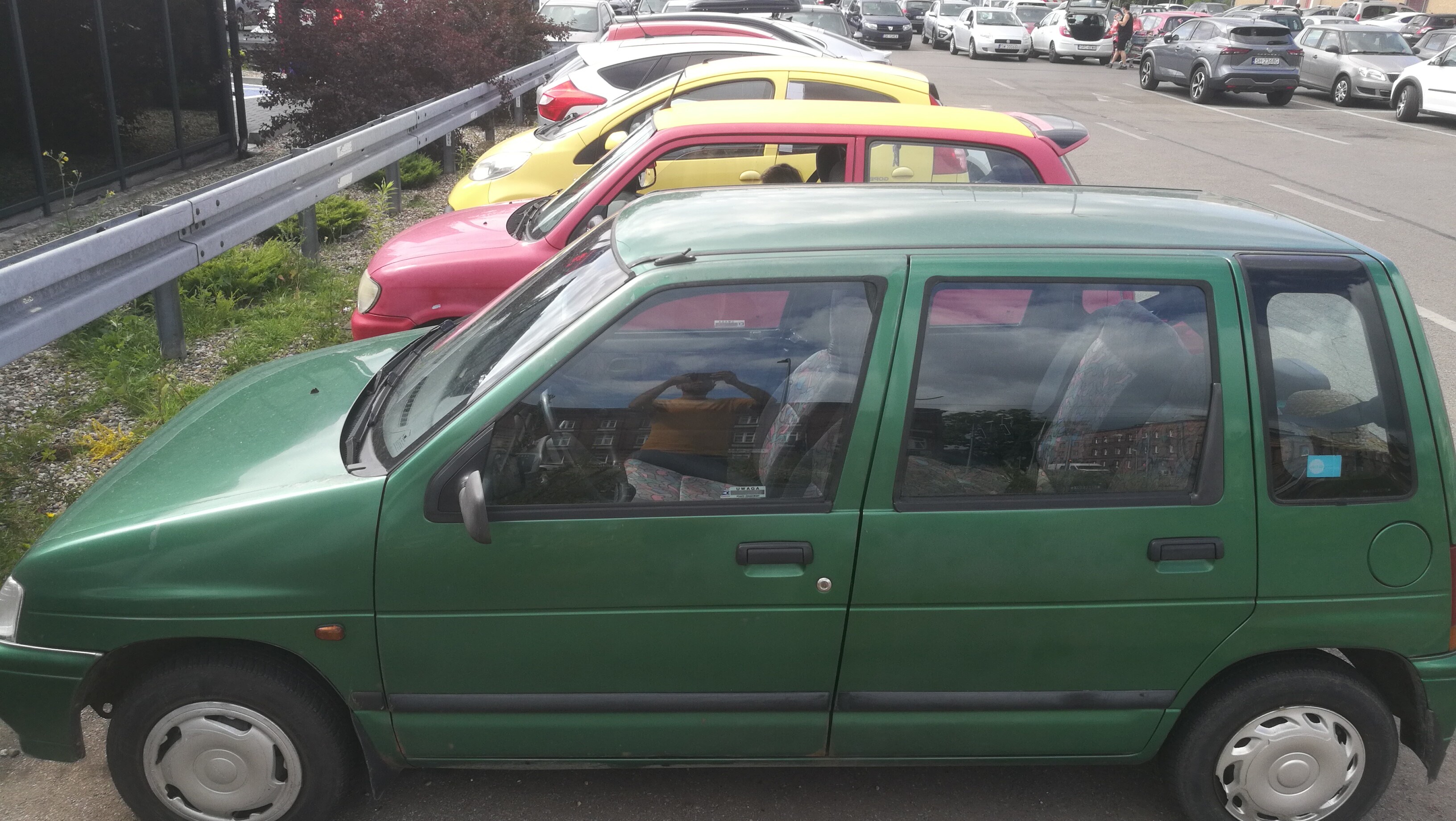

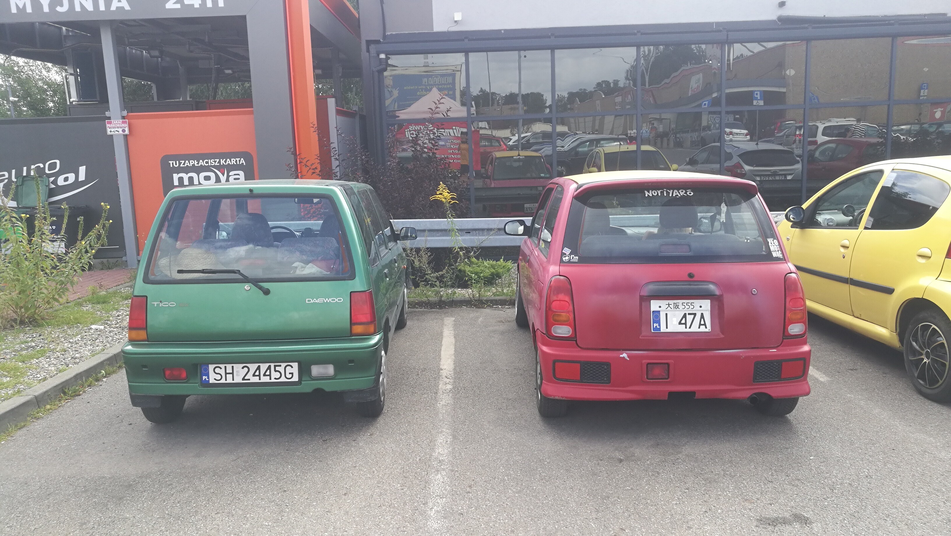

Todays bonus is side by side compairsion with Daewoo Tico. Hugely popular in early 2000’s

Oh maybe also total yellowed Cinque as bonus2 :smiling_face_with_sunglasses:
