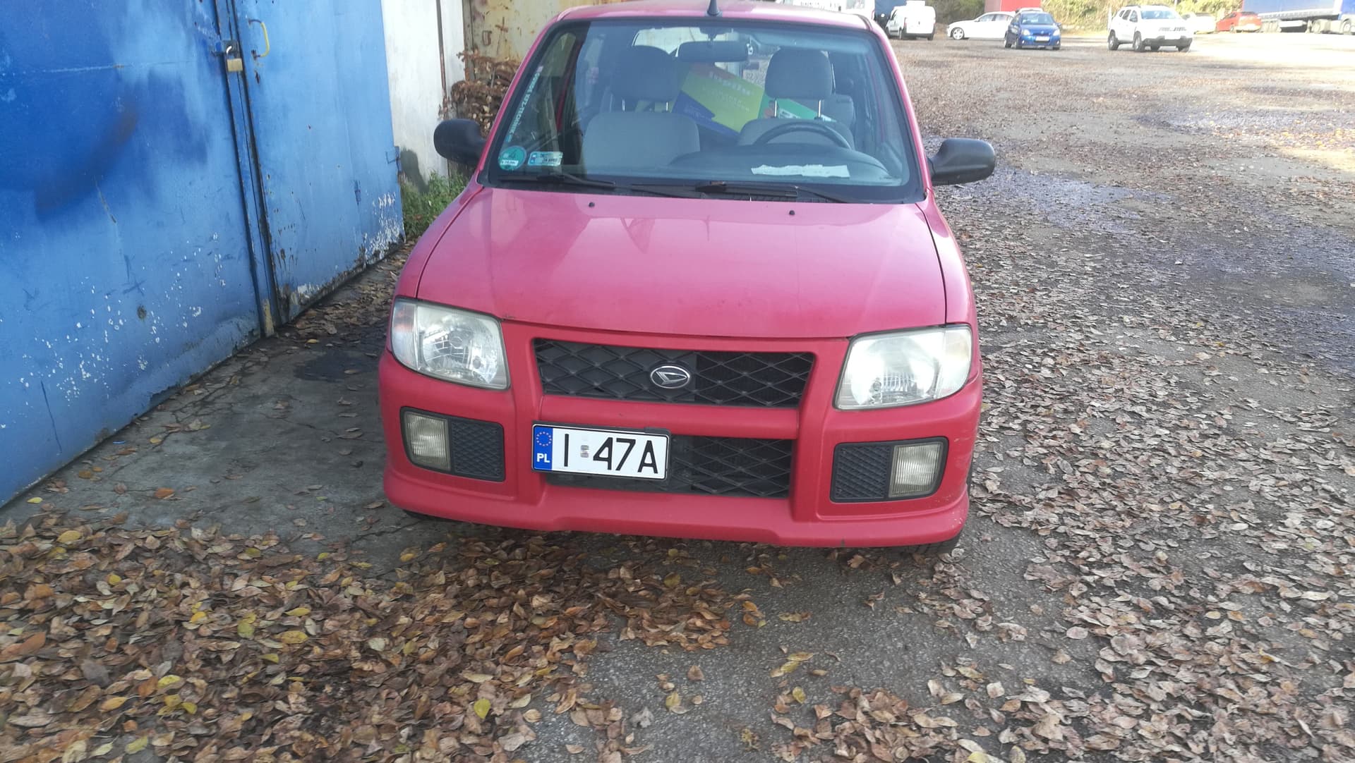

I traveled to buy Mira about 600km to polish seaside city, kolobrzeg. Im from other side.of country when mountains are, close to Czech Republic and Slovakia.
Car was in supeisingly good condition, I felt in love instatly. Big glass, huge turning radius (both of these lacks in yaris, i still amused how dramatically small turning radius is. Maybe its TS thing, i dunno…)
Paid 3000zl (1200AUD, 700EUR) and bombed home without problem.

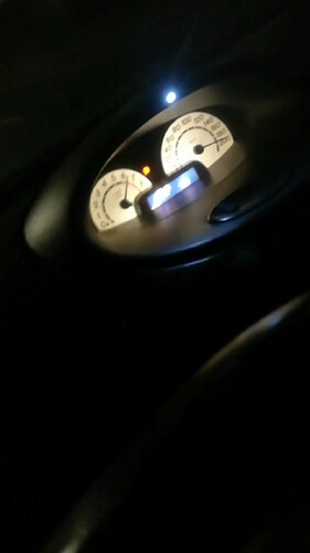

Heres photo of closing the clock. Everythings topped. I used to say “gerbox cranked to the max” but its revs issue. Its about 100-200rpm before fuel cut. You may also see shiftlight added above cluster, because I cannot catch the shift point for first weeks. Redline is 6000rpm and limiter is around 6300. I was bouncing the limiter like some typical honda guy :sweat_smile: no match for micras 7500 rev limit :pensive_face: ….

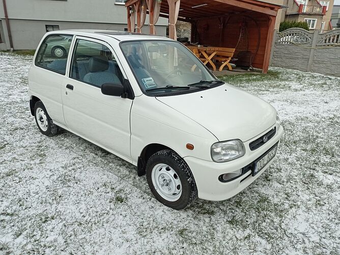

Okay lets proceed to Mira.

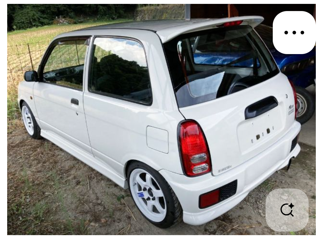

Goal is to make it look like those awesome Malaisyan Kelisas.
There was an pool about color between daughter and wife. White is my long time fav…
But everyone likes idea of…

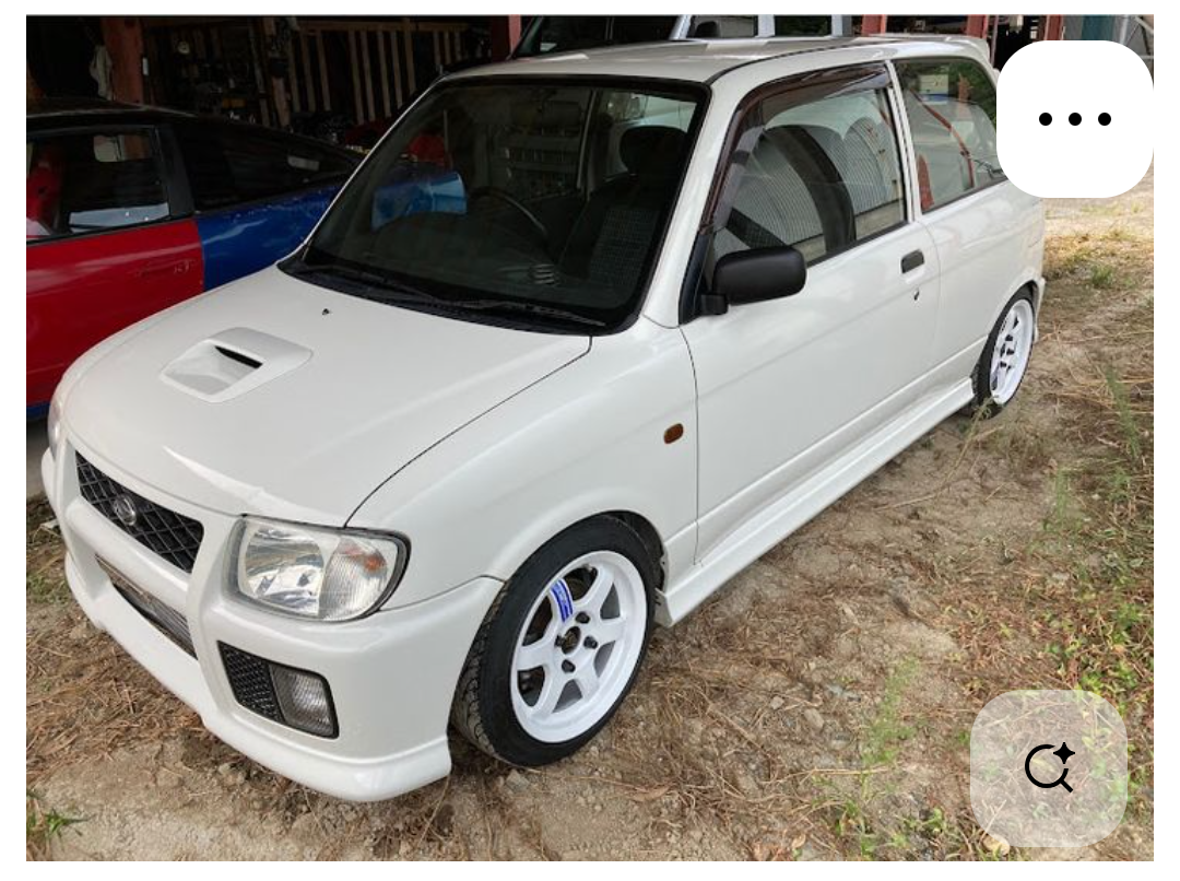

This exact car will be the main inspiration. As Gran Turismo kid, considered yellow body with black rims, spoon style, but paiting rims black makes them invisible. This one looks great with regamasters!
Quick intermezzo. We lacks of jdm wheels here, there are knock offs, but not even dreamin about TE37 in kei size (6.5”, ET40)
During K11 era I’ve found myself a challange to find forgotten german style (2000-2010) rims that has some jdm vibe. Usually those are cheap alloys with centercap, but when you not instal centercap, these are diferent beast.
First example, AEZ C7015 a bit regamaster looking. Regret selling these, but these went to my friends wife yaris
Later I’ve found amazing meister lookalikes. R.O.D Atura rims. Beefy lip ruined these, but overall looked nice. 8” and 20 offset was too much for any of my cars… some guy bought these for miata
For Mira I’ve found set of Rial rims (germany). Nice dimensions (7x15 ET40) but this center cap lip looks weird. Ill try to grind it down. First tryout with meat tires
White, with 175/50 should be awesome!

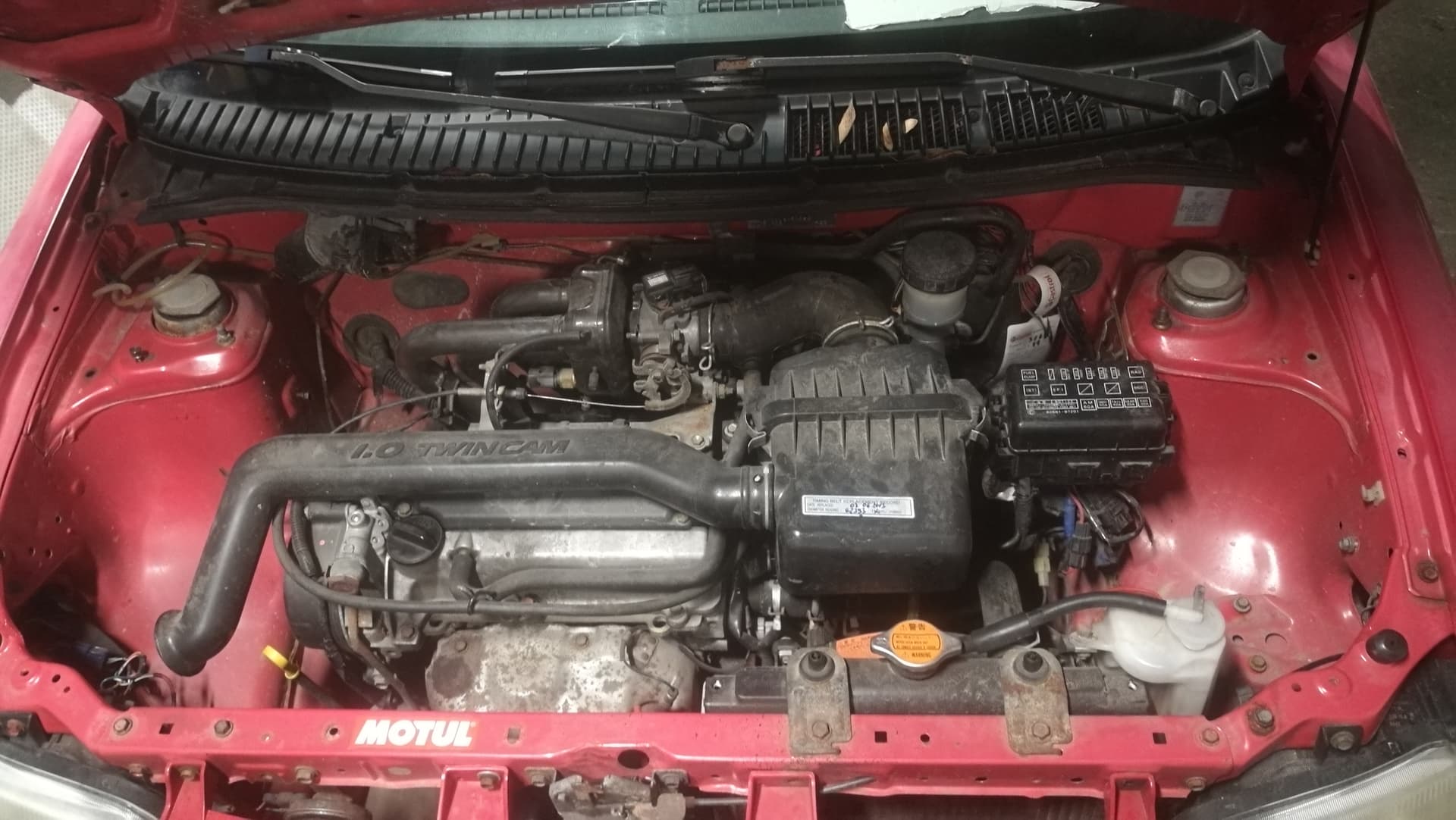

In engine bay I only did washer delete and batery relocation

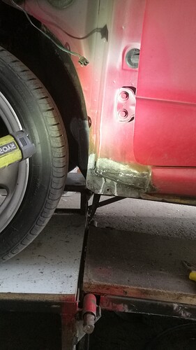

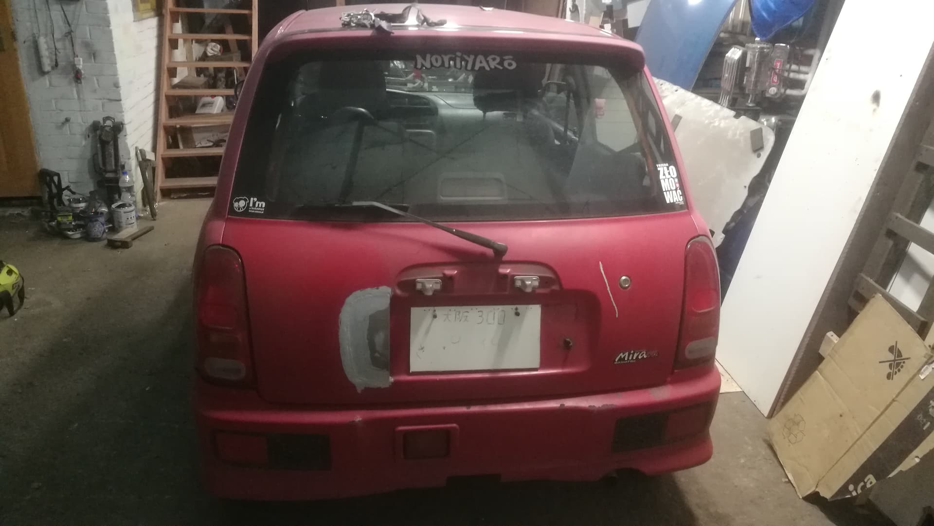

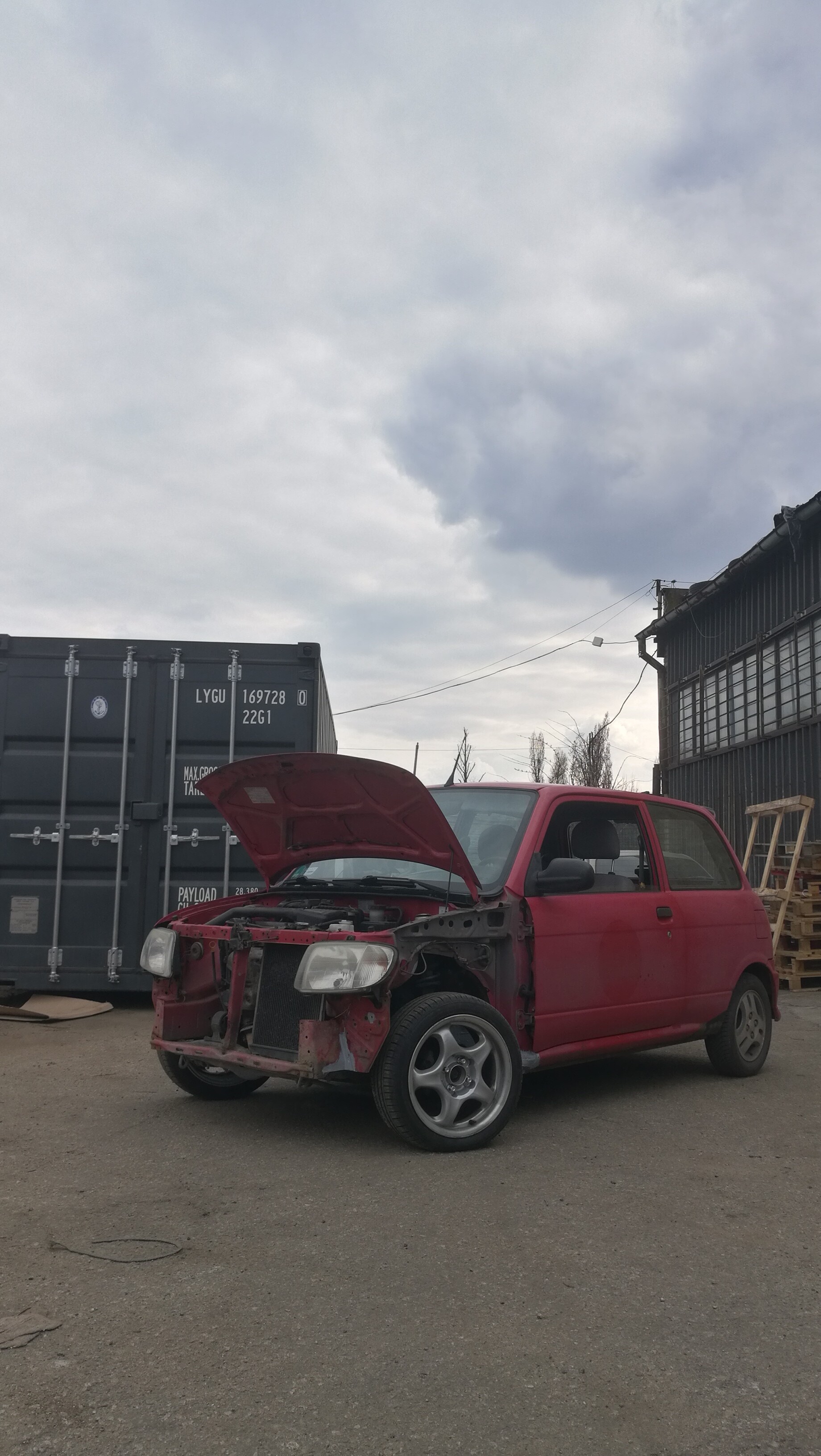

I have to reweld rear hatch…
In progress, also NoriYaro window banner visible. Heh, I was mailed with Alexi before he became famous, no one will belive anyway :sweat_smile:

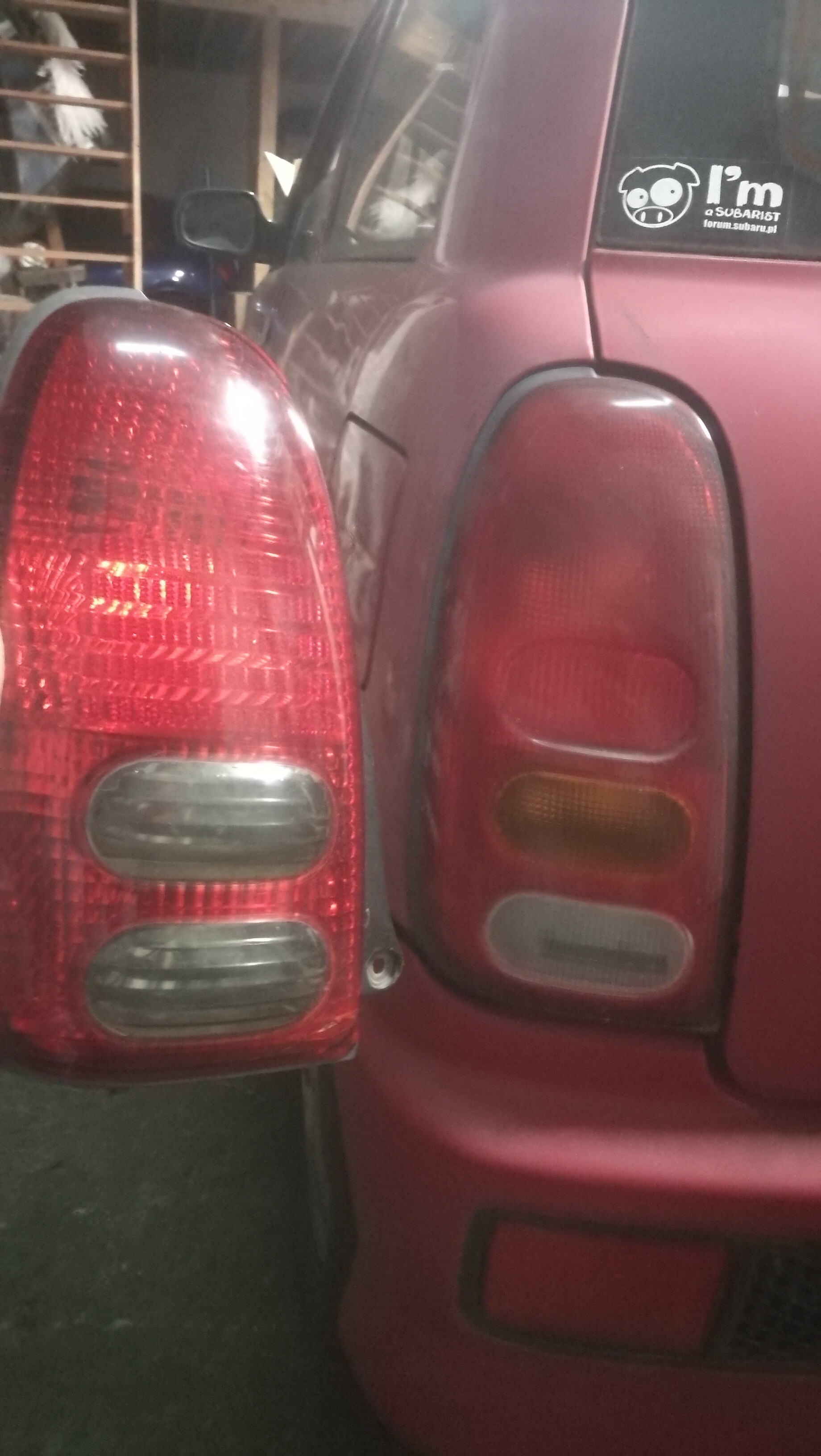

Oh, forgot about other mods, one tailight, one to go. Have it in progress

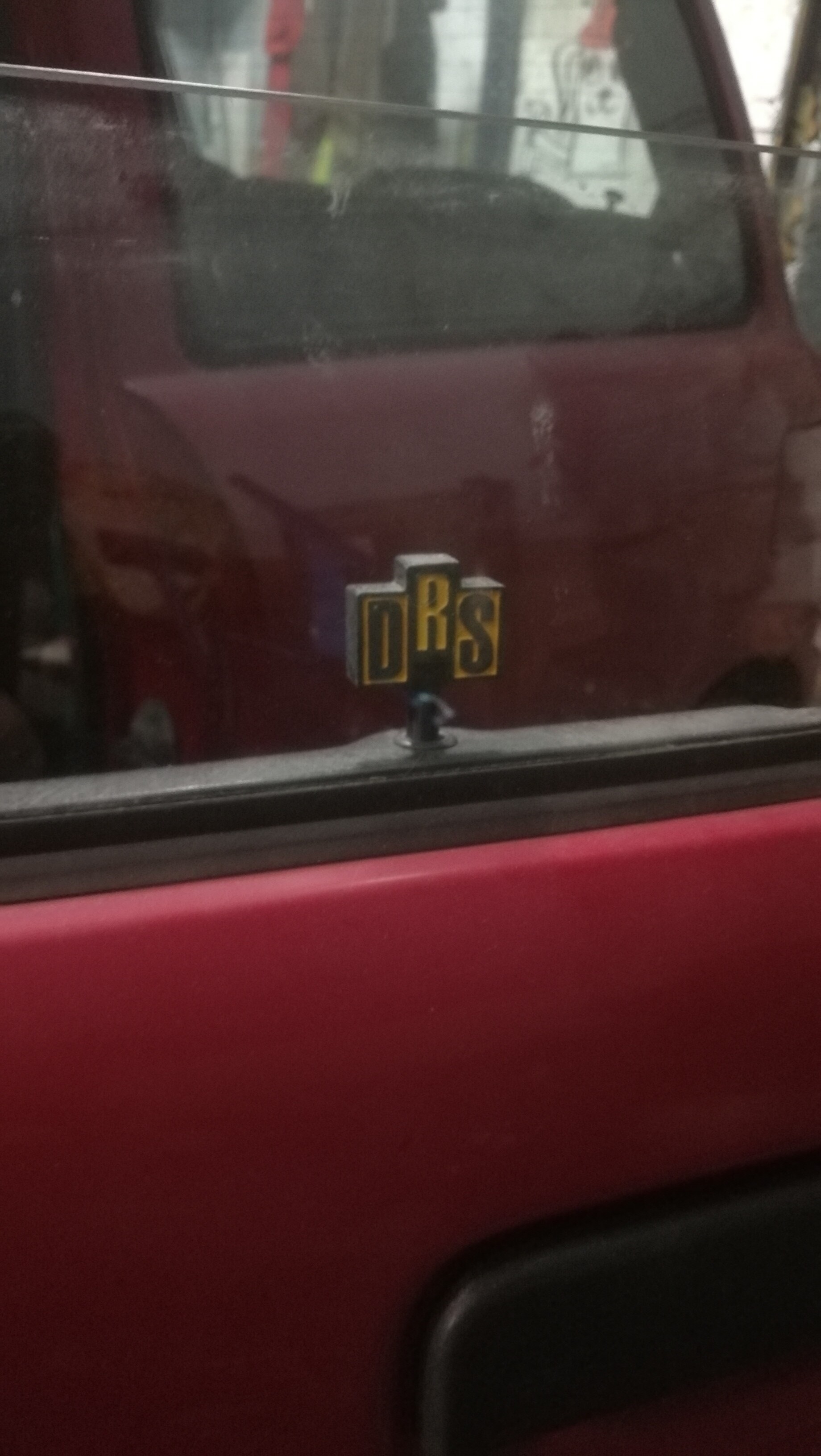

Some 3d prints, Mira badge and DRS door lock knobs

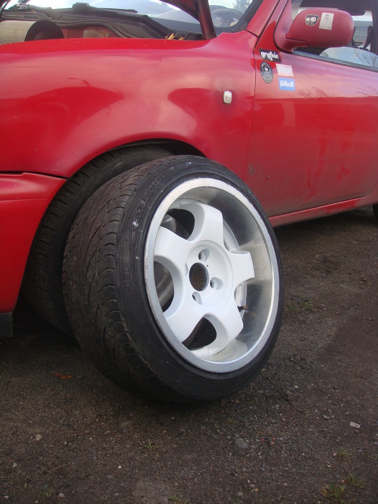

Bonus: friends wheels 7x15, ET35

Hatch reweld in progress, no foto, sorry :grimacing:
Osaka go go go :smiling_face_with_sunglasses:
Hatch will be re-done again before color change, I needed to rush to move Mira out from garage

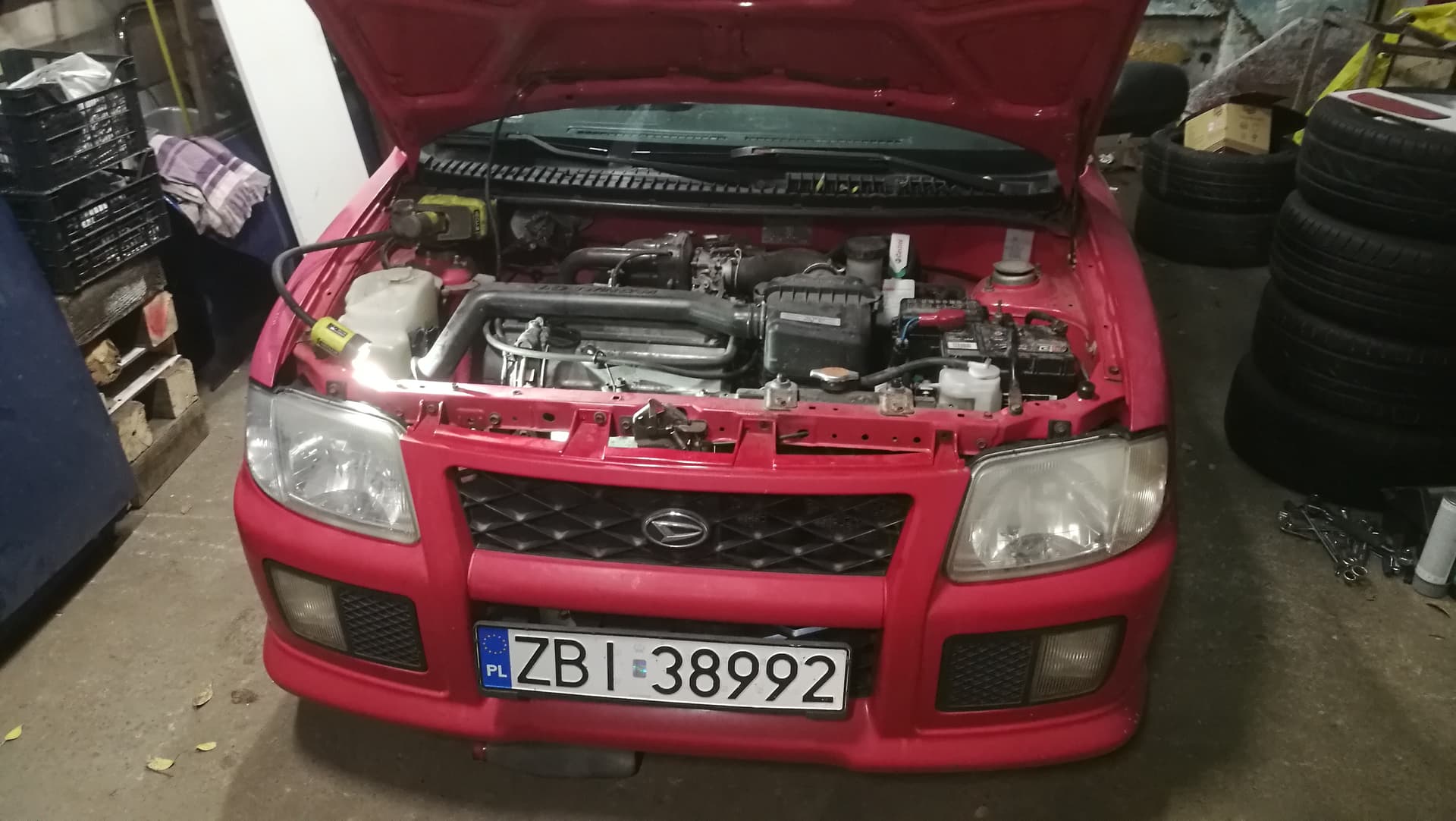

Engine bay shot after washer delete and batery relocation

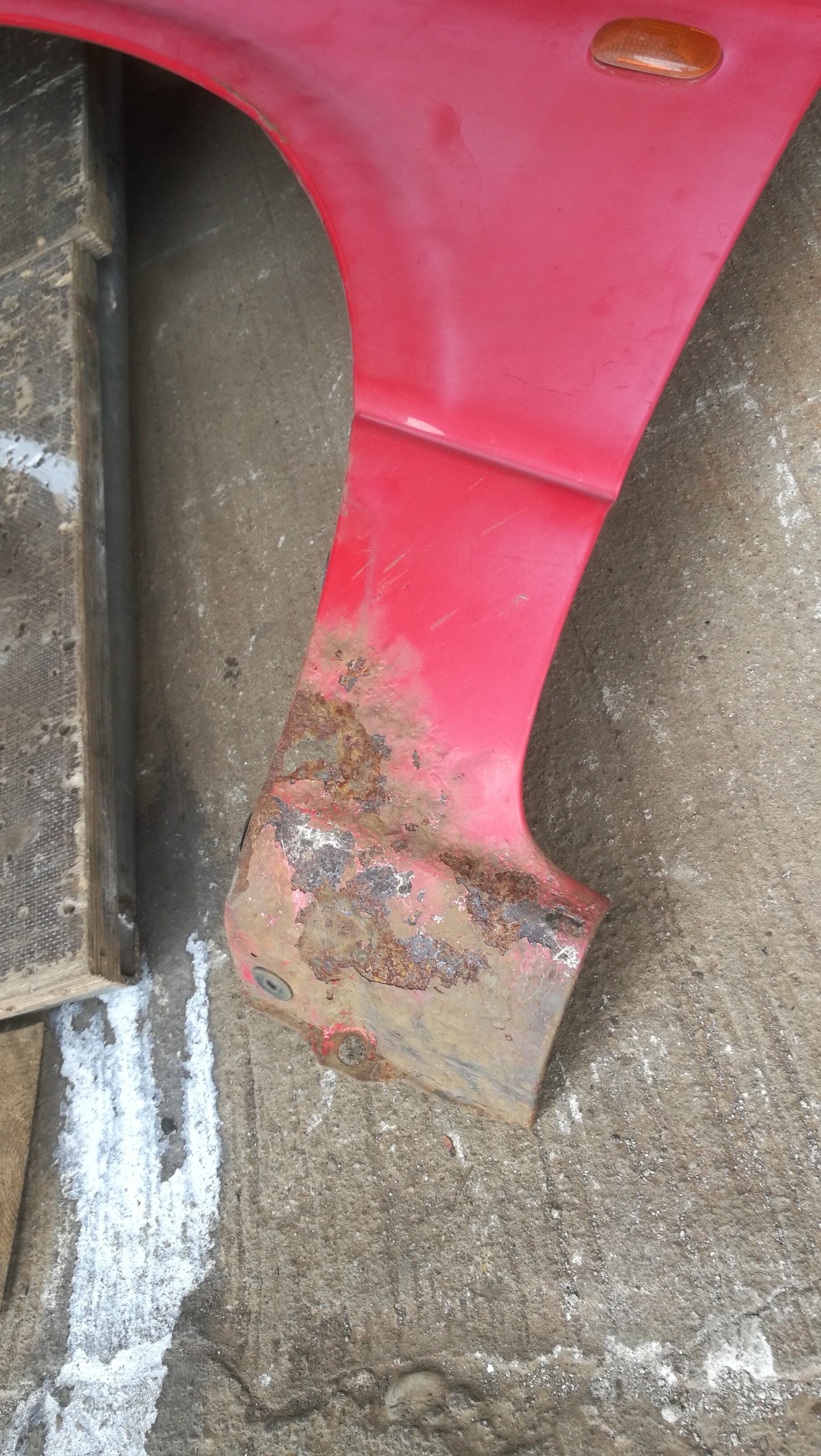

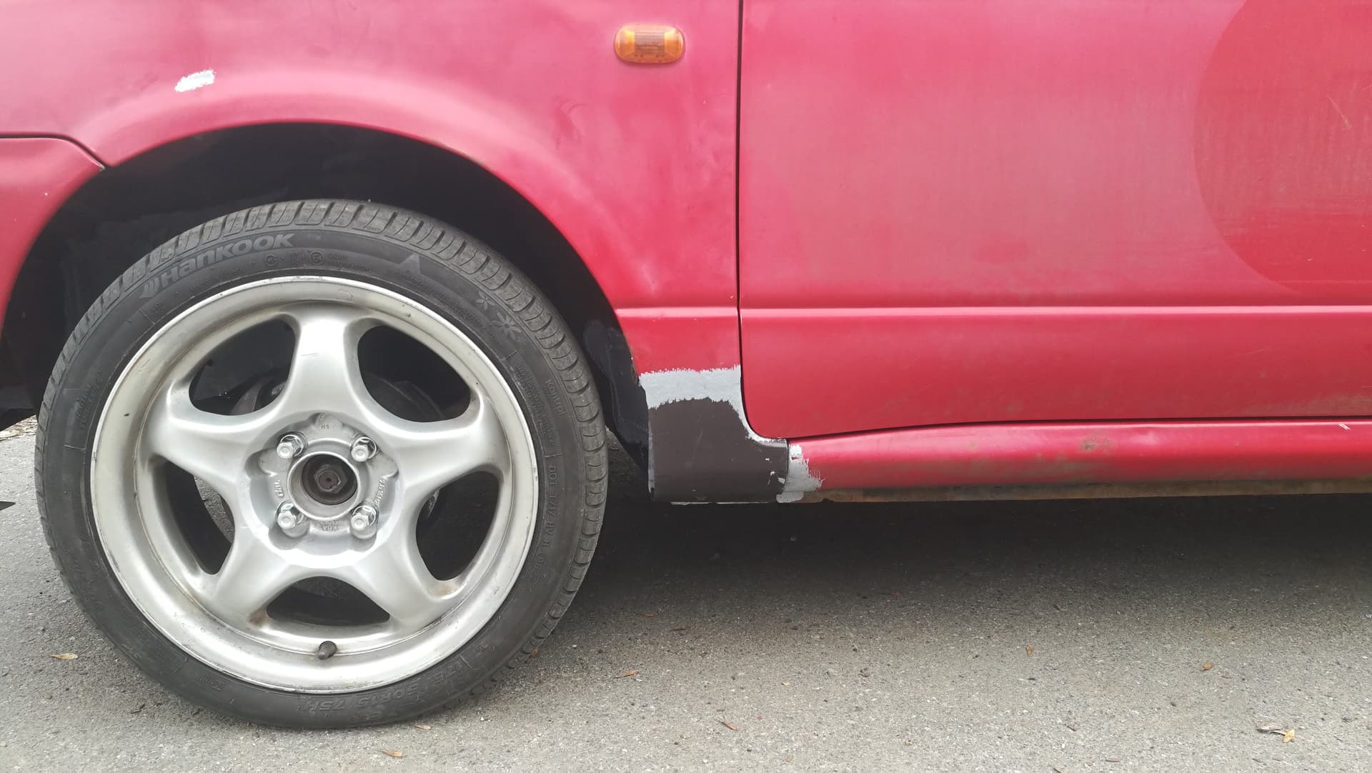

Started some rust prevention. Car is Not ideal, but overall promising. Way better that my beloved 300€ K11.
Why these japanese rustbuckets loves me so much… :sweat_smile:

Butch, about exterior looks its decided almost from the day that I bought the car.
Im not affraid to say replicate. These looks awesome. Even considered get similar TE37 lookalike rims, JapanRacing, well known budget brand…. But still, this is a bit too much. Dont want to go full-money waste like with K11…
These Rials was paid 300zl= 70EUR= 120AUD. I’m 5spoke guy

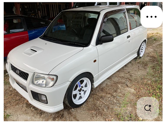

Heres my goal:
Also behind scenes colour is allready chosen by my daughter. I was in the middle between white and yellow. She decided. Want to replicate this exact car :heart_eyes: :

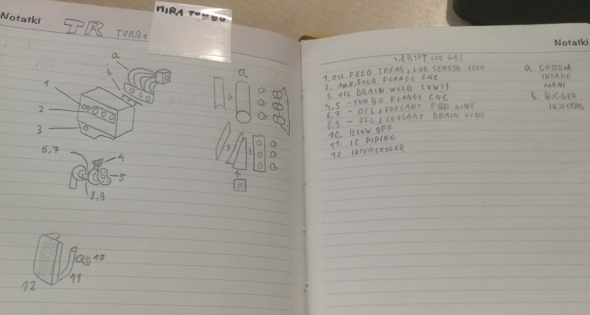

Okay started to plan my second homemaderurbo. com adventure.
Noticed after all this years that plan phase brings me as same fun as actual work.
As usual theres still some things to solve or gather info.

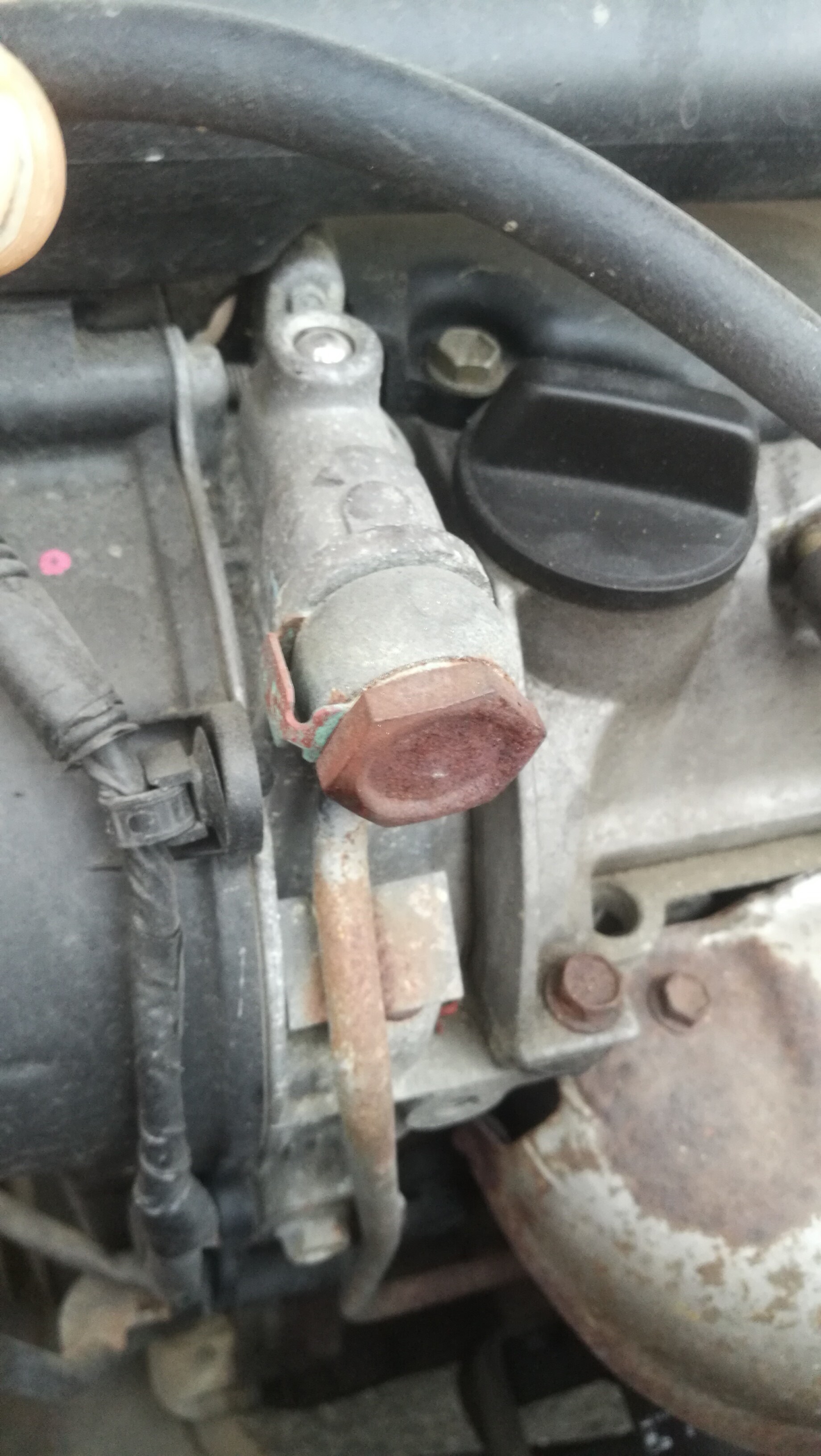

For example, what bothers me from begining I bought dai:
If EJ-DE dont have variable timing, what is this hard line to head for?
This one strikes again, because (for days of digging, cartune.jp helped a lot) I noticed that japanese turboed versions uses this hardline as turbo oil feed :hushed_face:
Wich makes mi think- should I stick with oil sensor feed idea, or try to replicate oem design…
Still on the hunt for coolant lines photo, if theres any ED owner jup to my tread, please conform routing for me.
If Ill not find any info I’ll try classics- TB colant line repurposed as turbo coolant line

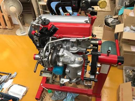

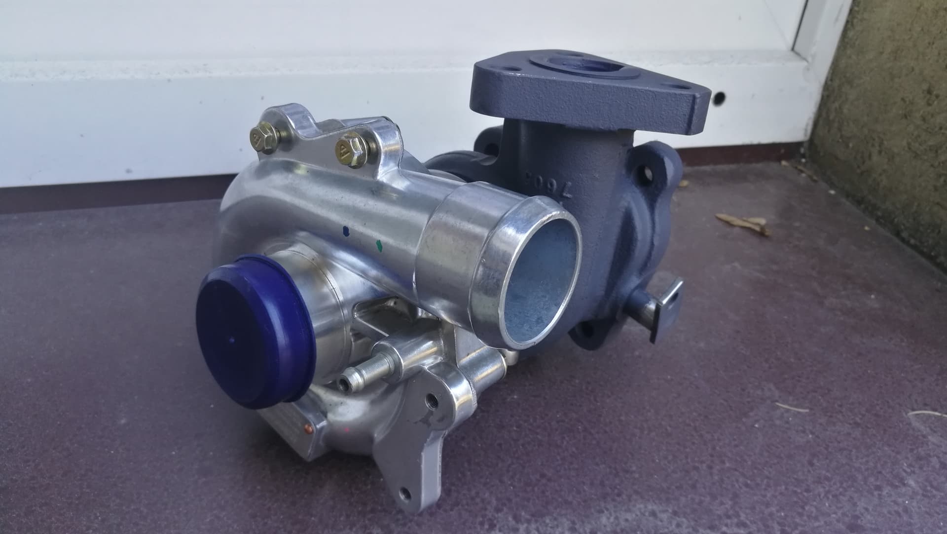

Stock TMIC is compact, but not great. Ic is still cooked by hot engine. I’ll try my droped idea from K11- verical monted chrysler voyager ic. Also plan to divide hotside and cold side quite solid, by routing all pipes via RH side of car.
Also big thing that I never did before will be custom intake, that switches TB facing to RH.
Our intake mani is designed for mid range na aplication, turbo works better with bigger plenum. Allready bought spare mani for flange hacksaw, its steel, so I dont need huge resources to made this happen.

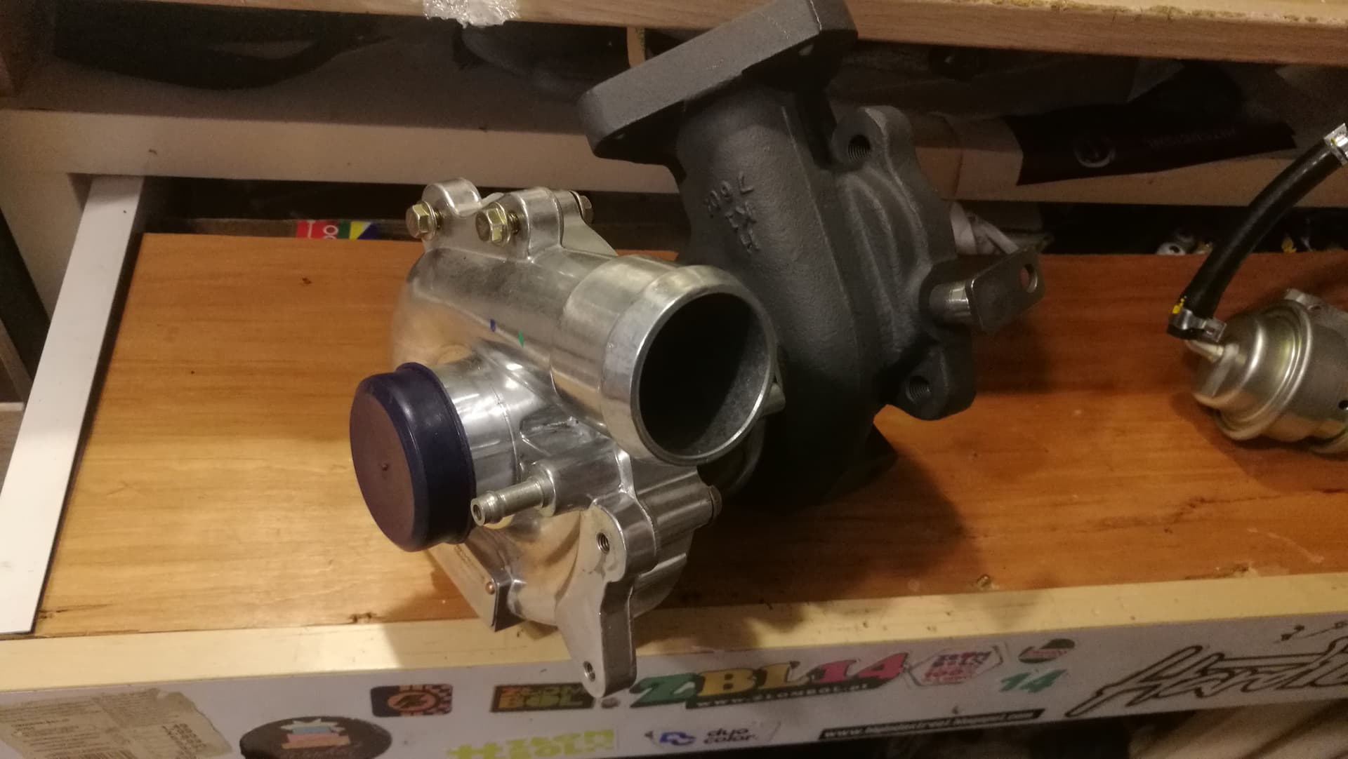

I plan to use spare IHI RHF4 VT10.
Handmade exhaust mani, log type
What else…
Fuelig is a bit headache, because of dead-head fuel rail. But its long way to ever consider this issue.
Stage zero will be slighty bigger injectors. Considering add rerurn line ad drill tap some spare fuel rail
For oil return considering VW lines that features bolted flanges. Rubber return hose dindt worked well in micra…

My guess is that this line delivers constant oiling to the camshafts’ gears.
The turbo versions hook up this oil feed to both turbocharger and to the valve cover
Okay, confirmed
VVT selonoid have electric plug
EJ-DE its just oil feed

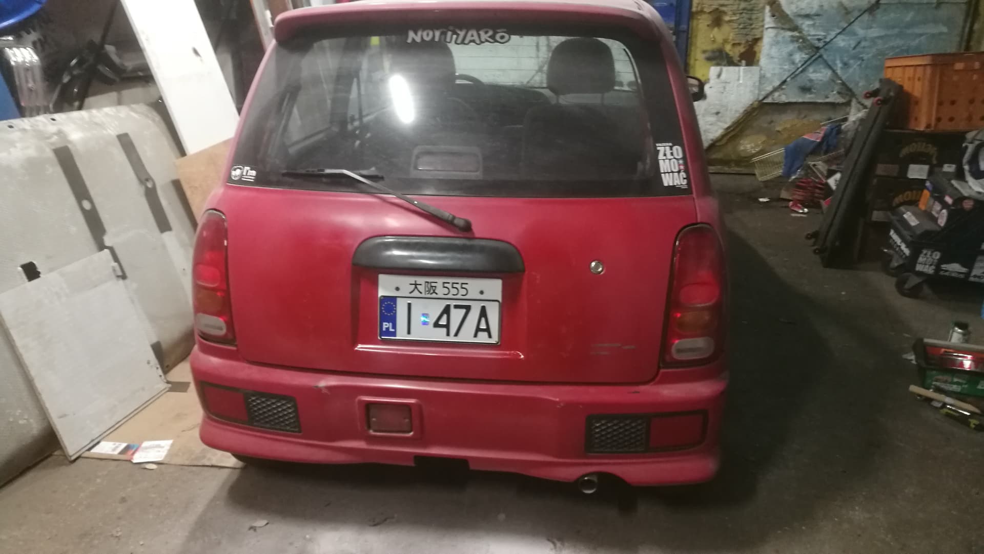

Sup people, some forced day offs at work comes, so lookin for some progress

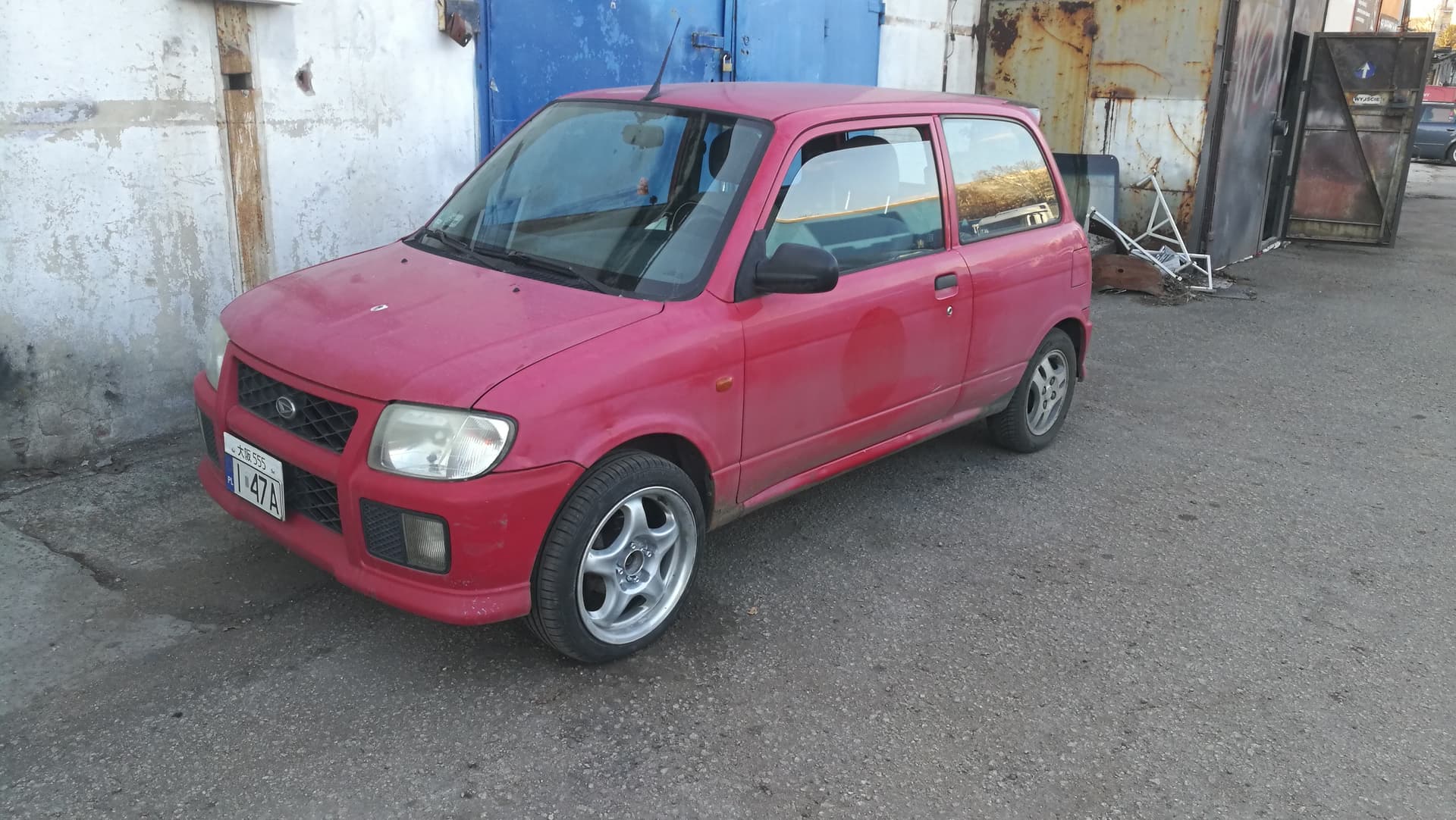

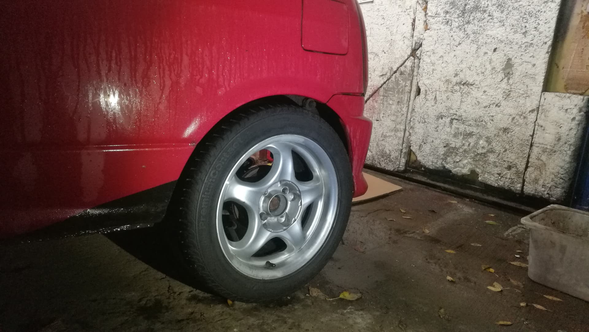

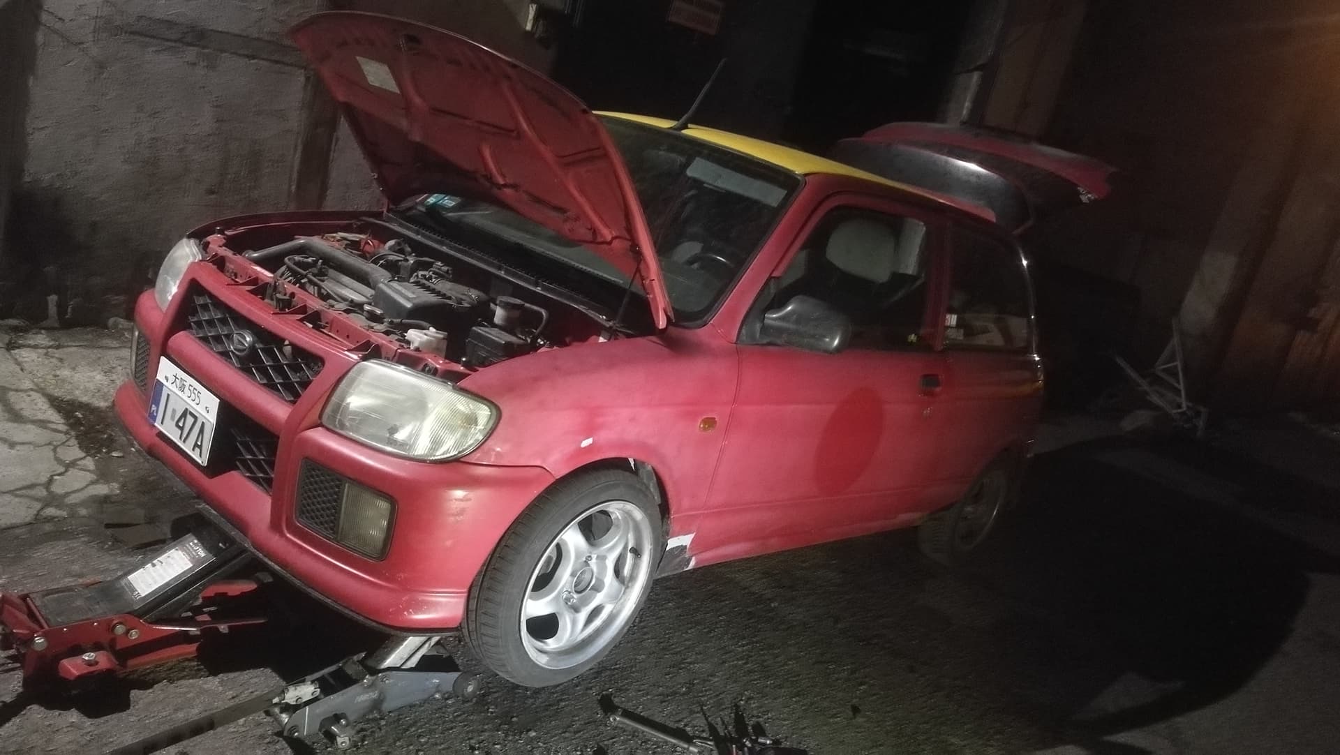

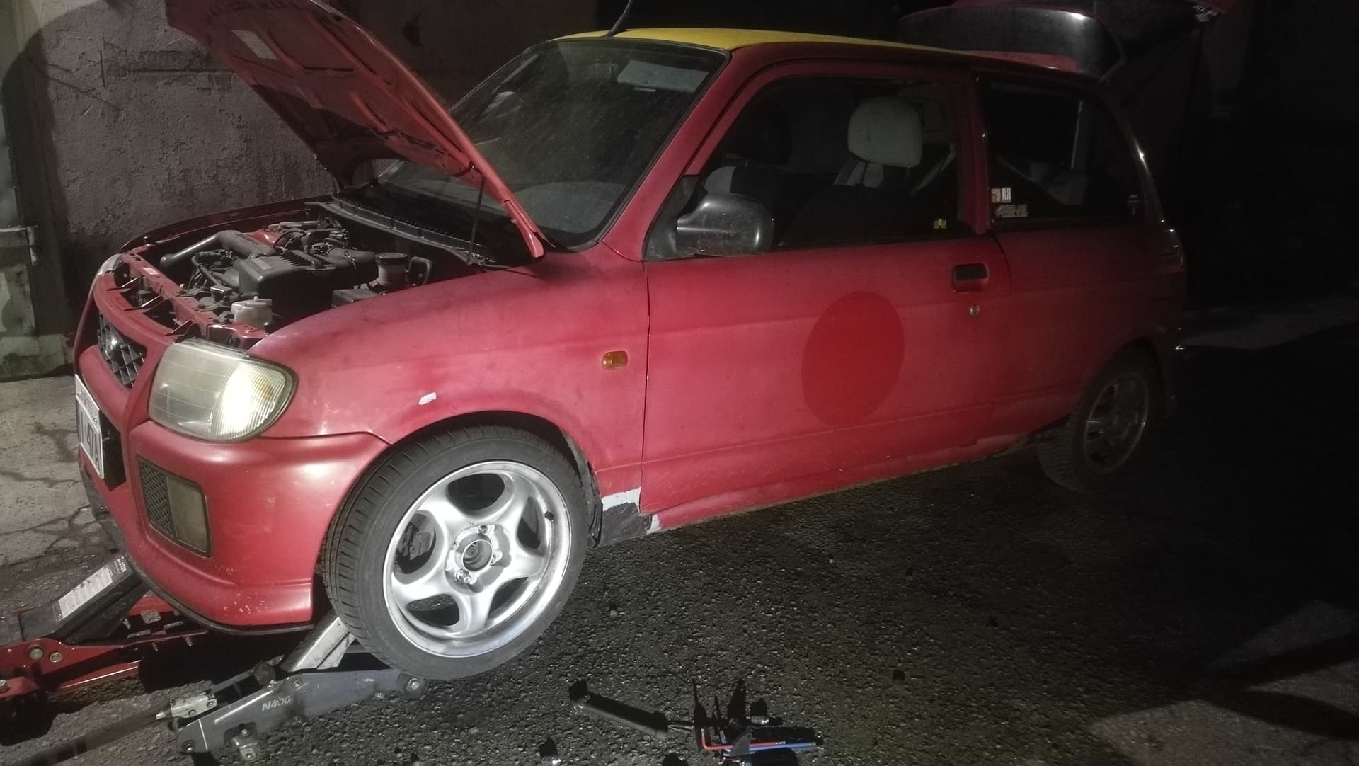

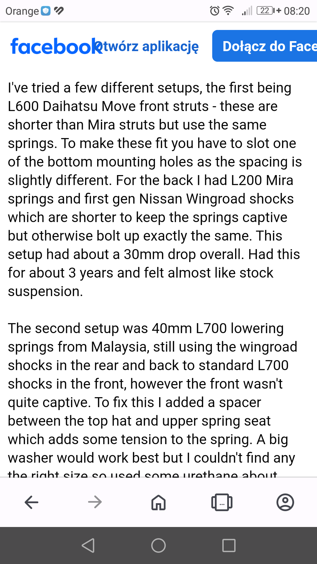

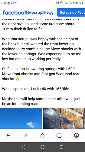

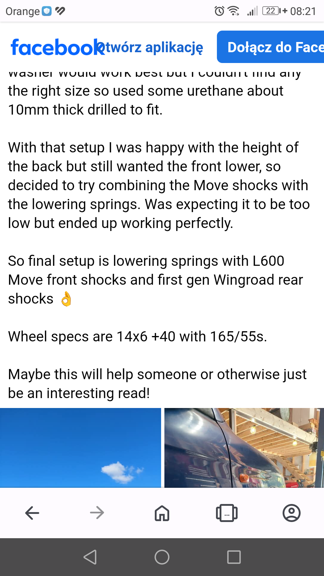

First up, rear lows made today. Thinking about sumarised L700 “lowering guide” with all info gathered so far. We had something like that at K11 MSC .uk, this info will be found by google, facebook posts- not so much…

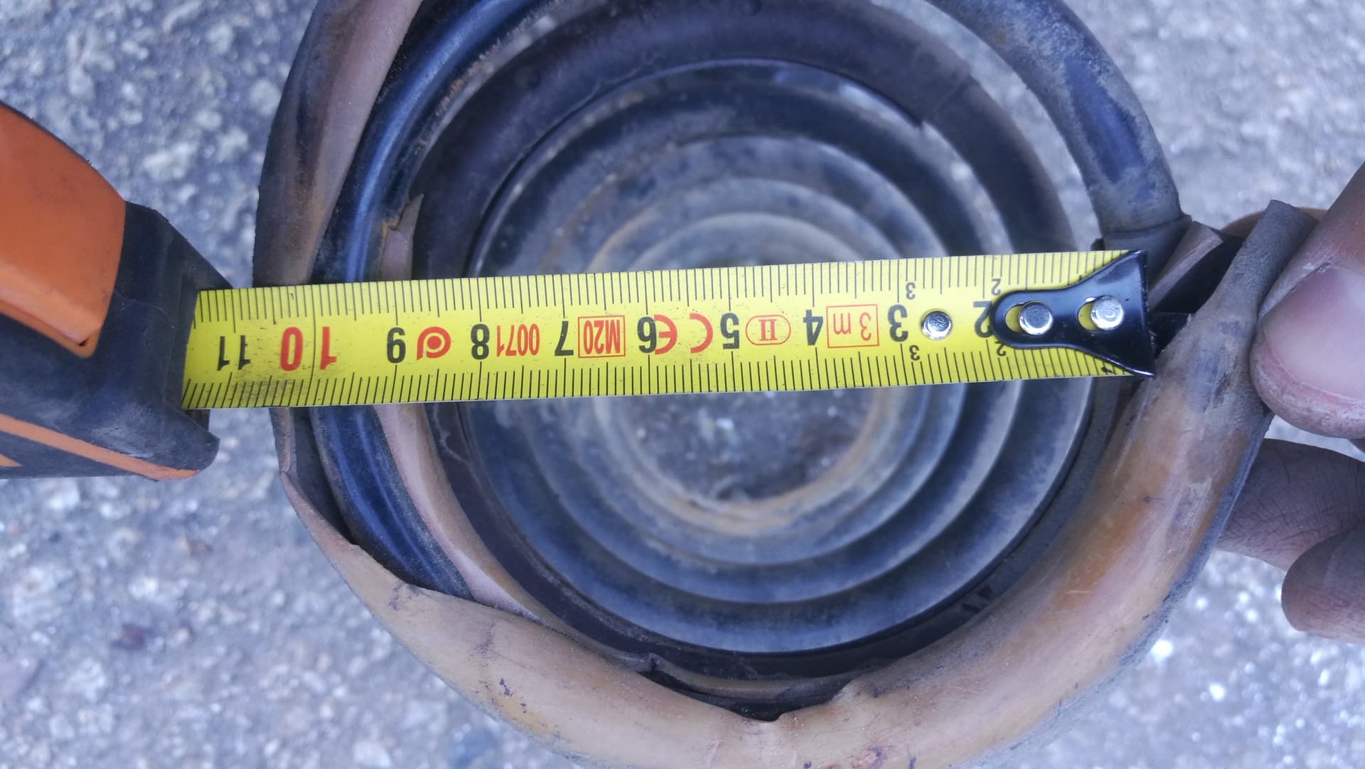

Okay it was done with 89-95 X2 Hyundai Excel (Pony in europe) shocks and trimed (about 2.5 coils) K11 rear spring. K11 should be a bit stiffer, but what scared me- this shocks are a bit to short. Sag is minimal, which is not ideal for me. Had hard times with too short shocks in K11. But test drive back home was promising.
But with final 15” wheels propably I need to swap for more firmly springs. Aims for mk1 focus , these were quite good in K11. Also similar diameter is confirmed.
L700 rears are 92-94mm in diameter FYI
K11 are about 91
X2 left, stock L700 right

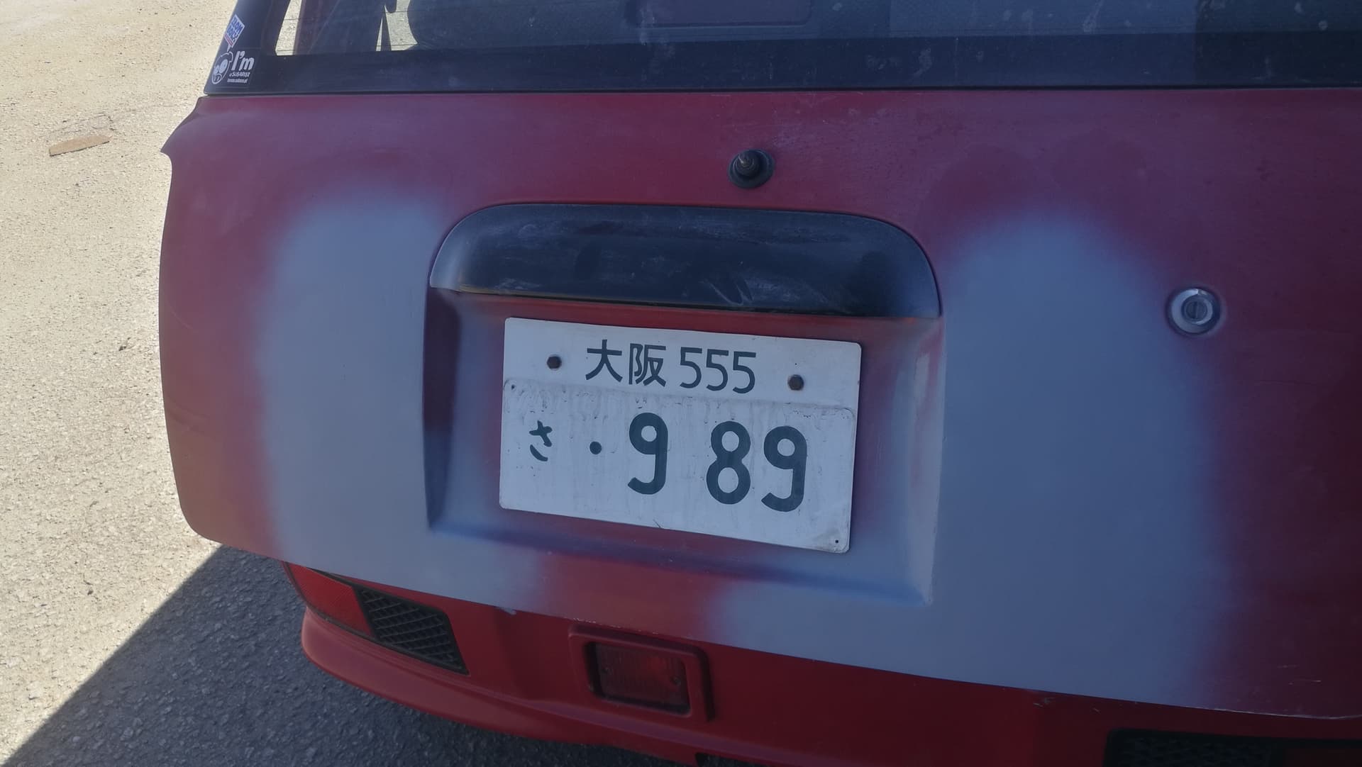

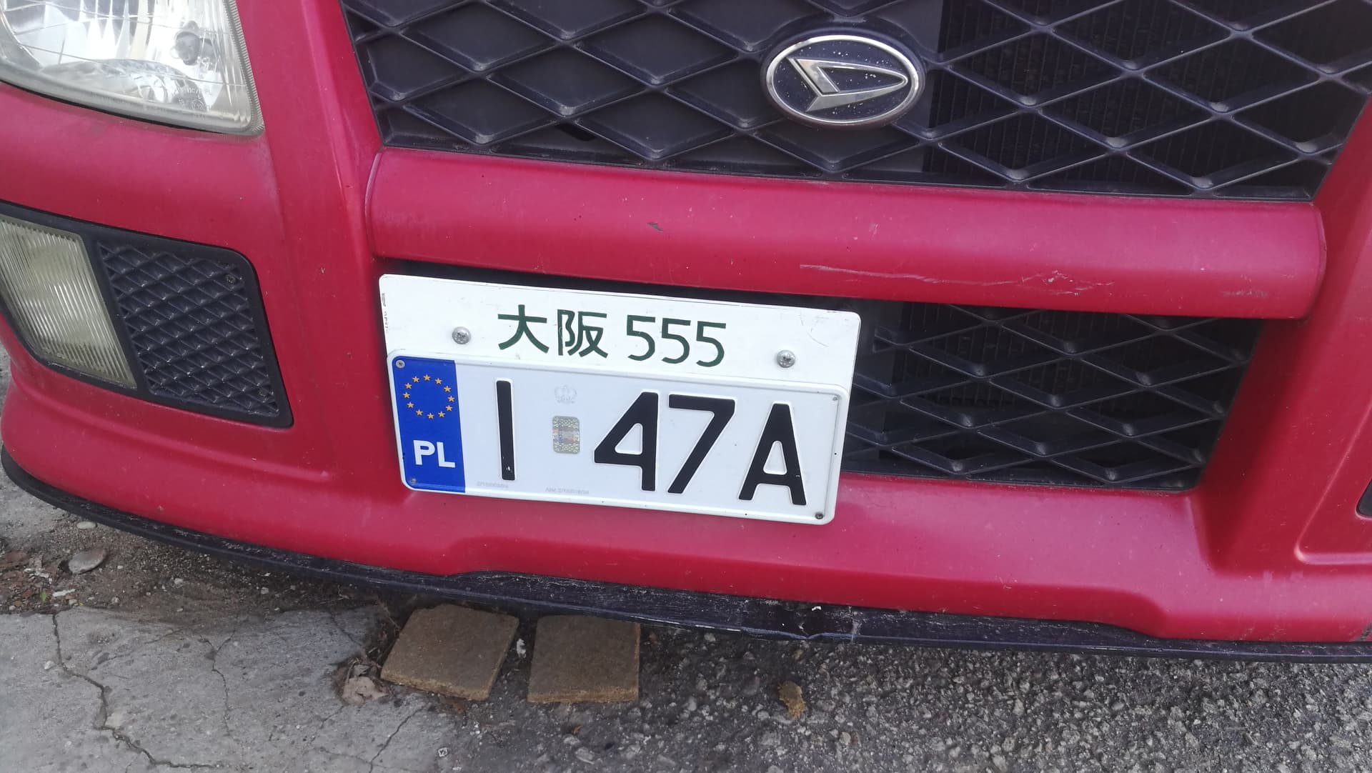

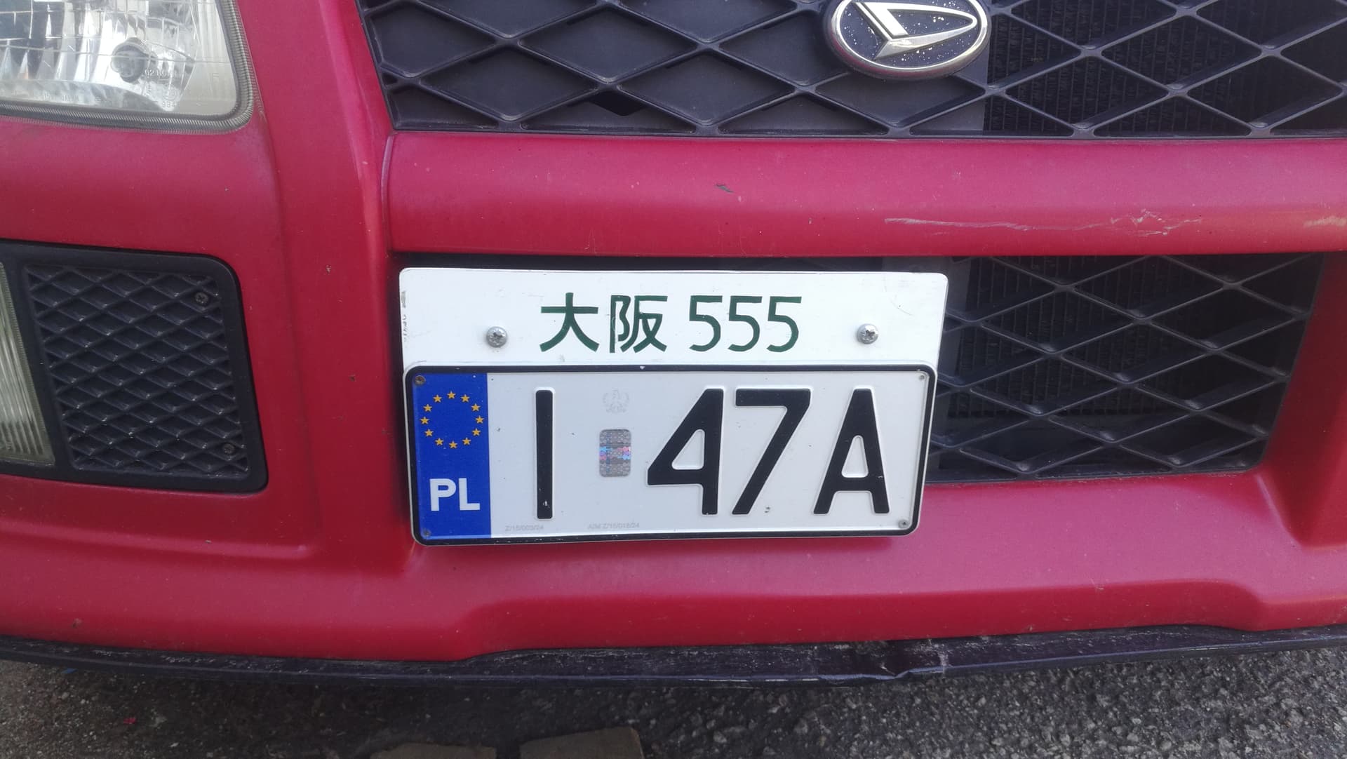

Last thing I’ve done within time limit was erasing black border from plates for better look with my “geek japanese plates frame”. It blends better without this
Before
After
Bonus: under polish plate theres full japanese plate with EJ-DE displacement matching numbers :smiling_face_with_sunglasses:
Osaka, go go go (hidden homage to mine subaru background) hiragana “sa” , •9 89
Also as seen- final filler sanding at hatch mod is in progress
See you soon!
very cool! thank you for doing the r&d on suspension, looking forward to the front setup and maybe copying it.
No problem salam, when I was fighting with micra the lack of precise info was big con. Also many info went to facebook, wich makes me soo angry, because asking google dont find these fb posts. When I post some technical data i trying to do this in the right way, to make this info searchable for another people.
You may also check “other car rear shocks” after bumpage

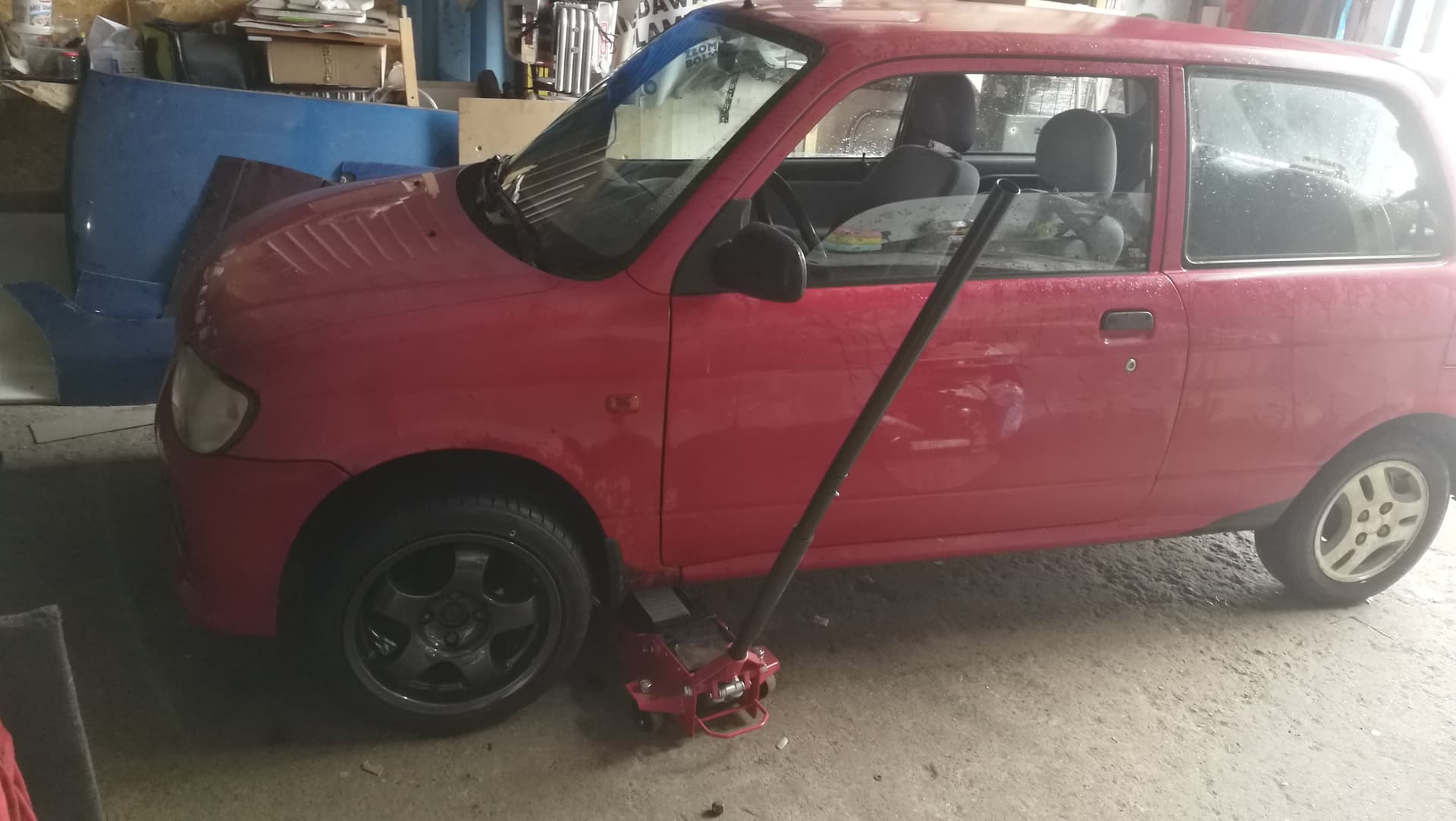

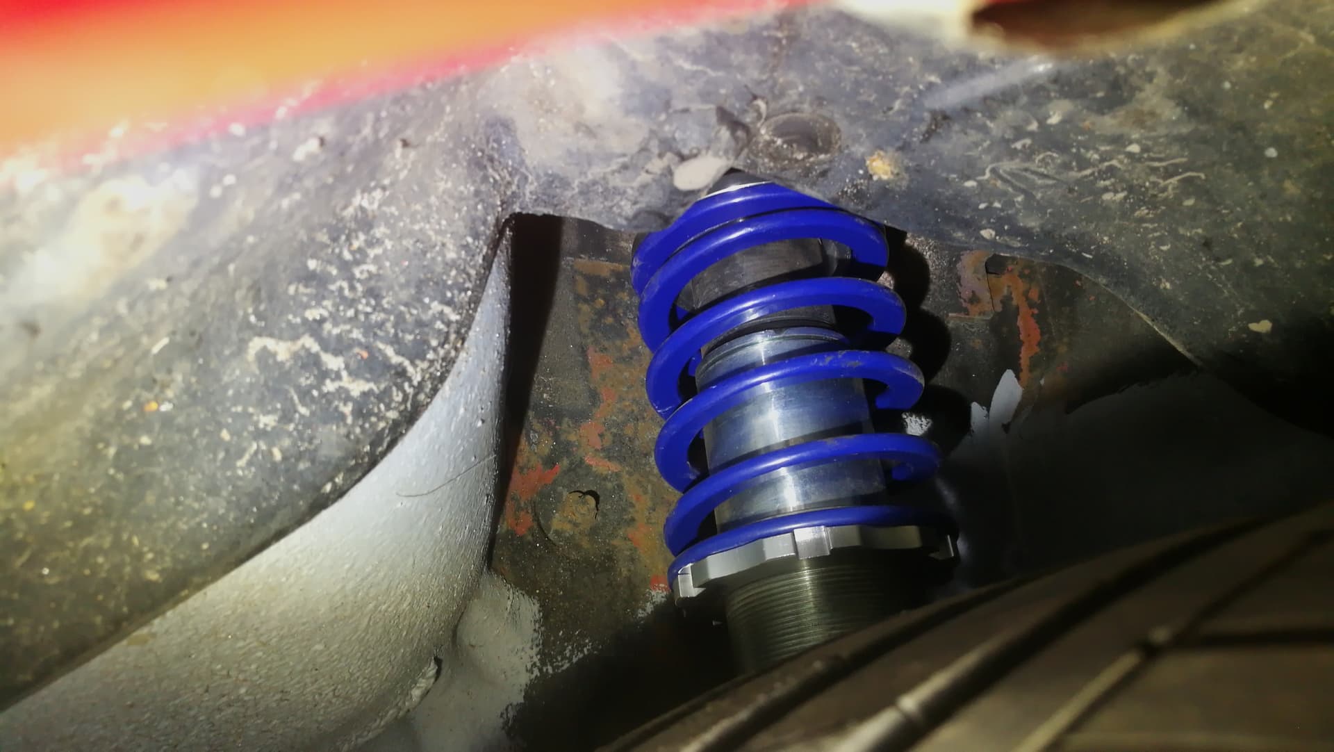

Okay, heh funny you mentioned this, because yesterday i finally gave up Polo 6N coilover setup.
In short- to archieve drop I needed, the shock will have 1cm of travel. And this travel will come from bumpstop :sweat_smile:
Heard stories about stance guys roling without springs, but thats not the way I want to follow :sweat_smile:
In my case the biggest obstacle is distance between inner wheel rim and shock pipe. I cannot use whole coilover tread lenght, because wheel rubs the spring. As seen at photo i need to have coilover adjuster rings above then tire. Its dont even need to be further investigate- lack of travel is end of the road for me.
Damn… I was so close…
Conclusion:
Polo 6n coilovers are for people who running stocks rims, wheel spacers or huge et rims and overfender
In my case only other way left with polos is to find top mount that allows shock top nut go furher, higher into engine bay. How to name it, flatter? Bmw topmount is quite tall, but whwn I compared with stock leg side by side, these almost identical…
Dont want to waste time with another topmount, bmw was at mine crossair since micra days, because it has solid ball bearing, compared to these loseball, flat bearings in plastic assembly in most small cars. Giving up.
Also wondering about cinquecento coilovers. This is the smallest car with aftermarket support here. But its finnancialy questionable when I dont have any measurements. Fiats may be same lenght as polos heh
Also corsa b was so short in K11, a bit regrets not taking any measurements during micra days…..
Thinking about stock legs mods, because i’ve found sirion m100 legs with whole brakes at wreckers auctions.
Here hows my thinking looks like:
-cento coilovers with questionable fit= 700zl
-sirion legs to mod with big brake kit= 400zl
For now- I dunno. Need to rethink. Stock legs idea comes after I foundnthis post:

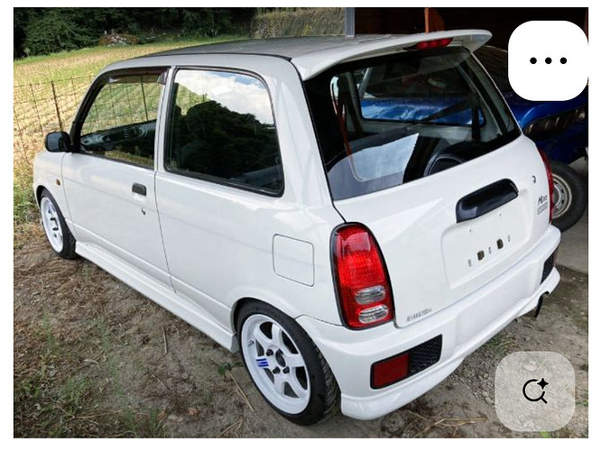

This bluey looks damn good! Its hardcto belive thats archieved with stock components and lovering springs. As you seen at mine photos, front needs to be droped about 100mm :weary_cat:
Oh btw, maybe camber plates are more shallow, need to go to ggogle. Looks like with flatten topmount about 20mm of drop can be gained
Edit: guys Ill thankful for any product/part code for these L600 move shocks, because this car doesnt exist here. Tried to find but minimal luck so far.
Magic of L600 legs comes from lower spring perch. Its a bit lower than L700.
