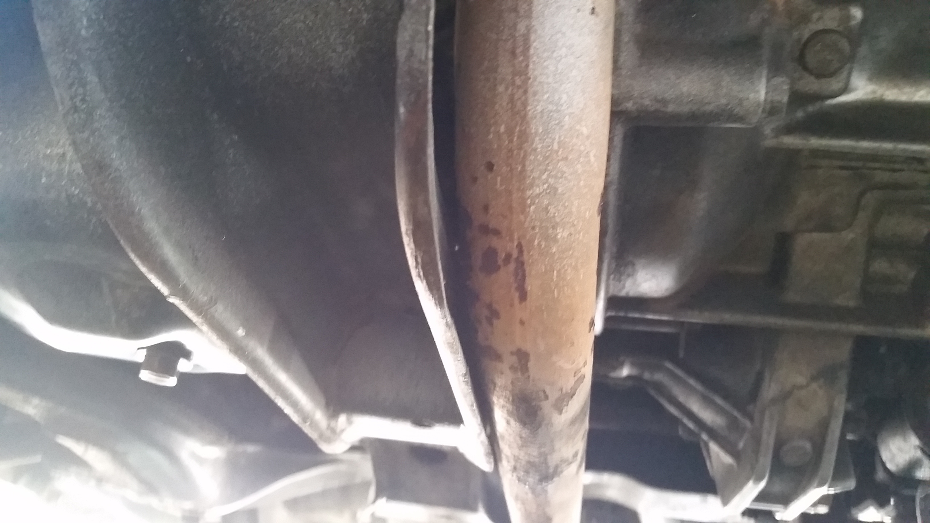

Exhaust needs to be modded as the EJ manifold sits a fraction too far to drivers side, it does bolt up but then will hit on the engine crossmember, mine does anyways :frowning:

Exhaust i can put up with till i get one made .
