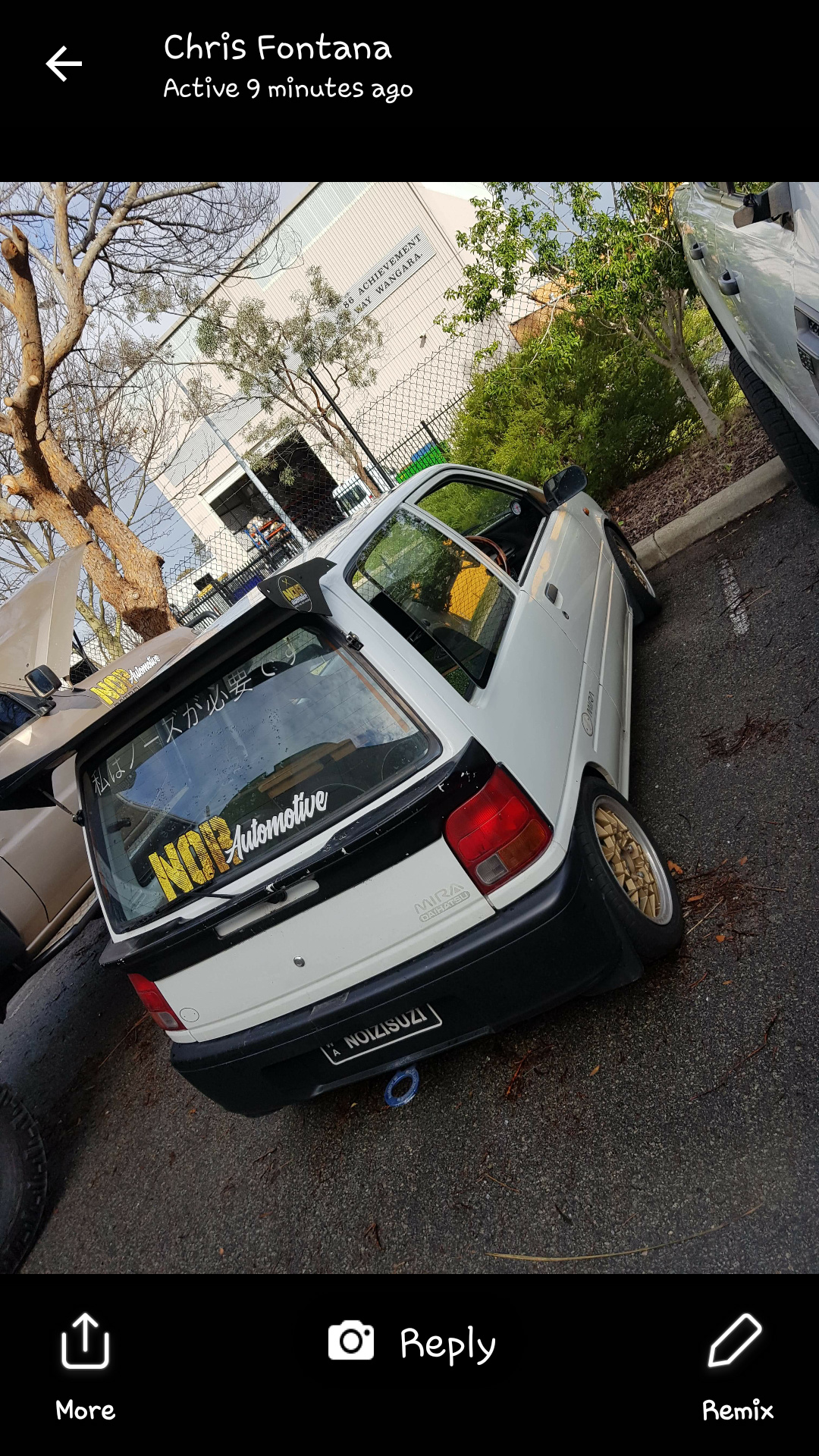

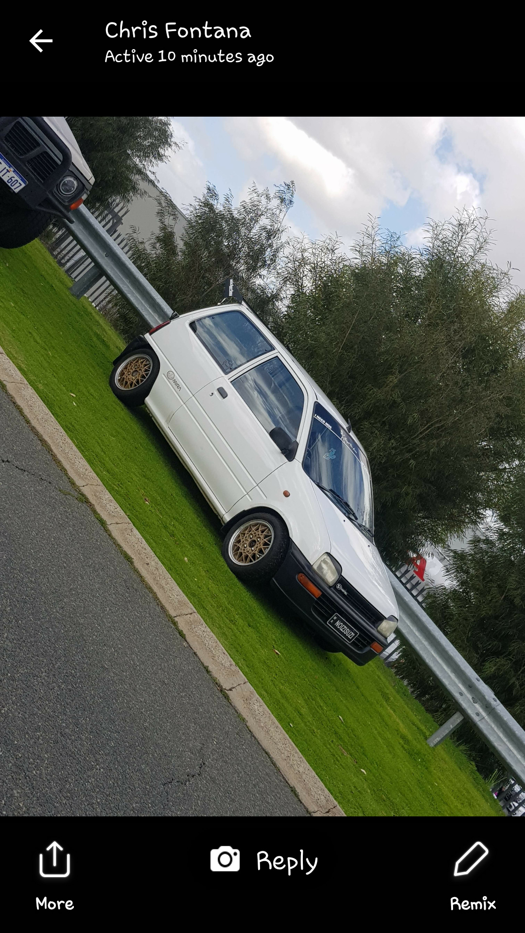

Weclome. Have a look through my build thread as there is a little info there and pictures. Speaking of pictures, please share some images of what you are up to. Doing this will spark our interest a bit more, and as such, I think you’ll find extra help/advice will come your way. Try…
…for a start. Plus as Mokeman suggested the DIY and Tech section.
Great looking car. Not sure we have to many here in WA. A couple but not many. Let us know specifically for info needed for the EJ swap.
well so far I know the motor drops in and bolts to the gearbox.
is there any difference with the rad location?
are the drive shafts ok with that motor upgrade?
will the exhaust fit on no mod?
and what needs to be wired in using the ej ecu?
sure I might think of more later
