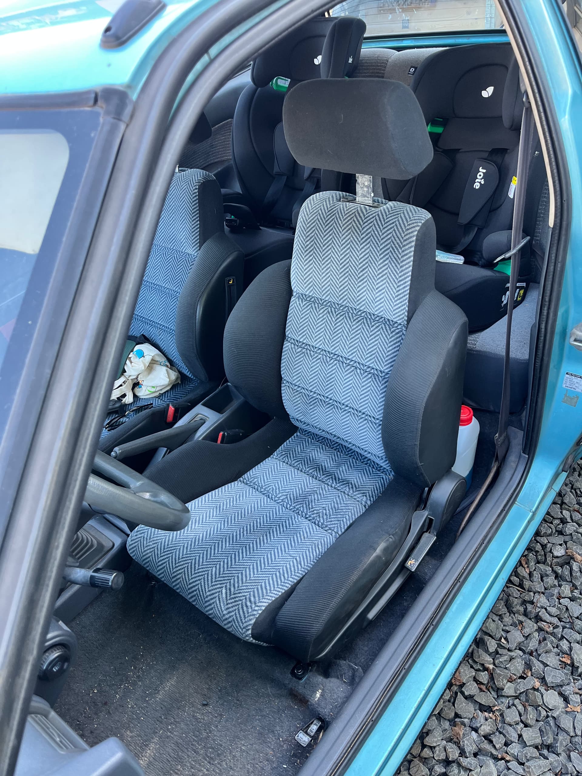

What are your spring rates? Find an lsd for the front. Add a solidly mounted seat that will hold you tight as and it should work with a six point harness. Get your driving position perfect. I would go as far a finding a quiker rack for the steering. Adapt hte car to your driving rather than trying to adapt to the car.

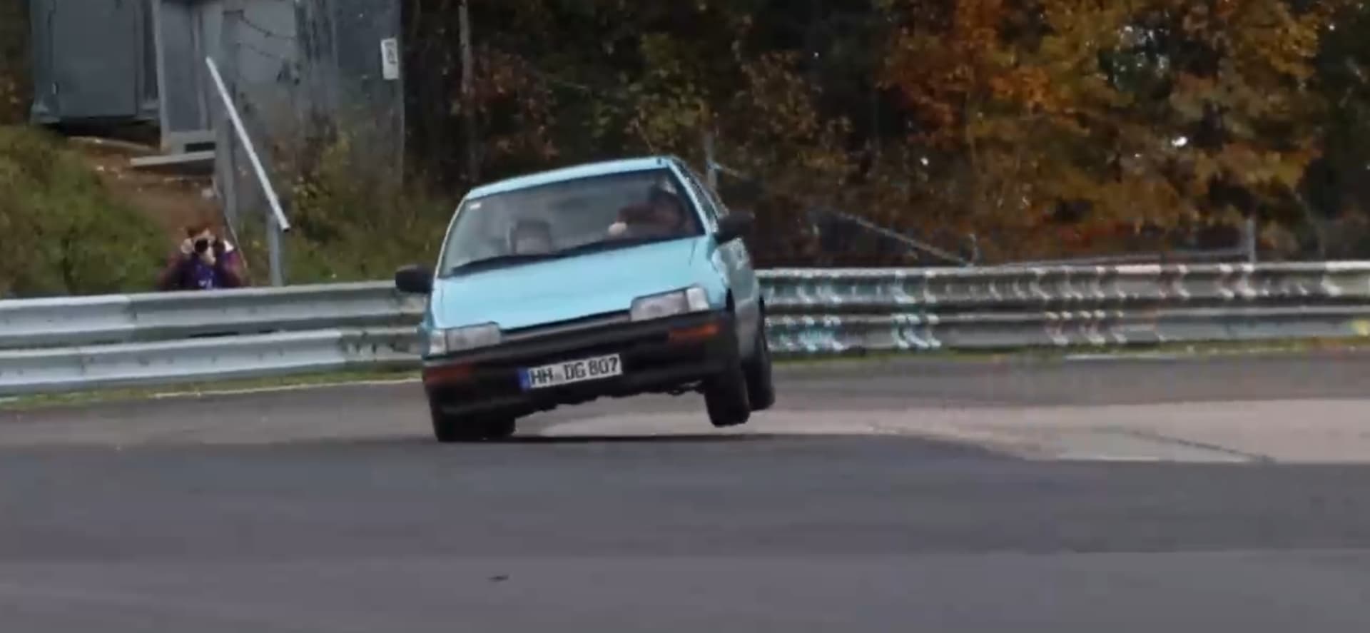

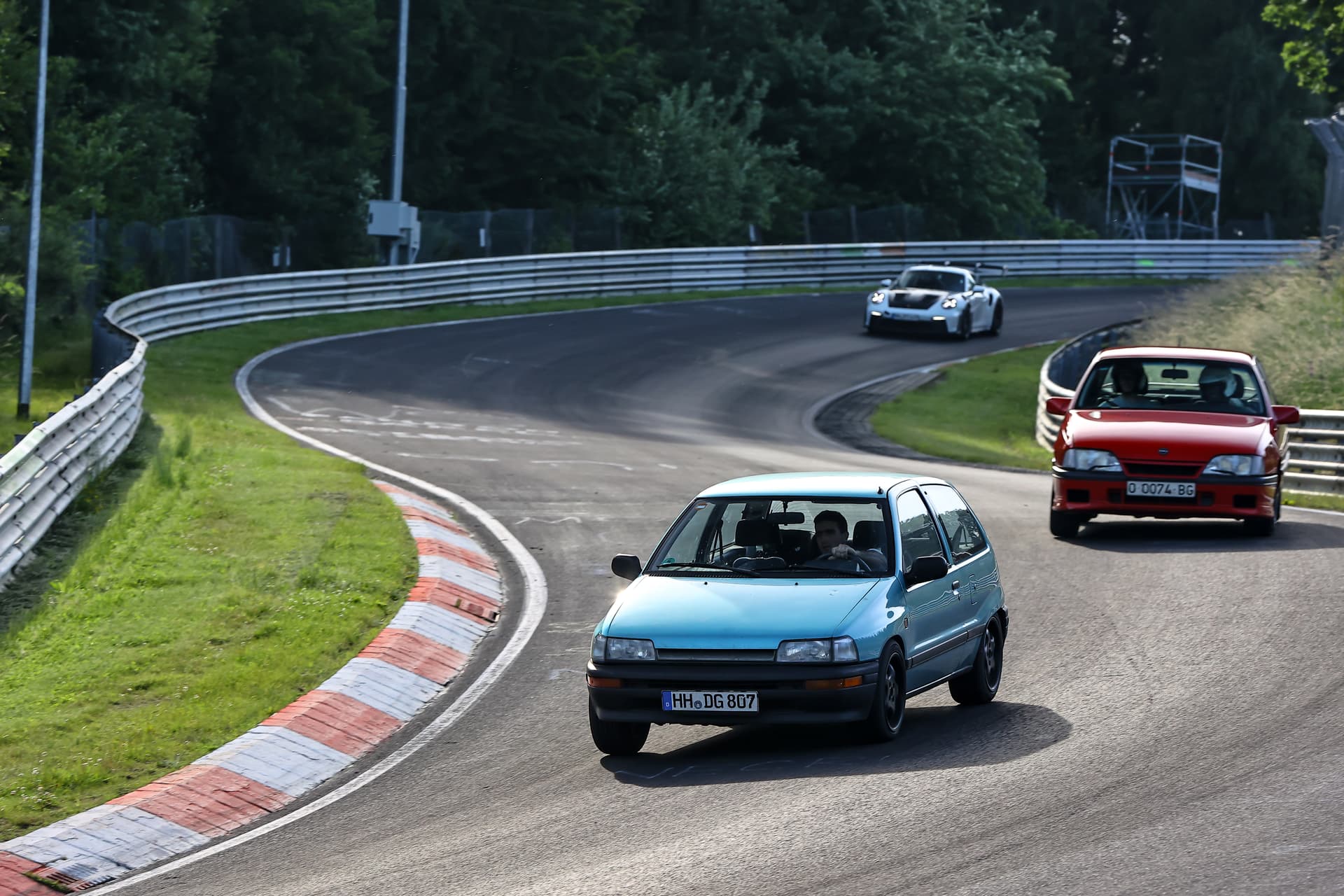

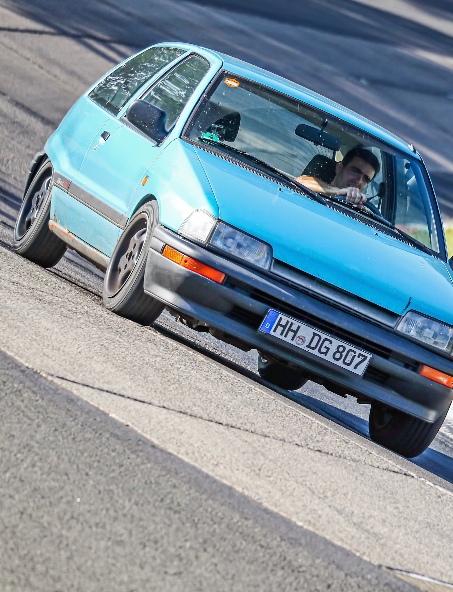

Ok, a year has passed. The Charade served as a really reliable all around car. I drove it almost every day to work (120 km daily) and 2 times on The Nürburgring, 13 laps in total. Everything with the very good 1.3 hc engine. No problems at all.
I managed to do on the first time on the ring a lap time of 10:05 on the only lap without yellow flag. The weather was perfect that time.

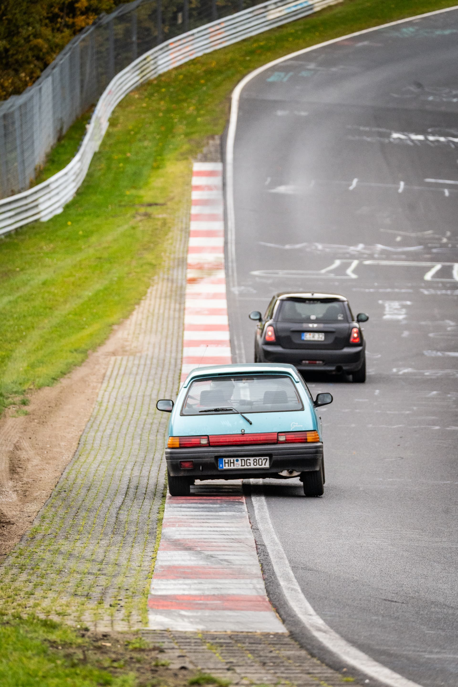

The second time was on the 26 of October with really bad weather, but after a few hours without rain I managed to do a time of 9:39 with 1 passenger in the car.

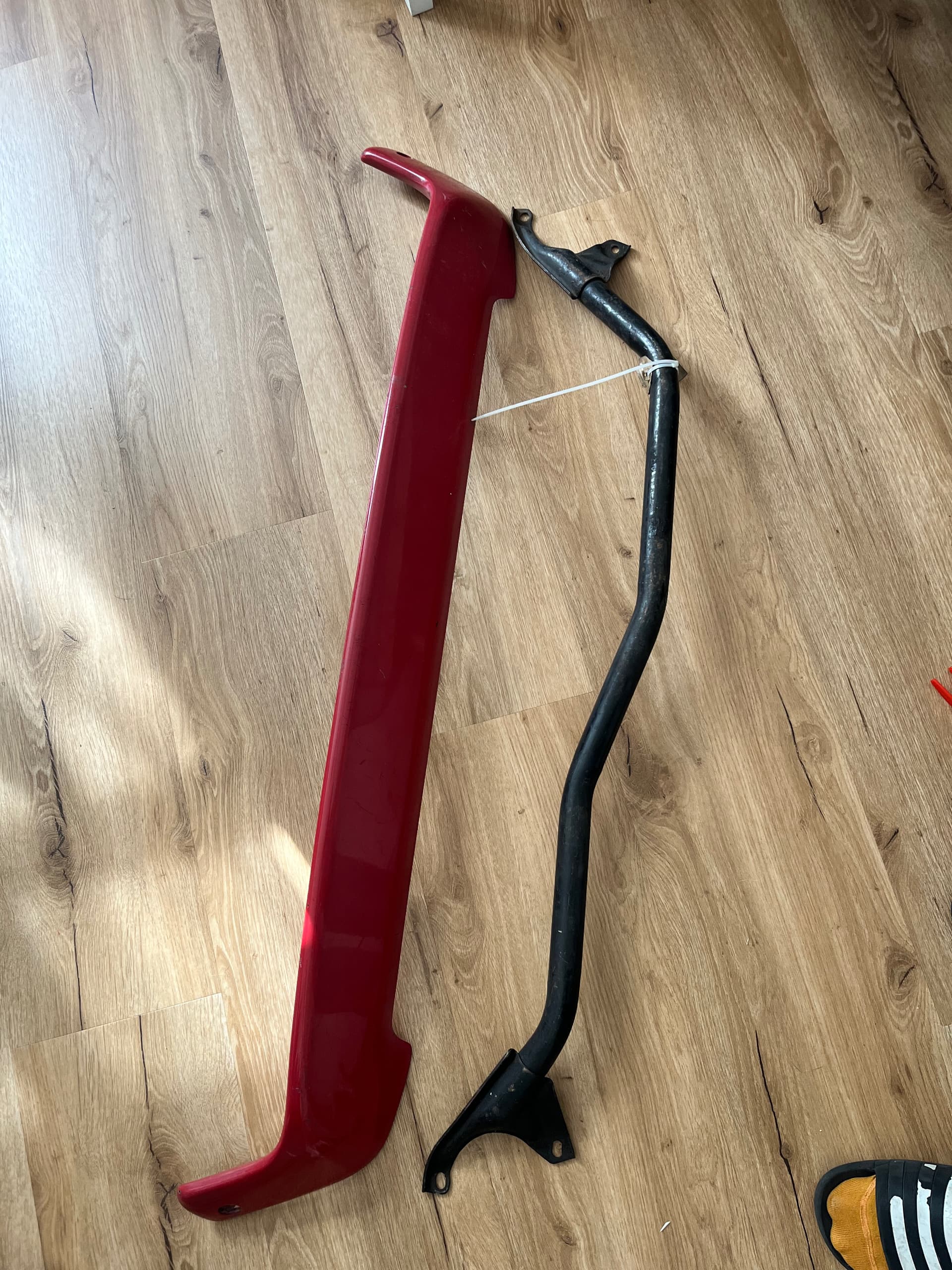

I also bought a strut bar and rear spoiler on my visit to england.
