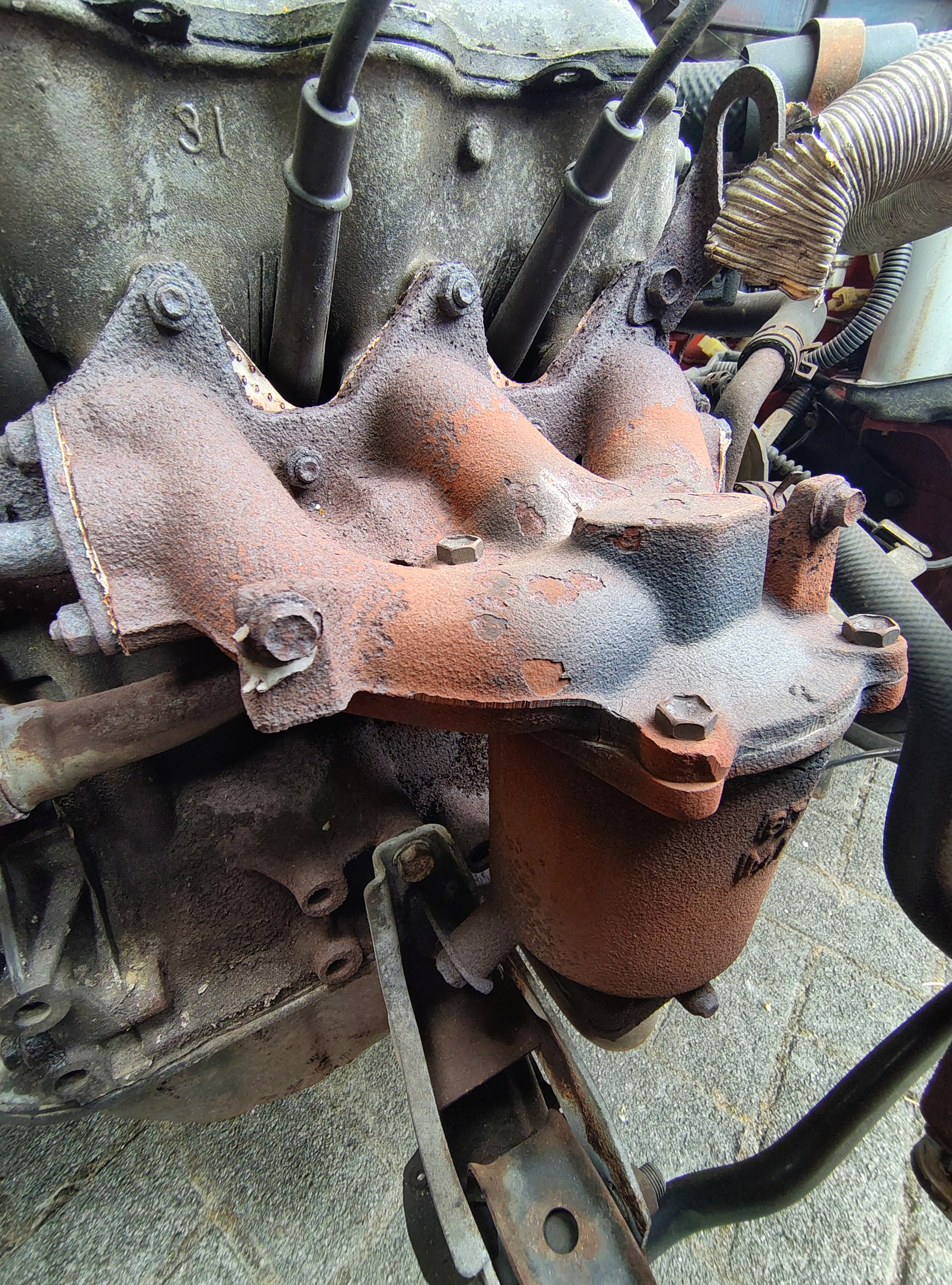

  2. I have this Exhaust manifold with what I guess is a thermostat attached to it which I cannot find anywhere. All the spare parts are different exhaust manifolds and I’m not sure if they’re “better” or if they’re compatible with my engine.

Hey mate Welcome to the forum. Thermostat is located in the cooling system. The big round barrel type thing is the catalytic converter.
