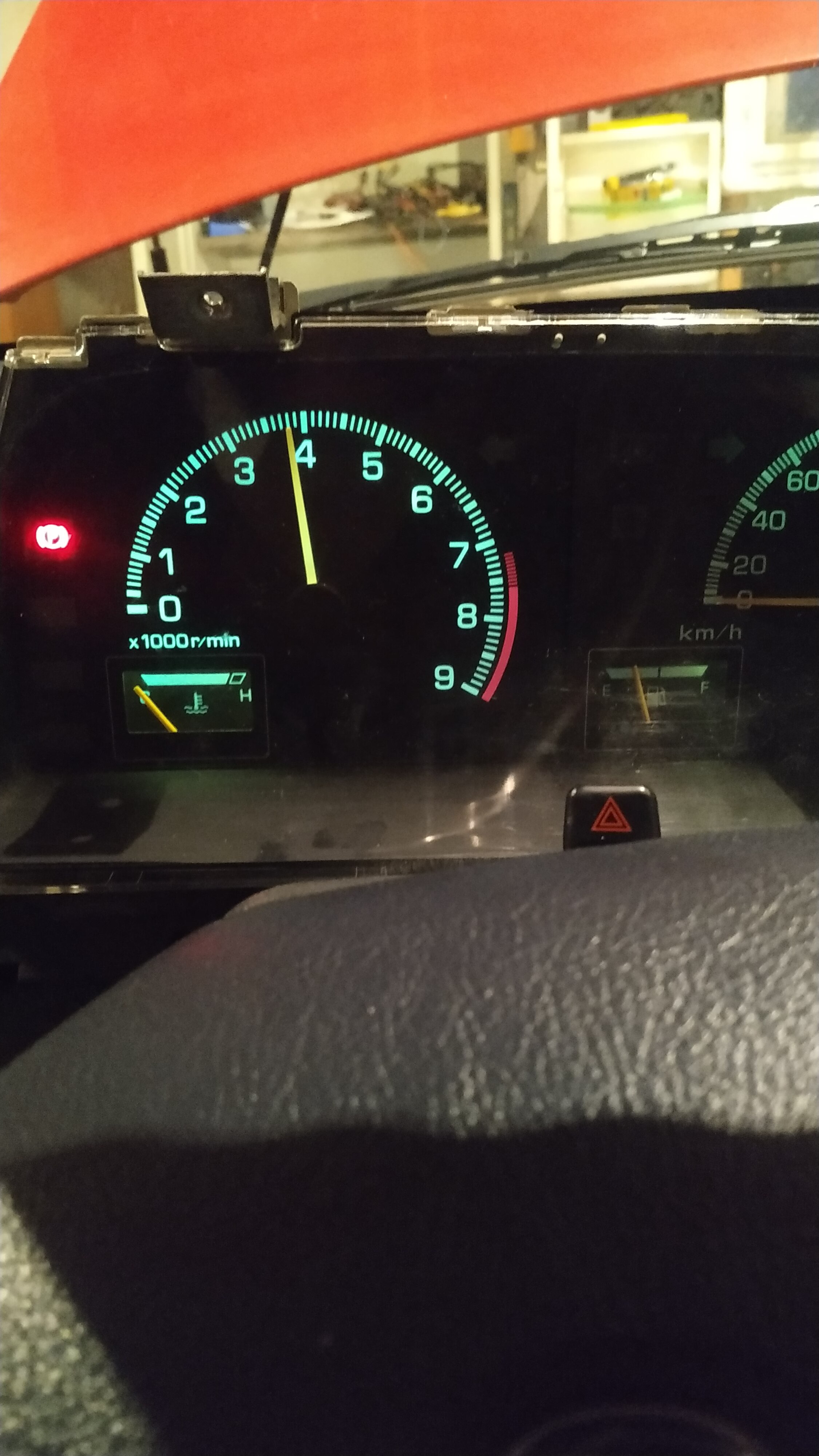

Hey guys , I just bought a Gtti tachometer to my CB23 carburetted charade , and everything works when I connect the cable to the dashboard (lights, speedo, turn signals) but the tacho shows 4000rpm when I turn the ignition on. And the same when I start the engine. Did somebody do the same ? I really want to have working tacho
looks like its a 4cyl tacho and not a 3cyl one would be my guess
No itβs a GTti tacho , 3cyl
It has turbo light too
