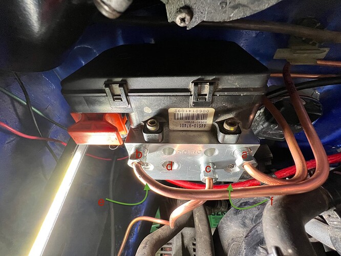

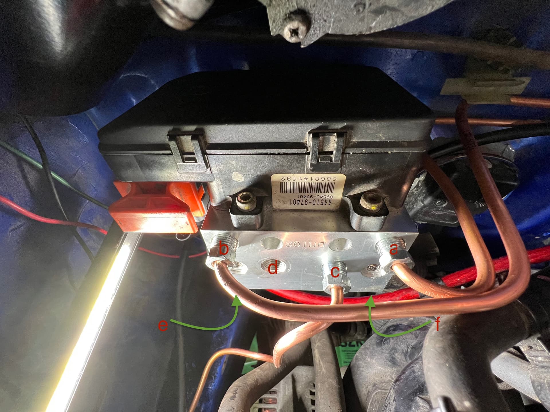

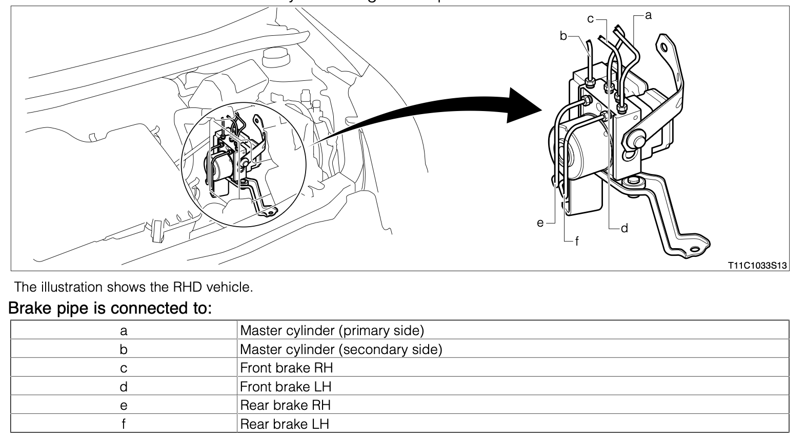

I have Daihatsu Cuore L700 where I swapped in k3-ve2 from Sirion m100. Currently I’m trying to figure out how to move ABS to get my tachometer working. I checked the workshop manual for Sirion m100 but the layout of the ports on abs unit is different than in reality(ports a,b are further away from e,f while c,d are closer to e,f) - I suspect the manual is not accurate.
Can somebody tell me what is the correct connection for the break pipes on sirion m100 ABS unit?
