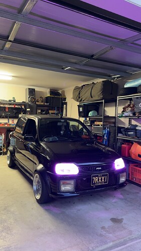

Back on the road after a 3 month saga. Finding a mechanic that would work on it was the toughest challenge. Then parts coming from overseas and arriving the wrong part. Little set backs here and there. Working fifo doesn’t heap never being home. But she’s back and pulling stronger than ever. I forgot how fun it was to drive.
Anyone on the Sunshine Coast keen for a cruise or meet send a msg
