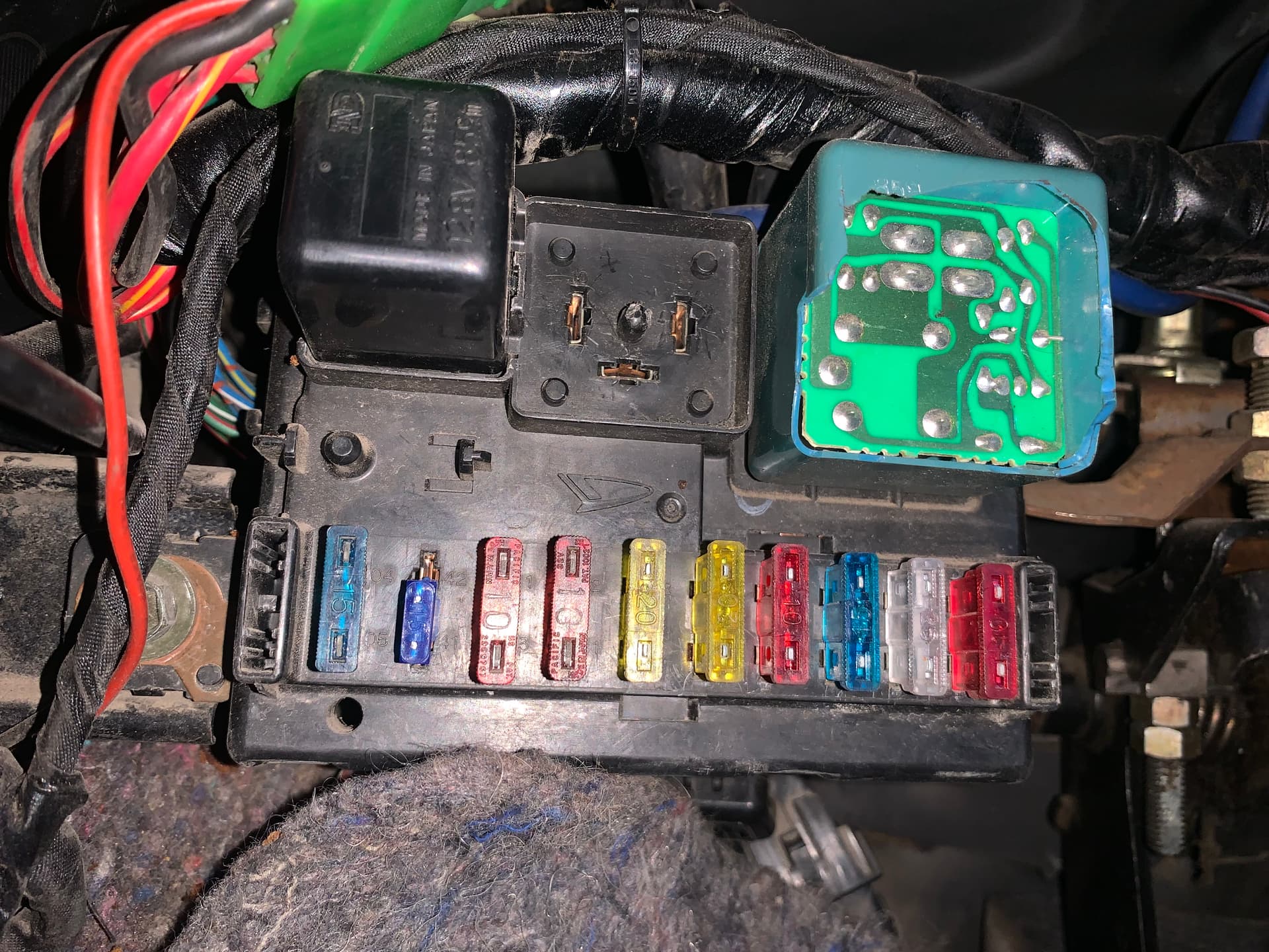

and we are having trouble with fixing high beams, when they are engaged headlights go either partially or completely dark. which relays should i put in fuse box on driver side? looks like its missing one 3-pin relay in the middle. and turn lights are going a bit too fast

A turning light blinking too fast is the result of either a burnt-out lightbulb or a poor connection to that bulb caused by corrosion at either the ground/earth connection or somewhere between the power source and the bulb’s socket.
If both headlamps dim simultaneously, either the relay’s secondary connection is hampered by corrosion or the relay’s points are burnt. The relay could get opened and the points inspected. A point file could restore function.
The missing relay could serve air conditioning. It isn’t unusual for a fuse box to contain accessory provisions which have been left inactive, being that it would cost production unnecessarilly to provide relays which will never be used
