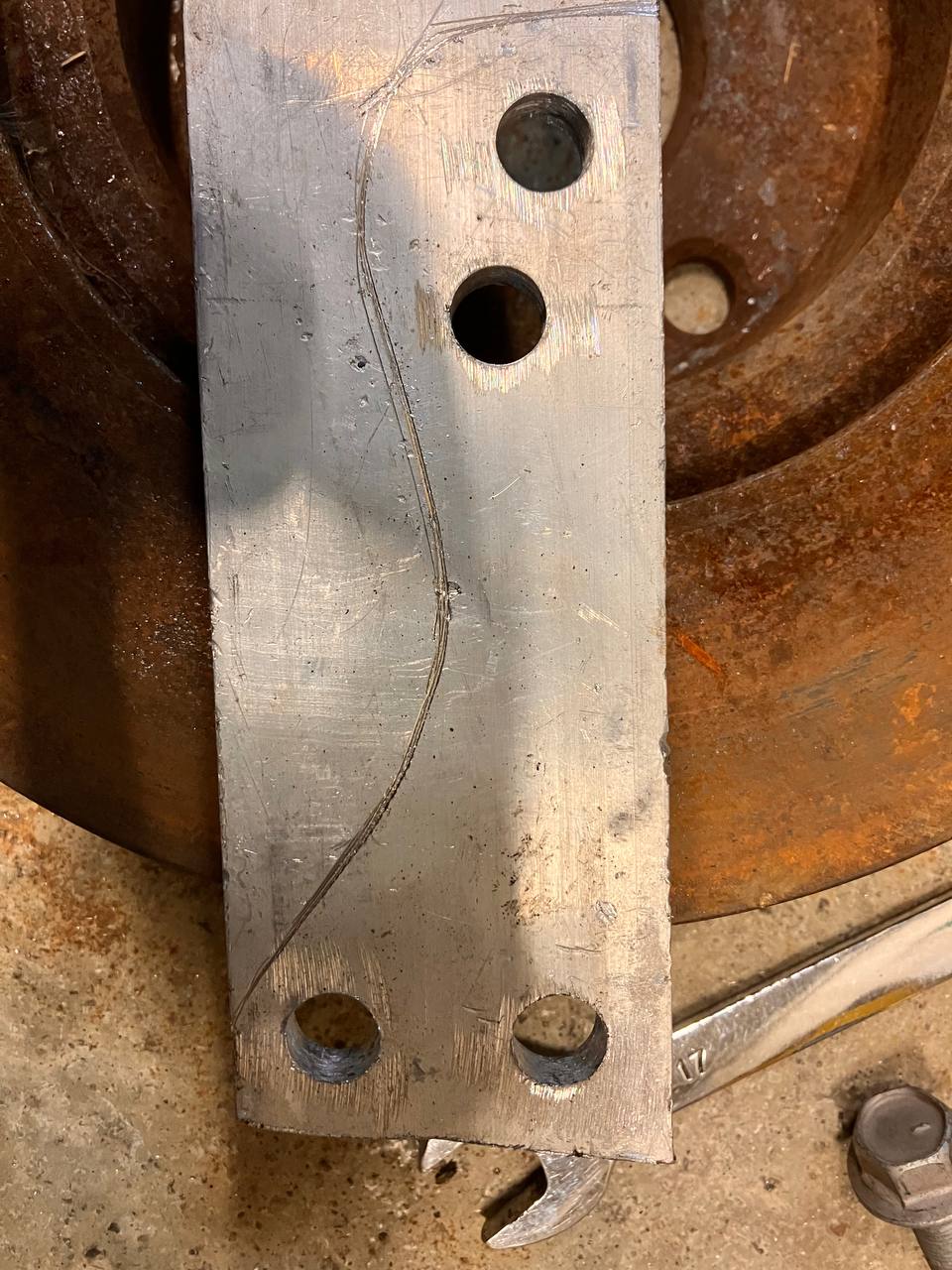

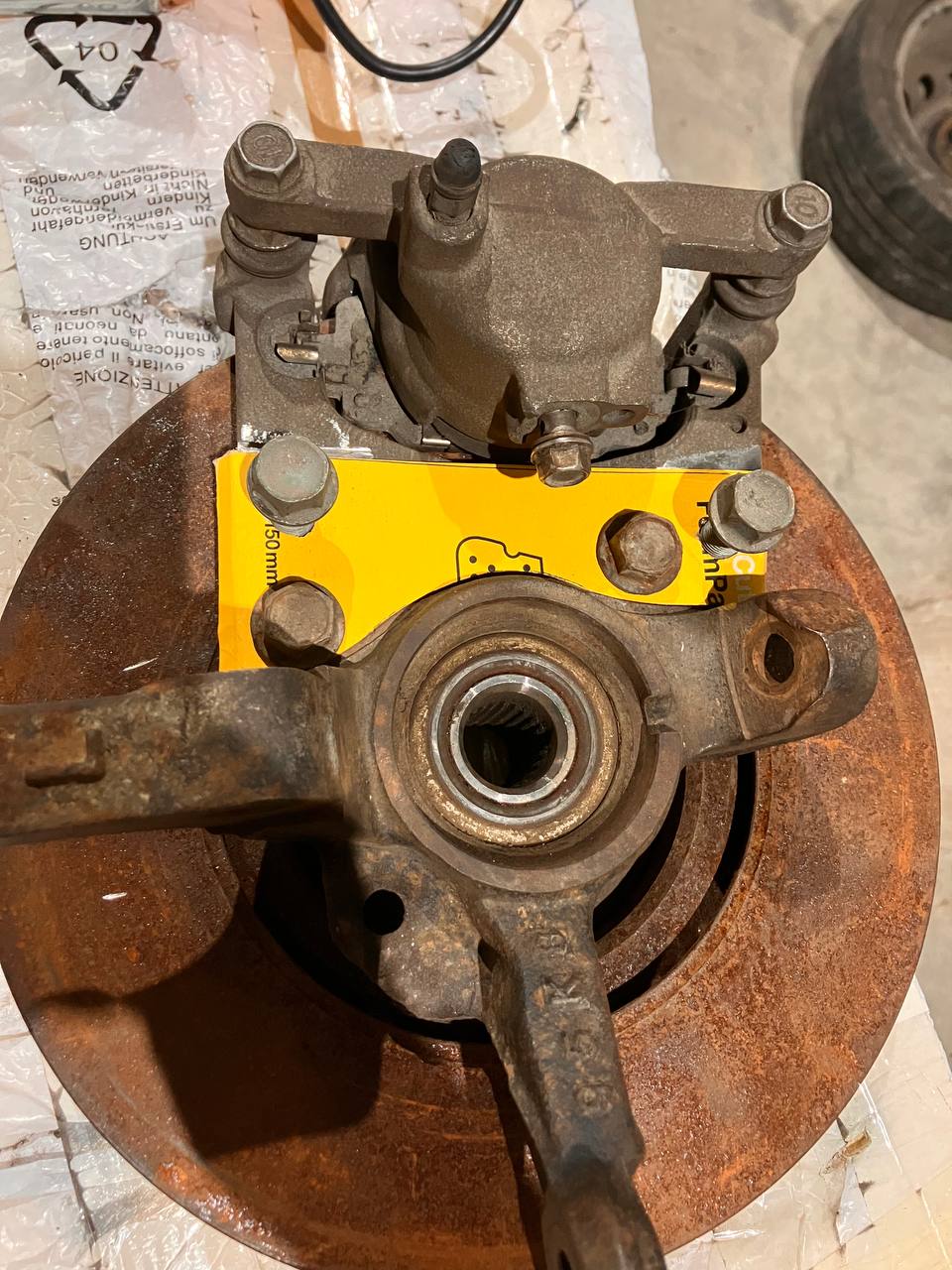

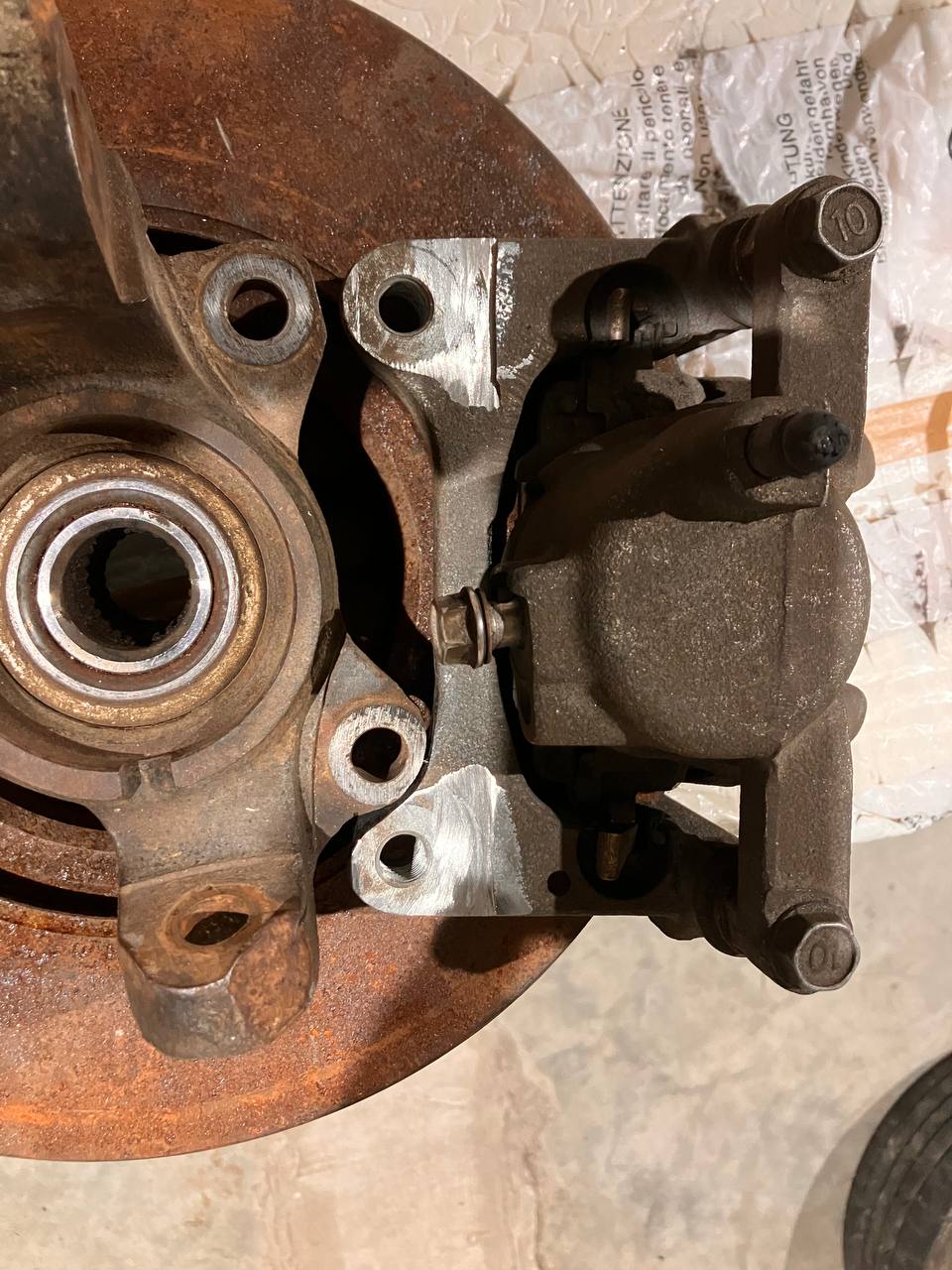

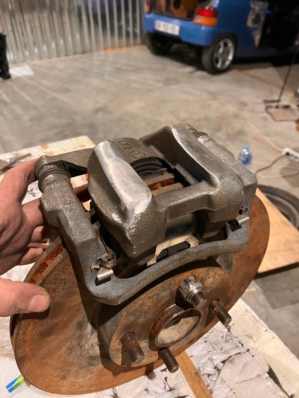

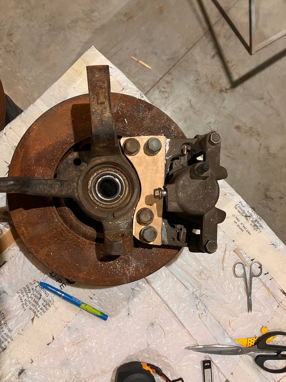

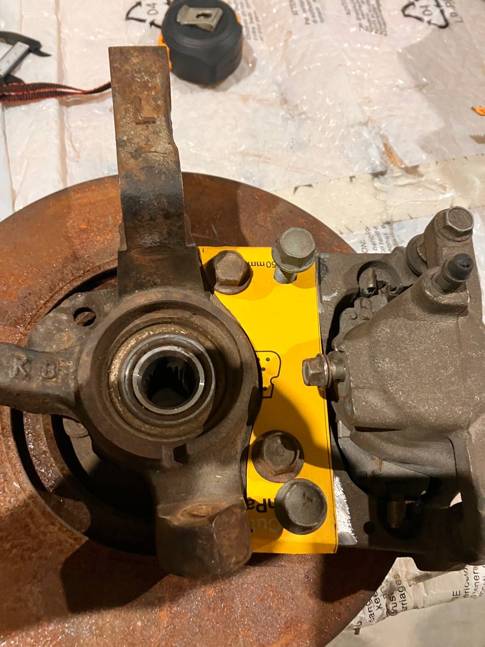

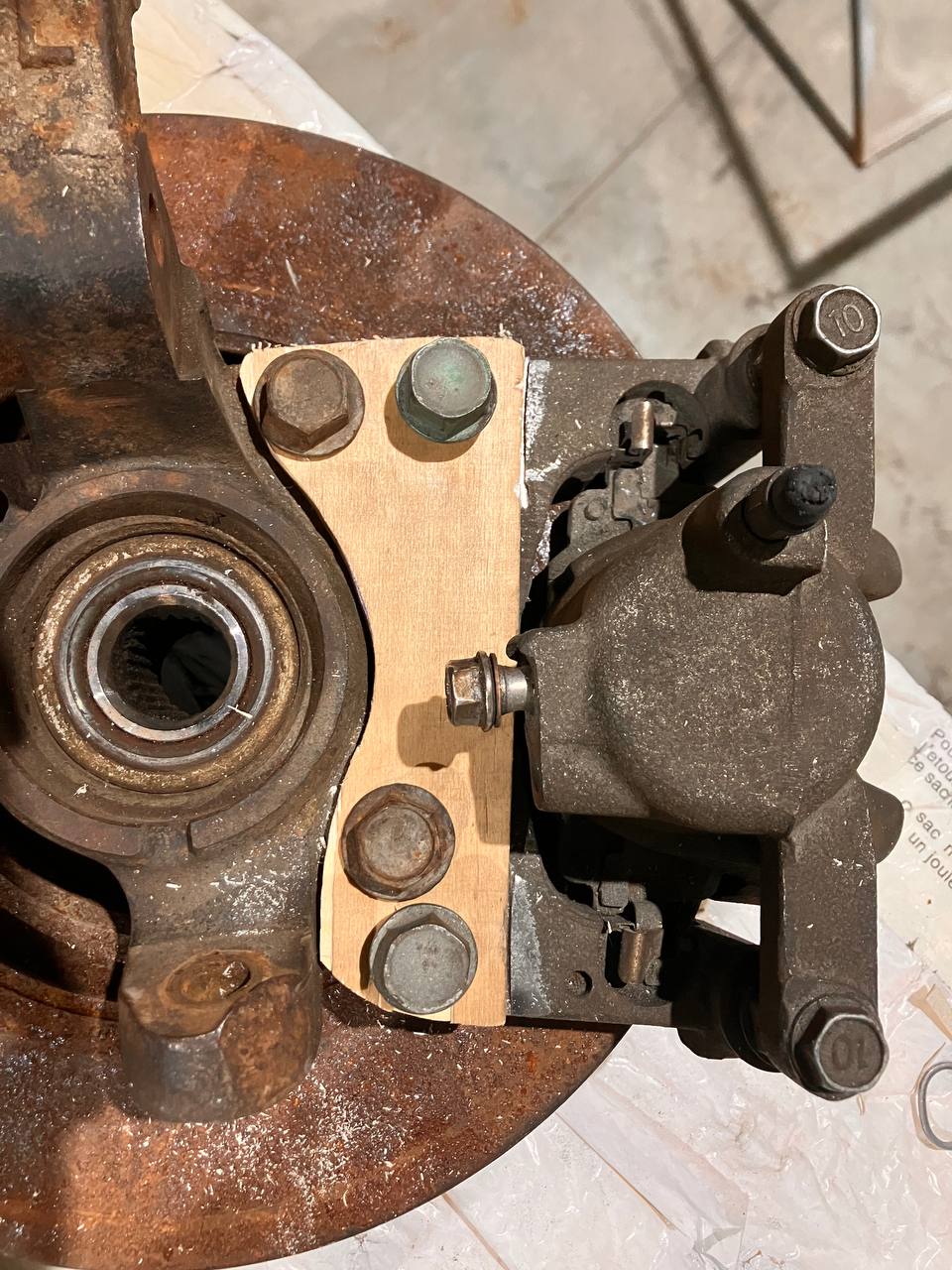

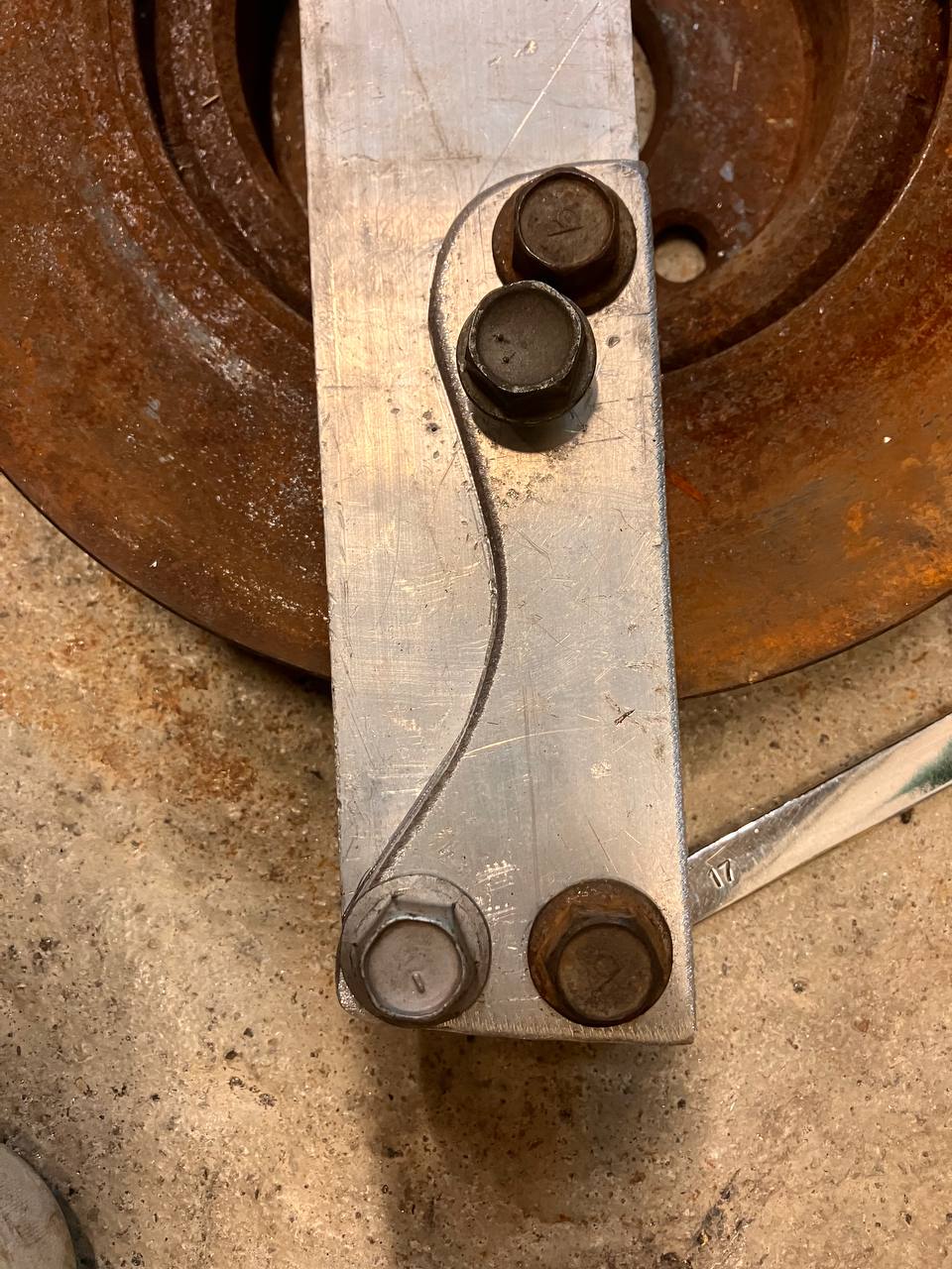

I’m desperately short on time to work on the car, but I’m slowly making progress toward my goal. Regarding the brakes, I plan to switch to L700 hubs and knuckles. Next, I’ll install fourth-generation Mazda MX-5 calipers and rotors using an adapter; I’ve already made some headway on this.
Unfortunately, the photos were uploaded out of order. (((
