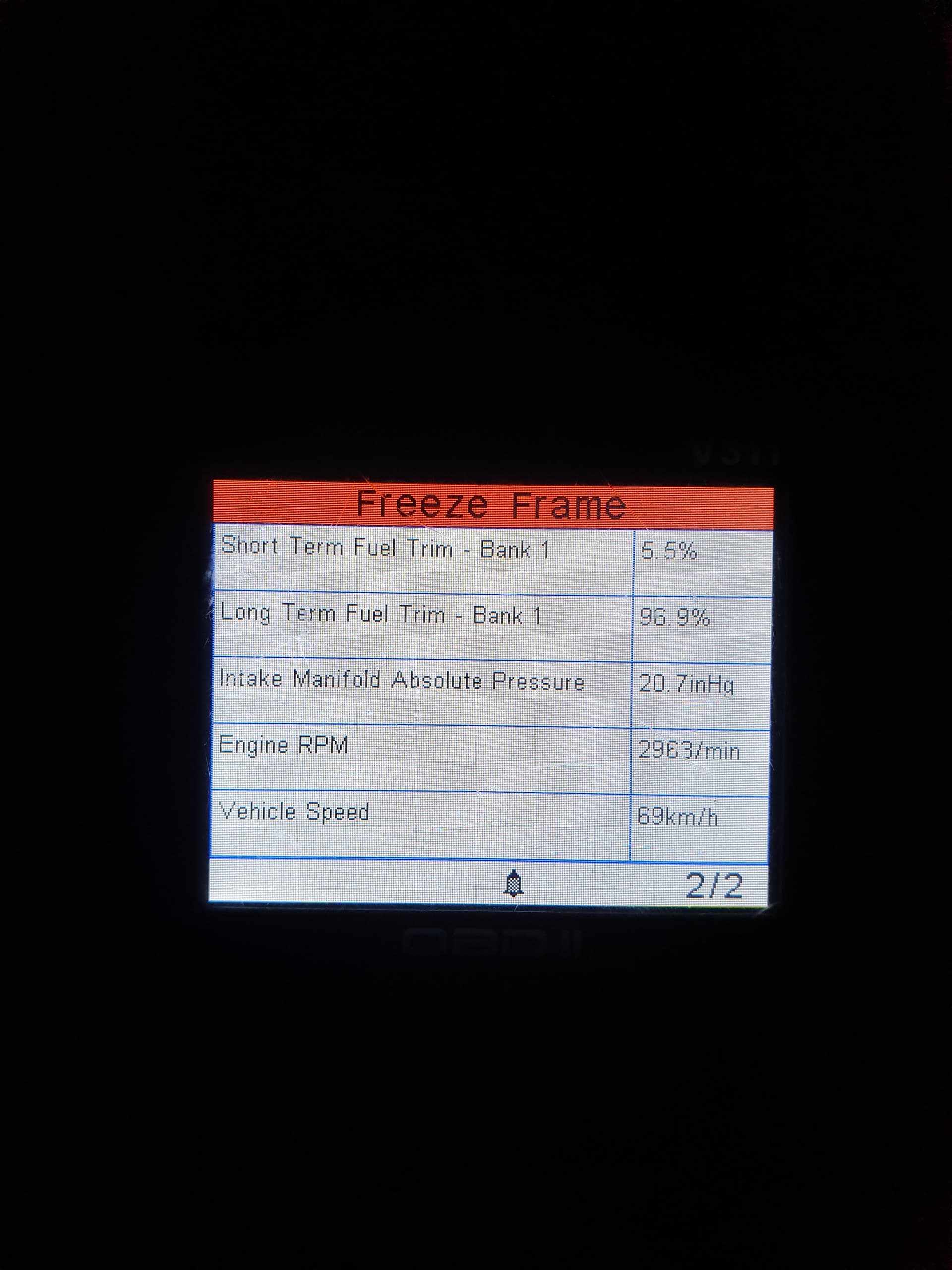

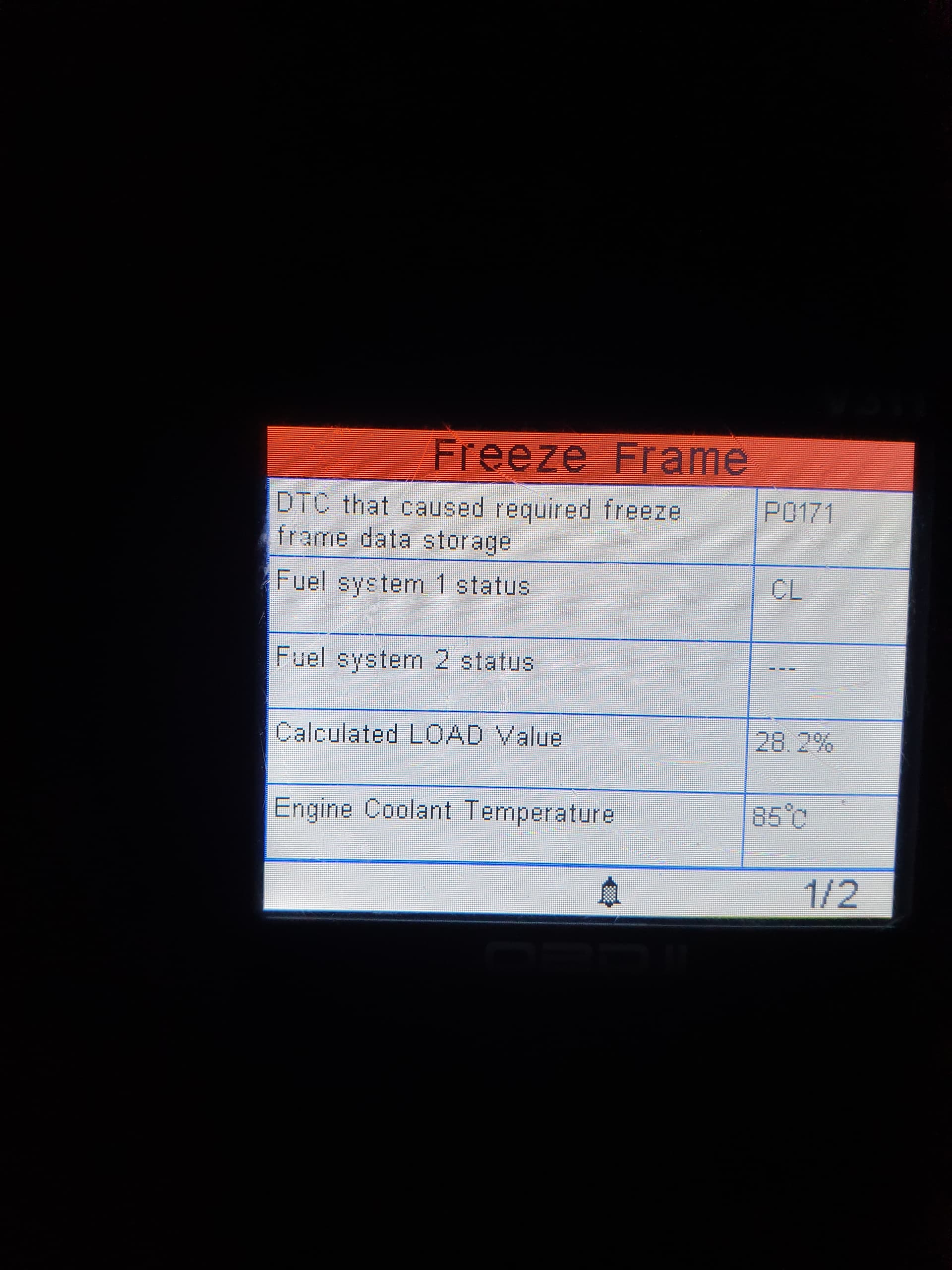

hi i would do that but im going to replace it any way with 4 speed its moore economical with the 4 speed now i have 5000 rpm at 120 km of speed it should drop with a 4 speed no i all so have chek engine licht and fault code p0171 cylinder bank 1 to lean i check the 2 oxcygen sensors in the exaust an tey are clean what could it be i all so check the map sensor and i cleand it just to be sure i dont know what is is broken maybe the catalytic cont verter need to be cleand or replace greets cis i chek for bad rubber hoses but so far i cant find it

You might have a vaccuum leak. If you spray a volatile fluid around tnumber 1’s intake runner tube,such as start spray, and the engine then starts to increase r.p.m., that’s where the leak originates

hi i cant find any leaks so far.the fault code p0171 is stil present i send some pic of my obd scan tool freese frame data
