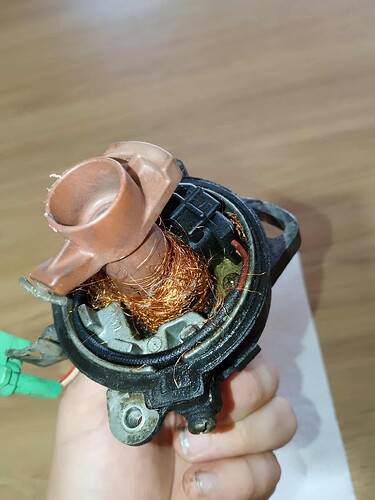

Replaced the distributor cause the old one decided to die in spectacular fashion (picture attached)
