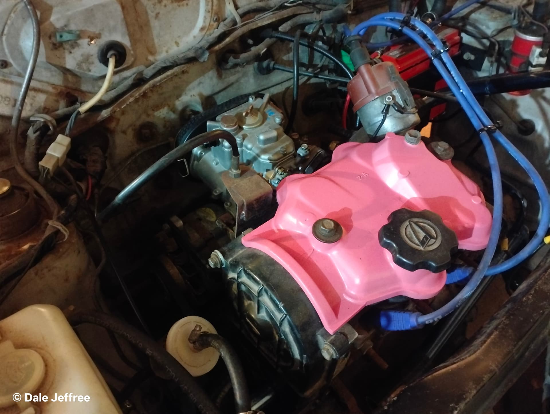

The alternator tension has been lengthened to suit the water pump delete, and also clear the inlet manifold.
The inlet manifold is finally bolted down properly.
The rocker cover has had the breather cut off and tapped to suit 1/4 NPT for a 90° brass fitting to connect to the air cleaner.
The water pump was removed to tighten the bumper bar brackets. Once it’s back in, the hoses will be clamped for the last time.

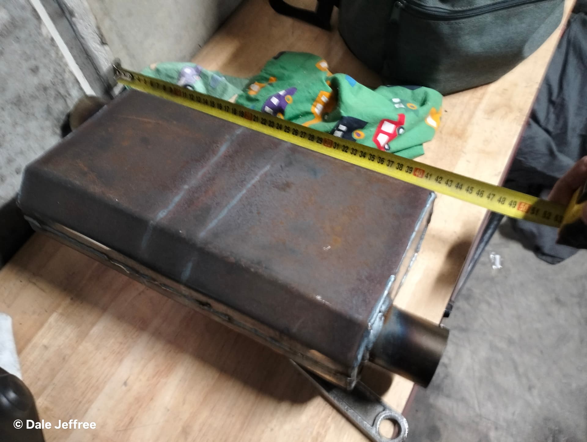

I made a new muffler for the Handivan. I’m going to build a new exhaust, and fit the radiator with new mounting tabs to be welded on.
there is witchcraft and magic in there :slight_smile:

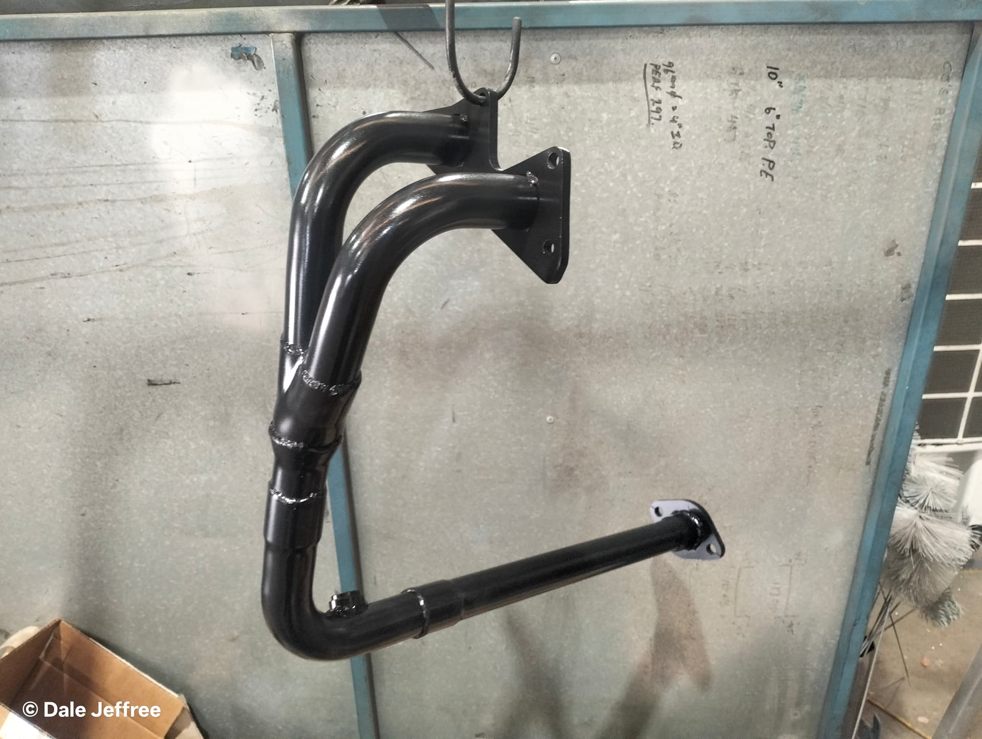

The headers have been finished and now connect to the exhaust.

Headers are completed, the clear ceramic coat will cure by Friday. Seeing as the car won’t be started for a while, I’ll be safe to install them beforehand.
They look wonderful!
what size piping did you use?
35 mm (1-3/8") is right on the money for AB 550 AD 620 and CB 993. Pipes merge into 38 (1-1/2").
