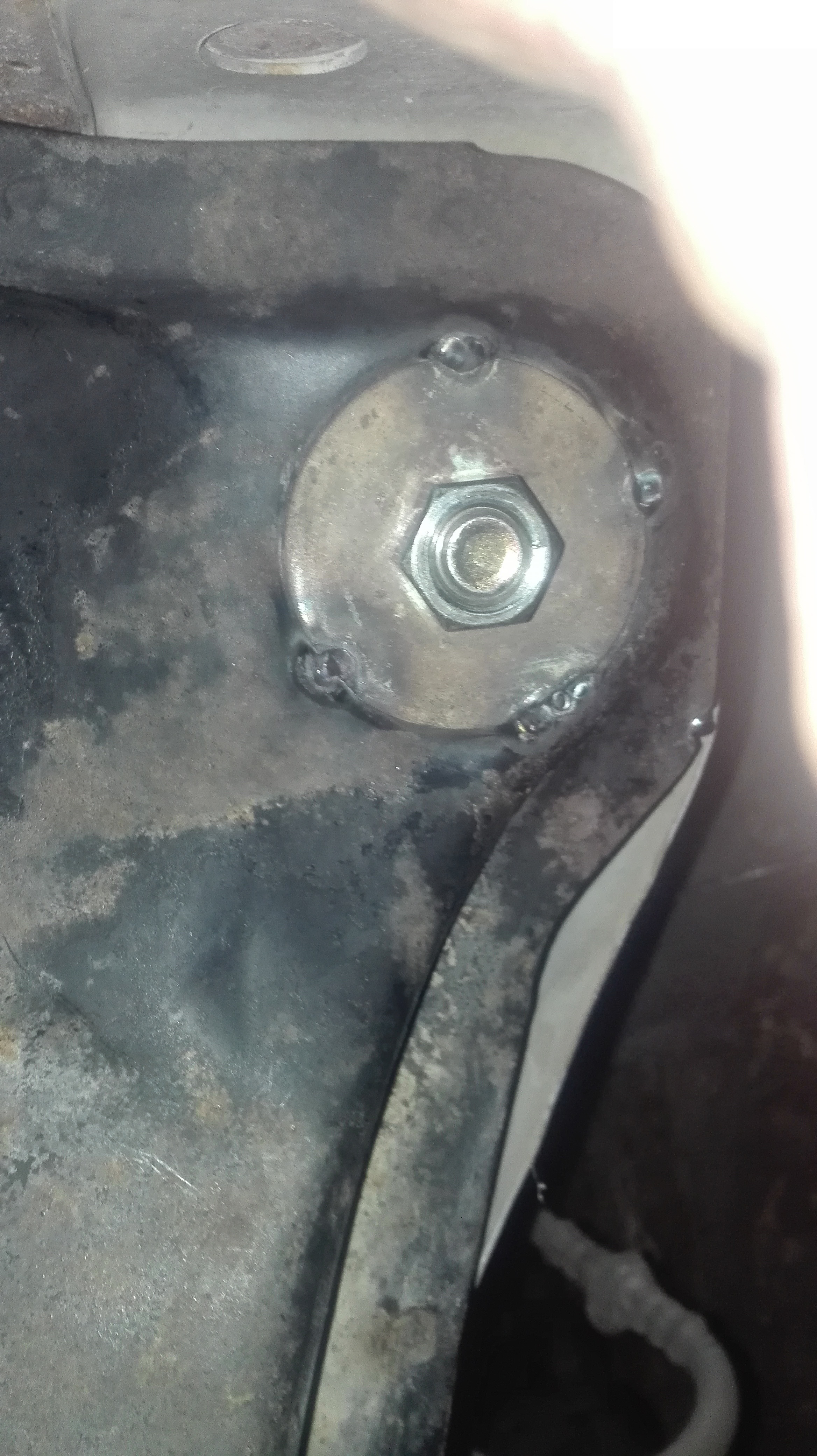

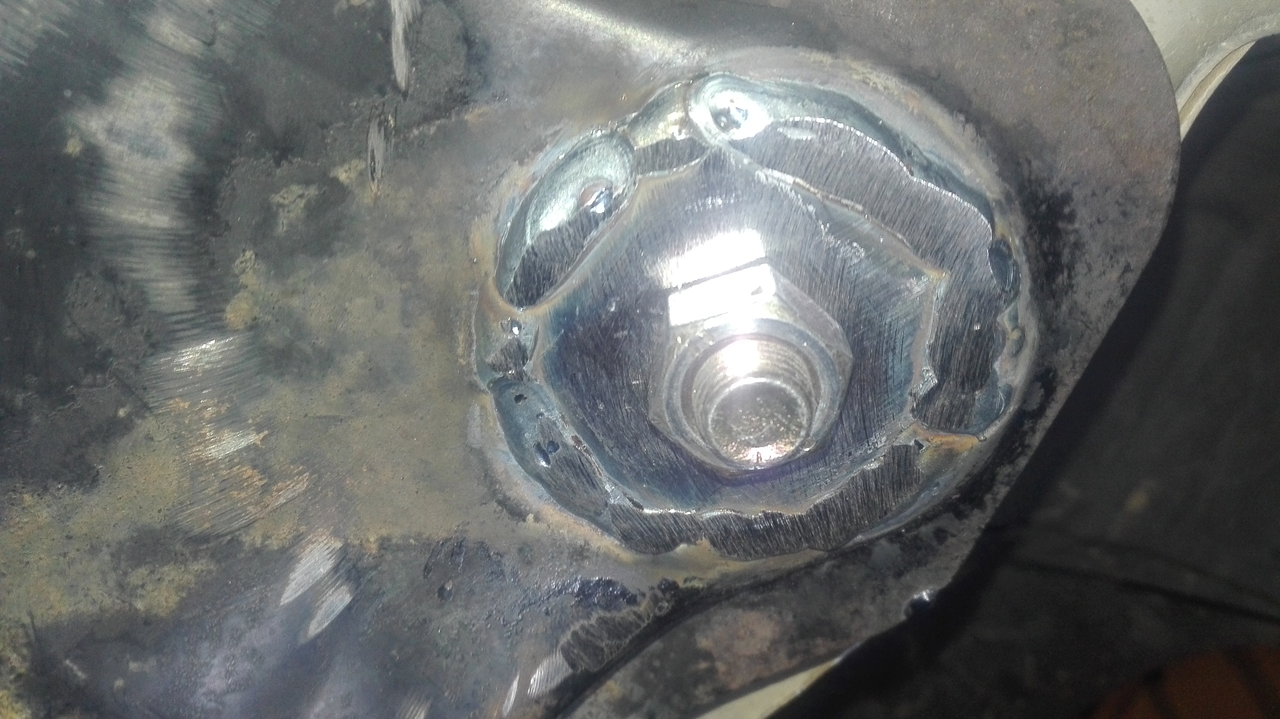

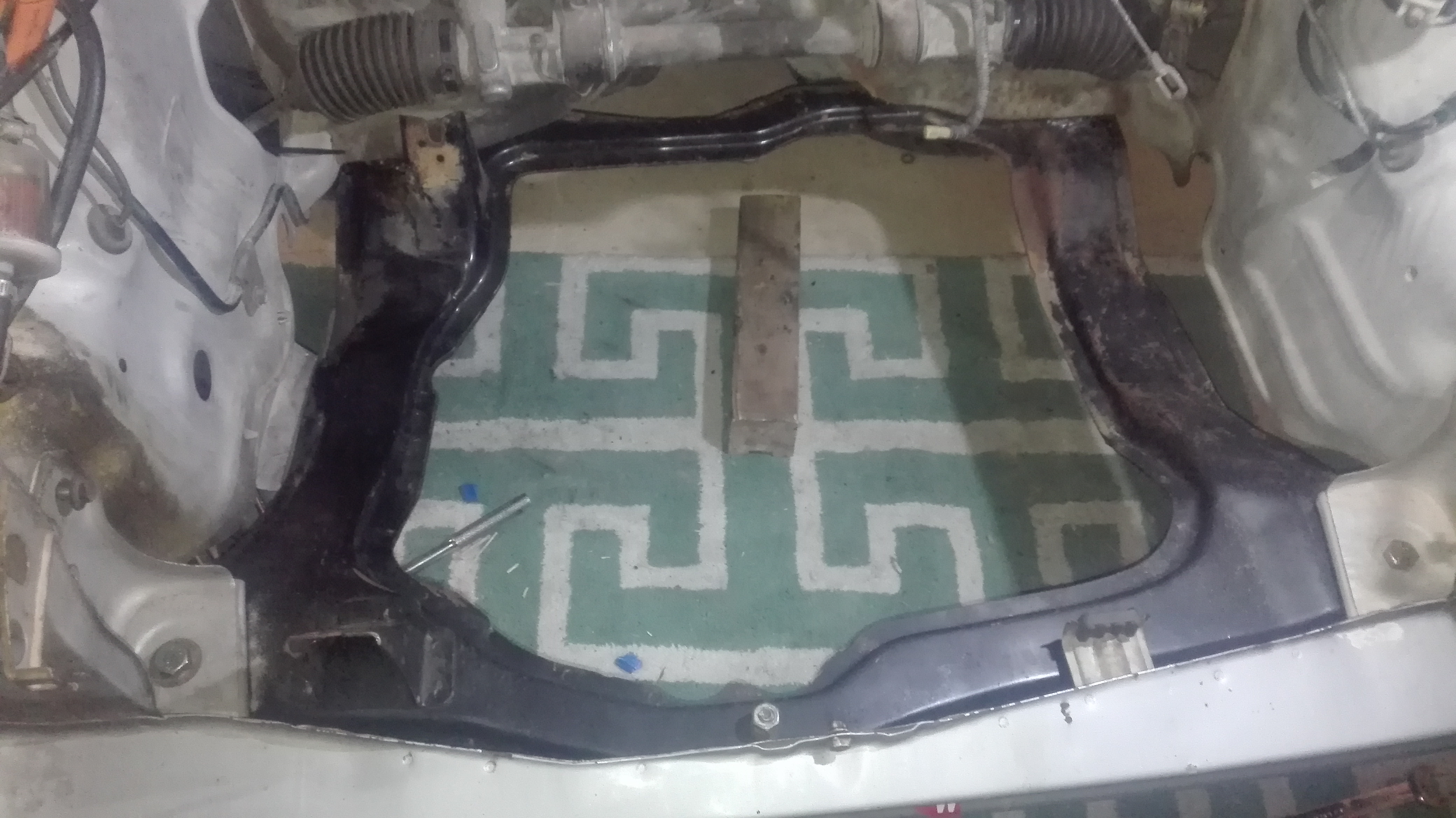

As of yesterday I still am playing with the set up, I am about to solid mount the sub frame to the chassis. This will eliminate any play in the frame, and keep suspension geometry in a fixed point.
Next step will be back to modifying the lower control arms to add another 5 mm of adjustment.
Getting the basics done, the sub frame is actually in the correct position with the rubbers but I want more precision with suspension geometry.
My tig welder doesn’t like galvanised steel or whatever Daihatsu coated the frame in as the tungsten was deforming a bit with the tack welds. So I’ll blast the frame at work and bring it home to tig weld it neatly.

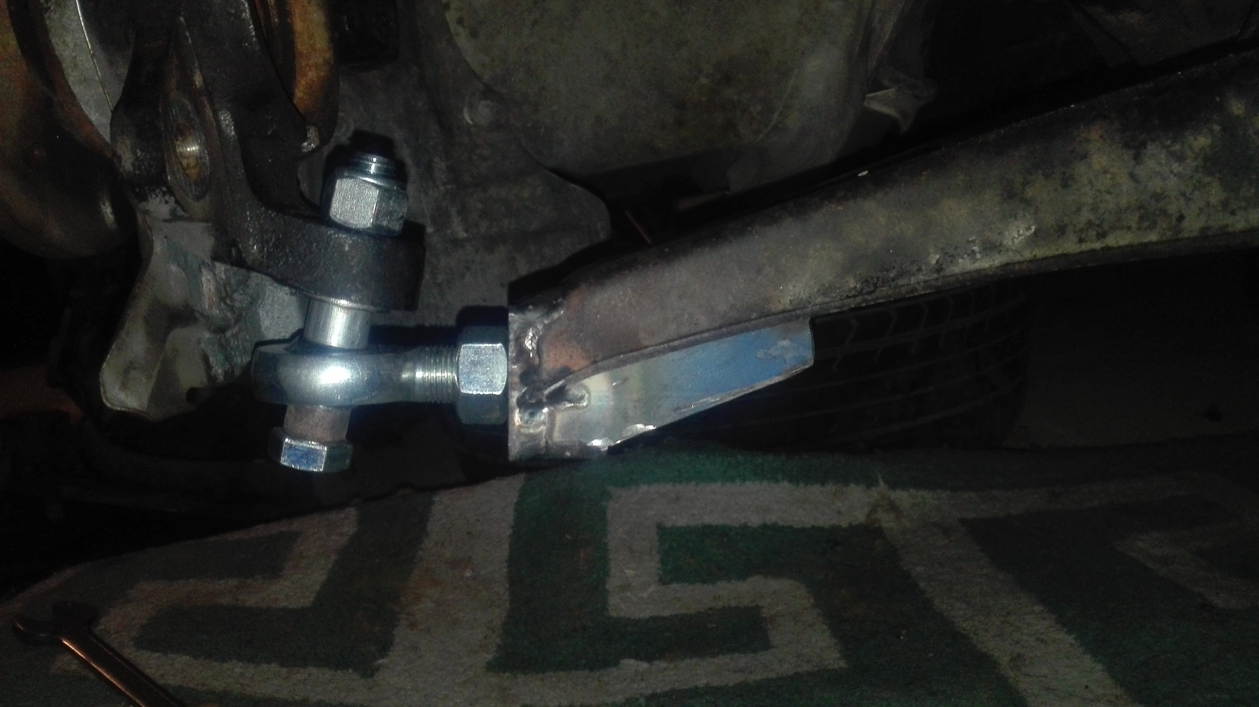

With the sub frame now solid mounted, attention can be turned to the lower control arms. Need to shorten them another 5 mm to get the more adjustment closer to 0° camber.
Not sure why you think you need zero camber. Plus you want the track as wide as possible. Strut front end needs neg 2.5 or more. I am at about neg 3.5 right now with about 4 deg castor. Zero for drag racing. For your little thing at at least start around neg 1.5.
Cheers Mr_Gormsby, I don’t want 0 camber at ride height, I am aiming for 0 camber on full suspension extension. Mainly so if I do manage to hit a bump and come down on the suspension that the wheels wont be in contact with the road with positive camber. If that make sense.
On that note, the sub frame and lower control arms are almost finished, next will be to make the steering arms (actually looking forward to pro ackerman angle steering arms).
Went and bought the real deal auto heim joints, these are 5/8" thread and 1/2". Looking forward to getting this rolling in to the paint shop.

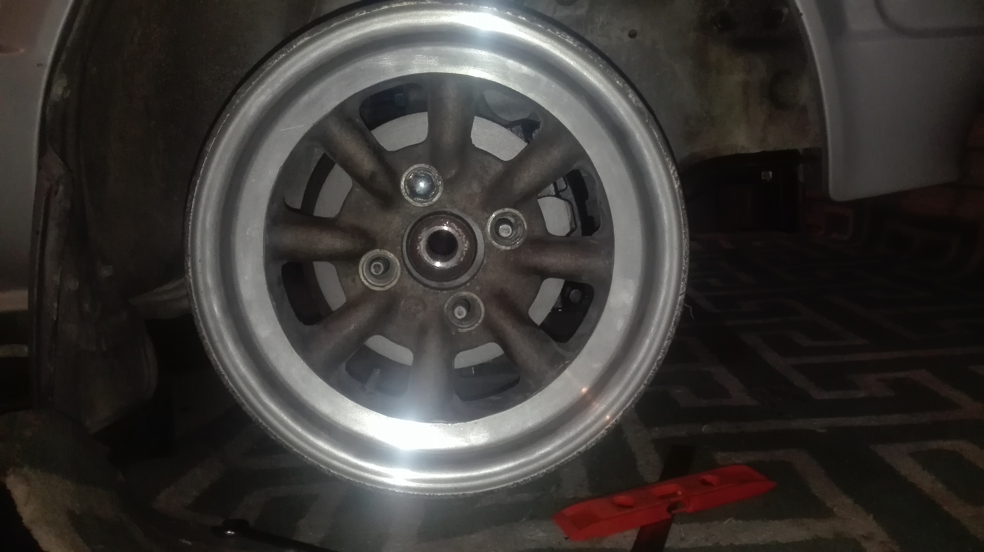

In a few days I will have completed the next part of the project, the wheels will be covered in coatings that I hope will improve the performance.

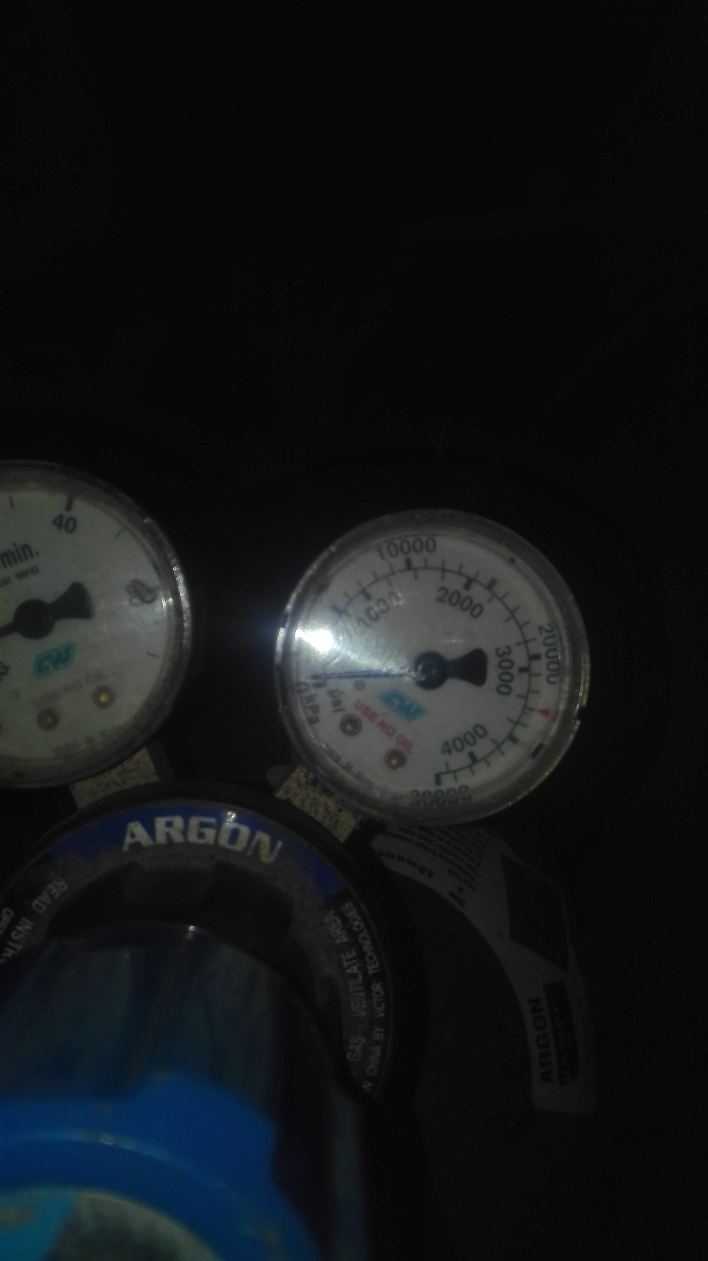

With things moving along, I was a little disappointed that the Argon is almost empty. Plenty more work to come once I get a new bottle.

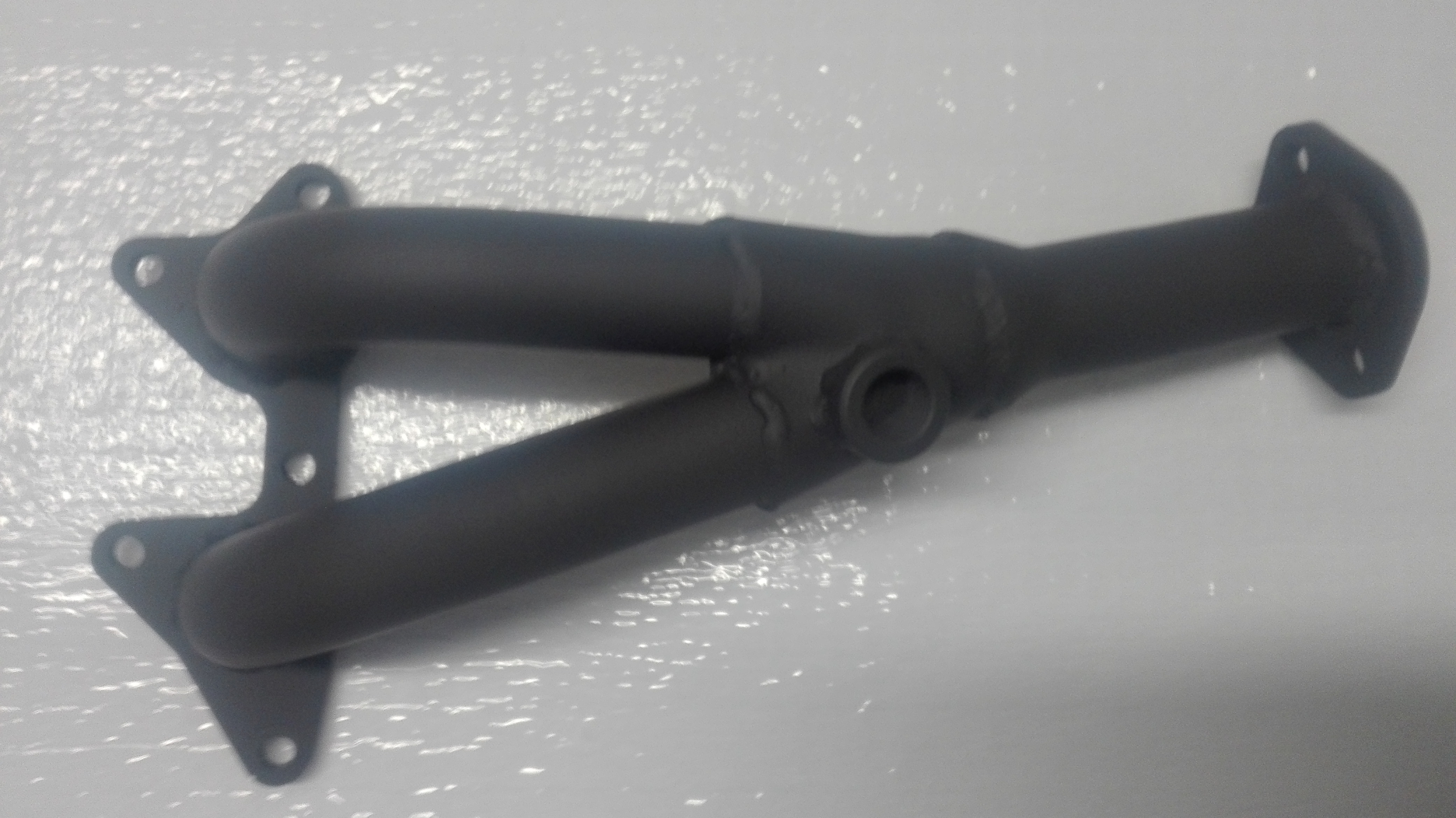

Well I took the extractors I made to work, and gave them a freshen up with some ceramic coating, this is Ciloxide matte black by Tech Line Coatings. I coated inside and out. I am quite happy with the outcome of the finish but am tempted to put a clear coat over the matte finish to bring them up to a gloss black.
I bought an exchange Argon bottle so fabrication has continued.

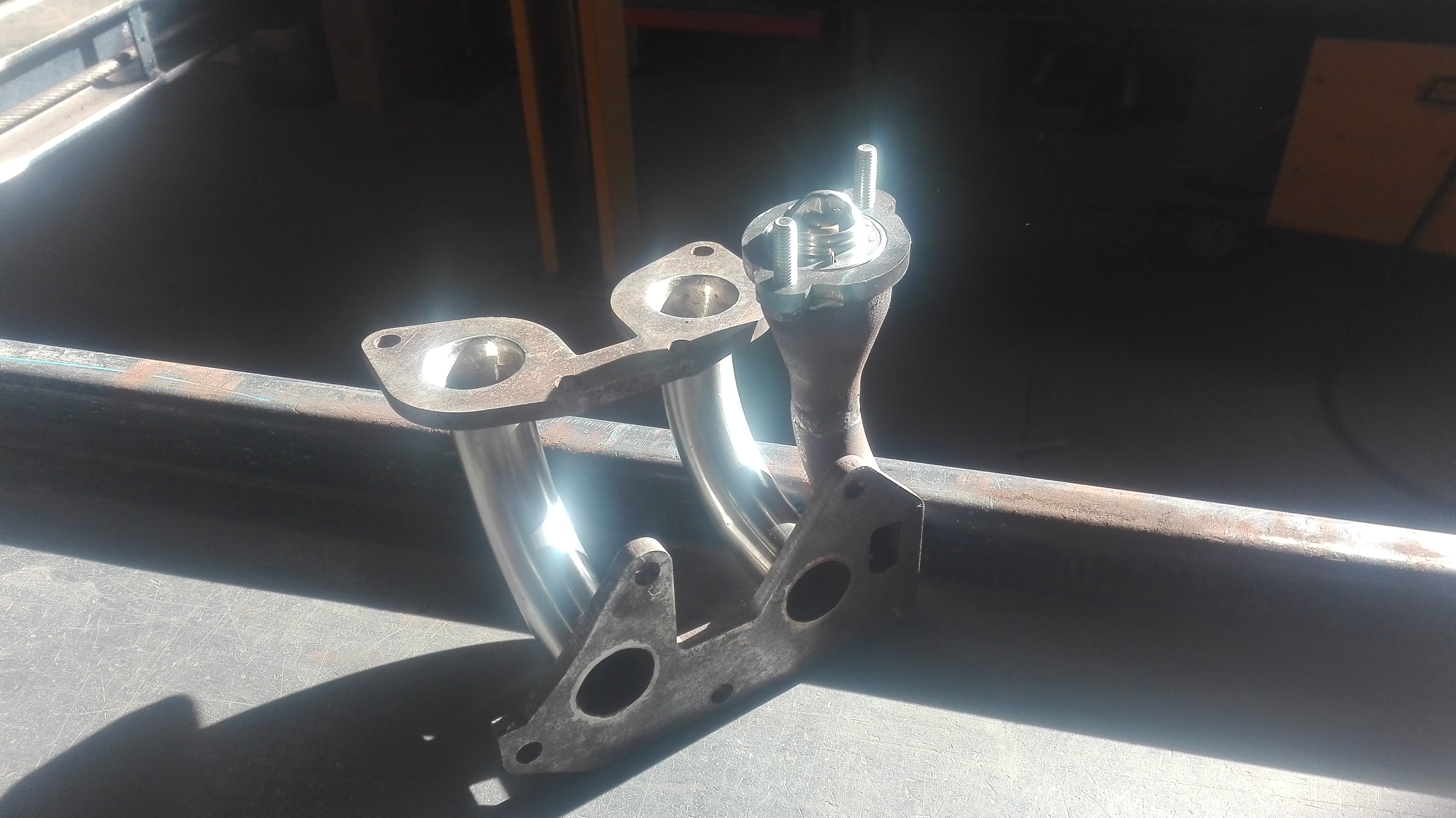

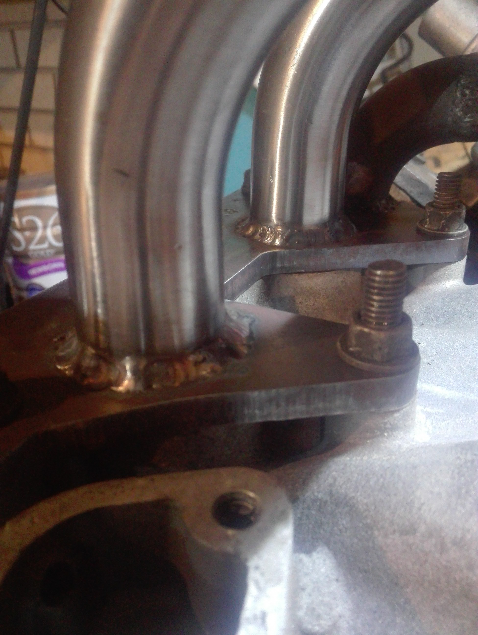

Need a new header flange, for the new set up to go ahead. Performance parts have been ordered.
Excellent work mate.
Id absolutely love one day to know how to do anything more then arc welding!
Cheers, my tig welding is better than my mig welding by a long shot.
I’m feeling like this manifold is at 90% now, only a few bits to weld on.
That looks awesome Dale :thumbsup:

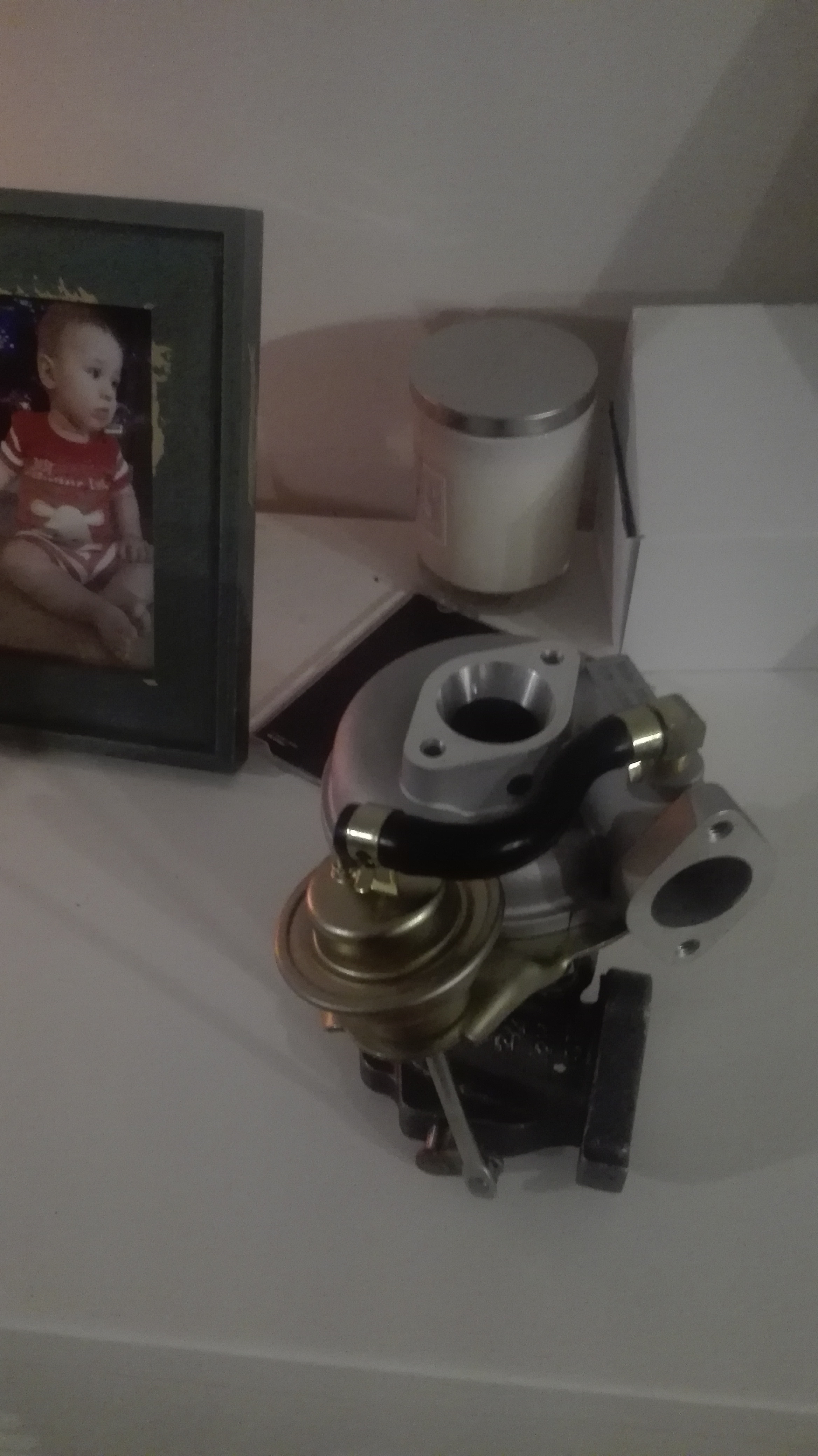

So I bought this little thing, and I’ve been buying the supporting parts for the fuel system. Rising rate Malpassi to suit the 36 mm IDF, a Walbro in-line efi pump, 6 meters of 3/16", 1/4", and 5/16" bundy tubes. I have spent about $200 on parts for making the IDF blow through friendly.

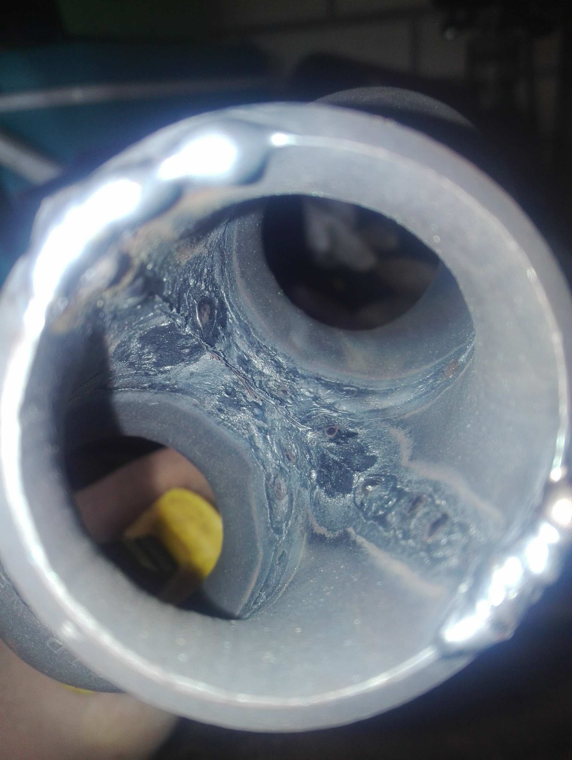

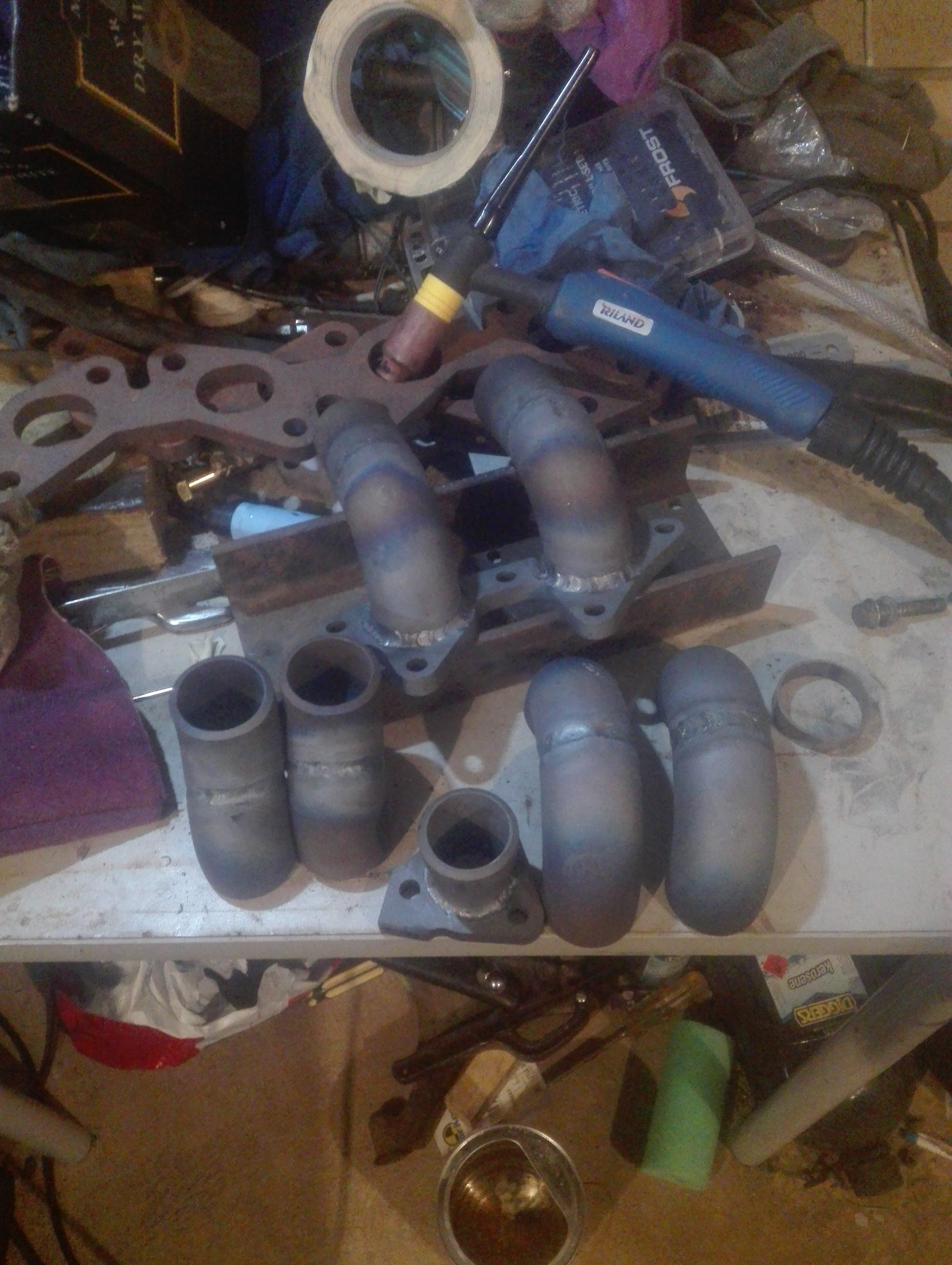

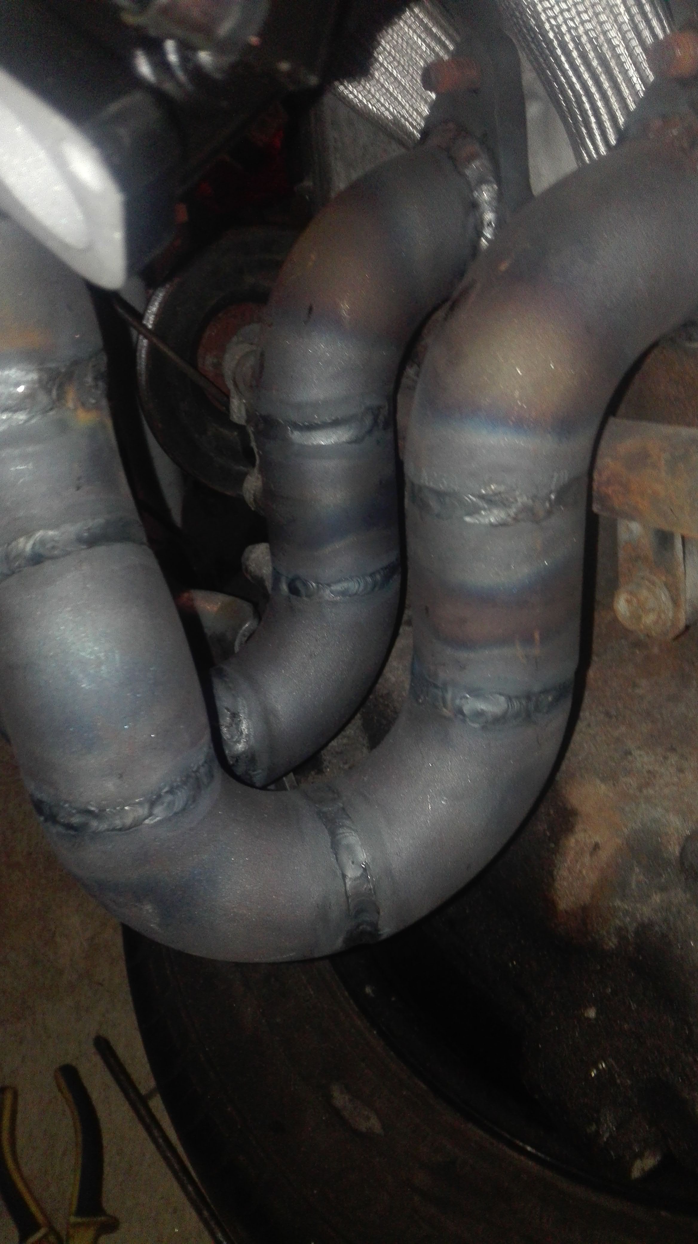

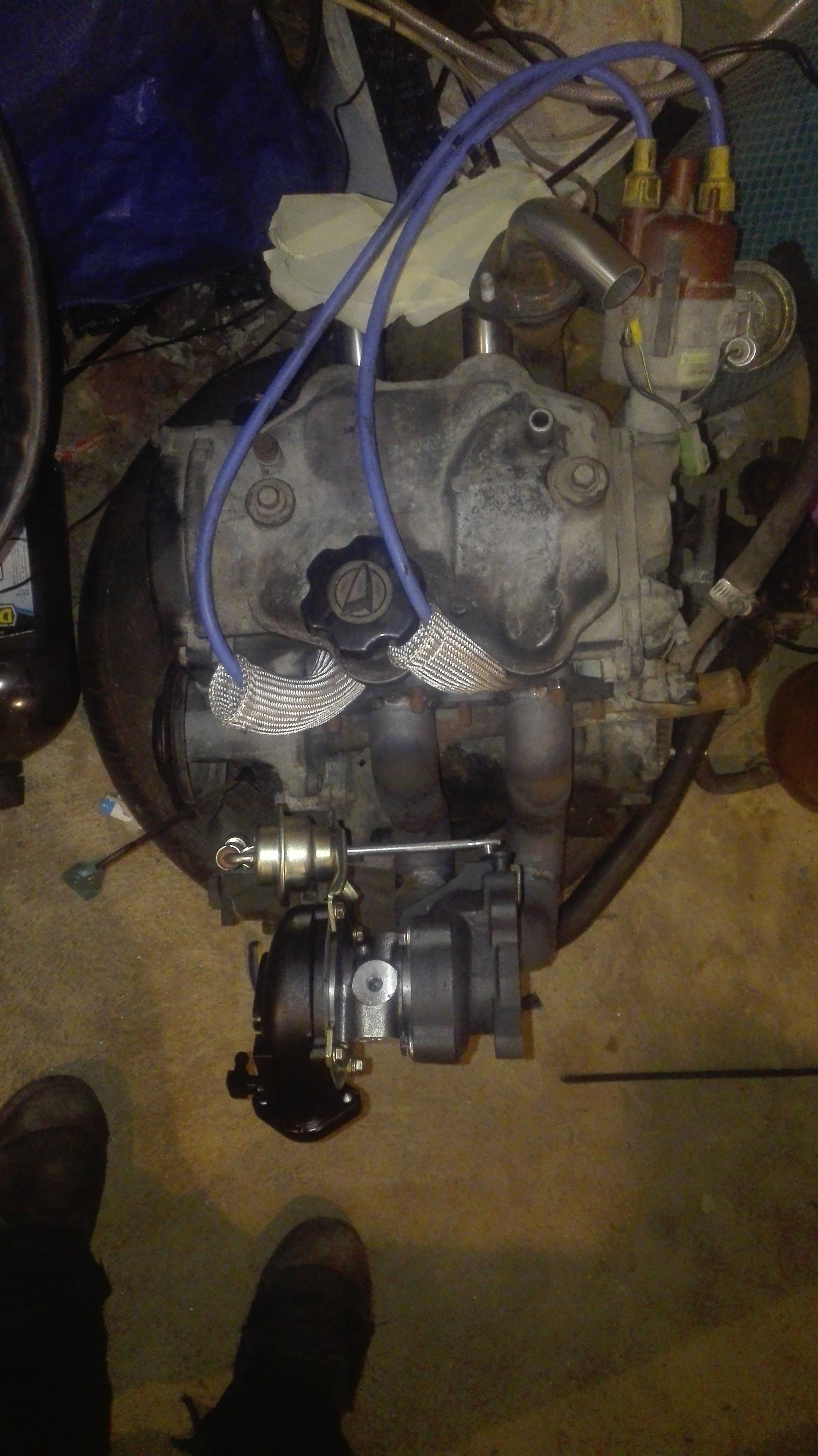

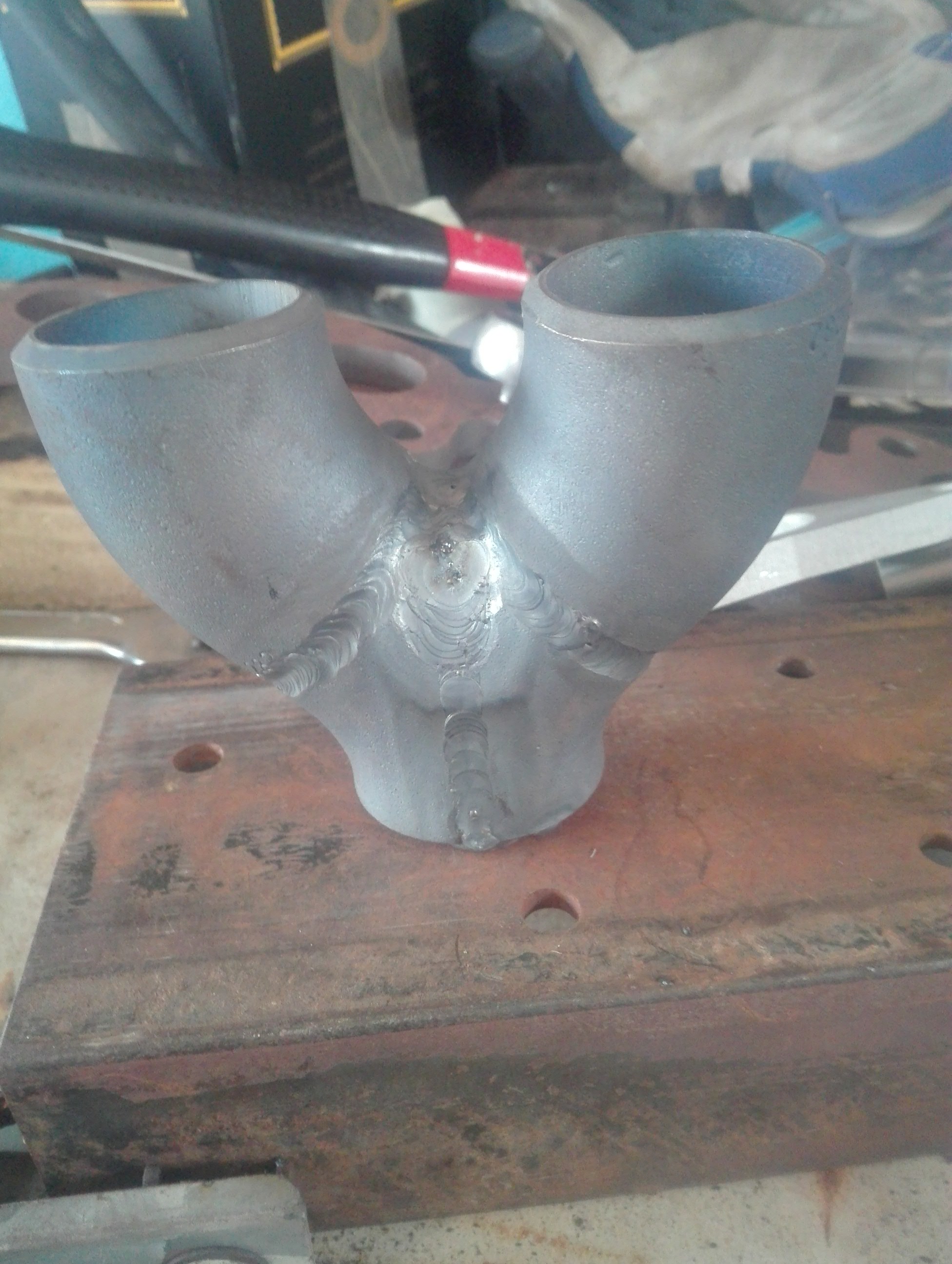

This is the first time I have made a turbo manifold. Some interesting clearance issues without using small radius bends but it’s a blessing in disguise, as the u bend of the manifold allows the 45 mm dump pipe to pass in between. I will post some pictures of what I mean once it’s all solidly welded up.
I accidentally welded on the exhaust housing inlet flange 180° the wrong direction.
IMG-20170730-WA0011
This is where the turbo is supposed to be. So I will cut off the reducer and spin it around tomorrow.
IMG-20170730-WA0014
This has been made with two intentions. Larger radius bends are cheaper, and this is where the 45 mm dump pipe passes through.
