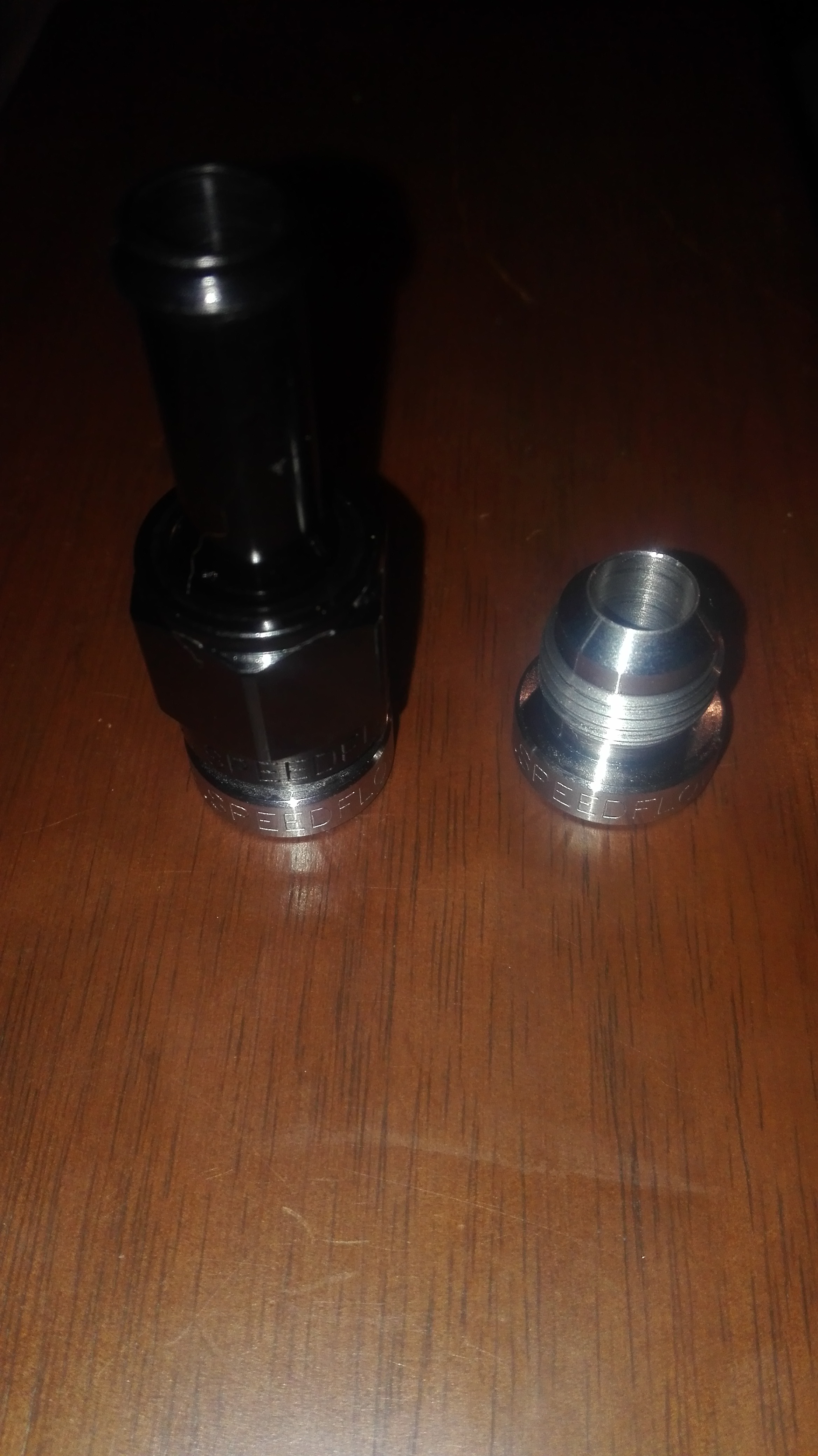

The first time I have bought Speed Flow, these are dash 6 for the vacuum lines from the intake manifold.

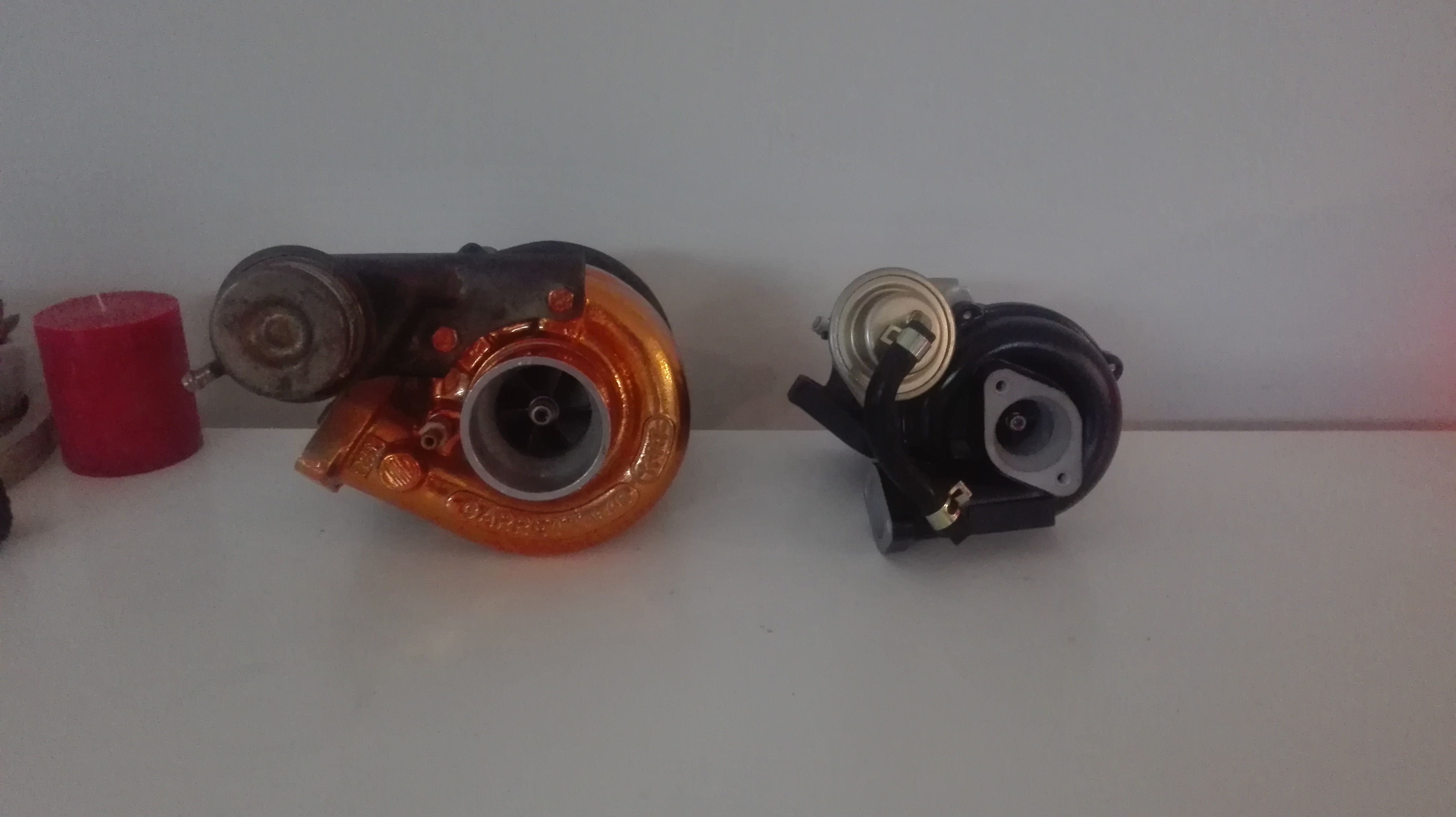

The size comparison of a T25 and the RHB-31

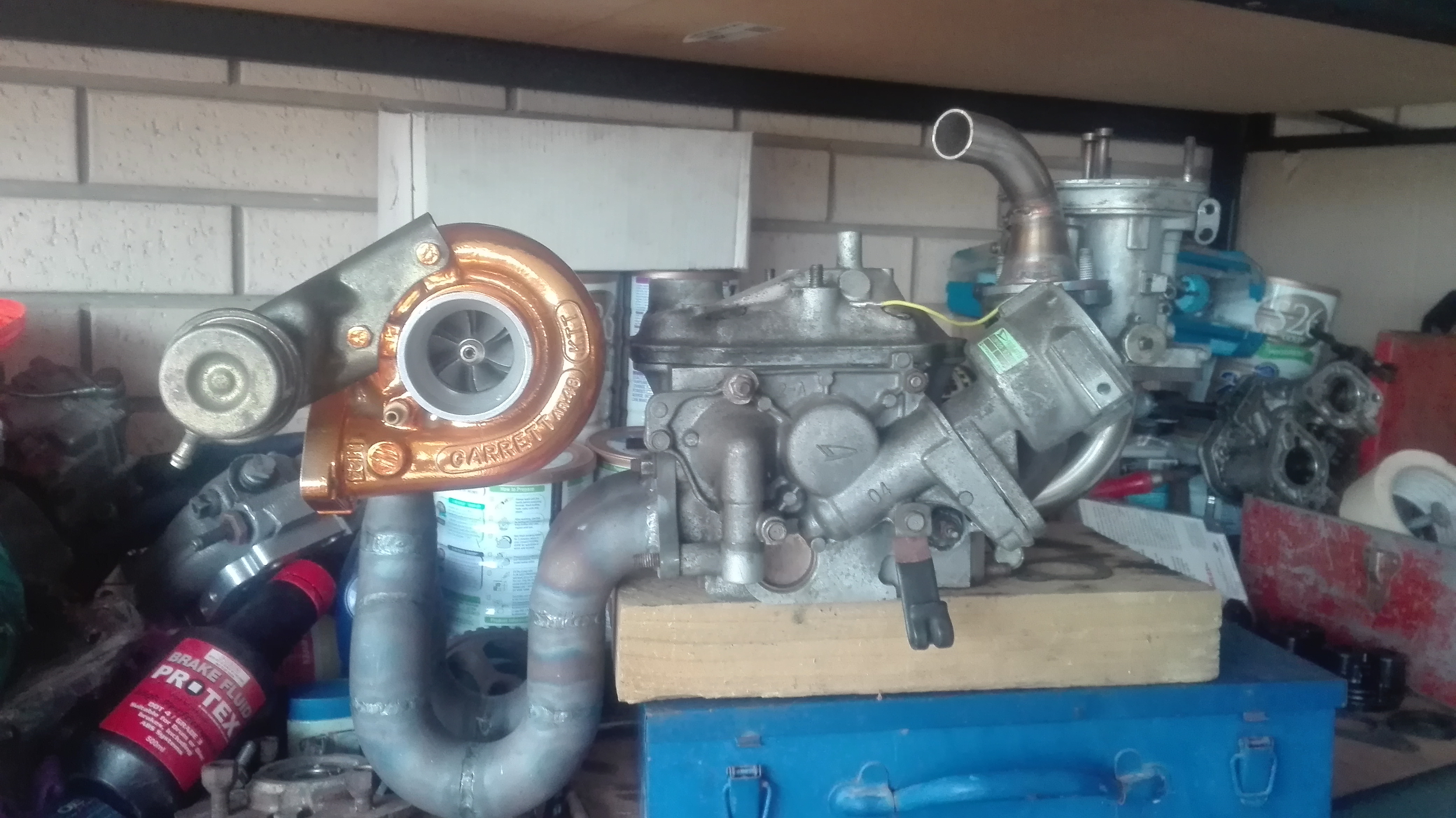

The turbo manifold is done and the intake manifold has dash 6 fitting welded on for a vacuum/boost source for the small reservoir I am about to make.
That is some bloody nice work.

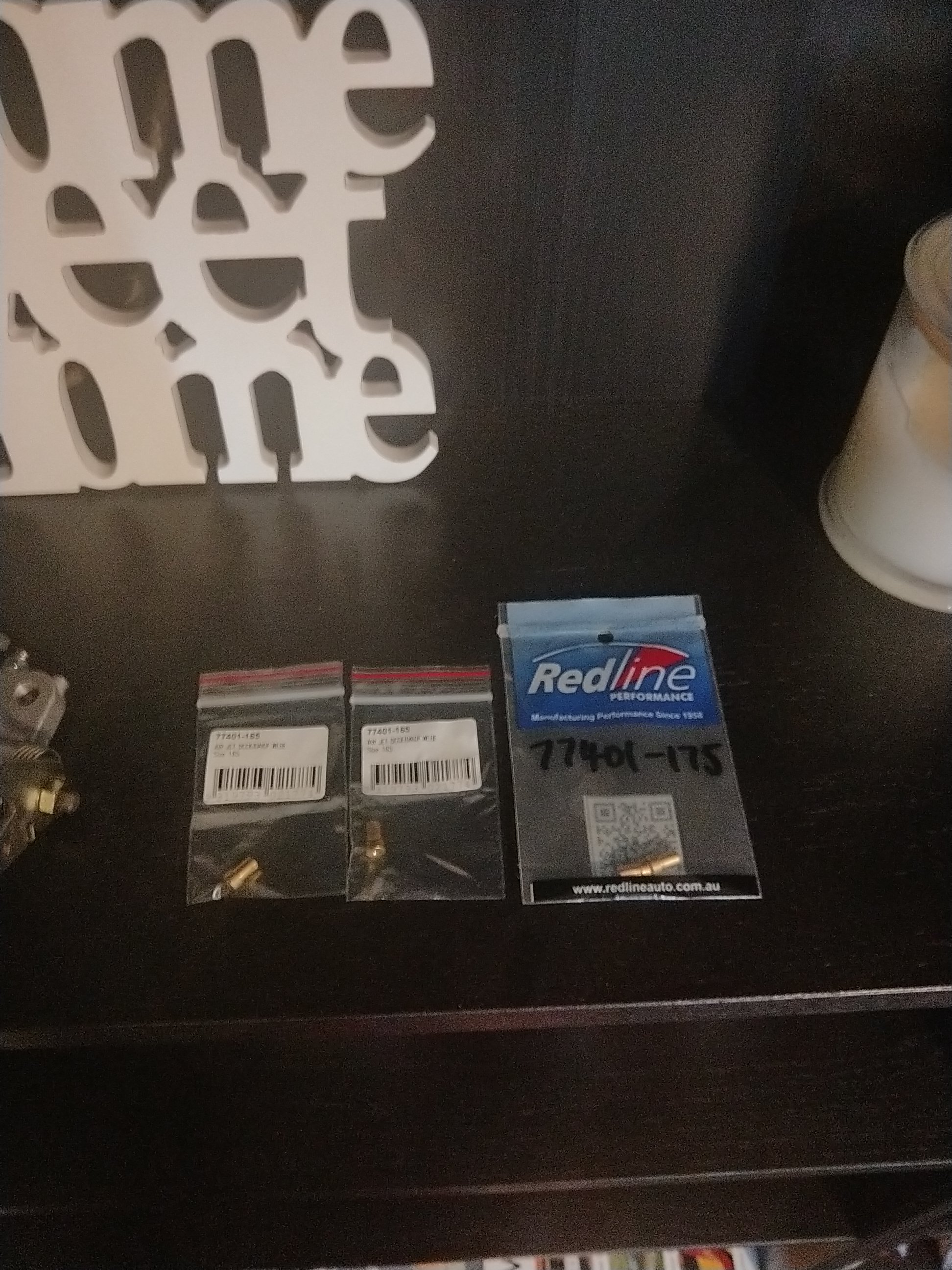

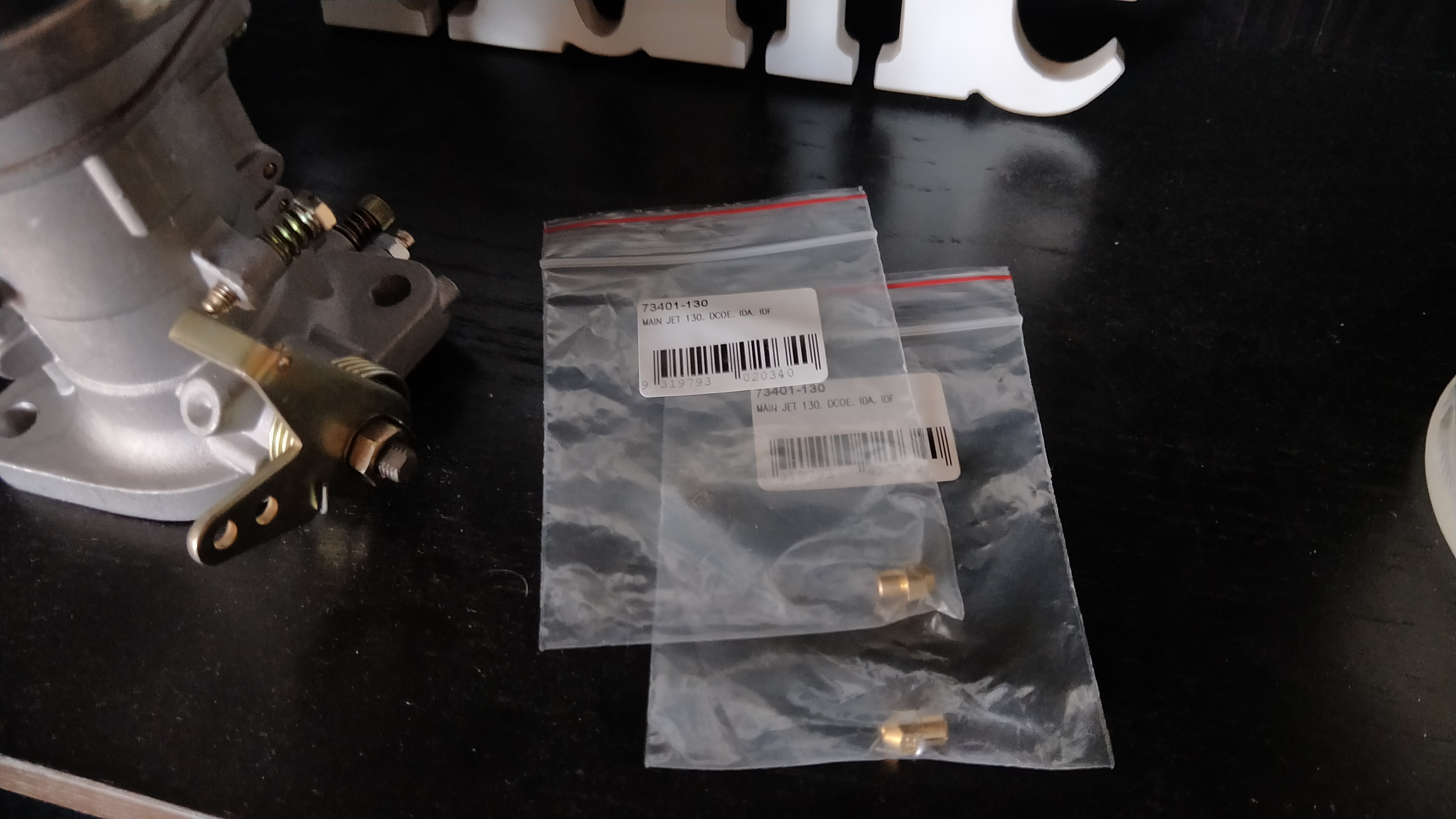

Working on the carby, upgraded to a 40mm IDF. Fitting it with the right size jets, emulsion tubes, and air correctors.
New jets, tomorrow I pick up smaller air correctors. Happy Valentines Day to me.
More air correctors. Hopefully my maths is paying off.

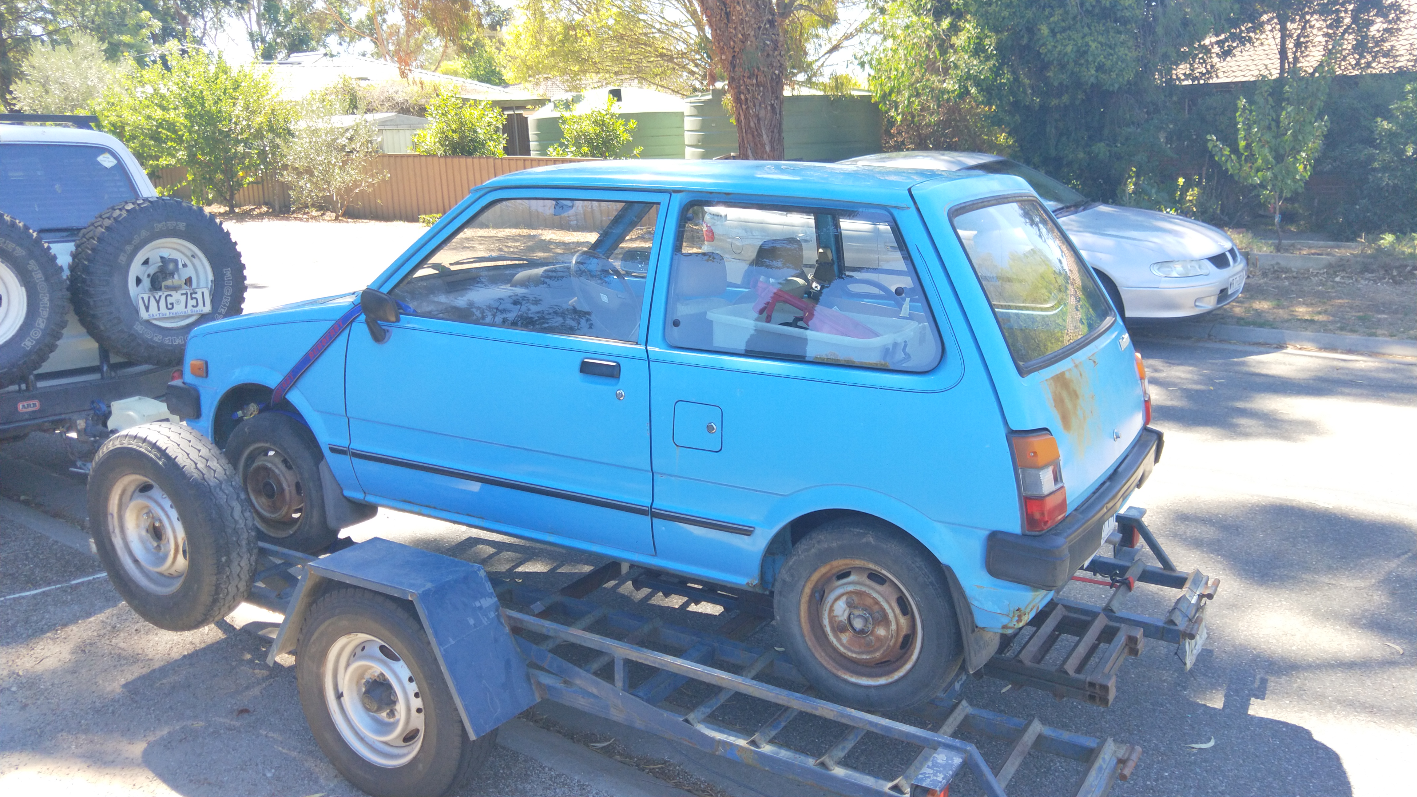

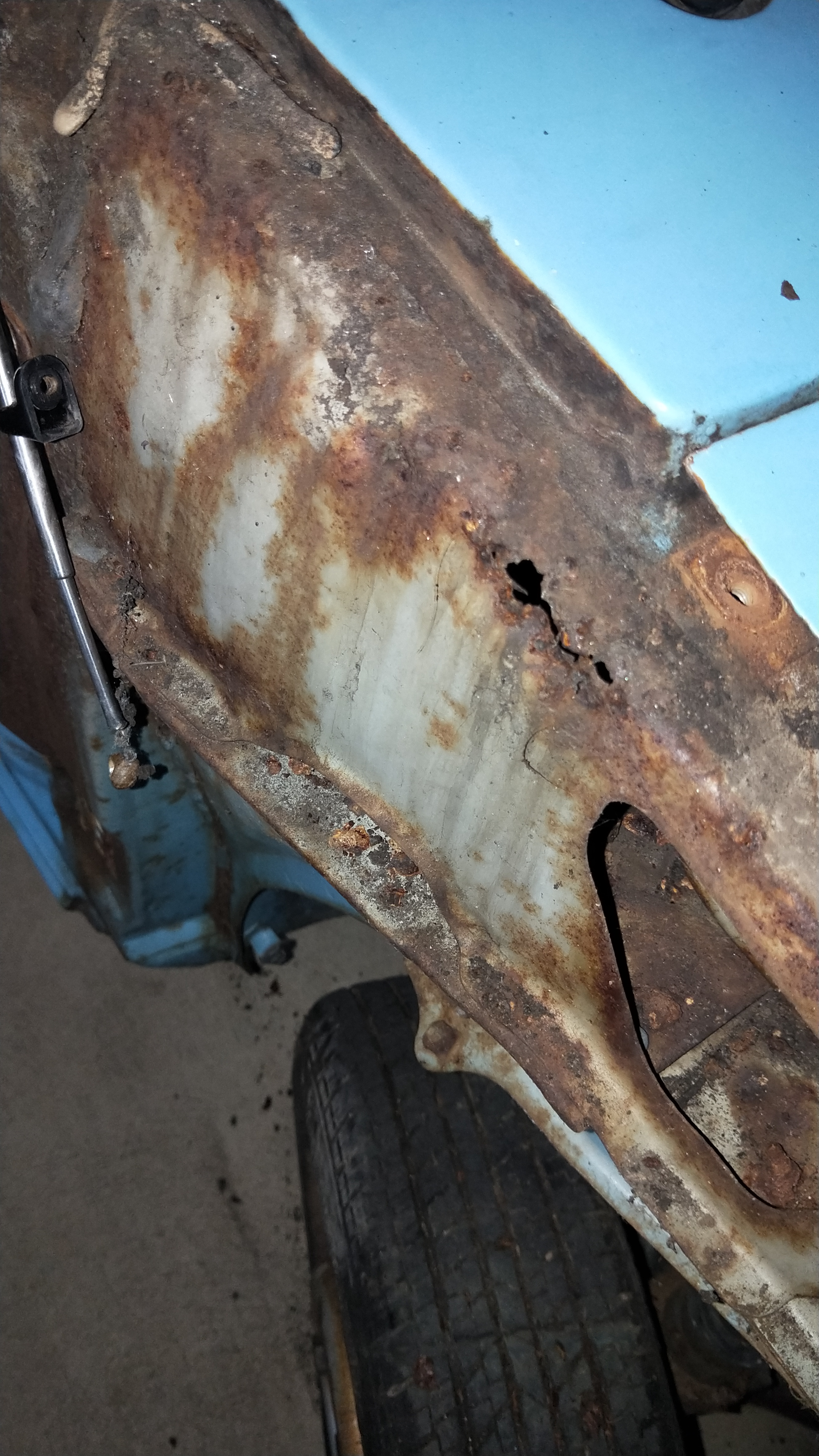

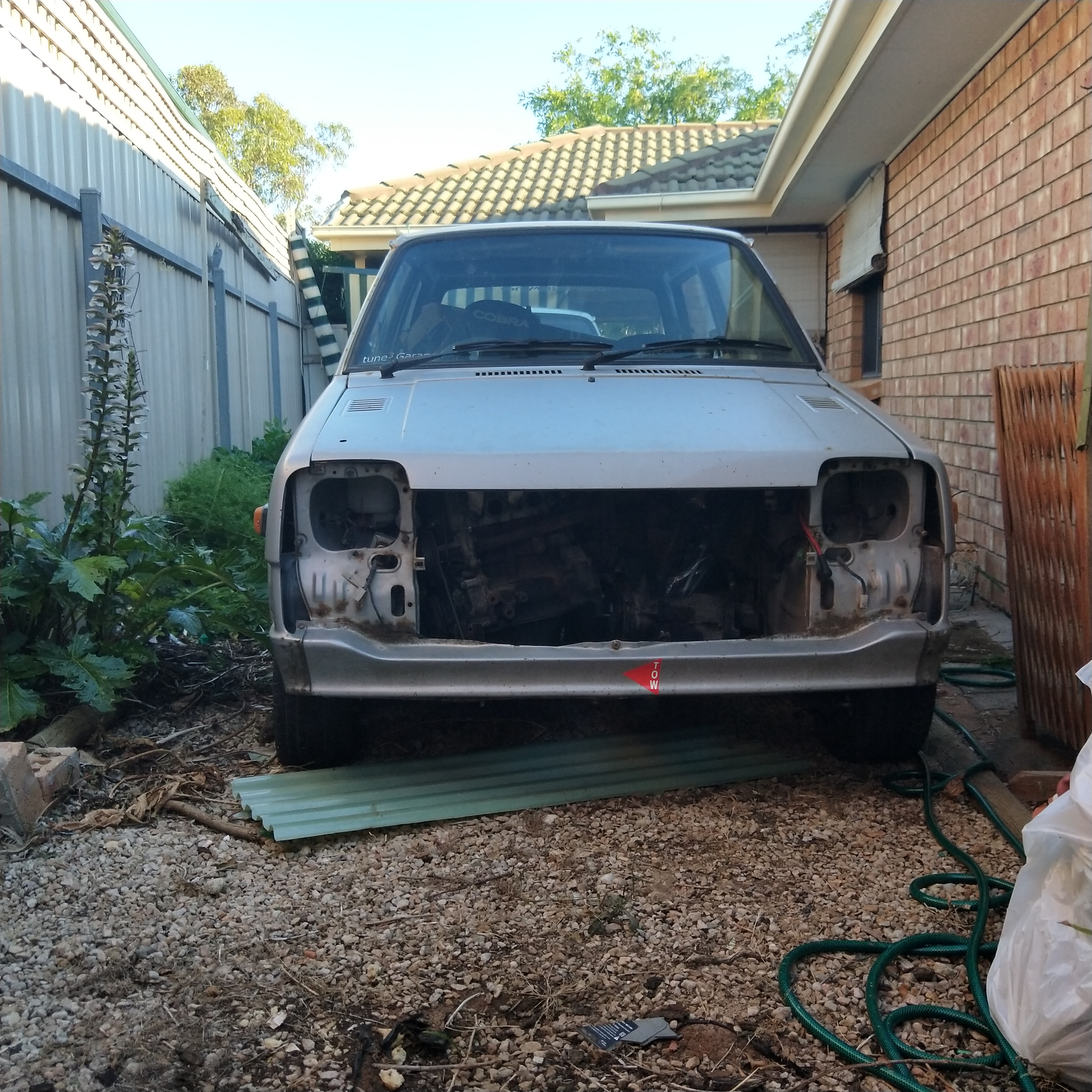

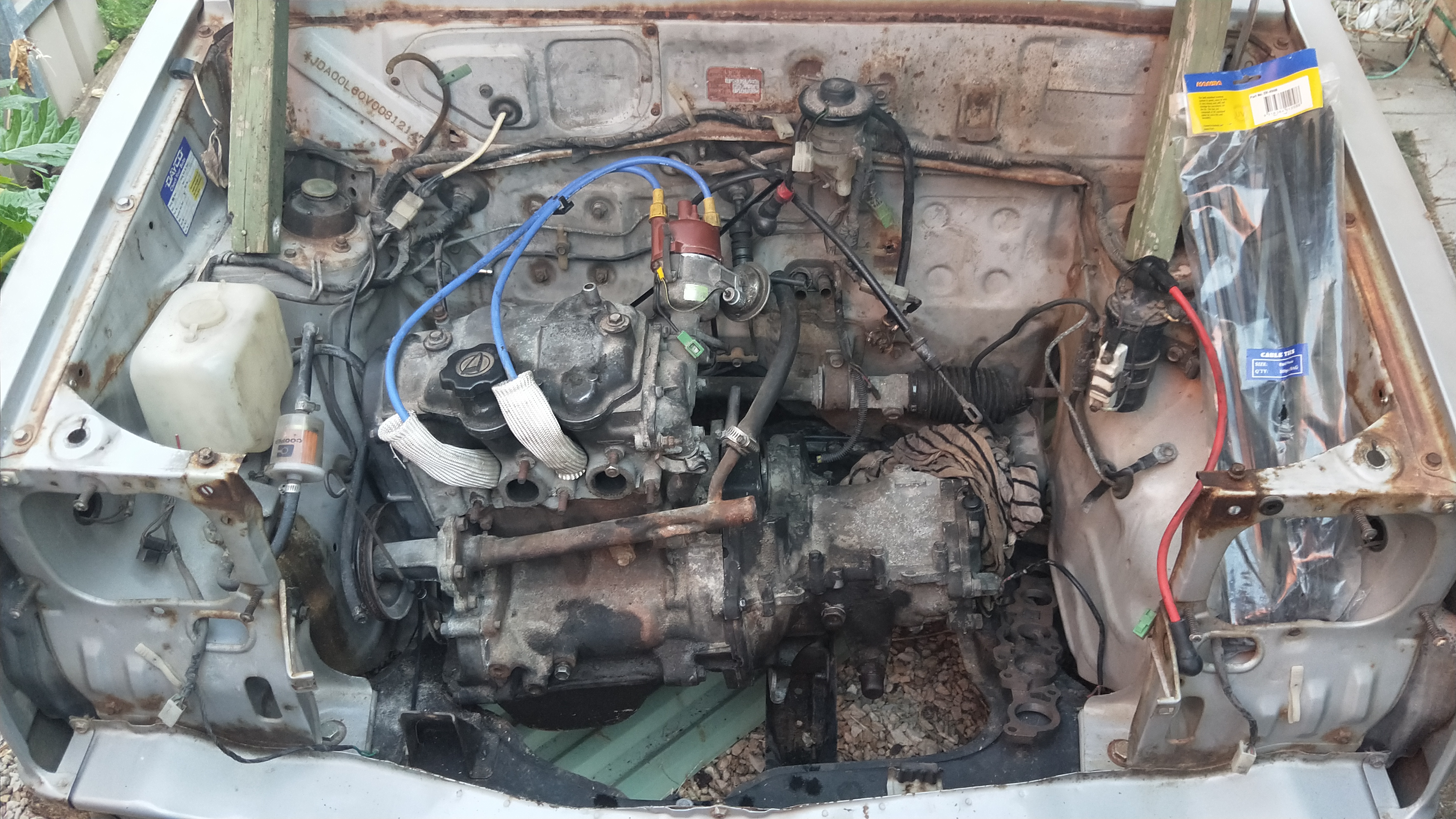

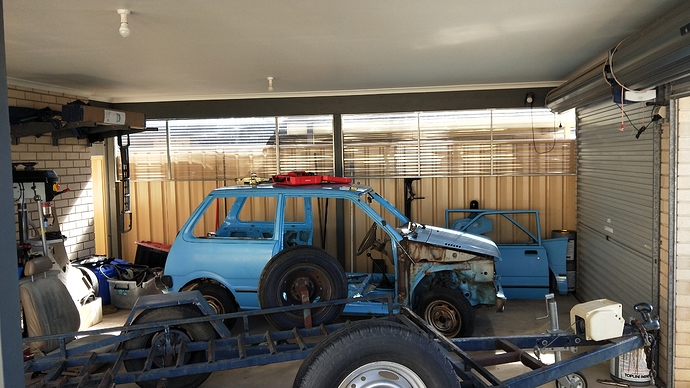

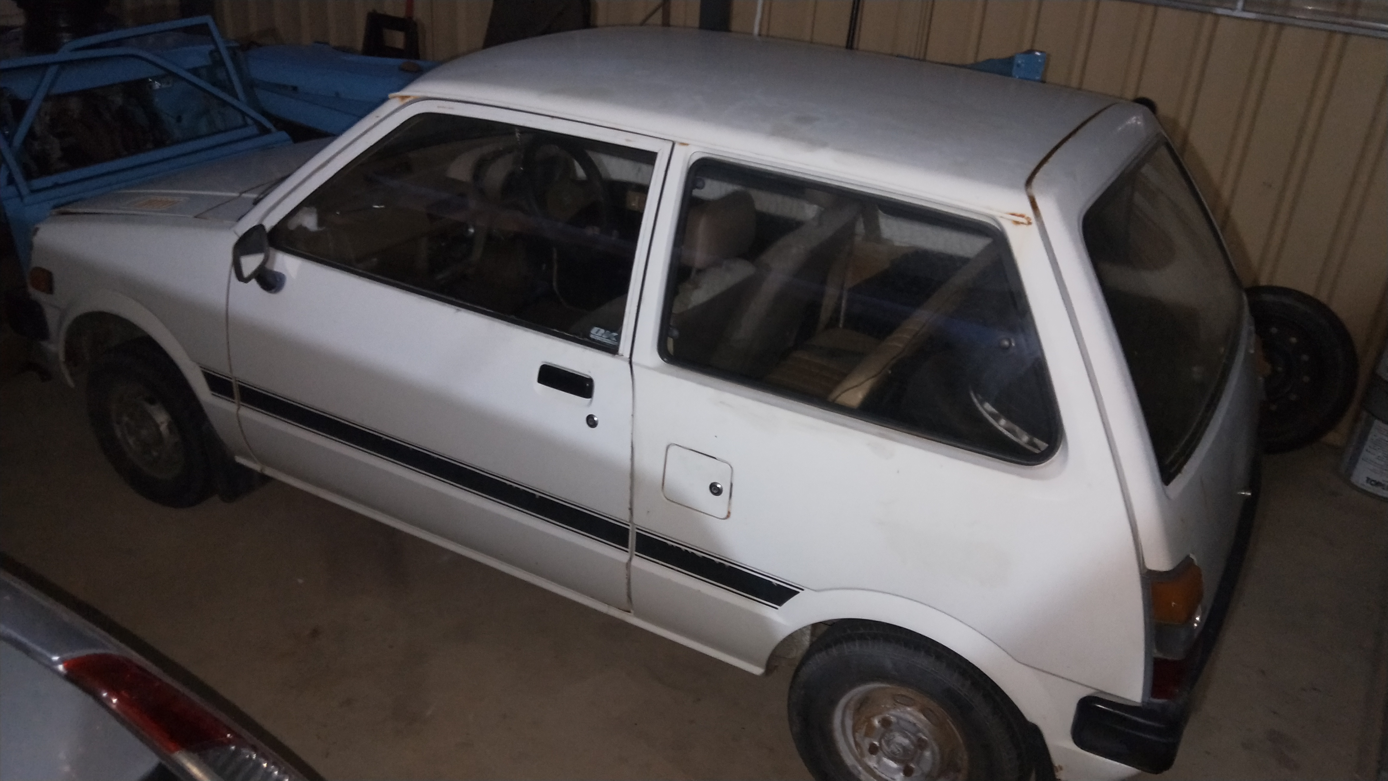

So I bought a parts car for both of my L60 Handi’s. The rust was an issue I was vaguely aware of when I went there. The Handi is a 1984, so it’s a 620cc, 5 speed box and 12 inch wheels.
some great parts there for you.

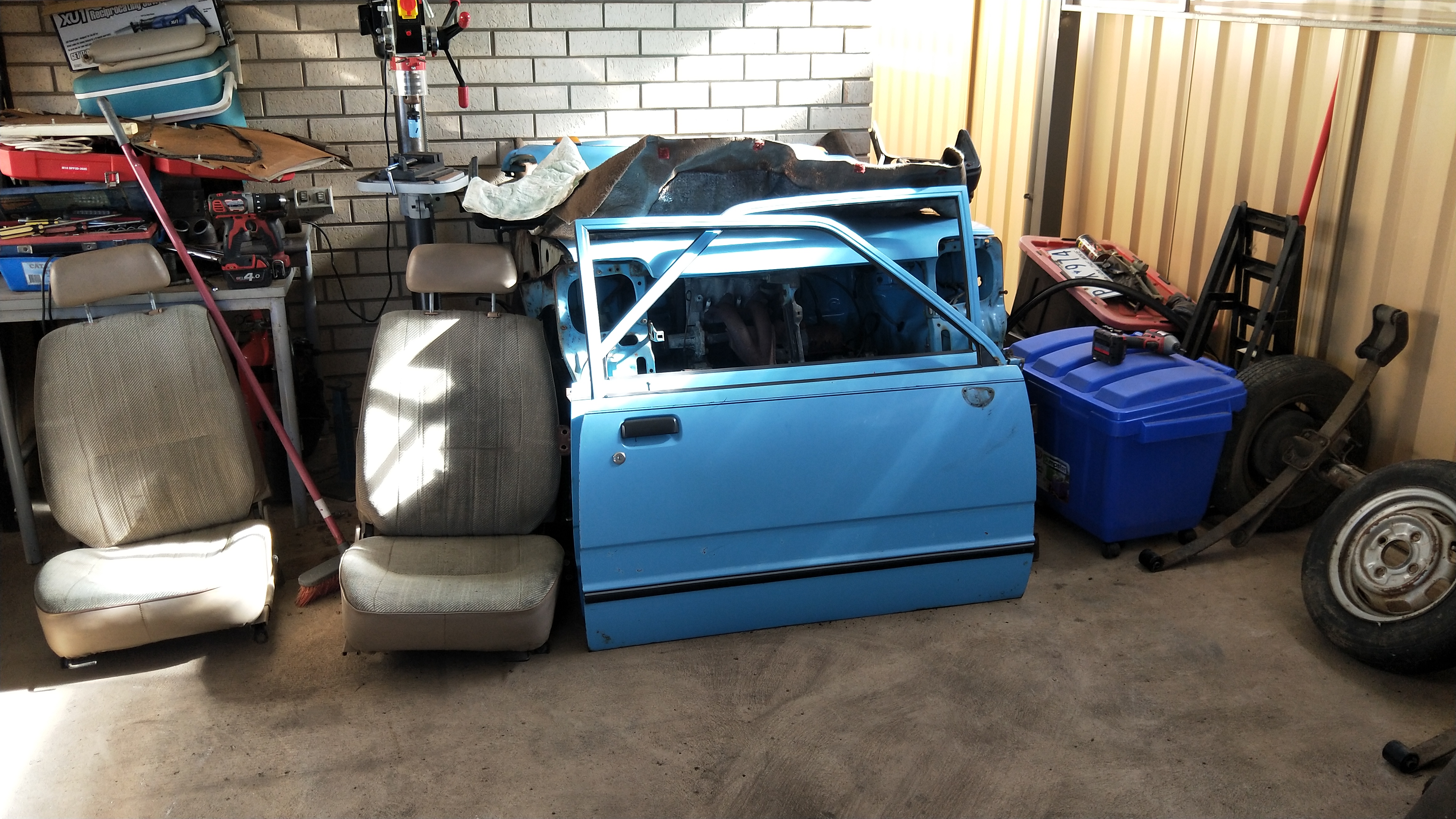

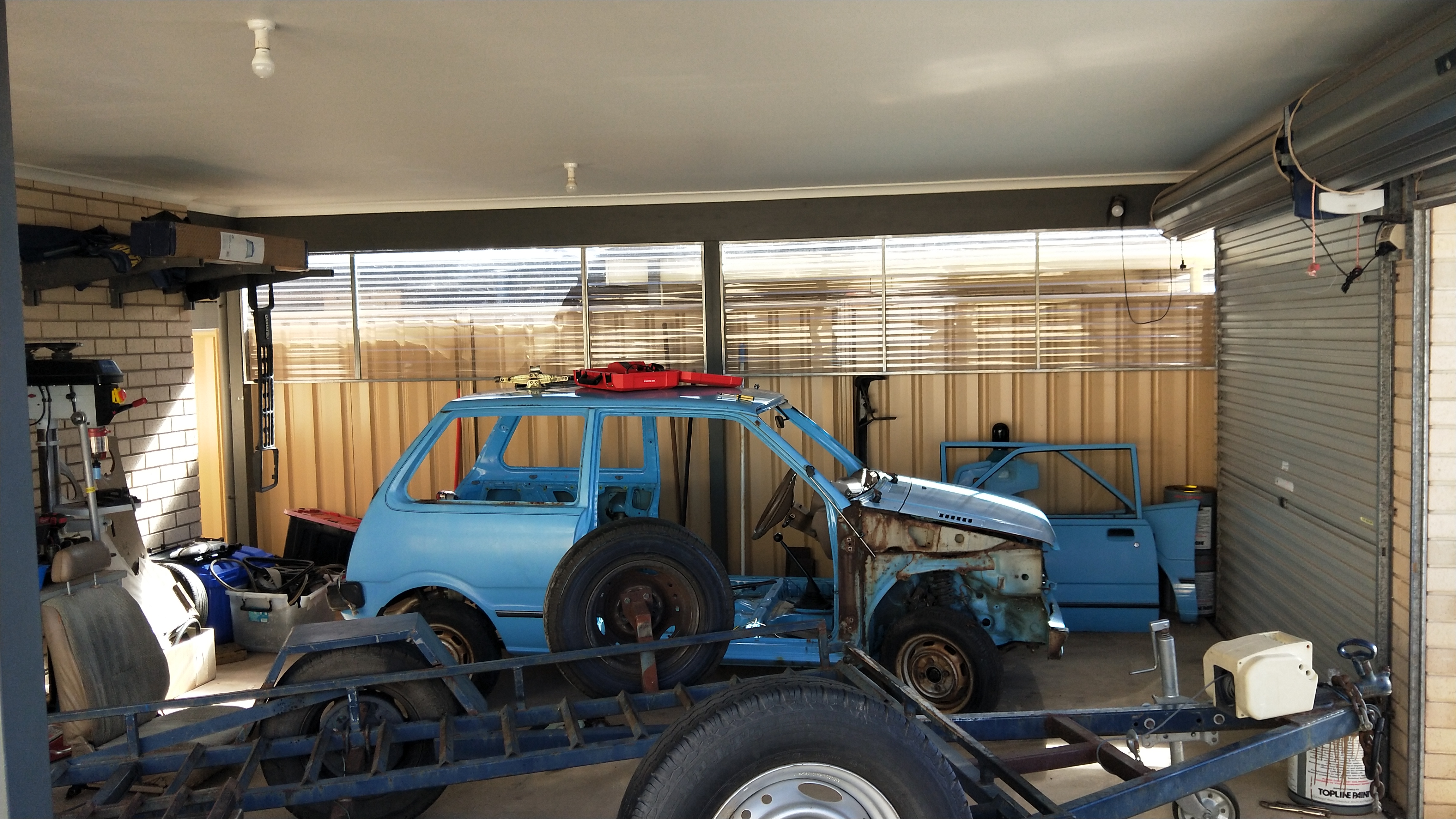

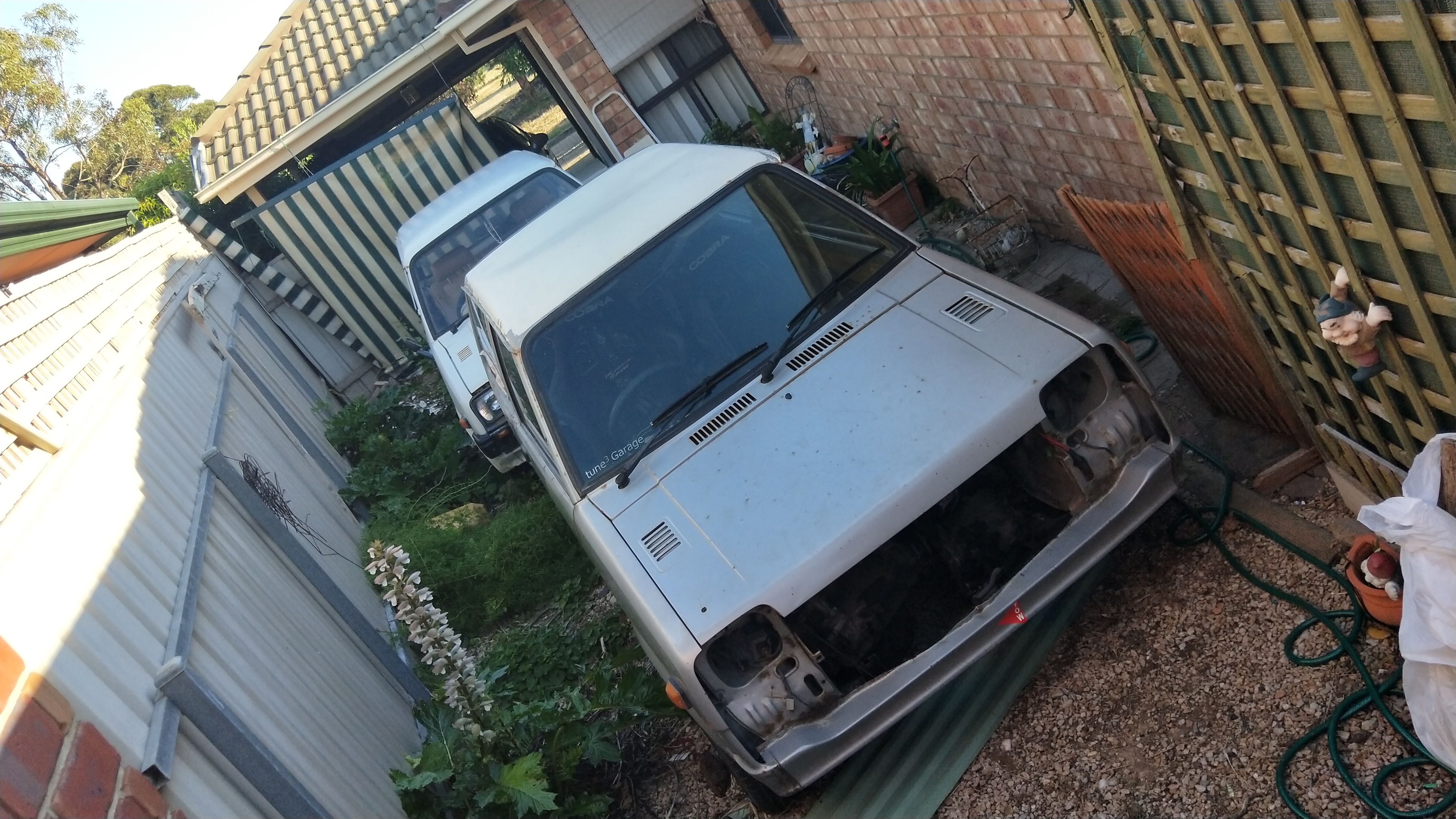

This weekend allowed me to bring home the cars. My feelings towards various vehicles has changed. Time constraints of work and family are making me question the direction of builds.

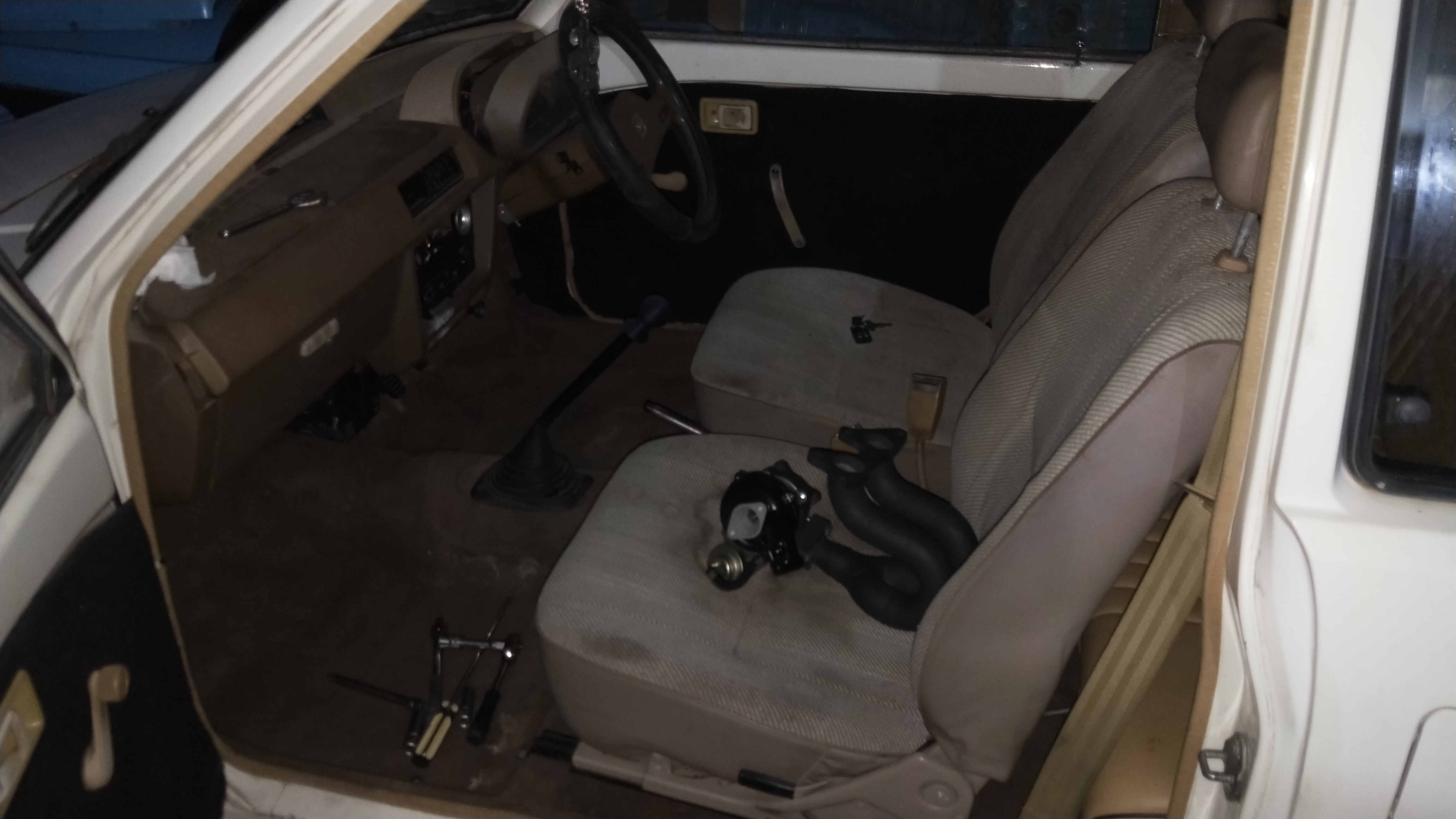

Newer carpet and seats from the donor are in the white car.
