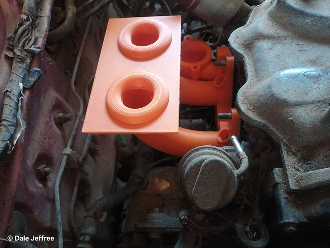

For the record this print failed and unfortunately I had to change a few things.
This is version 19, and the 6th printed manifold. I am happy with this version. Time to make the plenum shape with the printer so I can copy it later with sheet metal.

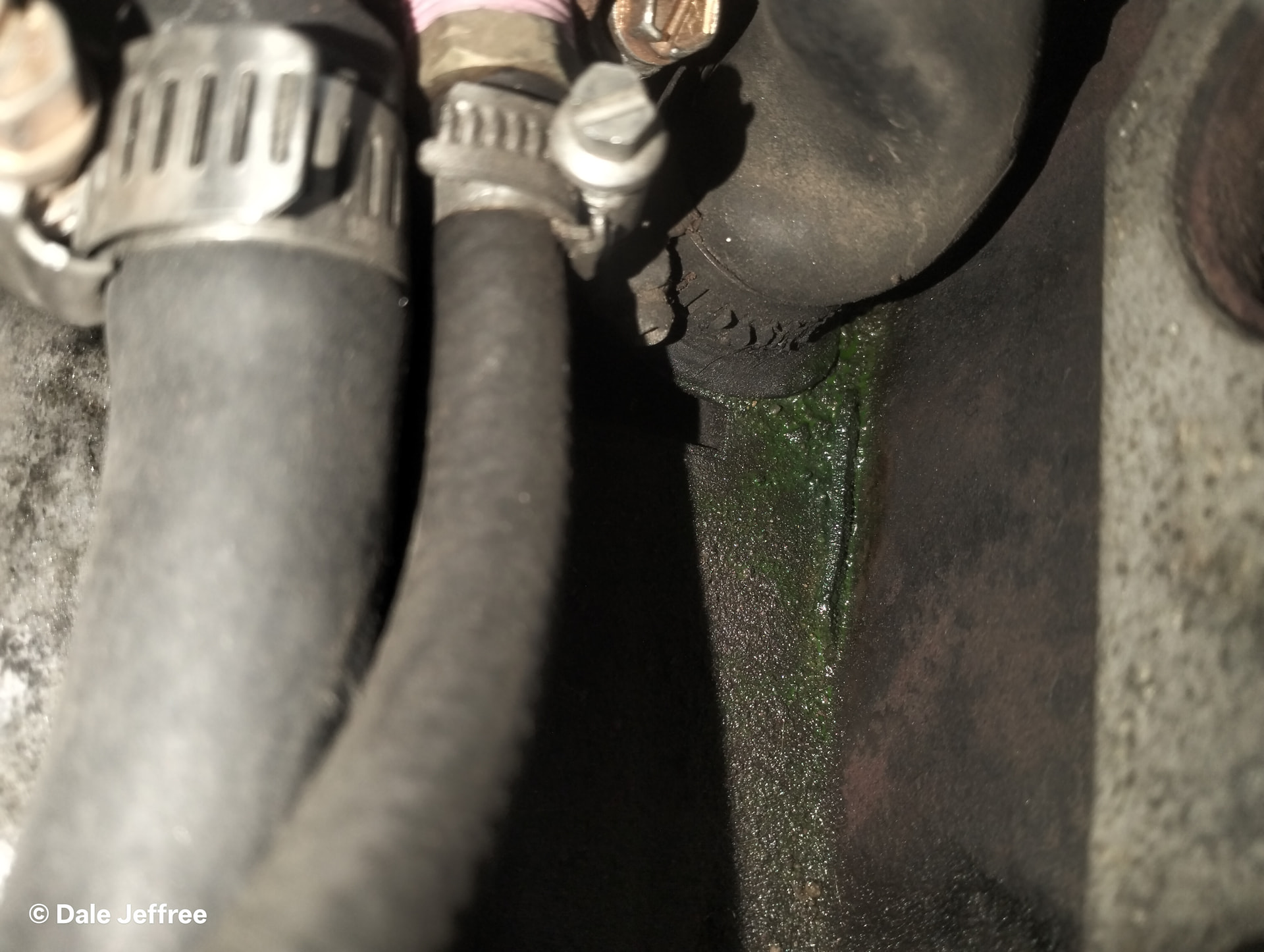

Definitely the head gasket but low compression of the rings is also consuming engine oil, 3000 km and a one litre of engine oil missing.
Milkshake machine. ![]()

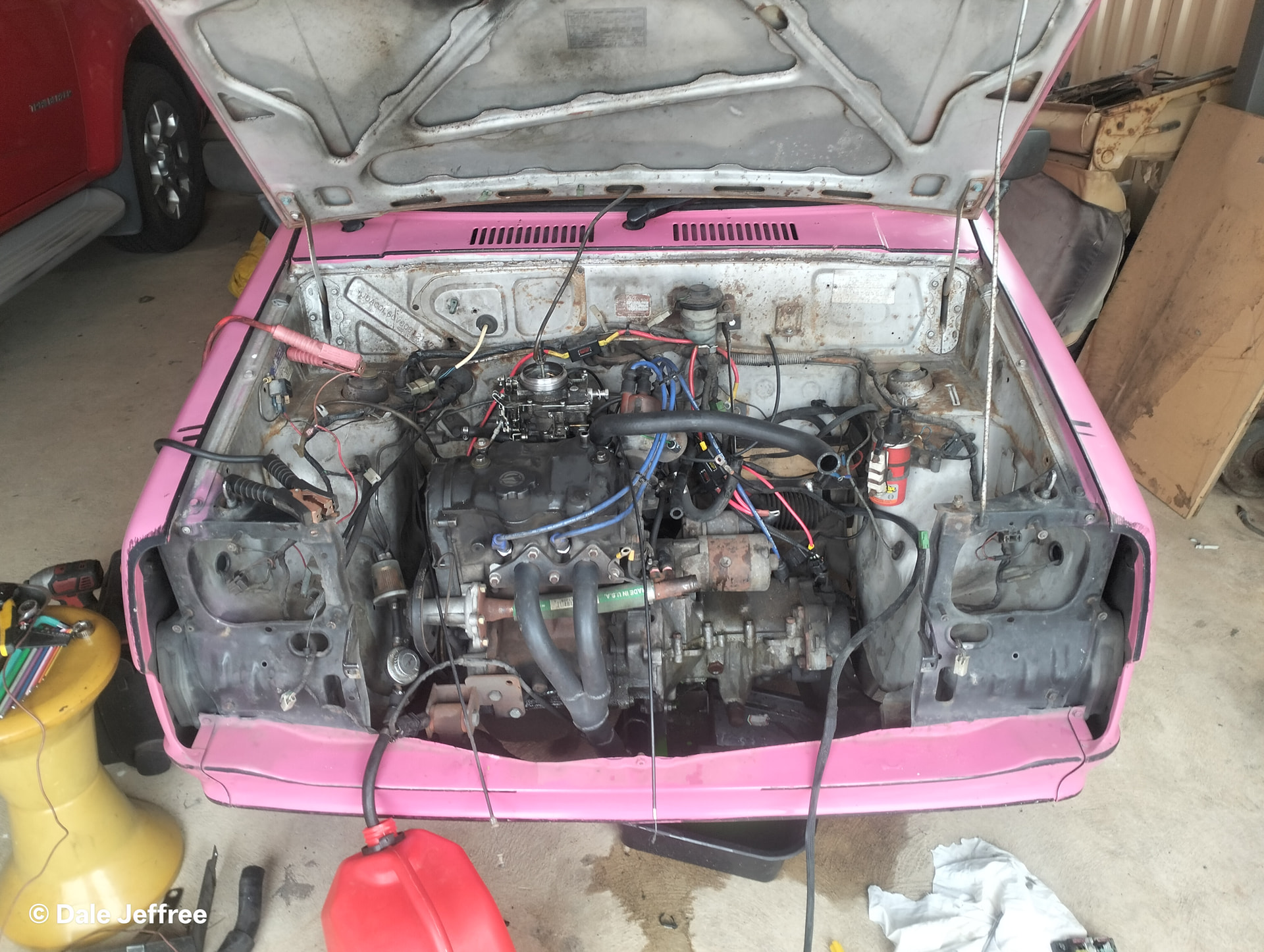

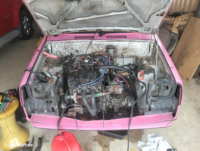

Seeing as it will cost too much to go forged rods and pistons on the two cylinder. I’m pulling the engine out.
When in doubt, engine out.
There was a lot of leaks of everything from everywhere.
New engine is lighter, much lighter. Just 45 kg, the old engine was 52 ish kg.
If I knew I probably would have done the swap years ago.
Im pretty excited to see this happening.
