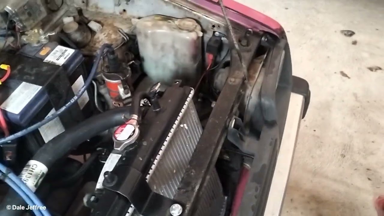

I fitted the M101 Sirion GTVi radiator to the Handivan. Video explains it all.
will watch soon and will comment on your vid on youtube

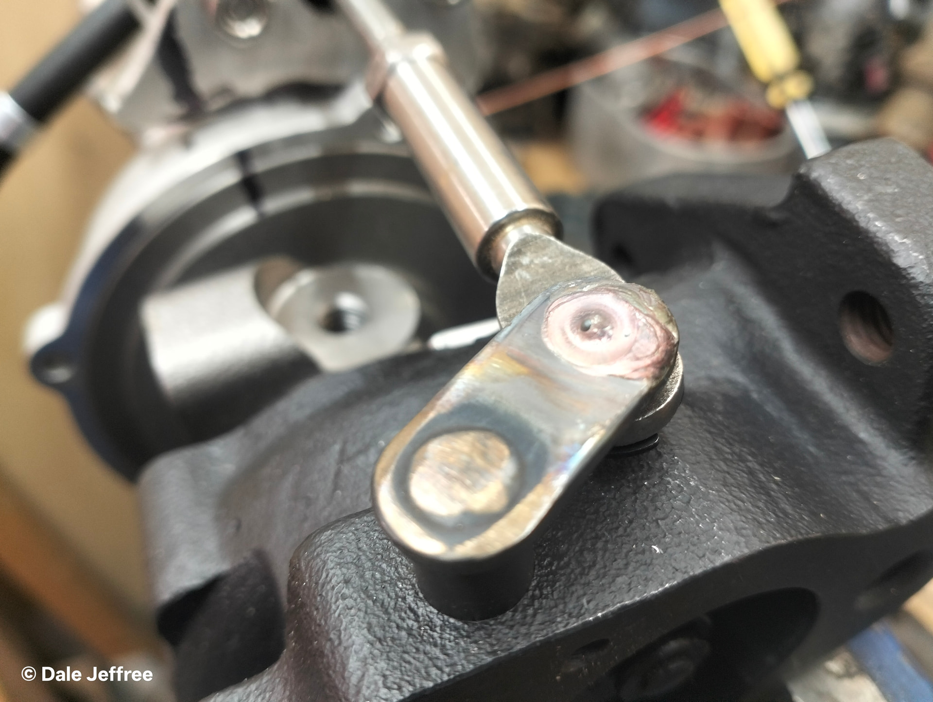

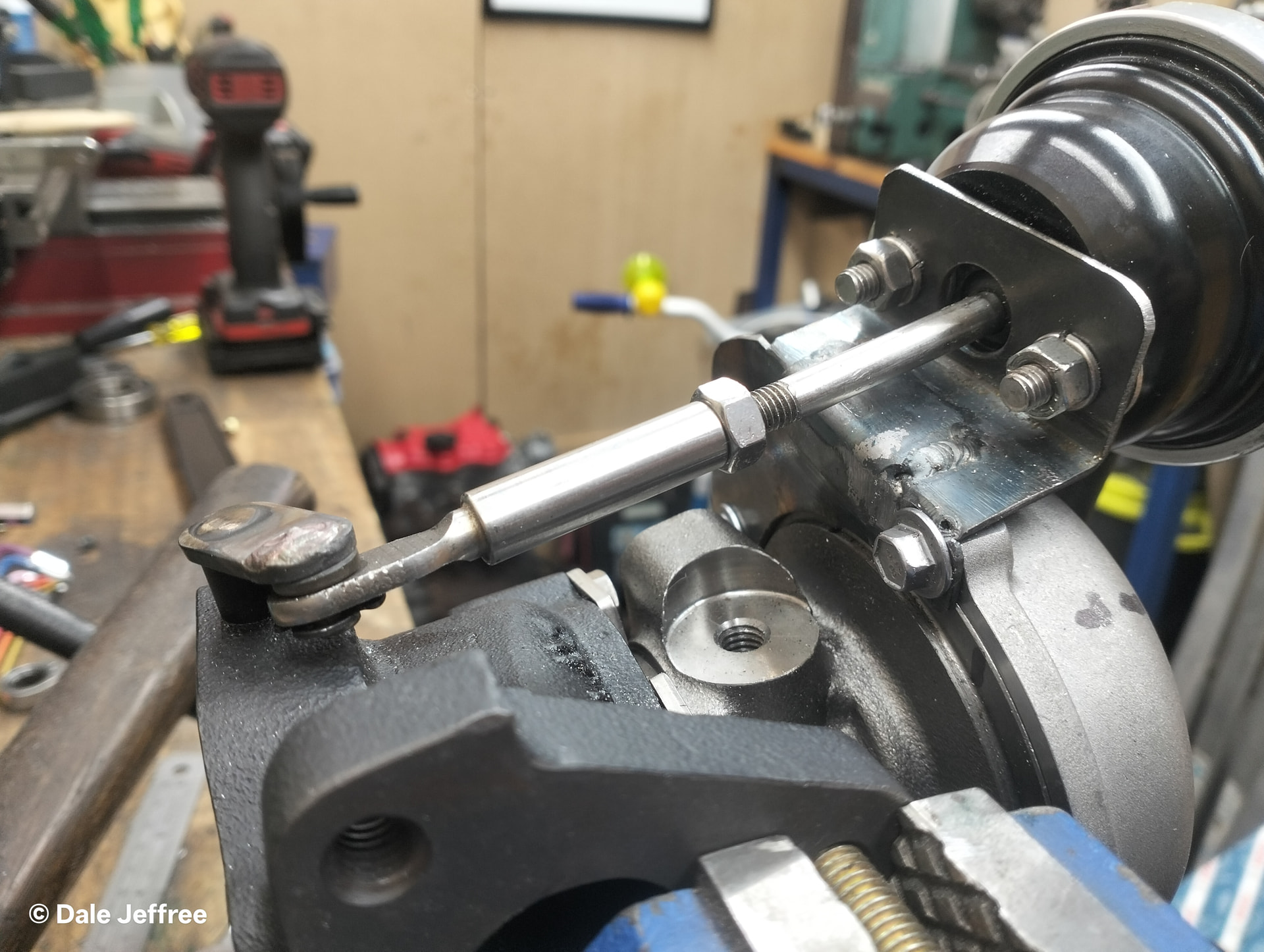

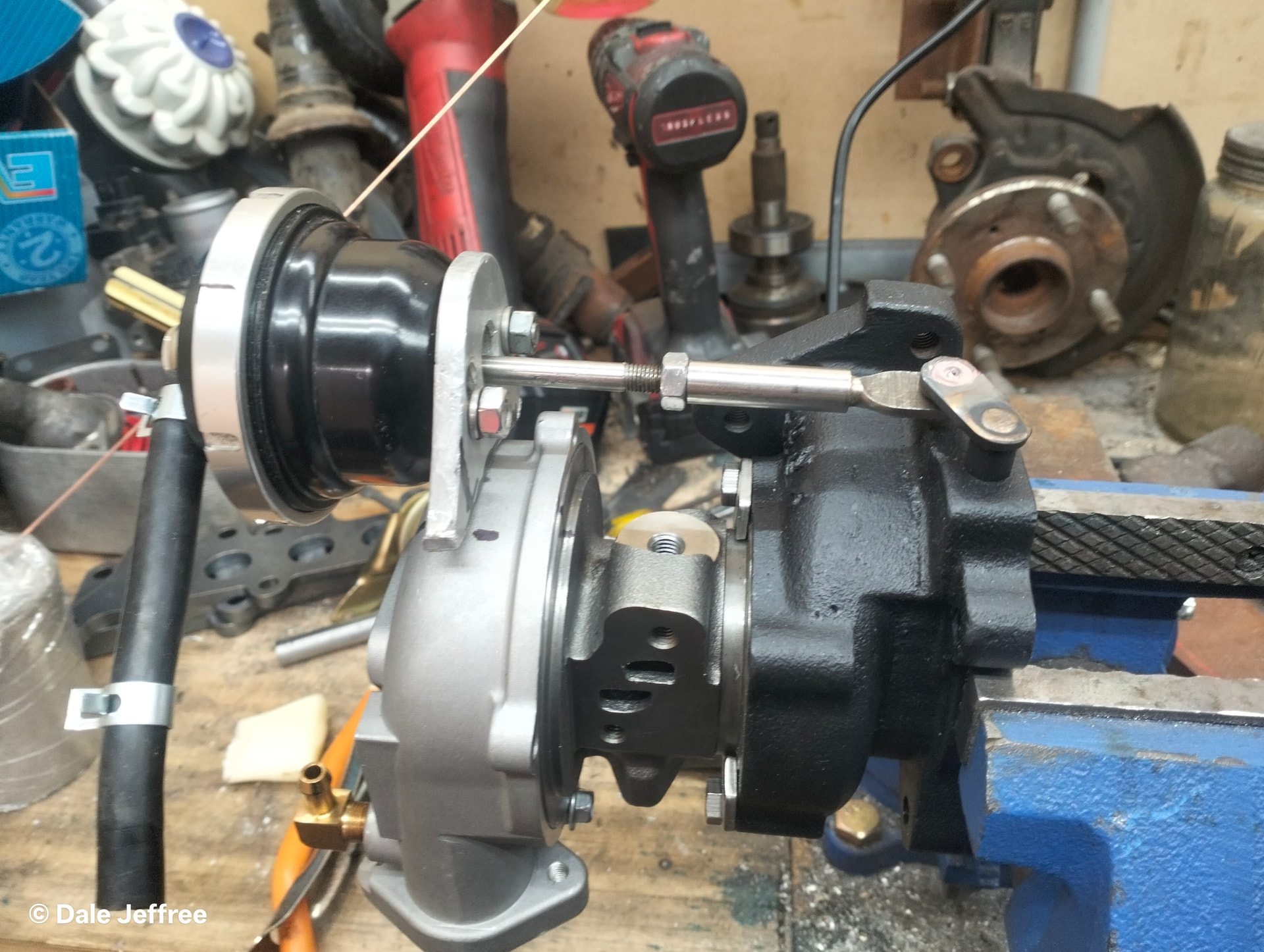

This is the most overkill on a cheap turbo ever. I ported the exhaust wastegate hole from 11 to 16 mm, there is plenty of overlap with the wastegate flap.

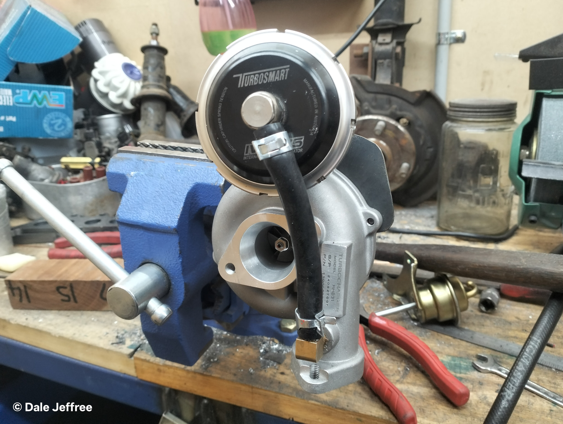

I bought this Turbosmart IWG75 off marketplace for $50, it needs a 5 psi spring.
couldn’t you adjust boost with a bleed valve?
You can easily adjust boost pressure upwards but not downwards, to my knowledge.
Correct.
The bleed valve is essentially stopping the spring being effective.
yeh that makes complete sense. I had a durr moment I guess. lol You bleed off air to increase psi so the gate stays closed.
Not a bad effort, pretty easy to do.

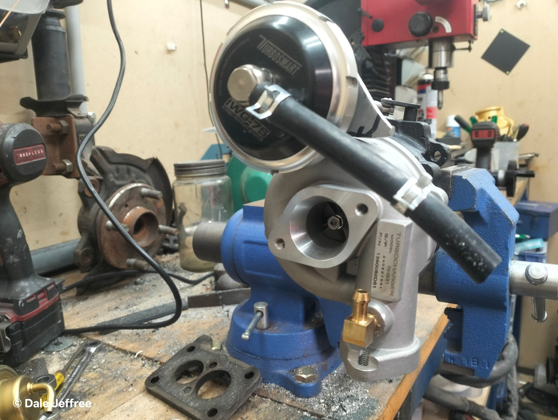

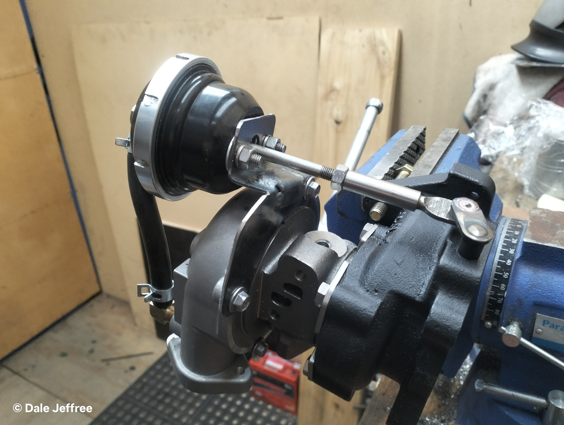

I need to make the manifold, and I’ll jig it on both the engine in the car and my engine in the shed. I can use the shed engine to make the oil feed line and I have a spare sump at work for the oil drain work to be done on.
I installed a 3 psi spring in the Turbosmart wastegate actuator, I can hold double the spring pressure which is good because I definitely don’t want it over 6 psi on the standard engine.

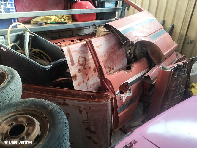

I need to get my hands on the L60 shell I pillaged the suspension from.
why you need another shell? what whitchcraftery are we looking forward to seeing?
The shell is absolutely buggered.
I only need the engine bay section to jig from, so I can keep the Handivan going while I get ready for the conversion to EFI.
It would also be handy to be able to jig E series engine and gearbox mounts into.
well that makes a lot of sense and good thinking. :slight_smile:

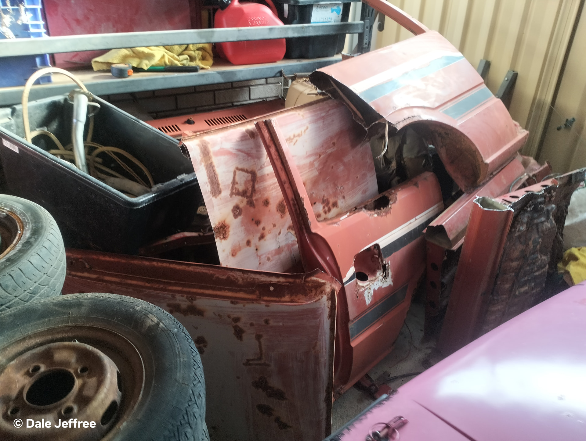

Bought home some parts to dismantle. I really wanted the front end, now I can fabricate engine mounts and check 3d prints and design parts to fit the engine bay without taking the Handivan off the road.

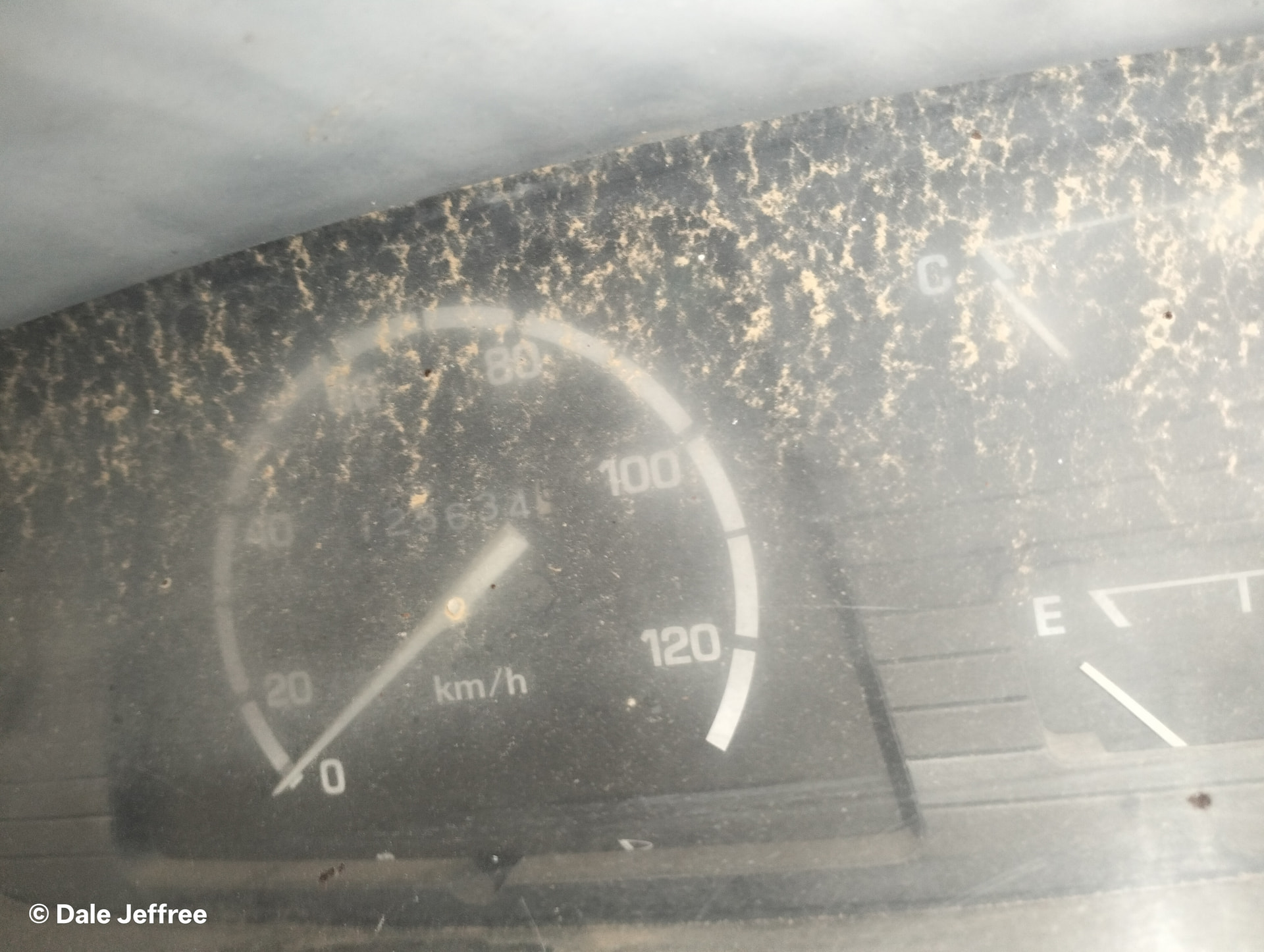

This car unfortunately had only 125,000 km on the clock.
Tomorrow I’ll take parts to the recycling centre. The condition of the parts left over are pure scrap.

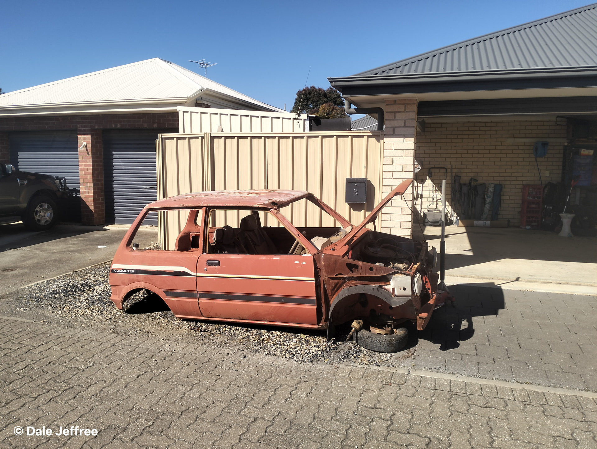

your quicker than me the car Im cutting up is going slowly in the wheelie bin lol. By the time I dumped the shell it would cost me more in fuel to get than what I would get back. So in the bin it goes haha
Great plan btw :+1:
I got $12.40 for the rest of the shell I didn’t want.

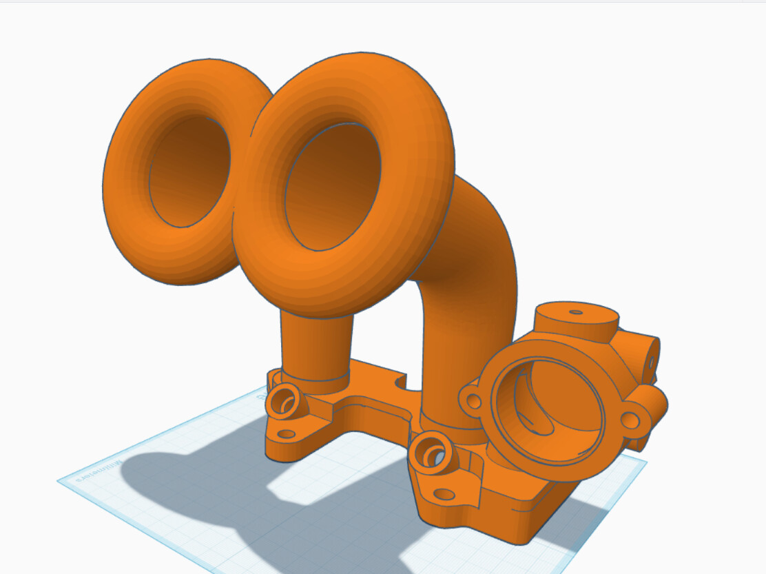

I had a break through with Fusion 360 but am using Tinkercad to align the parts together.

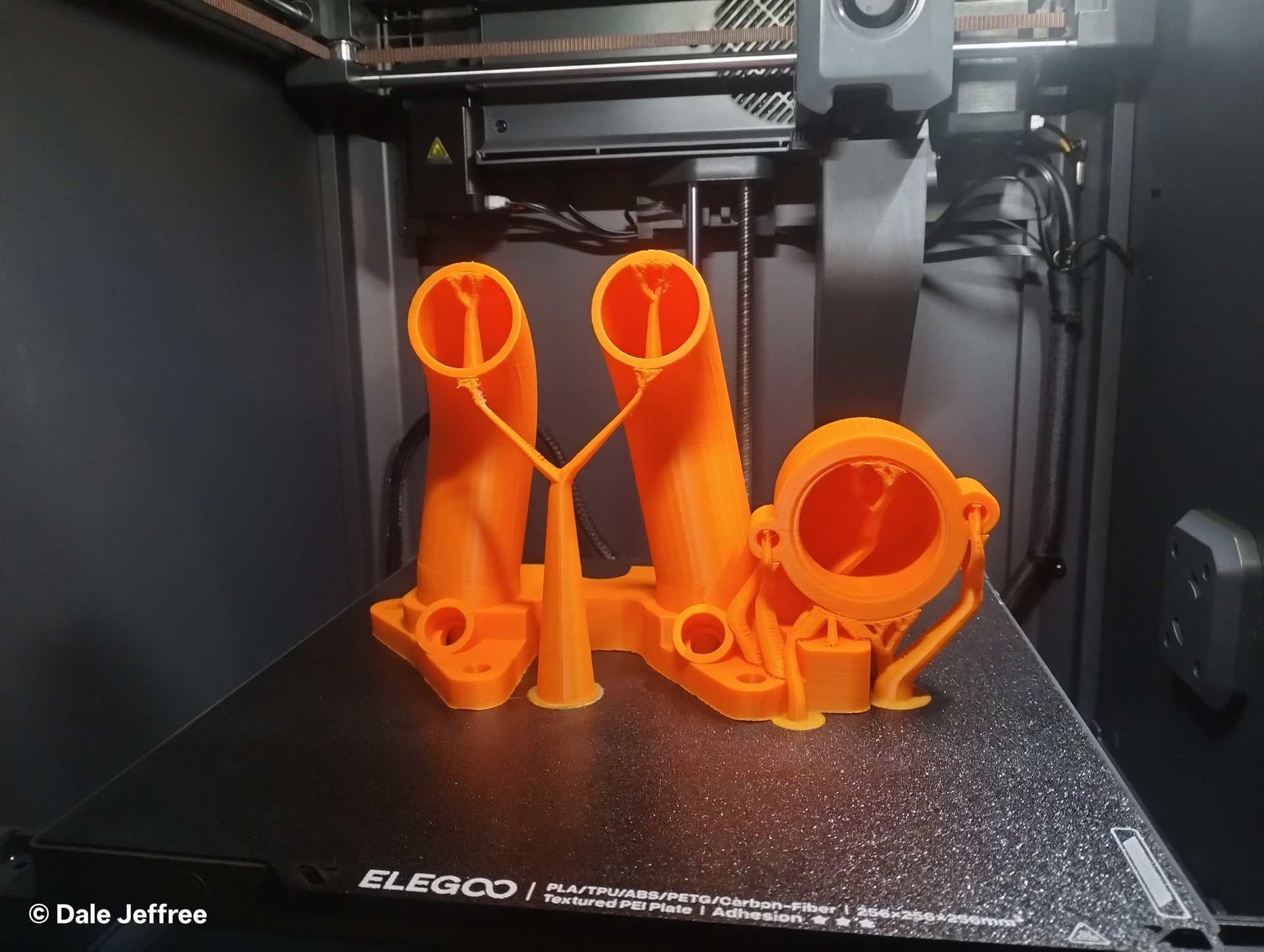

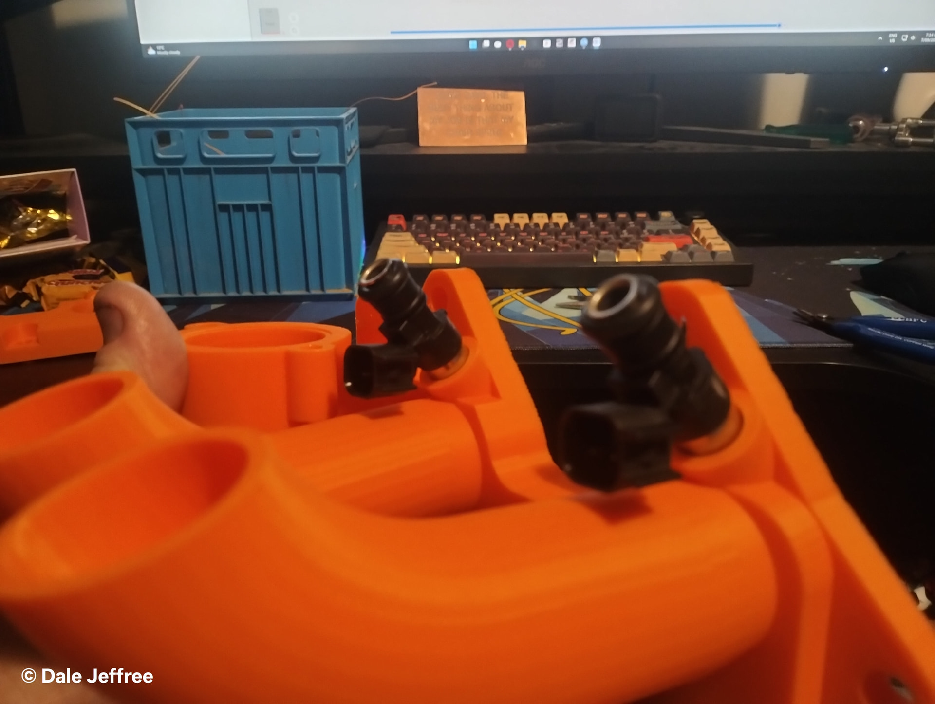

I have been busy, and while this isn’t done yet. Once its printed in aluminium, I will complete the manifold with aluminium sheet metal.
