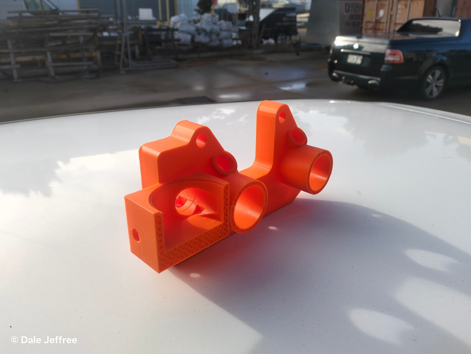

I’m spreading myself thin at the moment, I’ve been working on the EFI manifold for the two cylinder.
This is version 2 that failed to complete over night due to filament tangle.

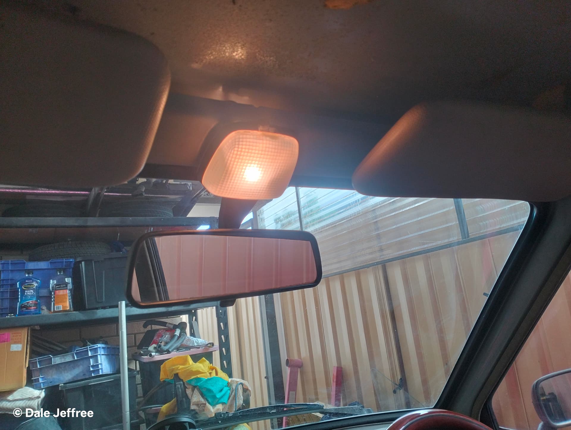

Upgraded the L60 rear view mirror to L250, I also ran the wire for the light again (for some unknown reason I took it out 6 years ago).
I was going to 3d print a wedge, and then the idea of machining it from a chunk of aluminium came to mind. I didn’t have any spare aluminium chunks to machine down. In the end I made an adaptor using 4 mm aluminium sheet. I had to hog some pockets in the light but if I had M5 countersunk screws that would have been a better option. I might make another and use the correct hardware but at the same time I think this is a solid win.

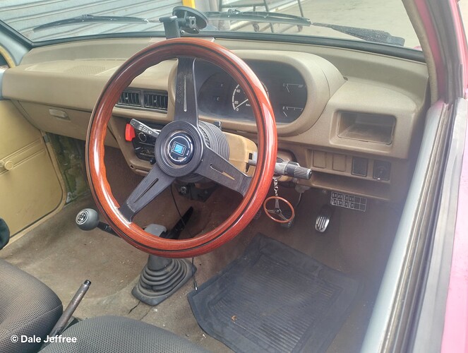

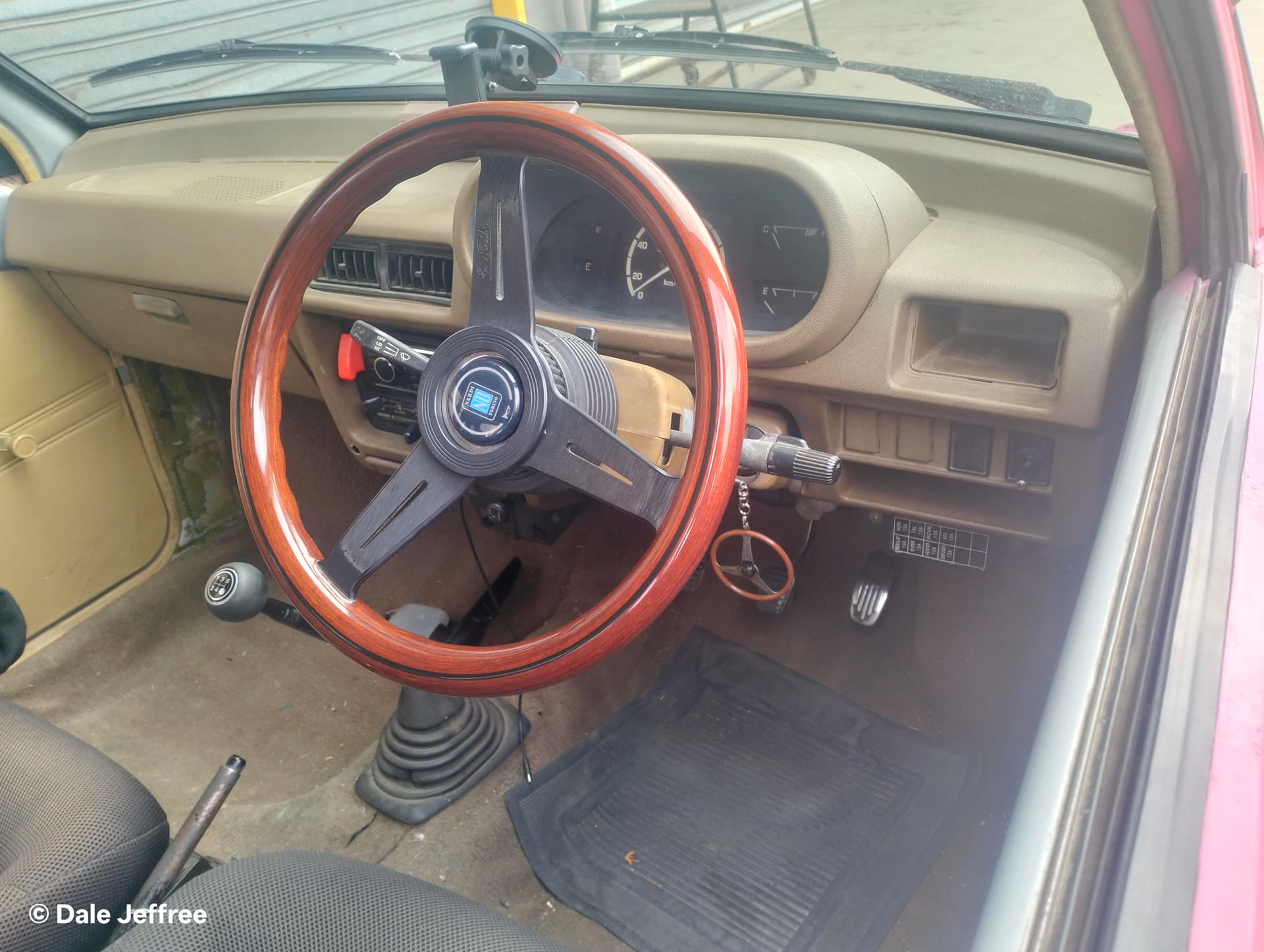

Friend went to Japan and got me a keychain of my own steering wheel.
nice work and job done. love the cute key chain. Dare I say they look Wheely Wheely good together?

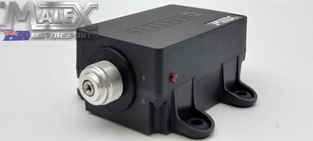

So the Speedometer cable snapped on the Handivan again, which confirms the outer sheething is damaged. I have bit the bullet and I have ordered a Speedbox by SpeedHut. It’s a digital speedometer drive that gives speed signal from both GPS and VSS (vehicle speed sensor).
It should arrive sometime during the week.
Very interested to see how this goes. Intrigue and anticipation will be building.
Future proof for any engine/gearbox combo.
It’s in and working. I received the package from Malex Motorsport in two business days by Wednesday 3rd of June, it arrived with the incorrect Speedo drive. I emailed them that night and by 7:45 the next morning they had express posted the correct Speedo drive out, and I received it by Friday.
Customer services is second to none.
I installed the unit under the dash and between the glove box and where the dash vent used to be (for some reason I permanently disabled the dash vent). Being where it is means I can see the red light and know when it’s searching for a signal vs when it’s connected.
It’s a little slow to react when moving off and being under 10 km/h. For the most part this is a massive improvement over the factory cable which snapped twice, and the 5 speeds internal speedometer gear on the secondary shaft being intended for 12 inch wheels with a 5.081:1 vs 10 inch wheels 4.933:1 diff gears.

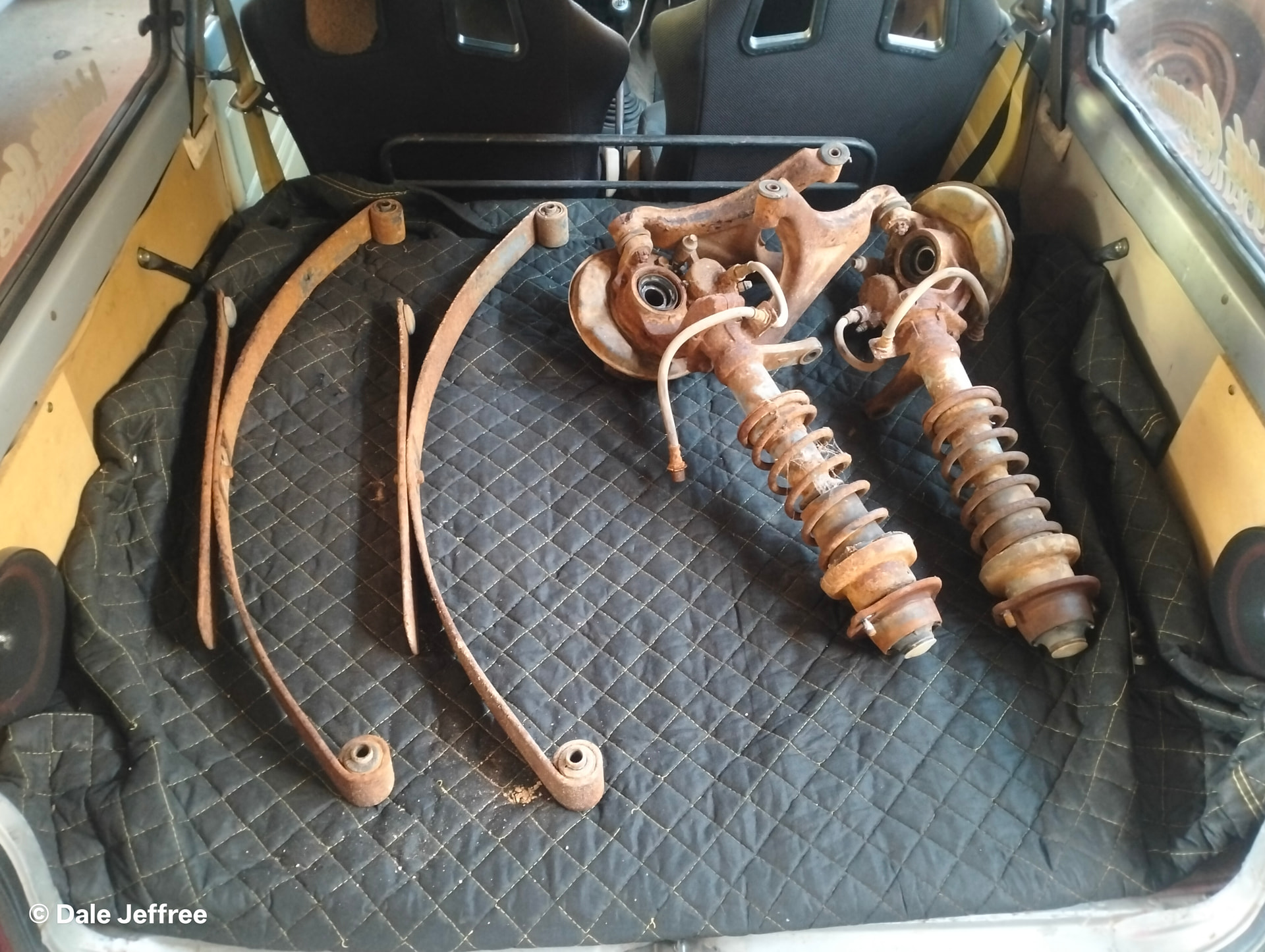

I picked up some spare parts to recondition and modify.
I think if I have the loops reversed on the leaf springs and add an extra leaf I can drop the back end 40 to 50 mm.
For the front struts, I’ll drain the oil, cut the spring perches off and remake them to suit coil over springs in 3.5 or 4 kg/mm. If I install them too low I could add a helper spring to take up the slack under full extension.

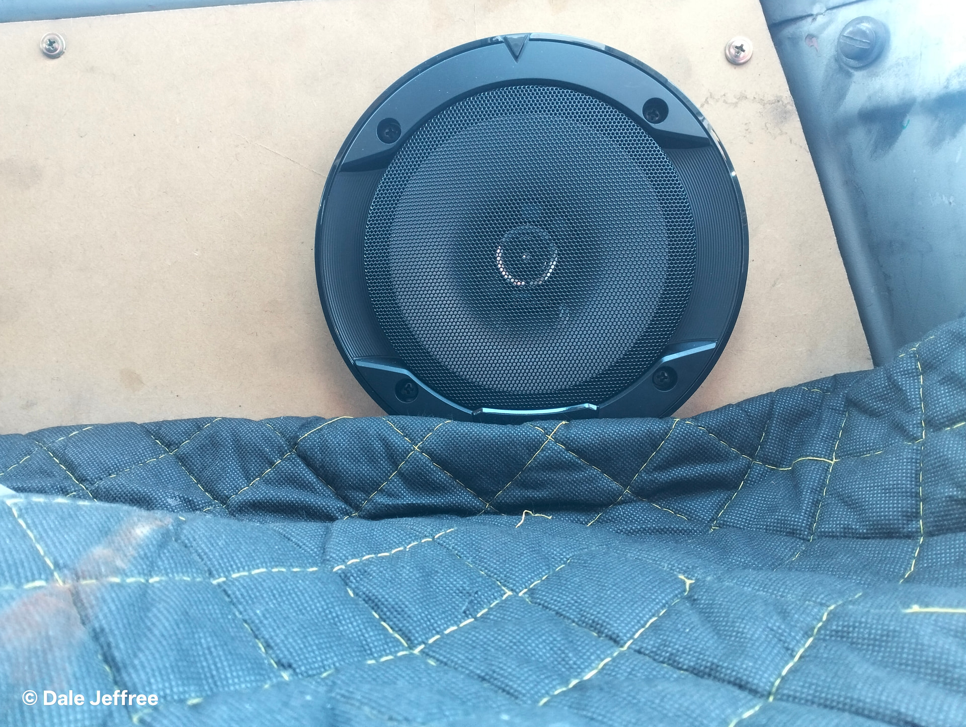

I blew up the old speakers in the Handivan, I had a high pass filter set on them and forgot why I did that. So I turned that off and they lasted 2 days.
I bought and installed some $75 Kenwood 2 way coaxial speakers, they sound way better.

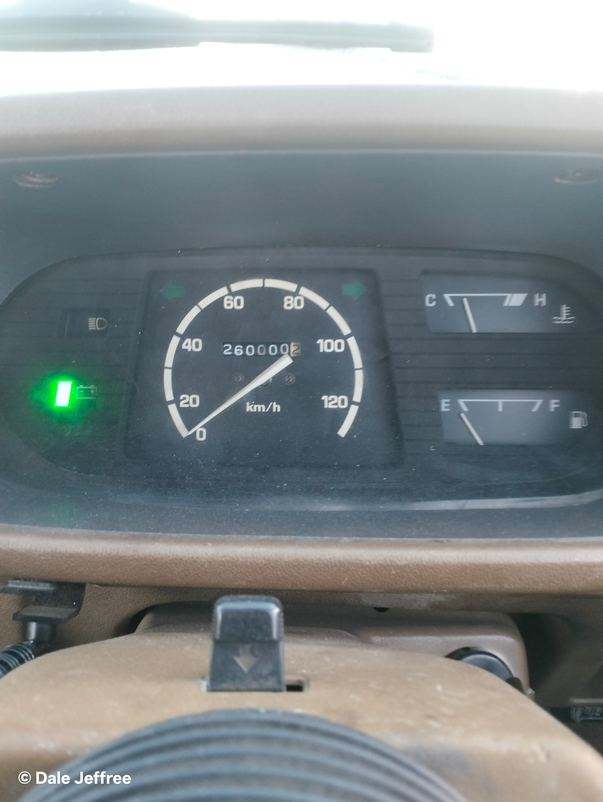

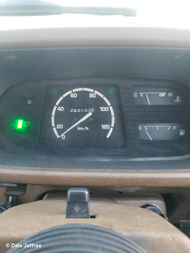

The car has hit 260,000 km
well spotted. :slight_smile:
