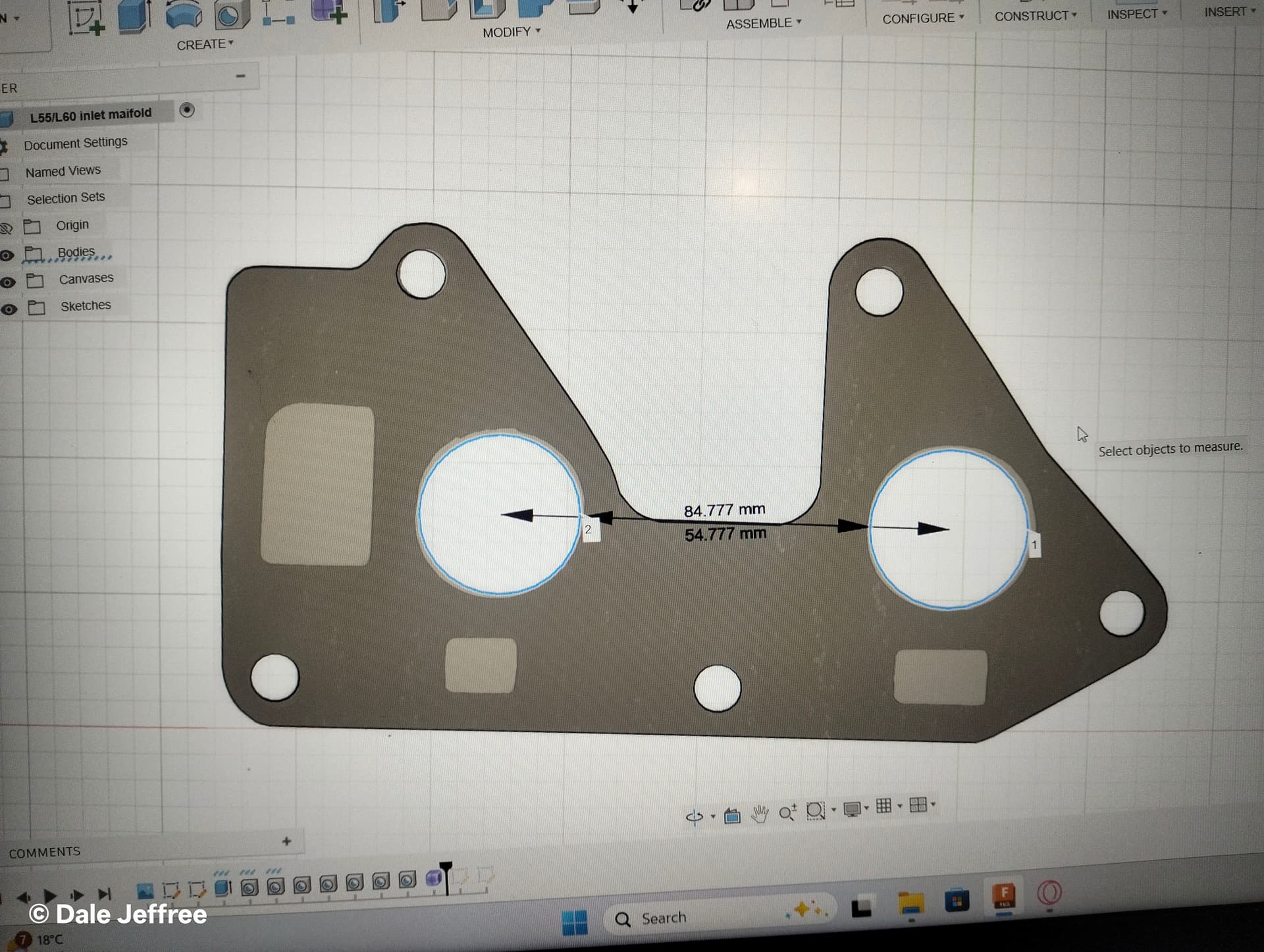

I’ve started playing around with fusion 360 on a personal account, and that has been difficult to learn.

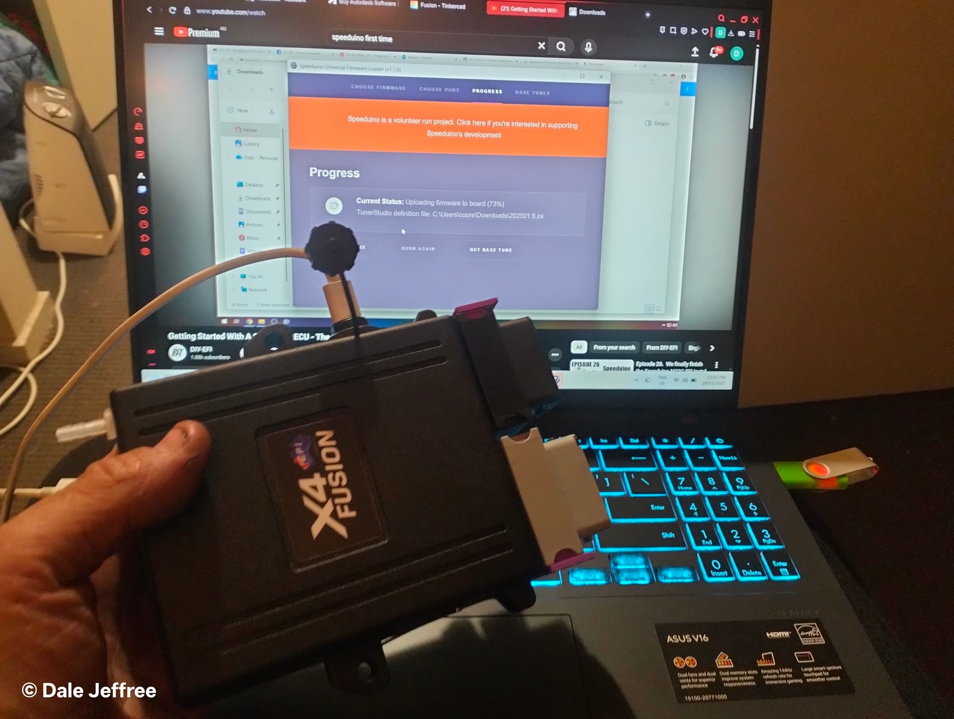

The Speeduino has arrived. I’m yet to pay for Tuner Studio which I will do because why struggle when you can get the perks by buying through the pay wall. The idea of adjusting the cells individually is mind boggling, plenty of help thought YouTube though.
You are doing so well with fusion. I struggled and gave up. I have tunerstudio but I have never activated it as Life happened and things went sideways. I still have the email etc to do so when I get to that bit.
Well done on tackling hard stuff mate.

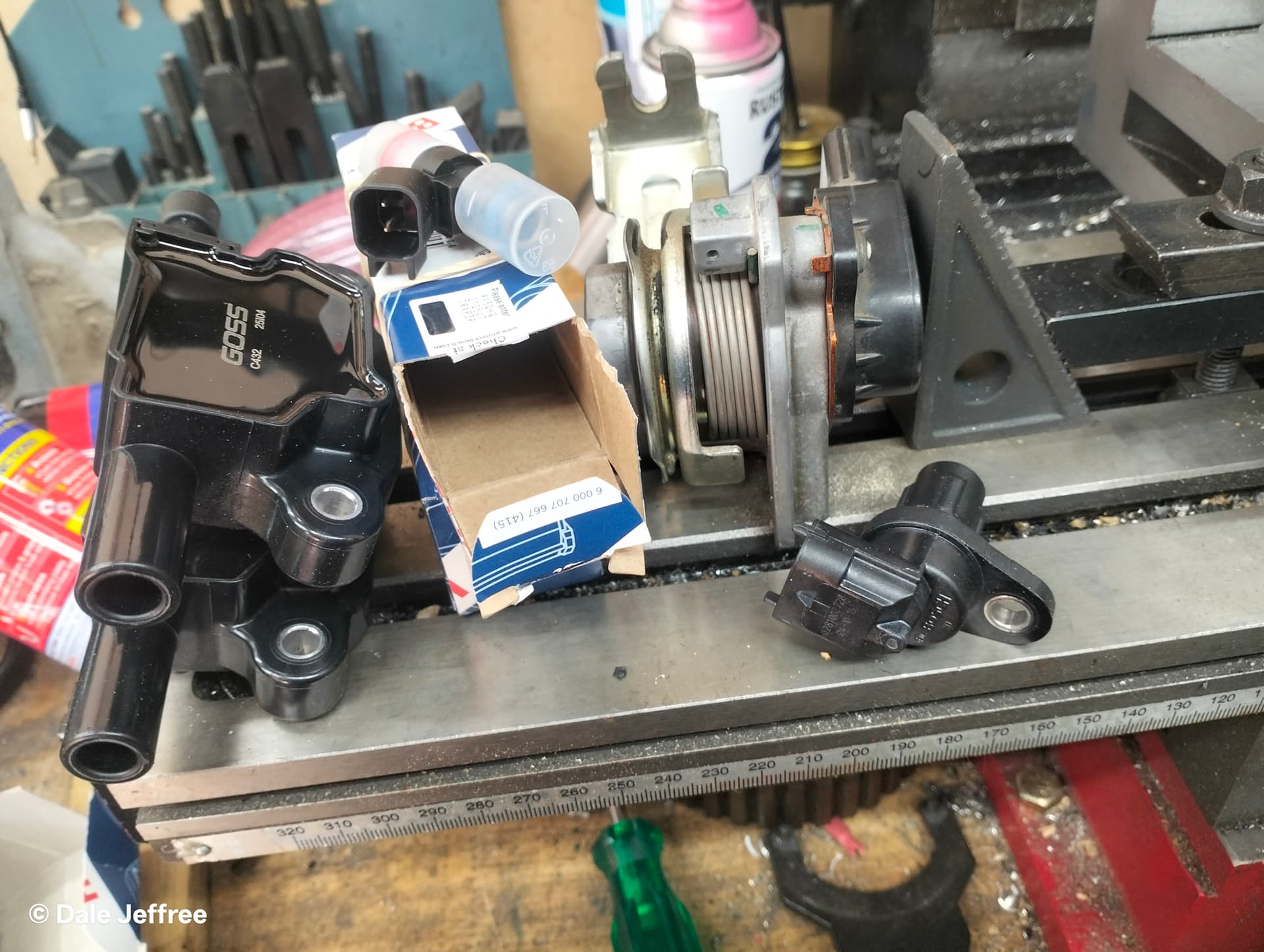

I bought a pair of LS2 coils because they have built in igniters.
Coil = $40 each
GM 4 pin connector $45 each
I’ll be mocking the sensors on the spare engine for now.

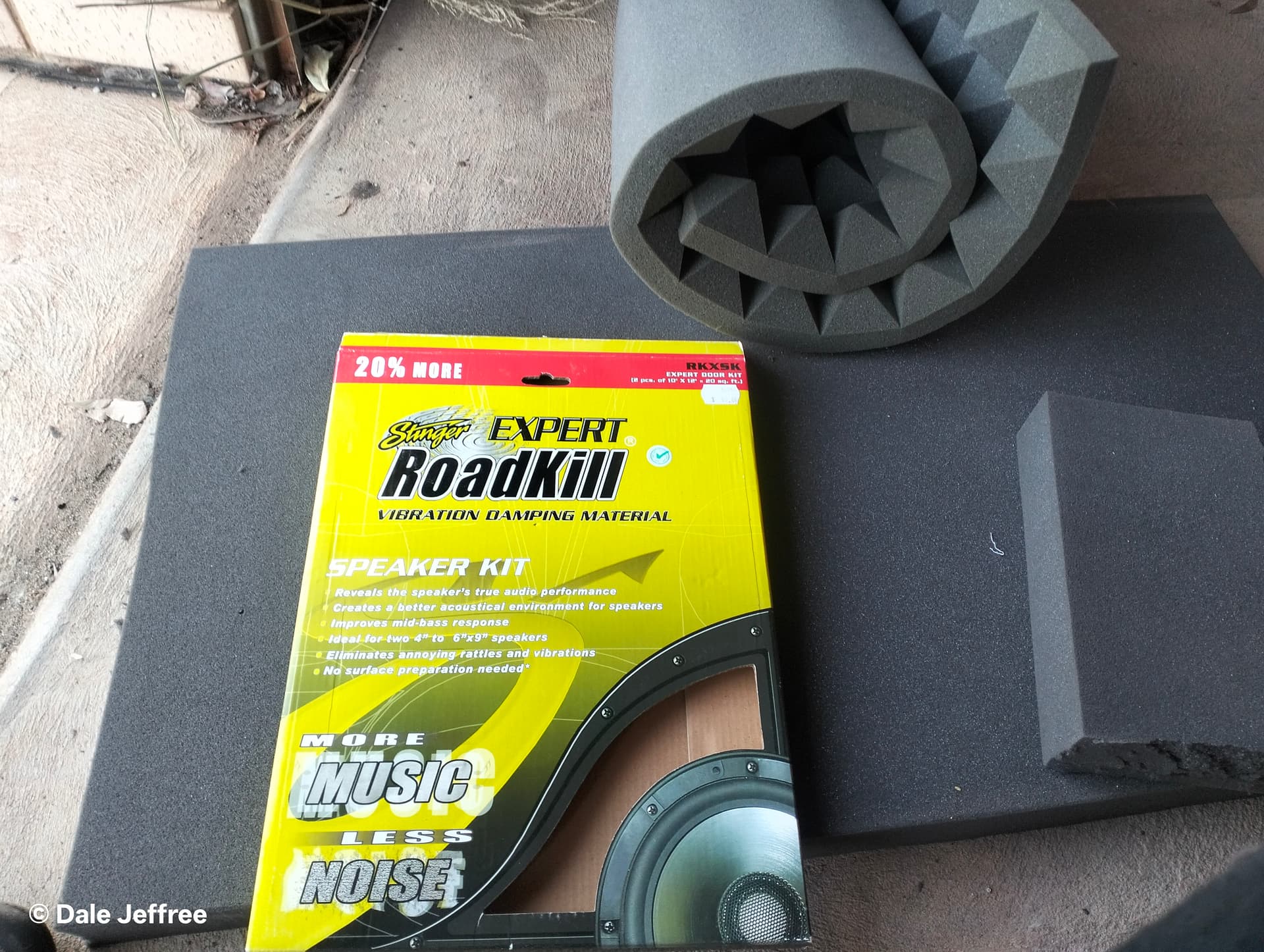

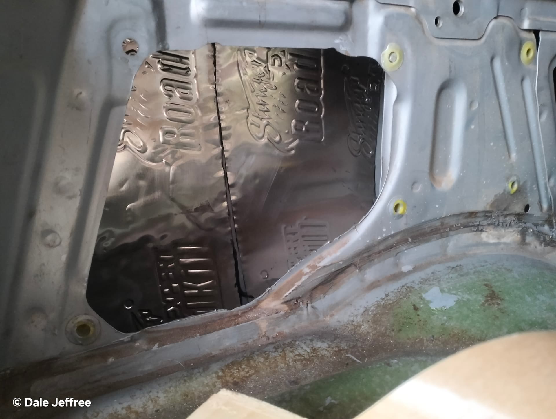

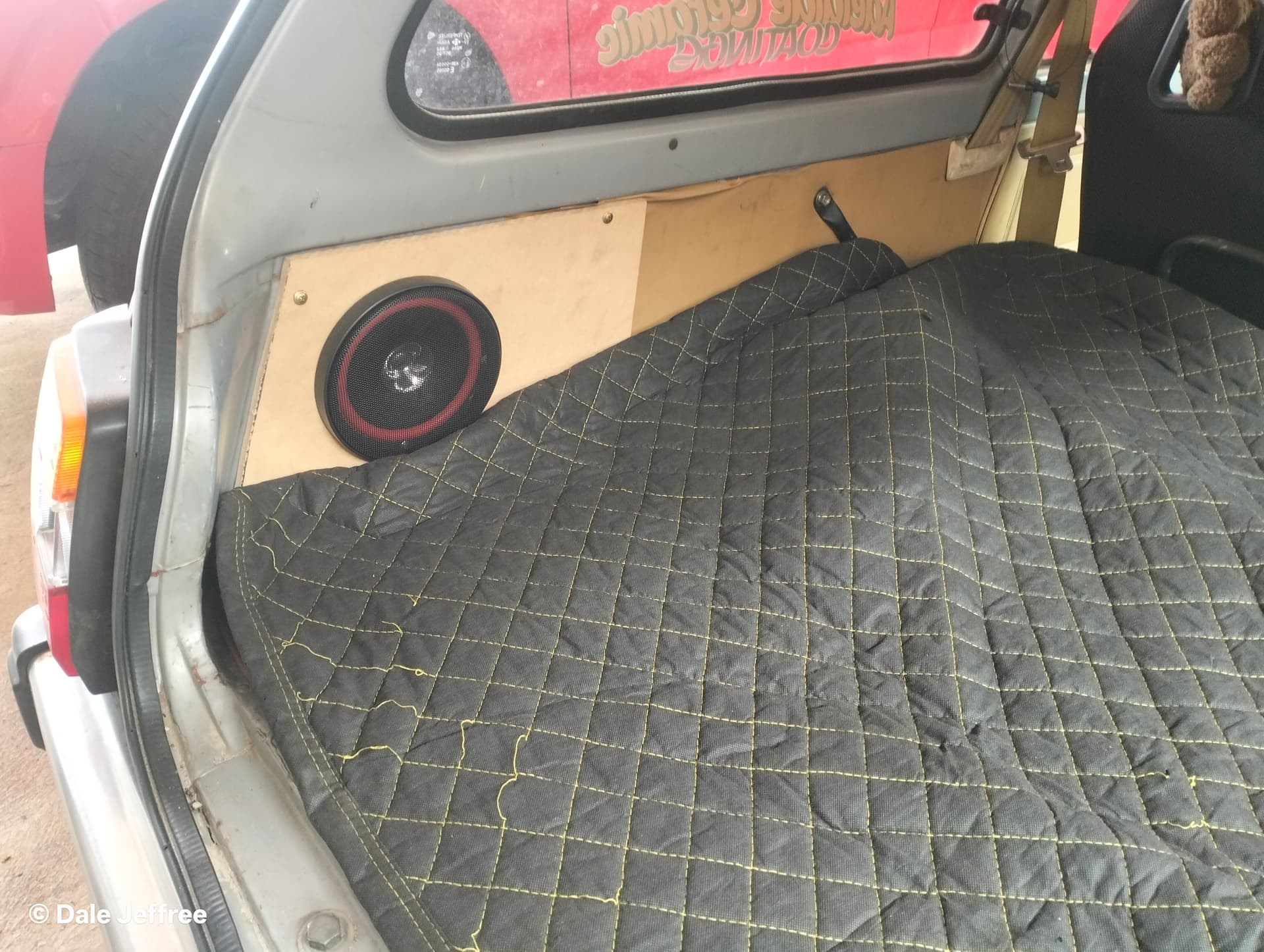

In the effort of making new old stock speakers sound less horrible.

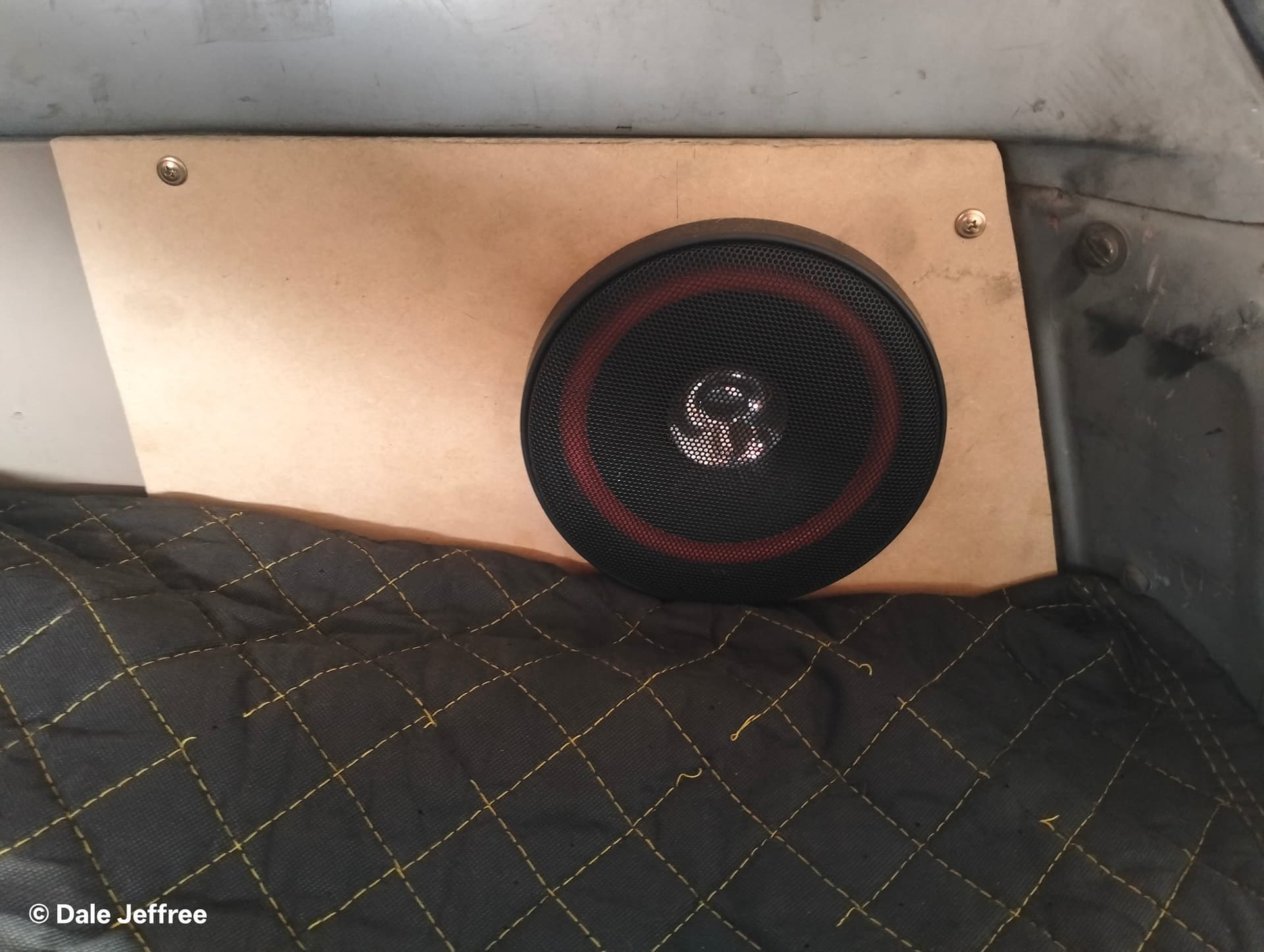

I don’t want to modernise the audio in the Handivan. The 28 year old radio cassette player, and relative period correct speakers.
This is the first time I have used dyna mat in a car for over 20 years. Actually this is the same supply of dyna mat.
In my usual fashion, what we have here is a permanent temporary job. It’ll probably stay like this for some time before the real job is complete.
What I can tell you is cheap speakers have never sounded so good. There is low notes that I would never expect from dual cone speakers. Distortion doesn’t happen until the head unit is on max volume. The volume is much higher than the cheap Jaycar 6x9s I had in there before, which means the 6 inch speakers are a lower wattage that the packaging suggests.

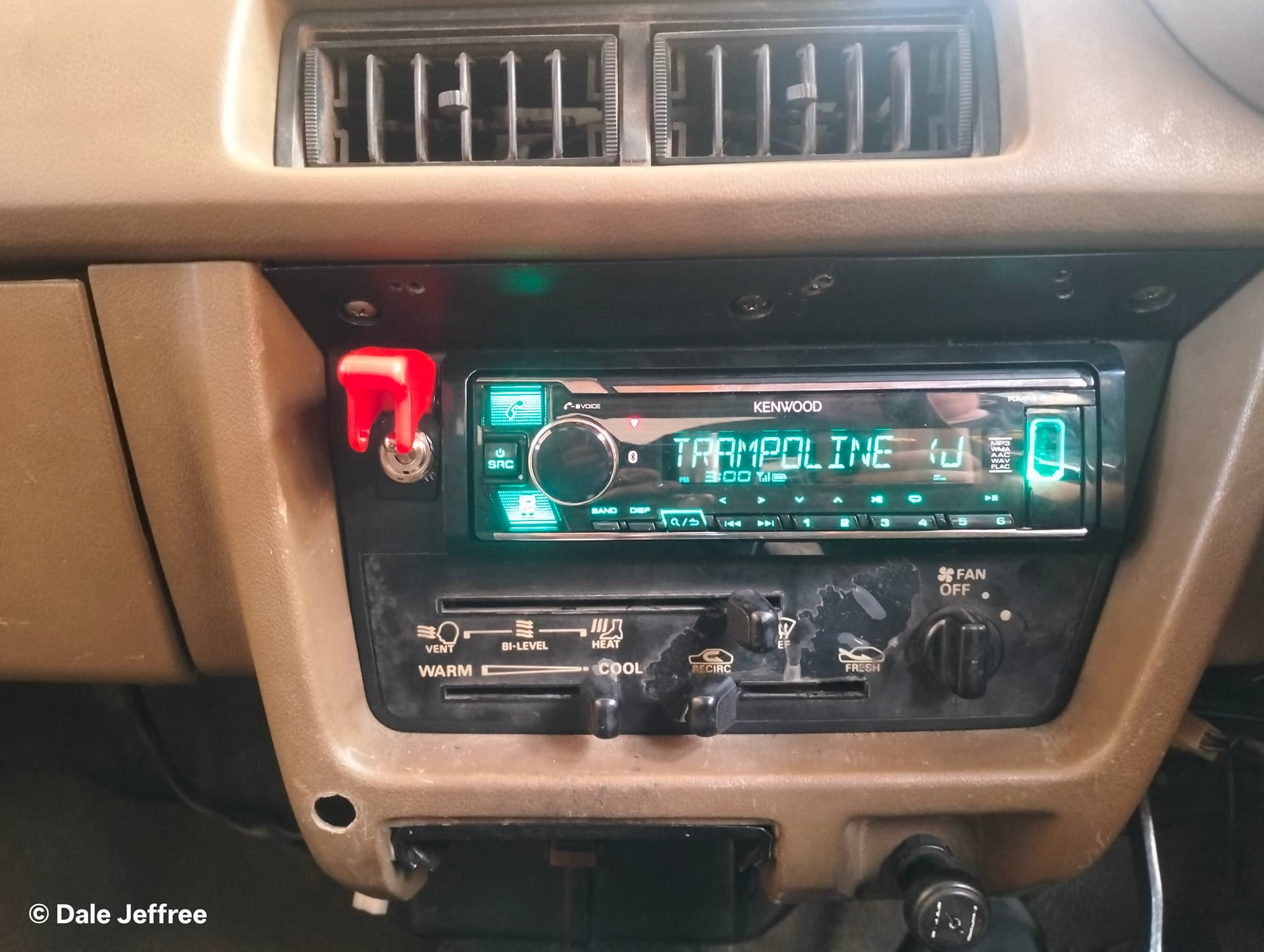

This Kenwood unit is a hefty upgrade from the cassette player. I still want a cassette player down the line or run a “walkman” in to the AUX plug.
The rocket switch is to turn off the radio as the factory loom isn’t 12v ignition switched.
The biggest plus is still having the connection to my phone, having hands free connectivity is a must especially with how much the government will lift from my pocket if I touch my phone.

The reason the tape player became a smoke machine was after fixing the eject button today, I decided to wire it into the car power. Didn’t go to plan - I looked at a wiring diagram and instantly reversed it in my head.

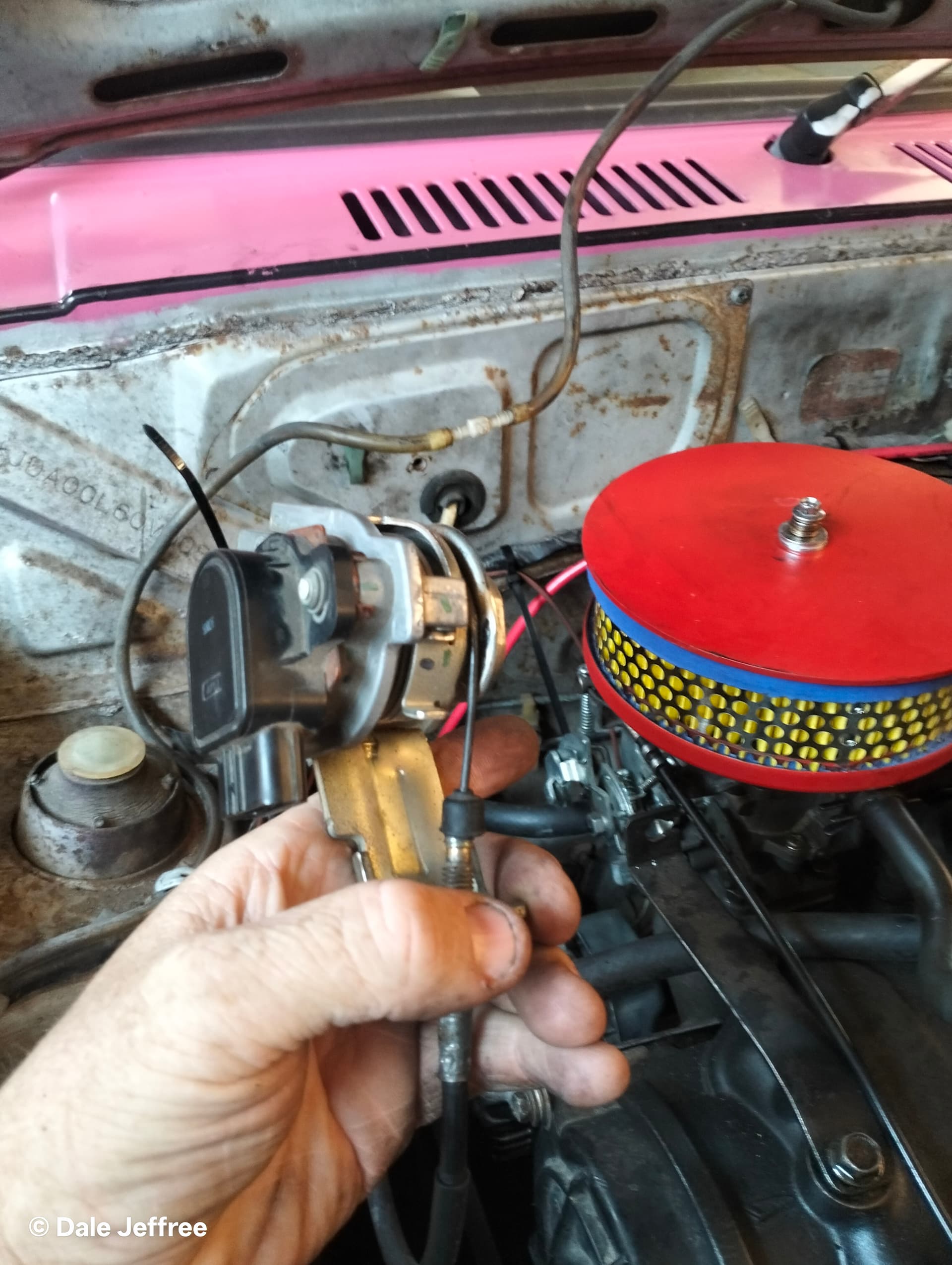

Next piece to the EFI conversion. Analogue to digital converter for DBW throttle body.

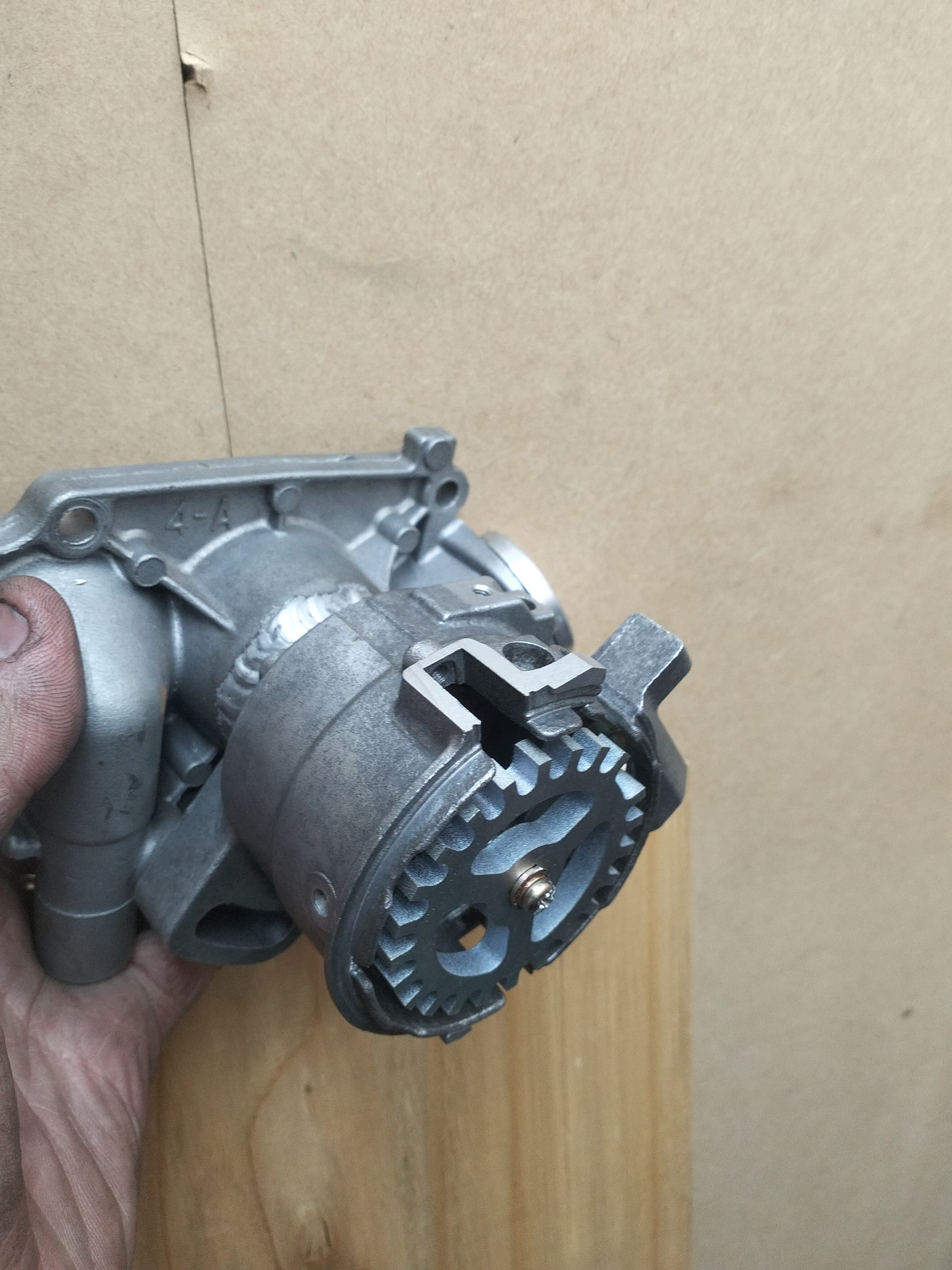

I’ll probably weld the tooth wheel in place. But until the cam sensor is in place, it will be screwed in.
thats a really nice snug fit.
It’s the same trigger that Marty has used on his Mira.
