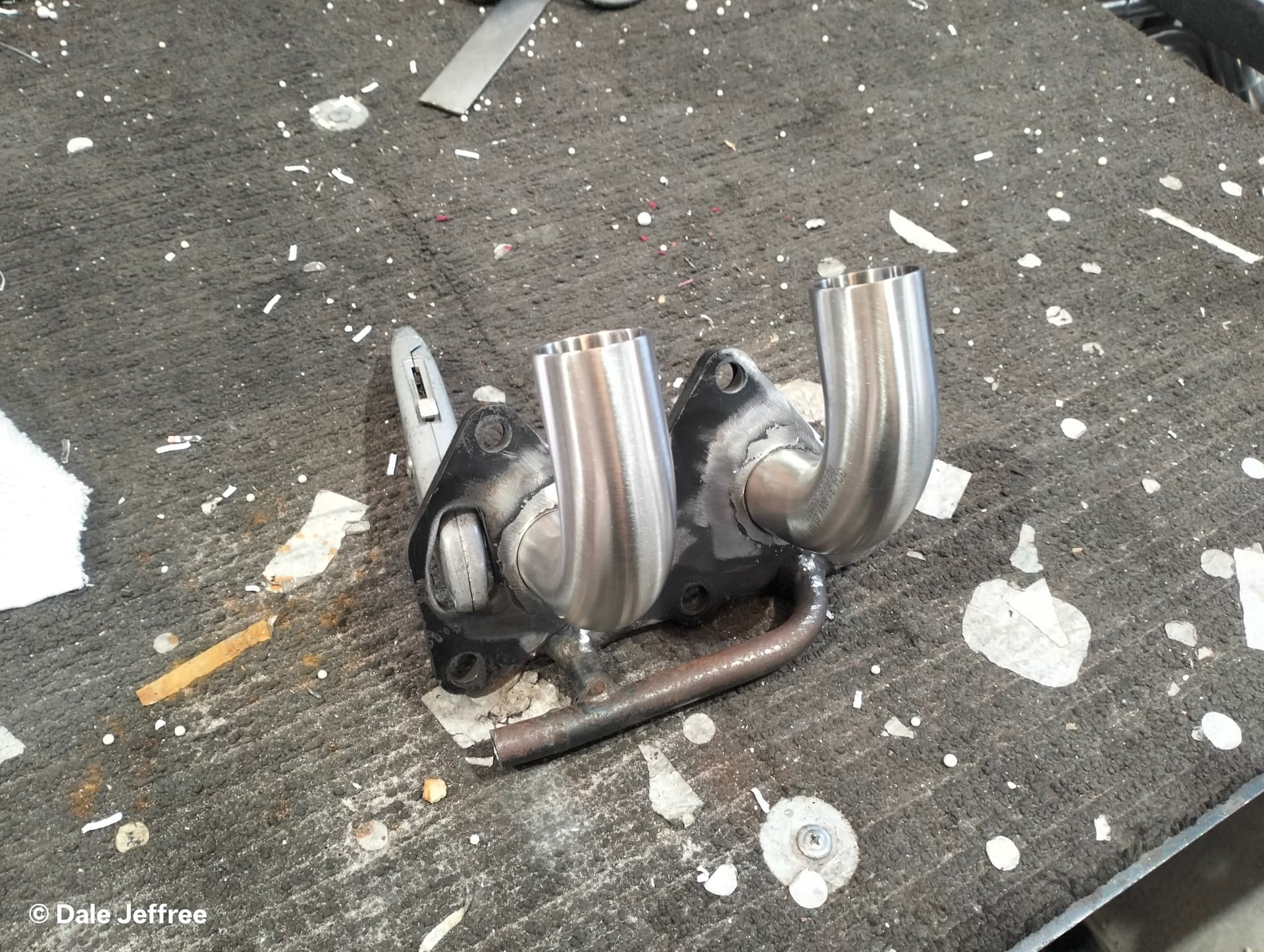

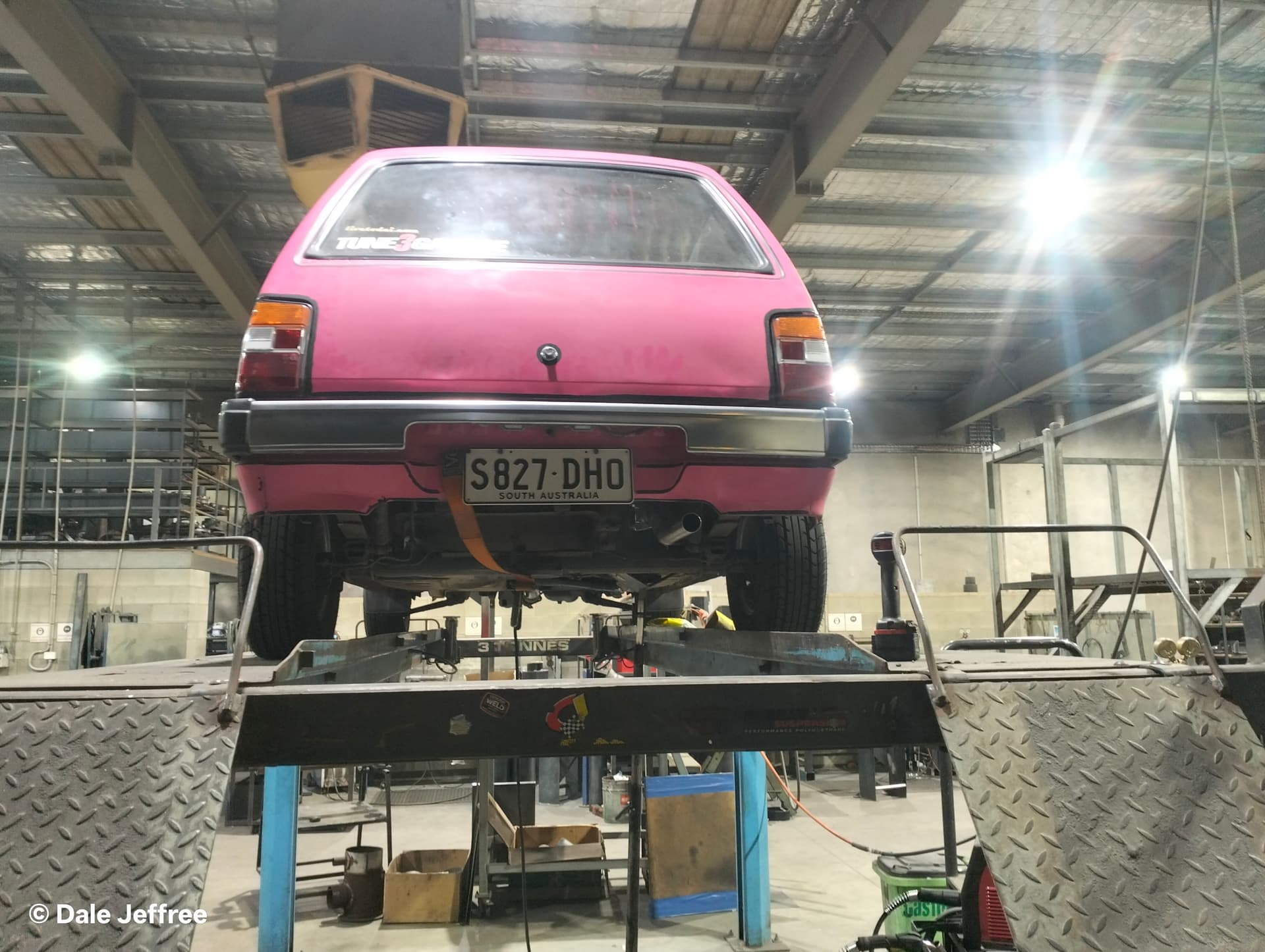

I made a new exhaust. I always under estimate how long it takes to make one. This time I made a hotdog resonator and the muffler is a triple chamber, the idle is typically loud but at full throttle is bearable on the highway.
fantastic that sounds good. It was only harder to start because the camera was there.
The exhaust consists of the headers which are 35 mm primaries into a 38 mm outlet pipe. From there it goes into a flex and then in to the 38 mm hotdog I made, then into the muffler made in June/July. The muffler is 51 mm in and out but some tapered adapters were made to suit. After the muffler the exhaust exits at a reduced 45 mm to a stainless steel tip.
Forget how little they are till you walked over to it. Definitely a good note out of it.
I made a set of extractors from two top stainless steel radiator tubes off a vn commodore. Had the perfect length and bends to come off the heads and under the sump to a two in one.

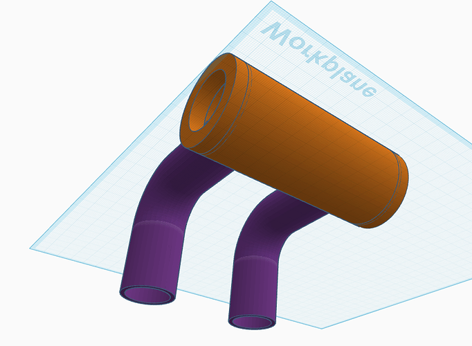

I’ve been playing around in TinkerCAD. I haven’t got the measurements correct but a proof of concept is being constructed. I will get a gasket and see if I can recreate that too.

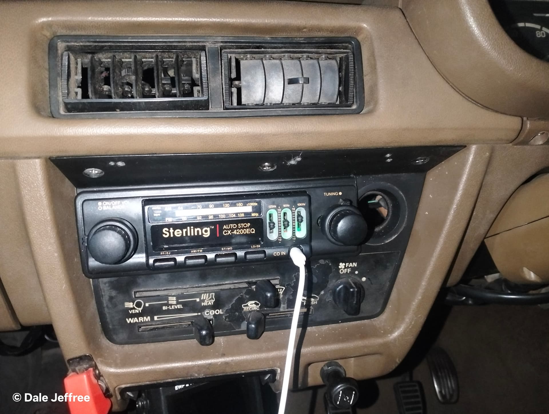

For a while now I’ve been looking for AM/FM radio, I found this Sterling AM FM cassette player on Marketplace for $50. Brand new in box, originally purchased in 1998.

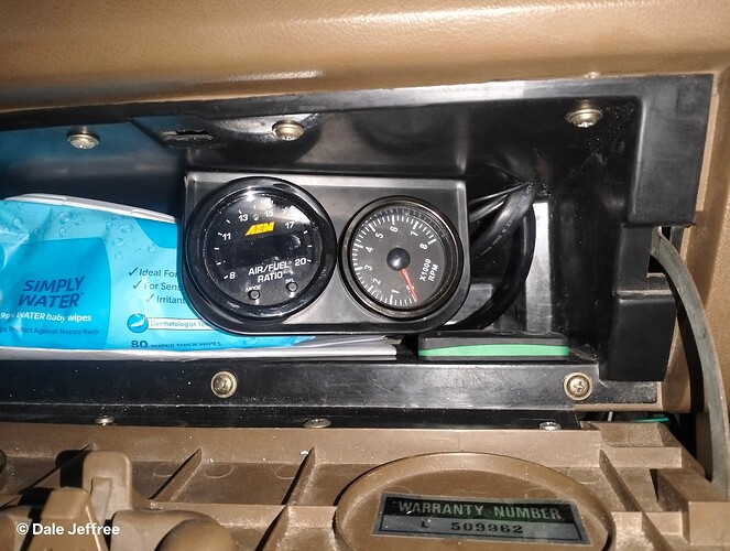

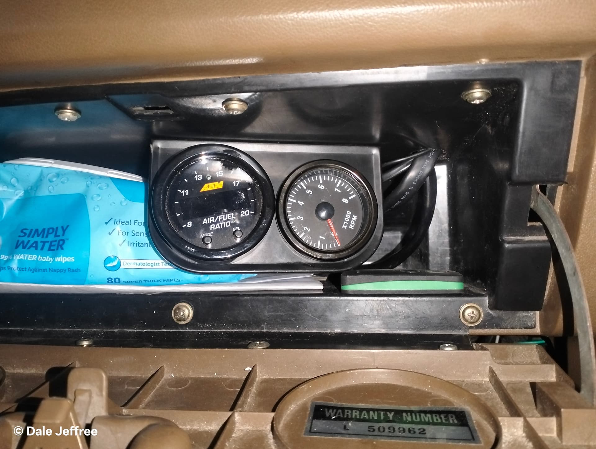

I didn’t want to lose the gauges just yet, so I’ve relocated them to the glove box.
