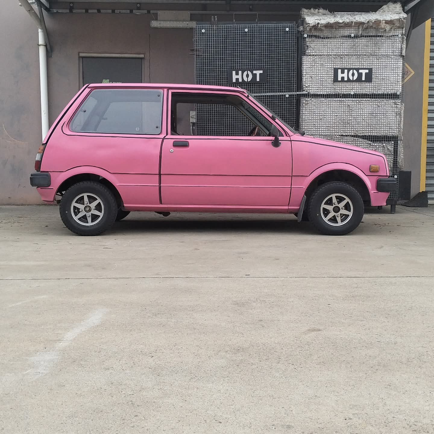

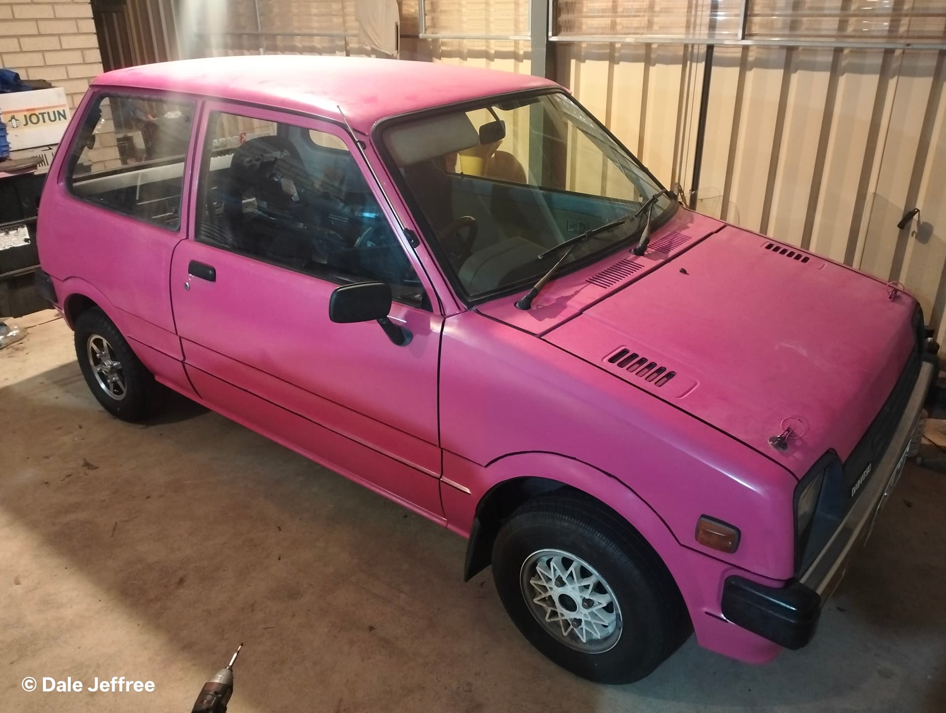

Dale's L60 Handivan
Good to see it going! Does it have a 4 speed box?
Actually I have a late L60 5 speed box.

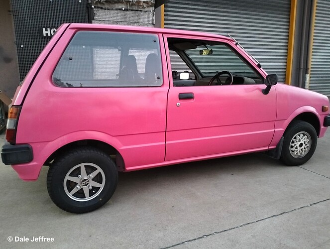

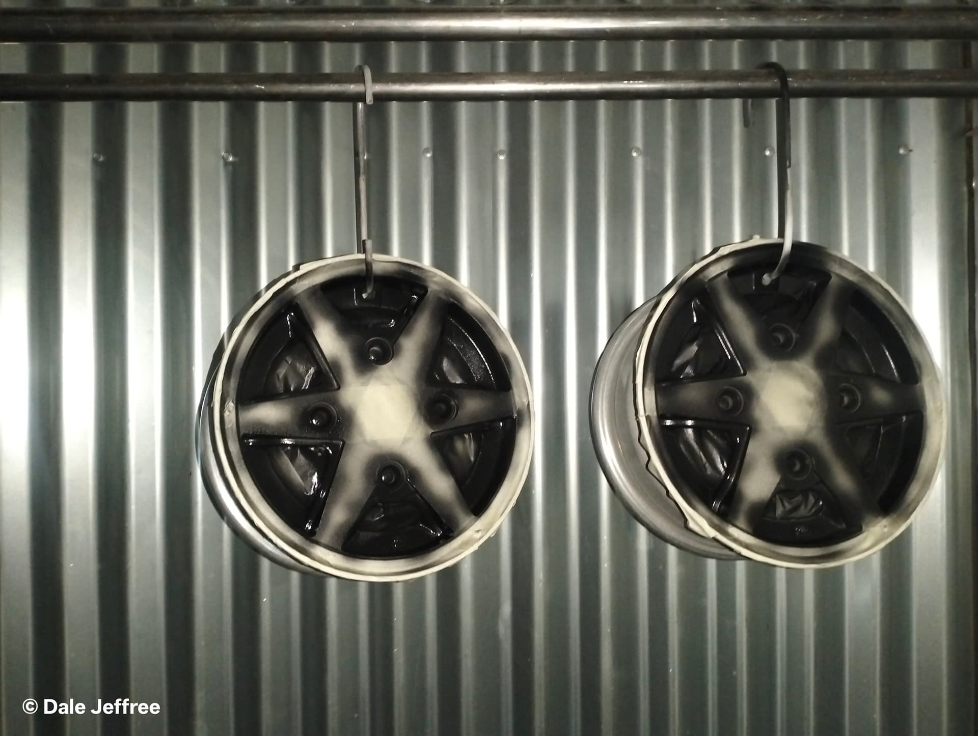

I got the tyres fitted to two of my freshly ceramic coated wheels
Thats always good having the extra gear! How are the ratios? You can always play with tyre sizing.

The 5 speed box is much better than the 4 speed, unlike the Mira the Handivan 5th gear is overdrive. In 4th 100 km/h the engine revs at 5000 rpm, in 5th that drops to 4000 rpm.

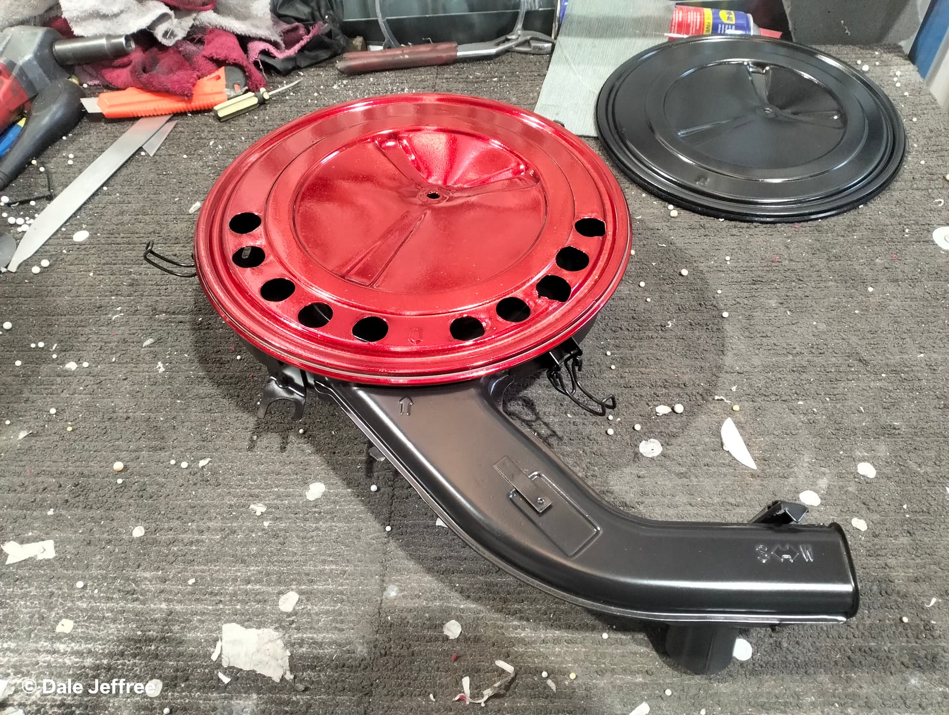

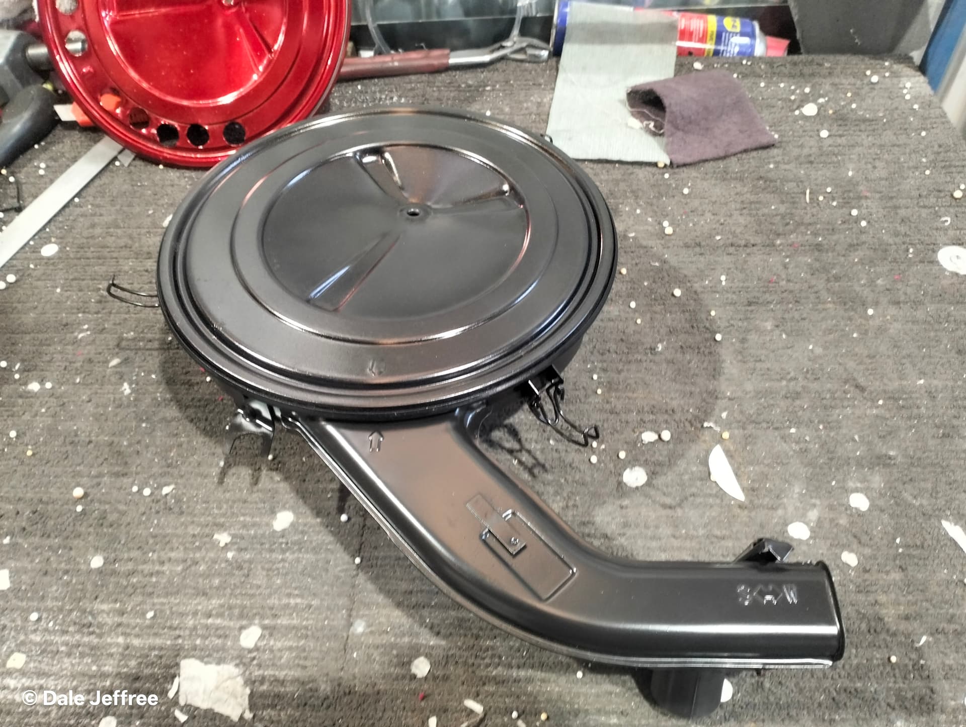

I found the right air cleaner box, and naturally I have ceramic coated it with options.
very sexy that will look great in the engine bay.
Unfortunately they don’t fit Toyota 4k carburetor
