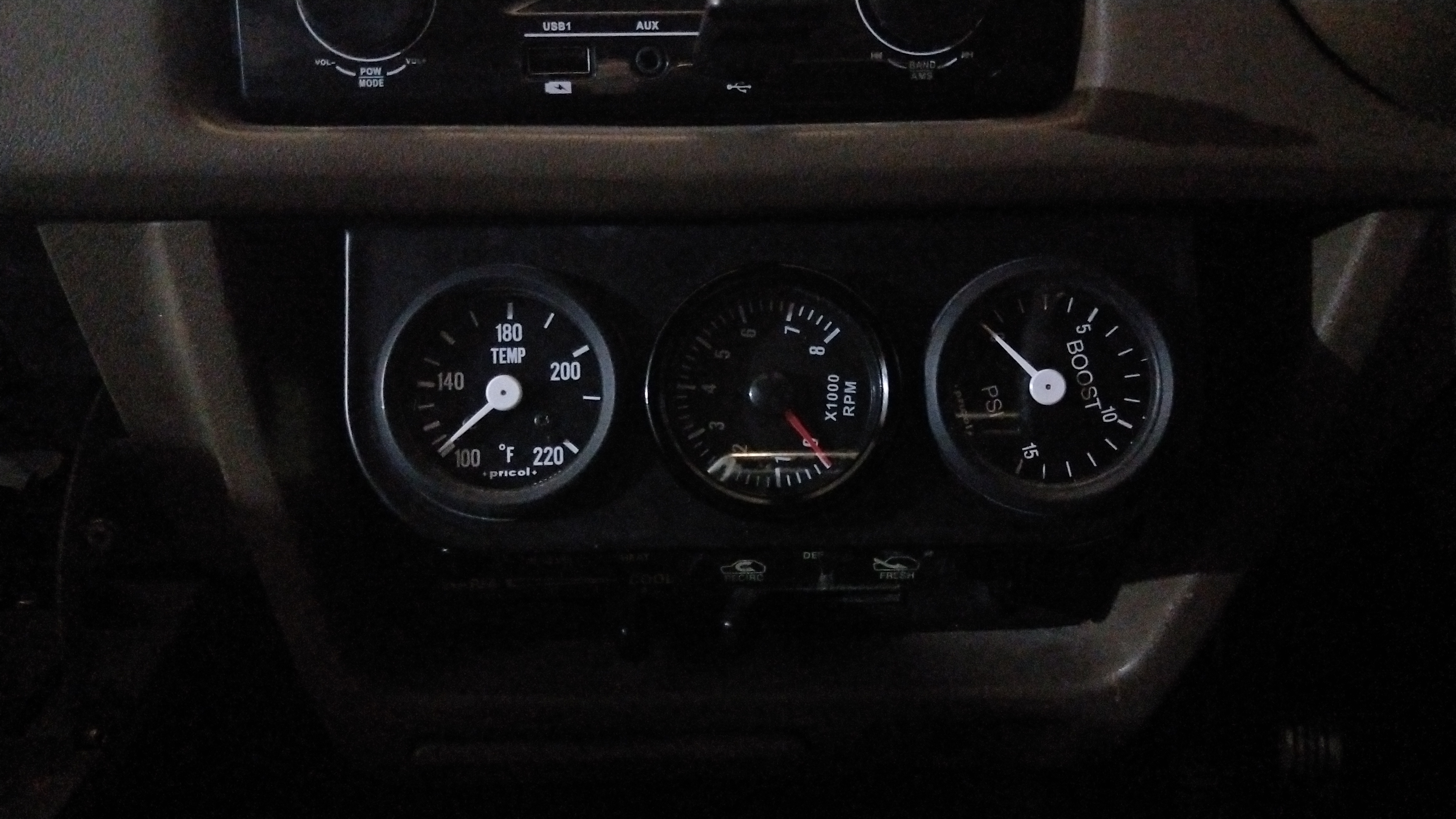

Sneaky tachometer test fitting. The trio is complete.
Huzzah! I have back lighting and have connected the tachometer.

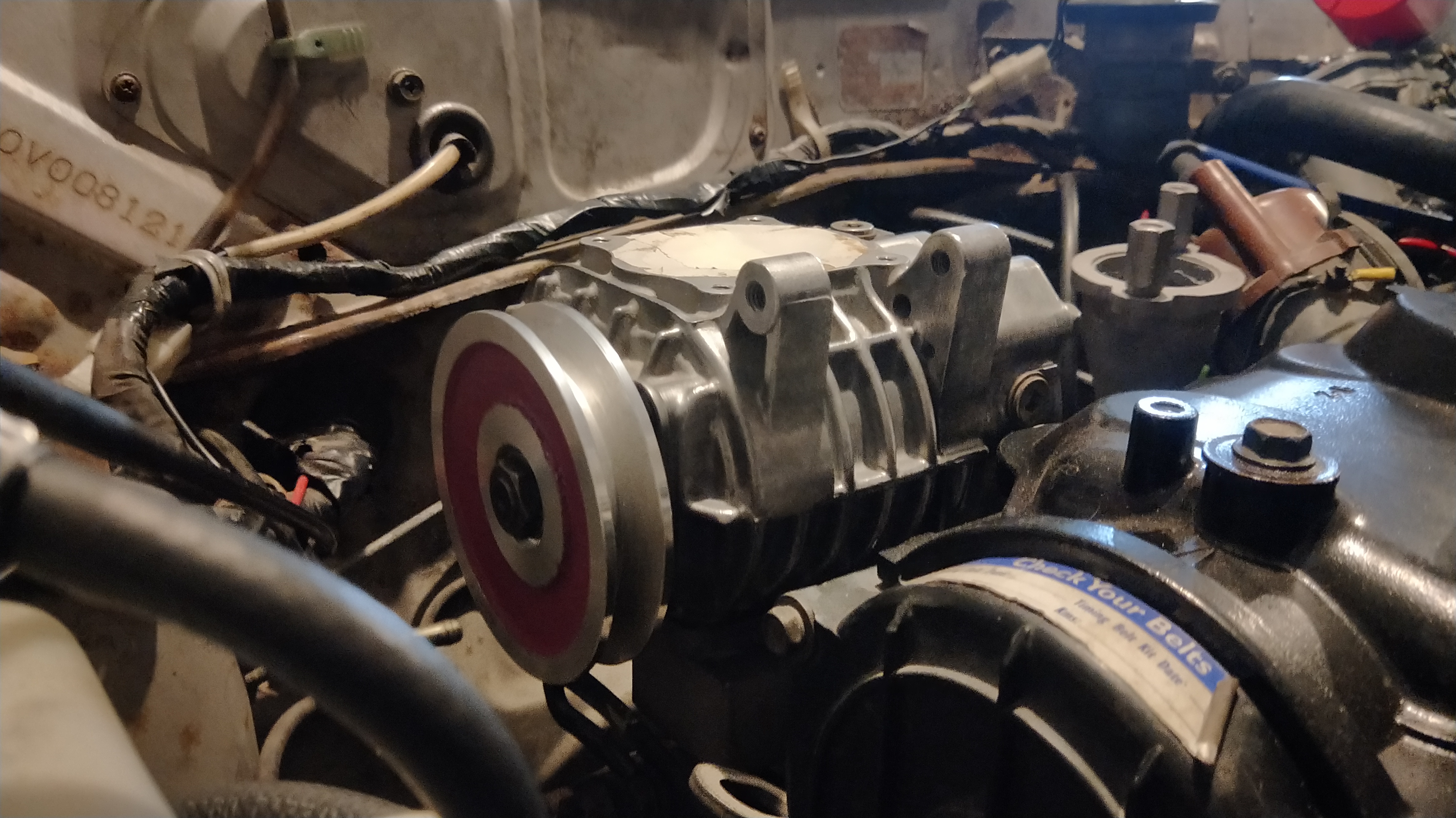

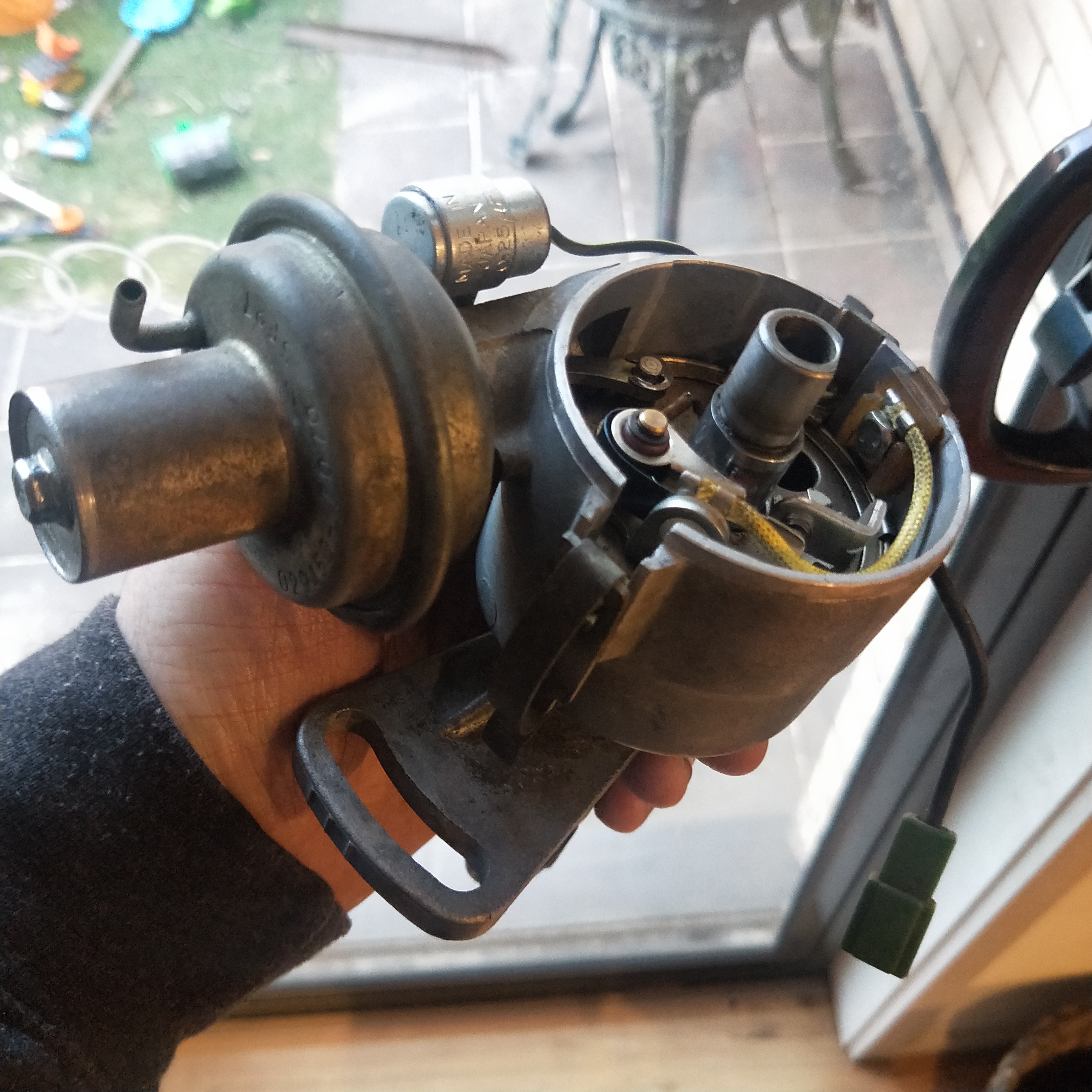

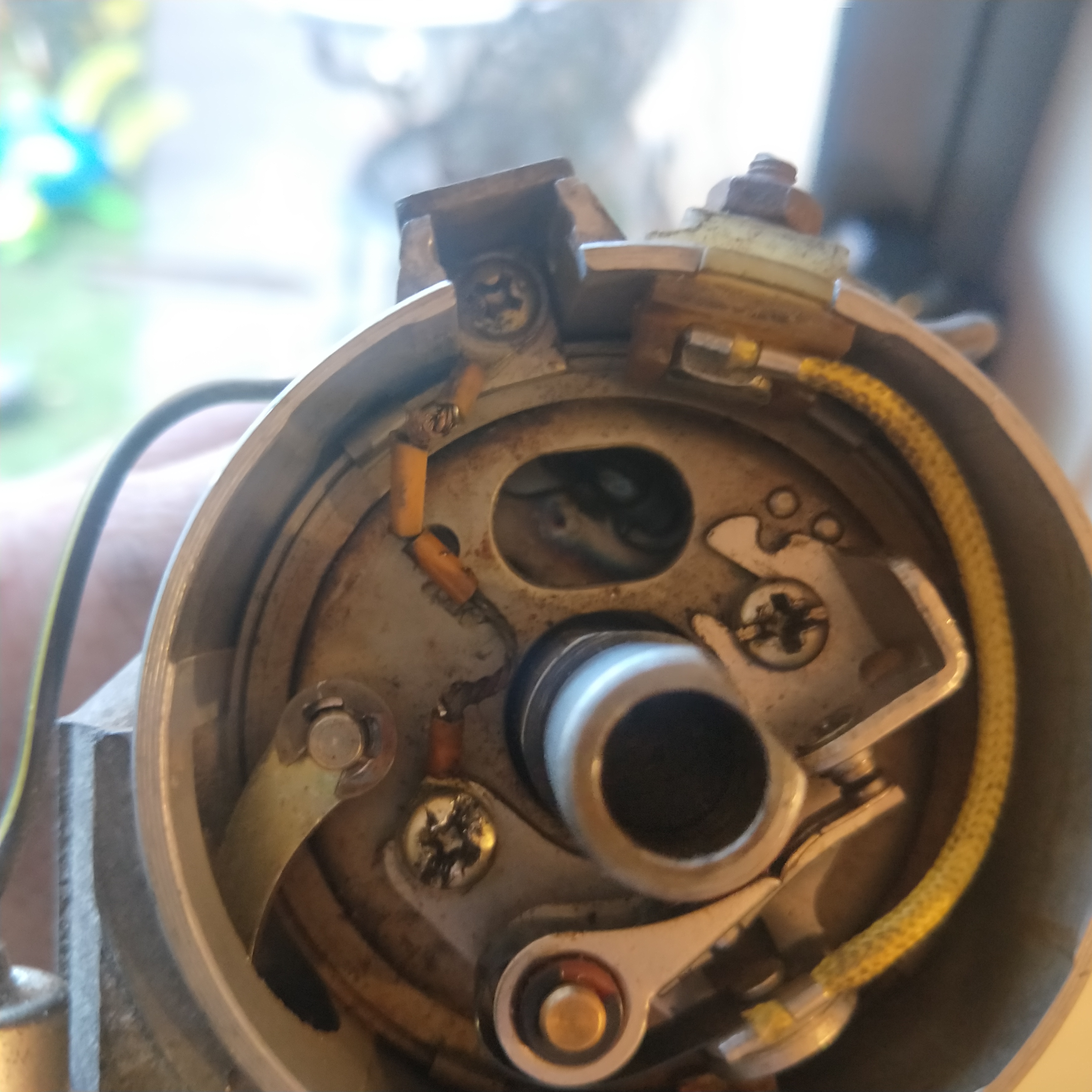

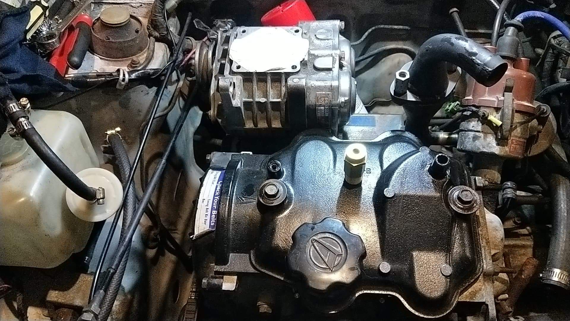

Adjusted the valves to have a valve clearance. Decided I’m “gonna send it” and bolt on the blower. Made necessary mods to the distributor, mechanical advance has been removed and a tig weld is holding it in place. The dizzy will still have vacuum advance and being a cb60 canister it also has boost retard.
At some stage I will take it upon myself to mod the cb60 canister and remove vacuum advance too.
The manifold is getting the final machining done like milled bolt holes and facing the flange faces off. Pulley will be getting machined next, so it fits the AMR shaft and have a key way broached into the pulley to match.

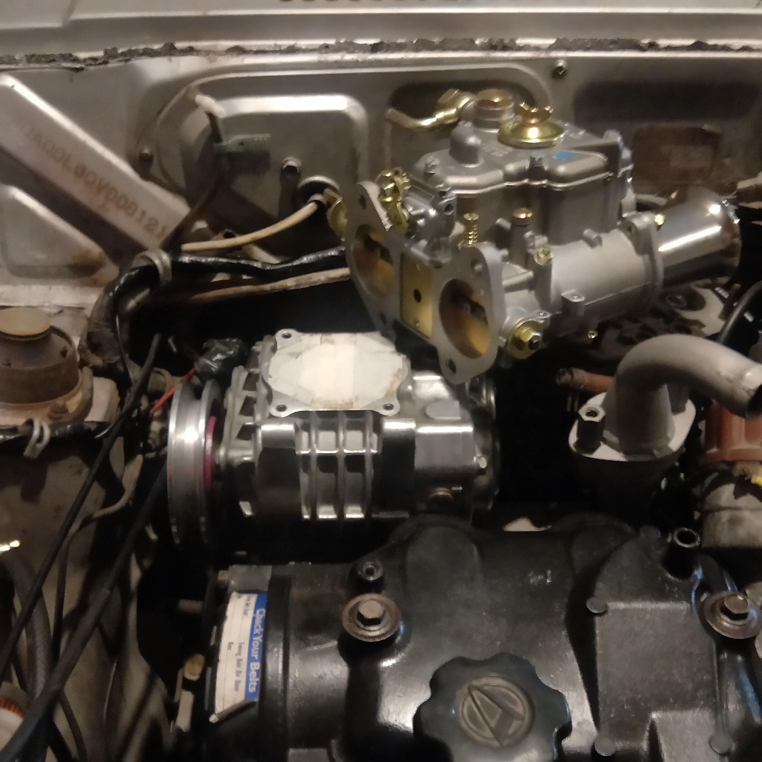

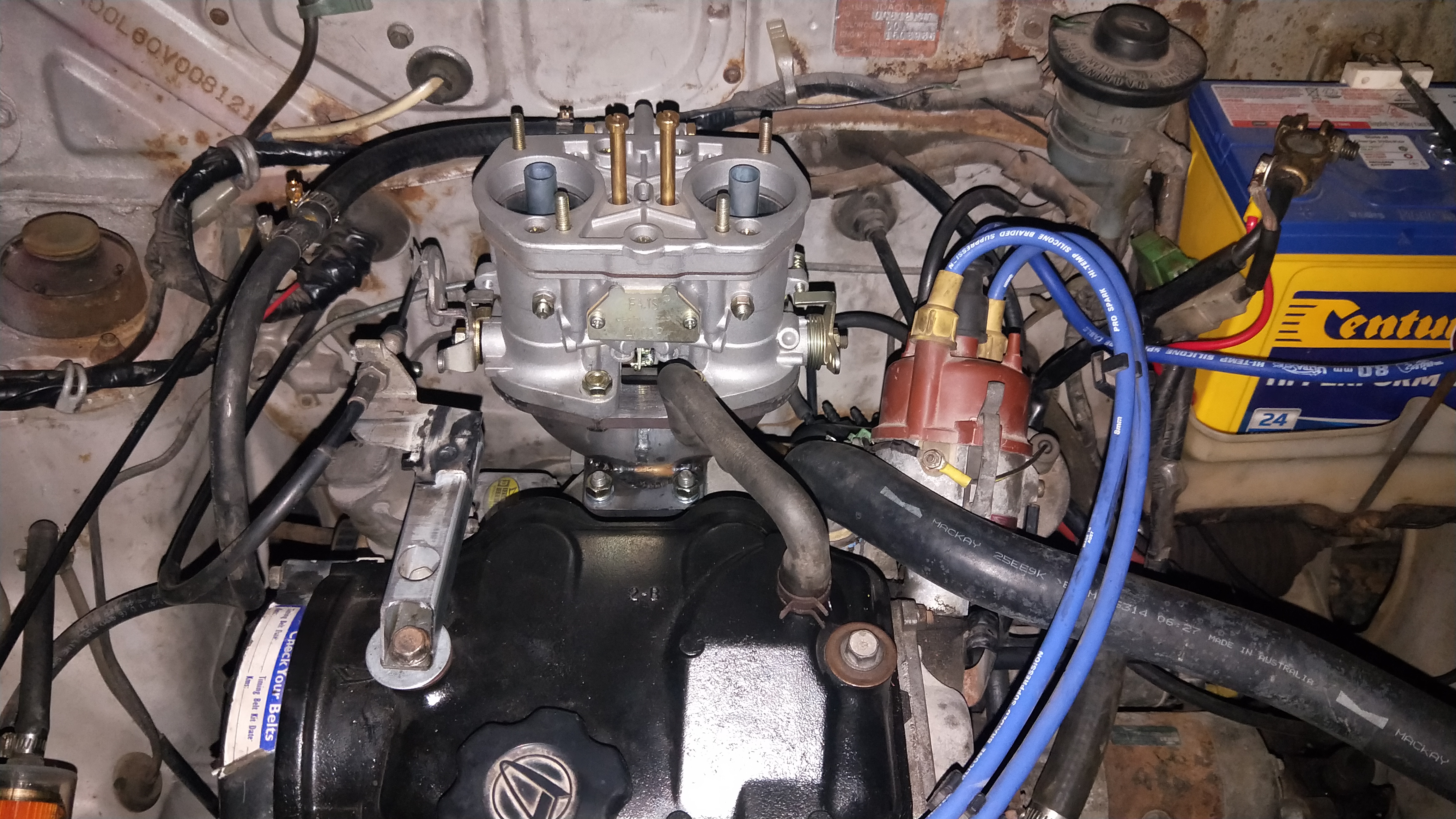

50 percent down payment is put on the new Weber DCOE. Sick of crappy second hand parts.
Weber acquired
With the DCOE on this angle only a little bonnet reinforcement needs to be removed or modified.

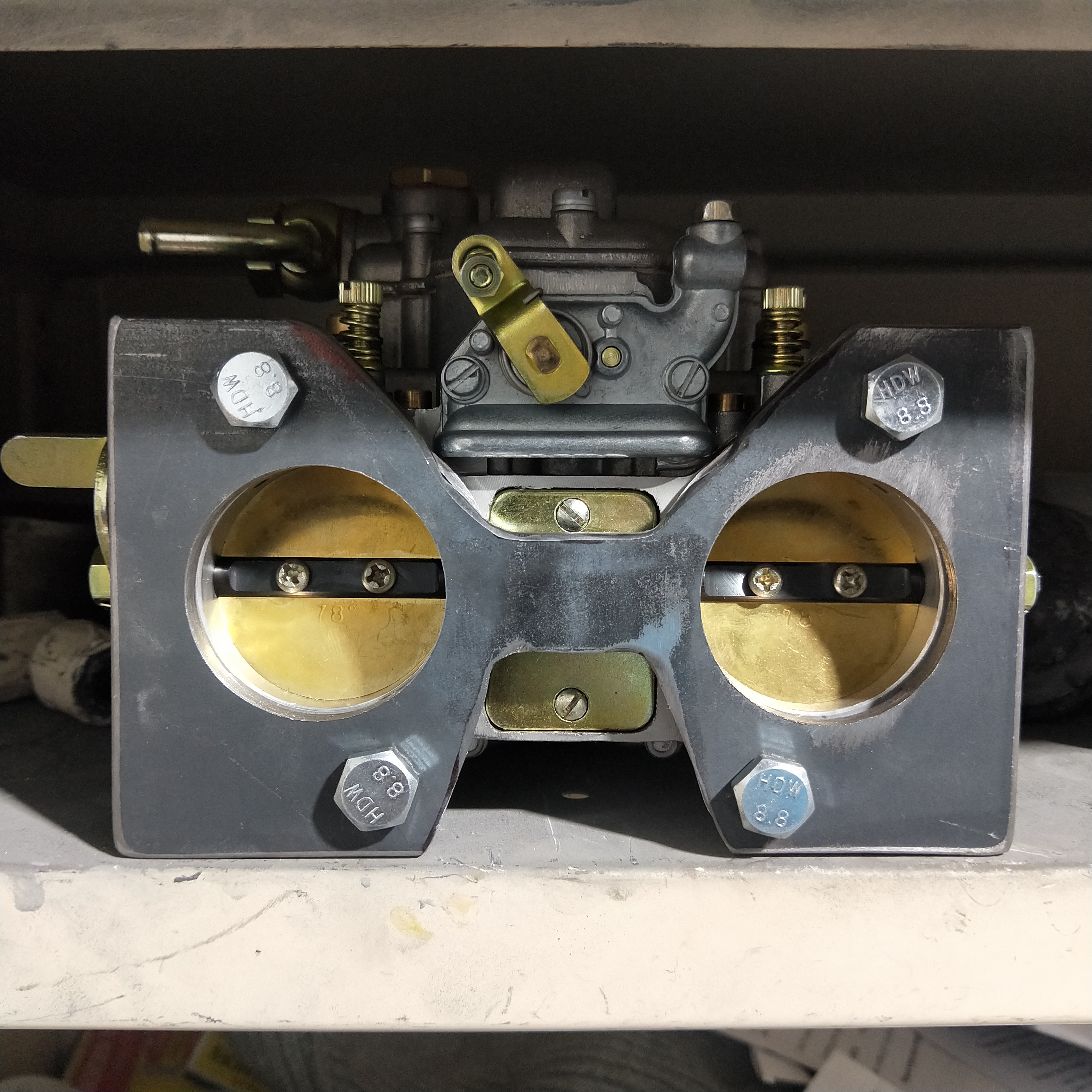

Flange made, not trimming of all the excess yet in case I need to attach brackets.
All made on the drill press.
Made a little more progress. Supercharger inlet flange is done, not as centred as I would like but Ehh
