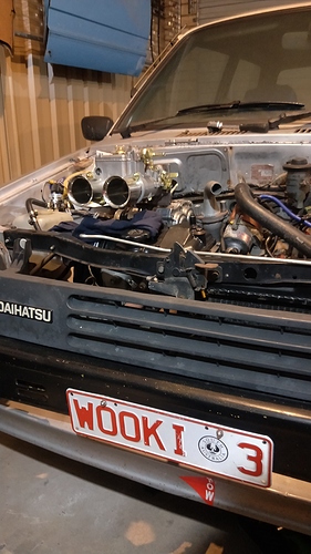

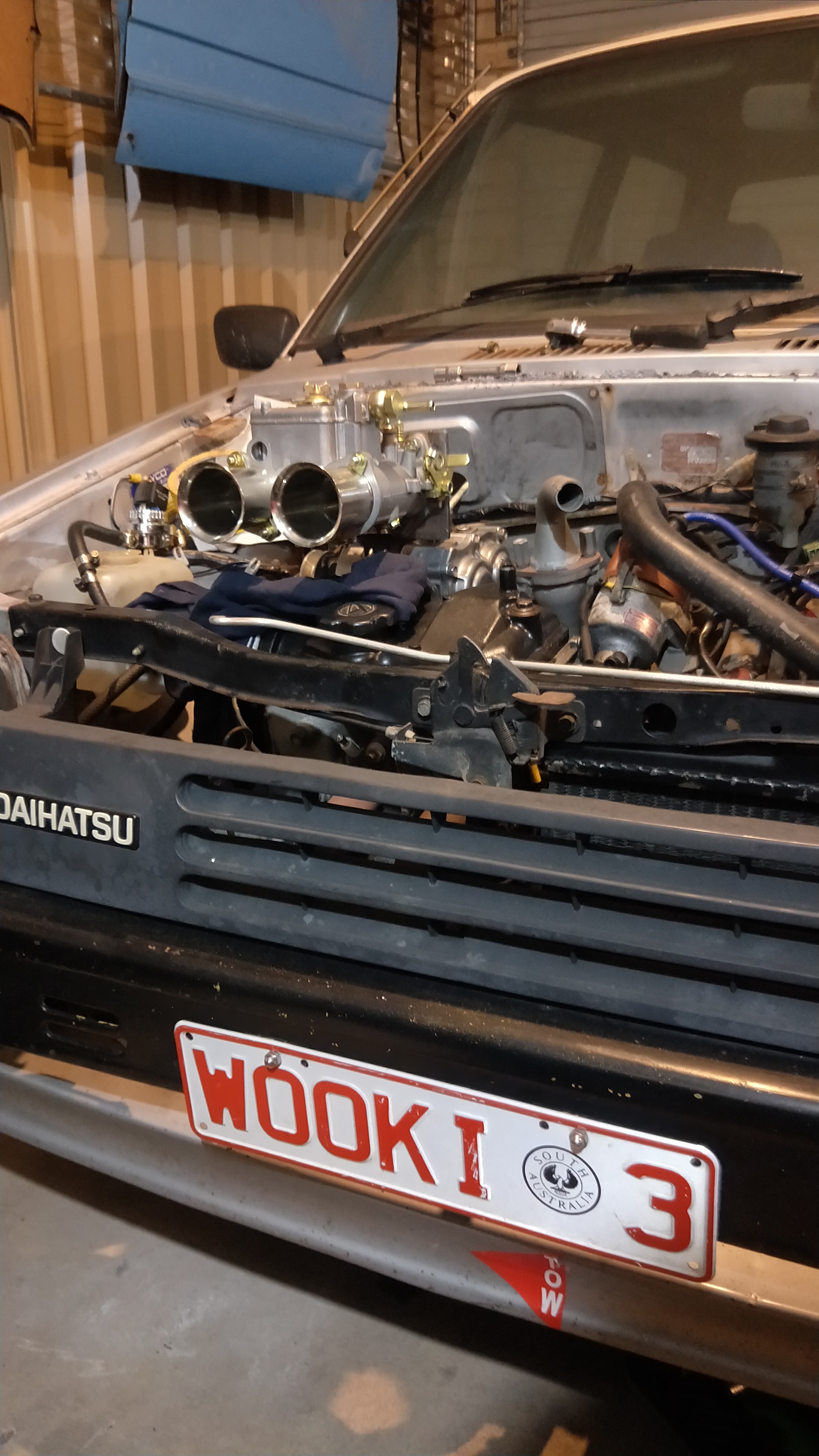

Menacing…
looks like some sort of small robot looking at me lol
Things aren’t getting out of control at all.
Well this is a different take on on a handivan :wink:
Nice to see the work you have done, it’s fun in the stock engine bay.

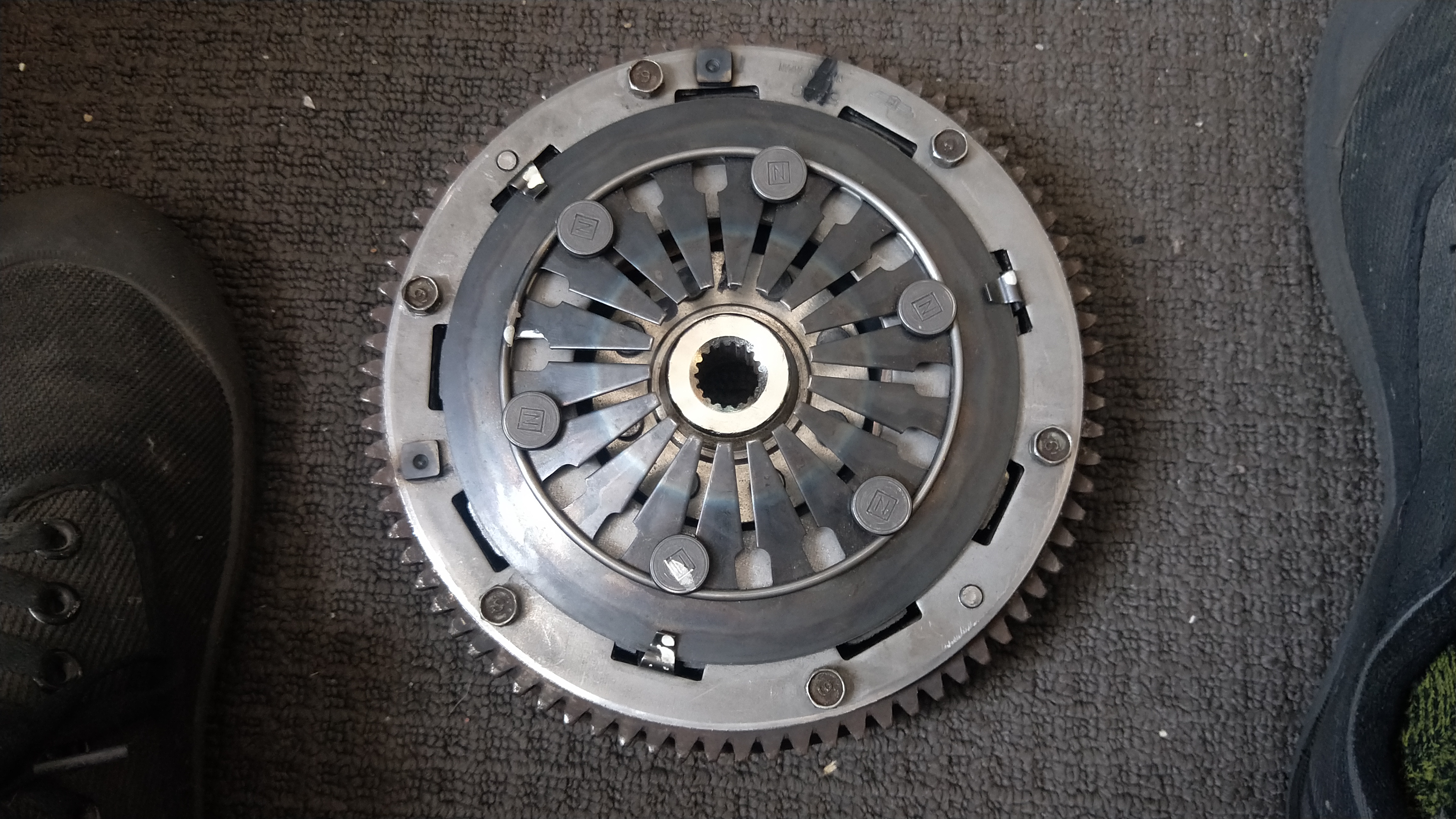

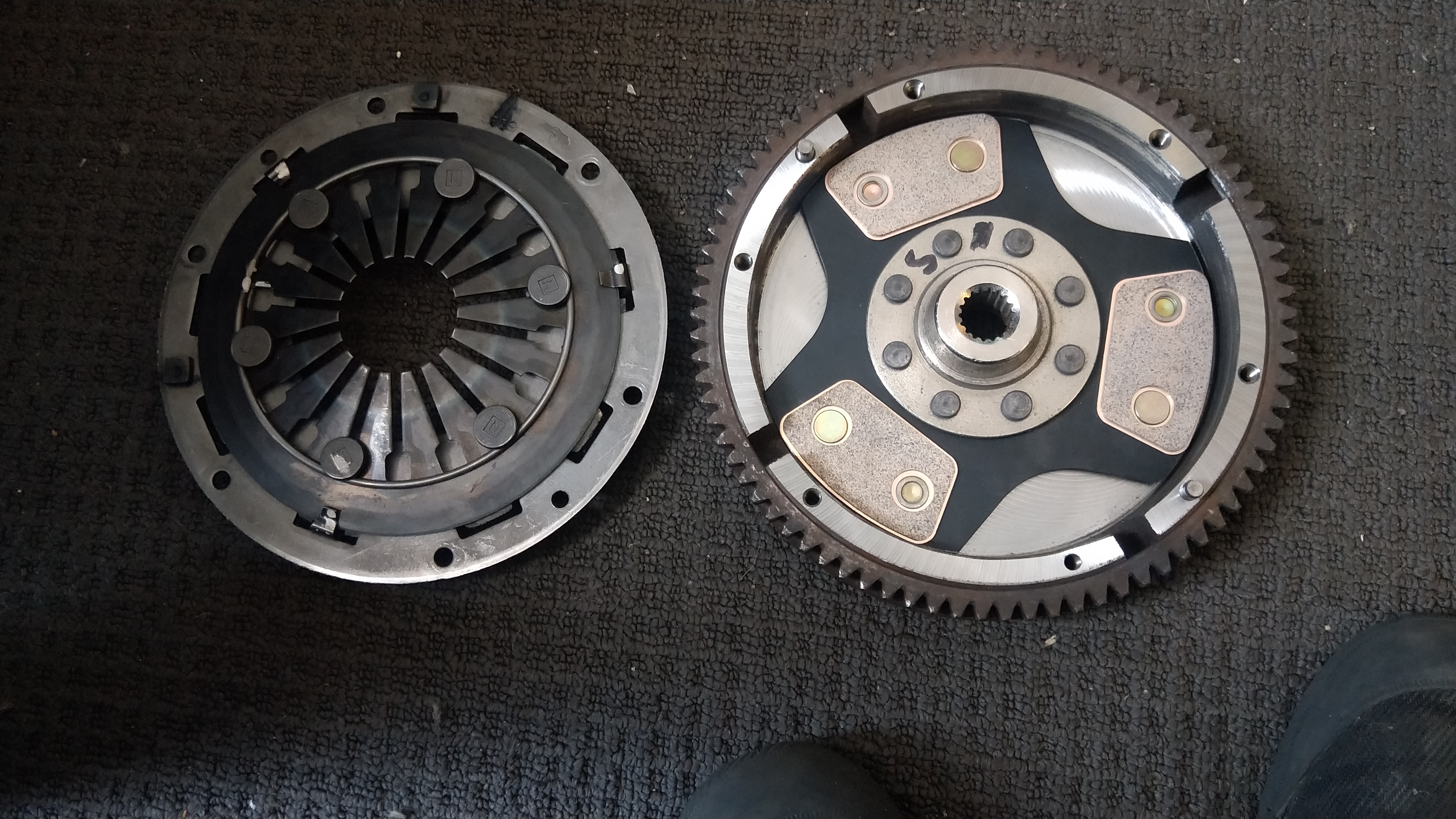

Well it has finally arrived. It will either work well or break gearboxes.
So ever driven a car with a brass plate clutch before ? :smiley:
Turns the clutch into a switch, on or off with very little in-between :slight_smile:
Not yet, the car won’t be a daily.

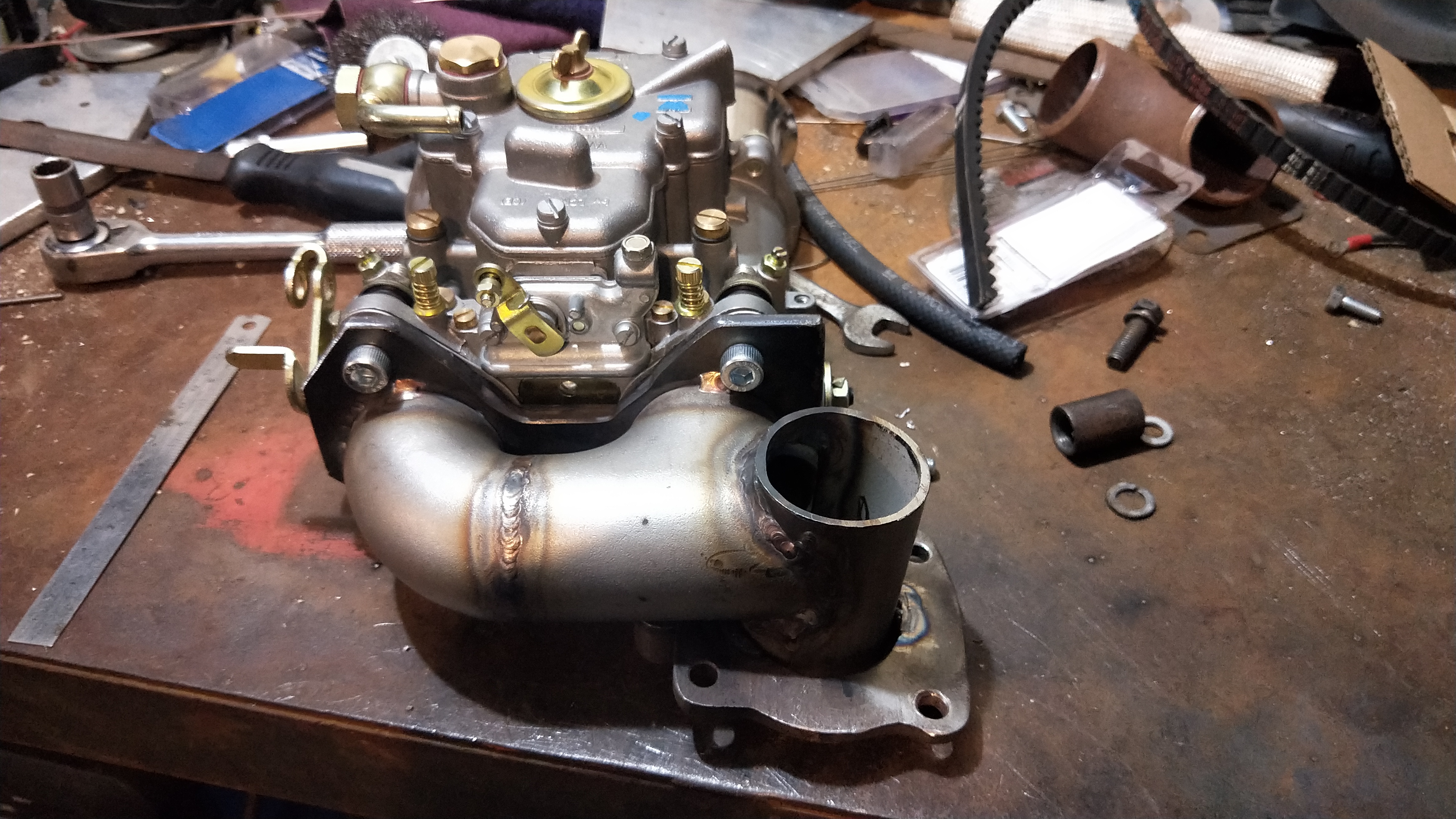

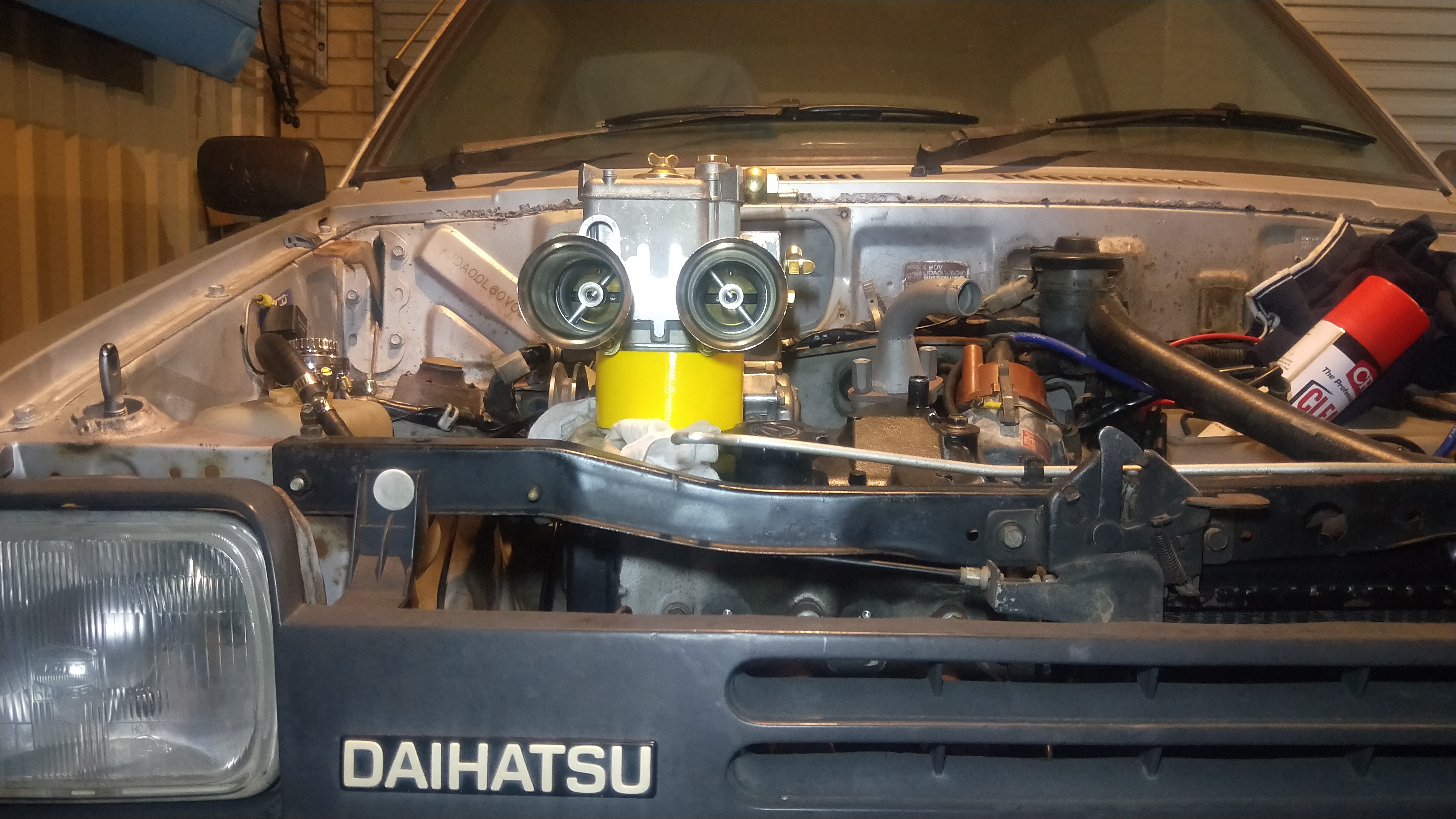

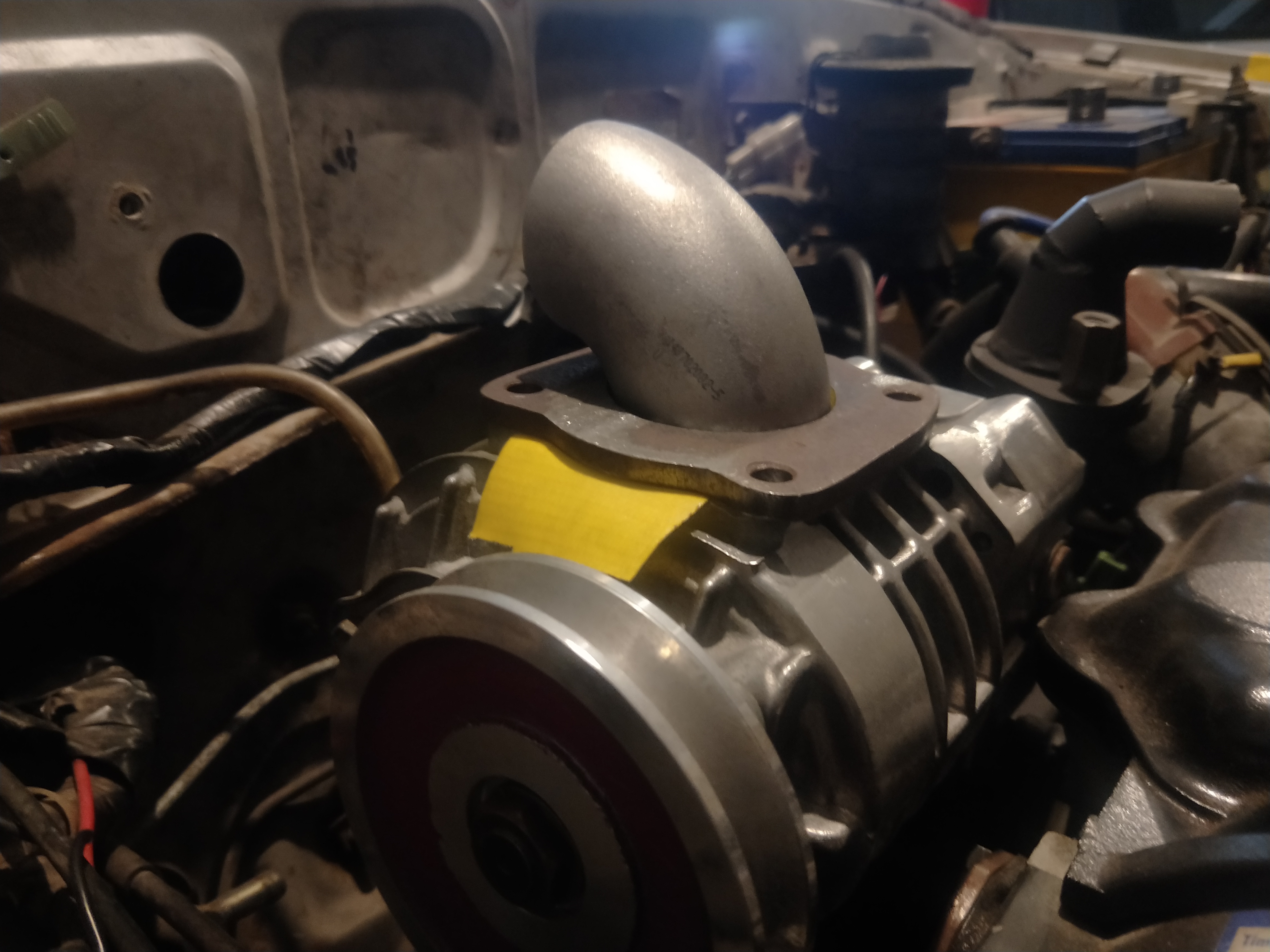

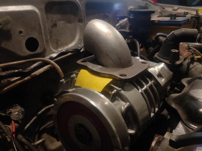

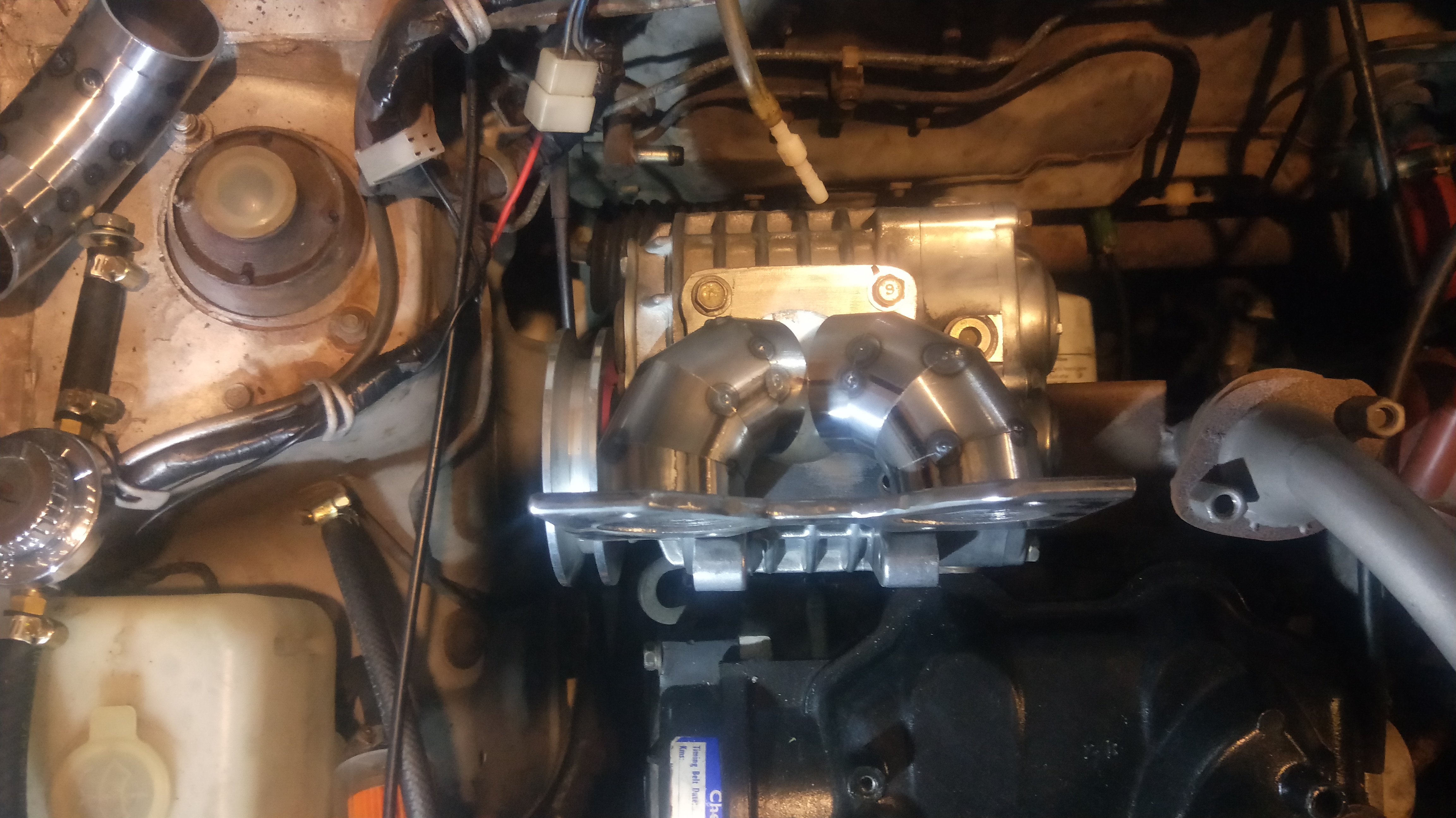

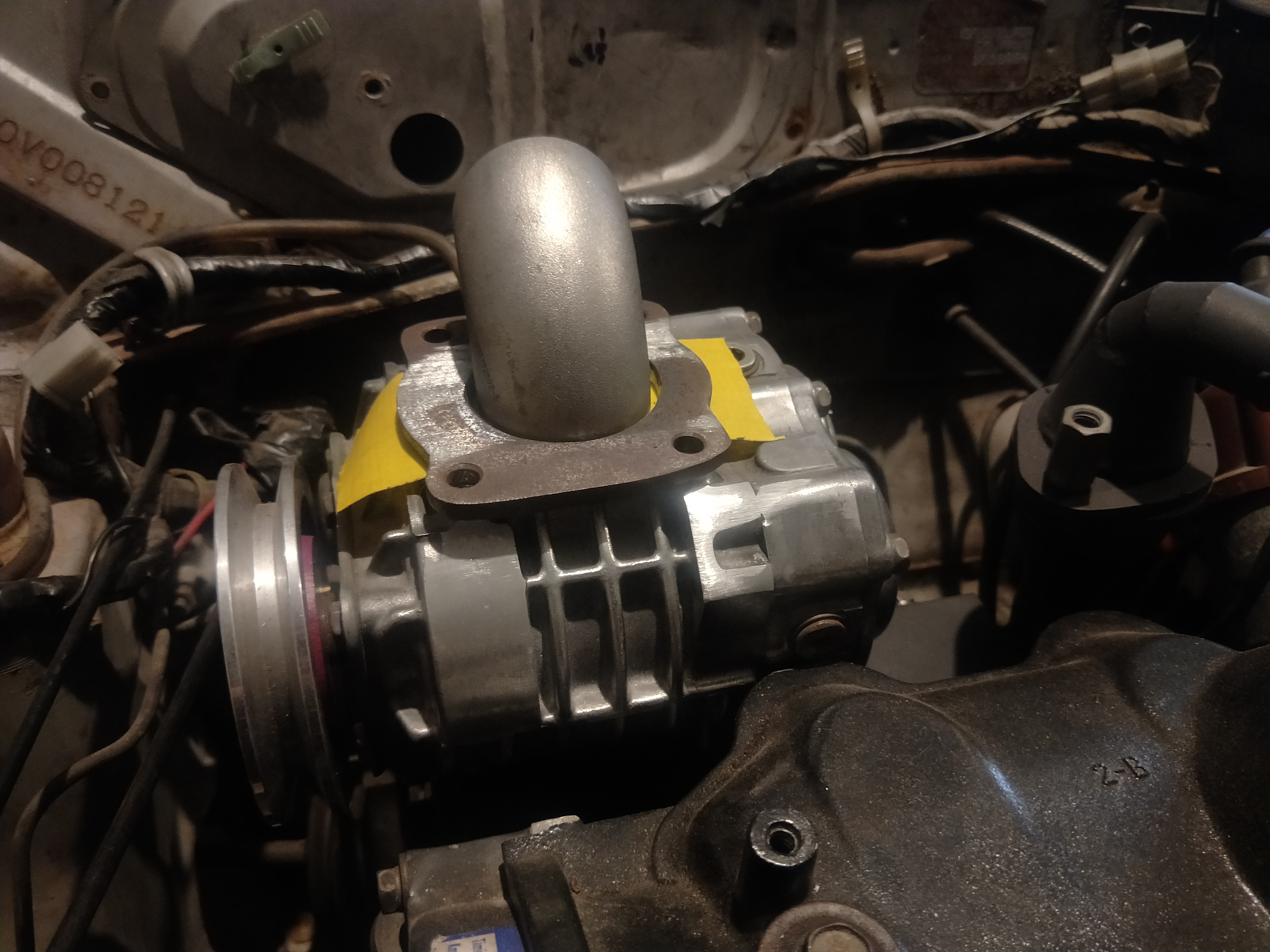

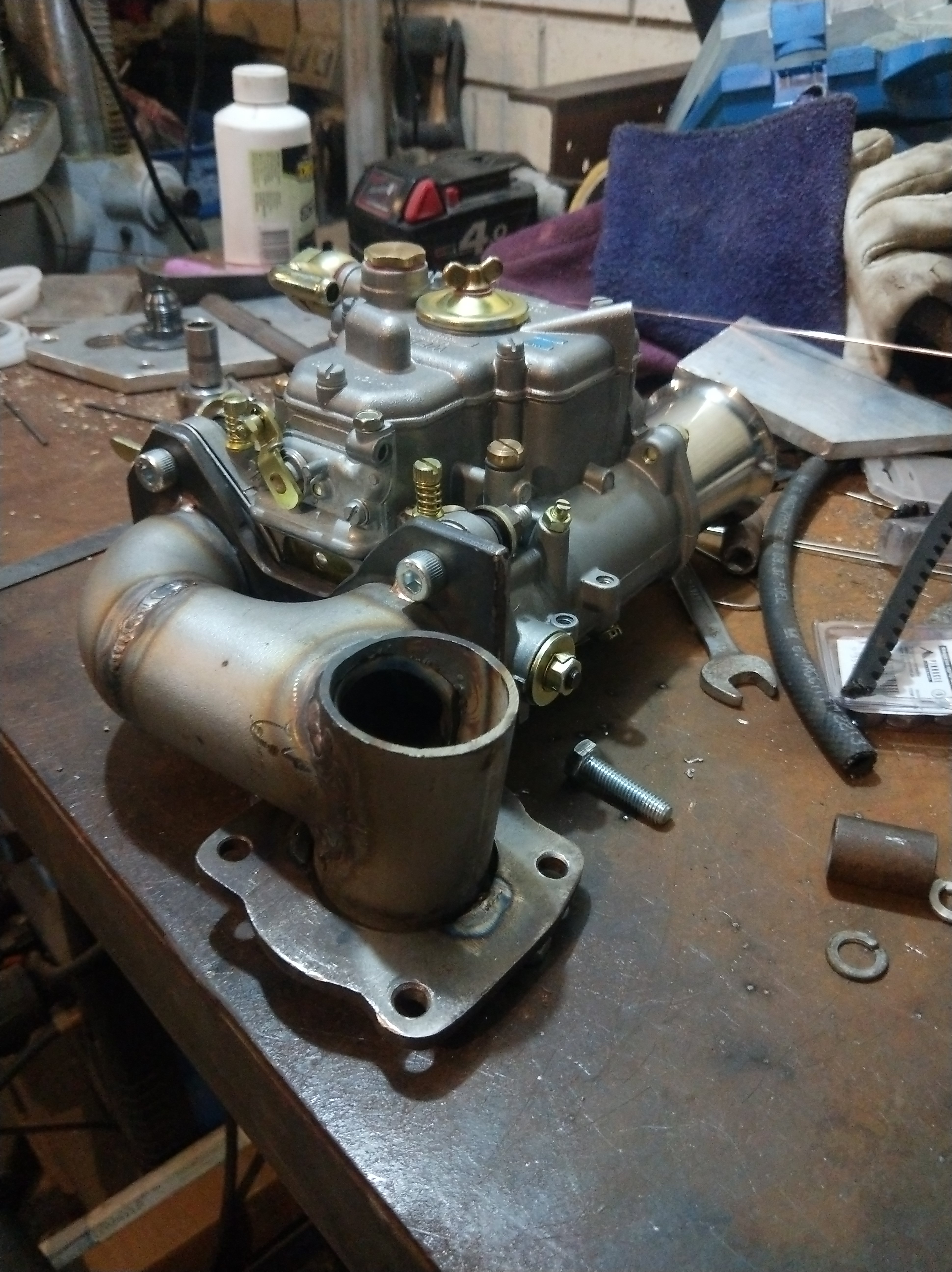

Yes this is another carby to blower inlet, the aim is to not chop the bonnet.
Hopefully some more cash flows my way and this will continue once again.
good idea not to chop the bonnet. not like they make them anymore :slight_smile:

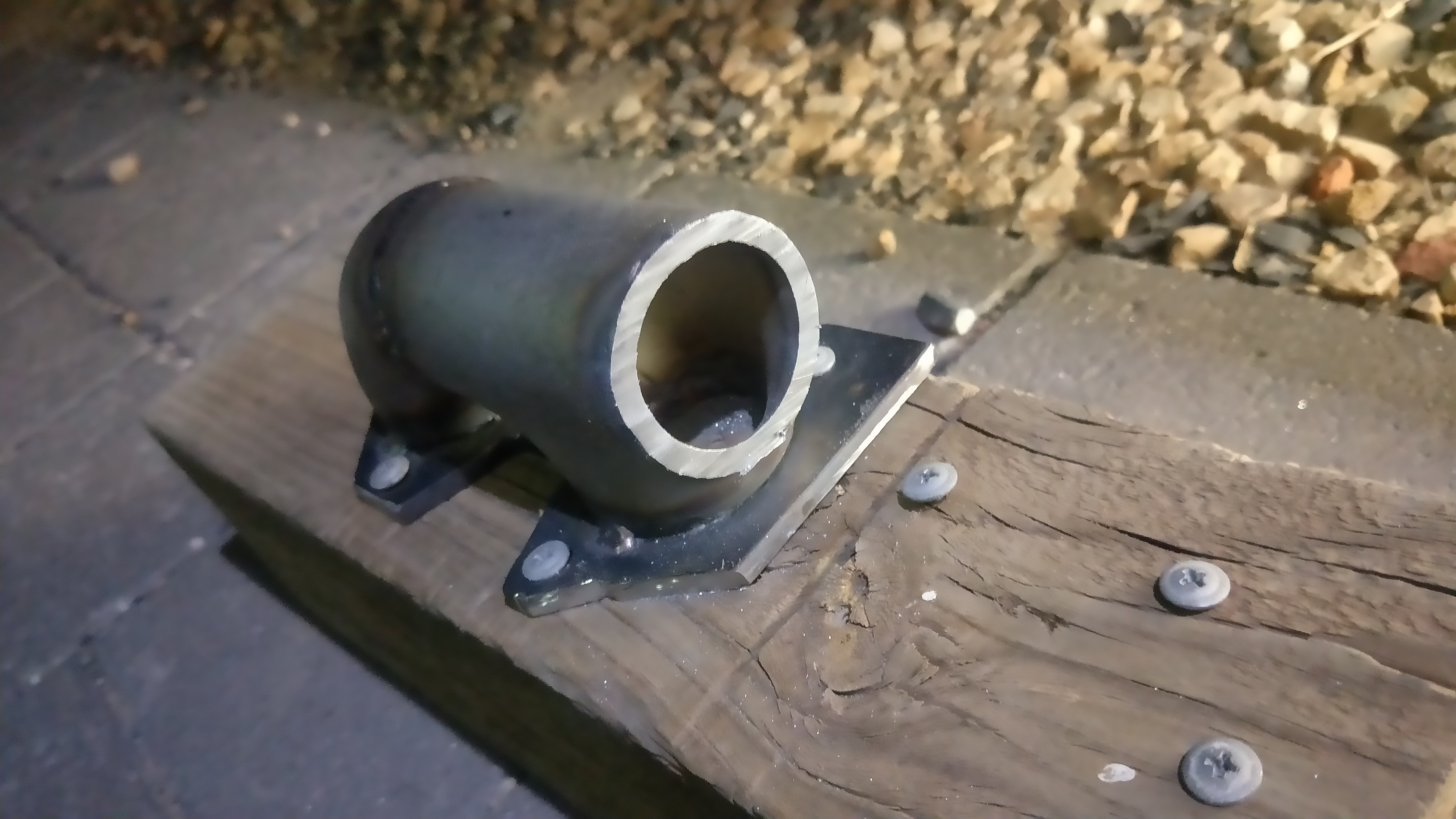

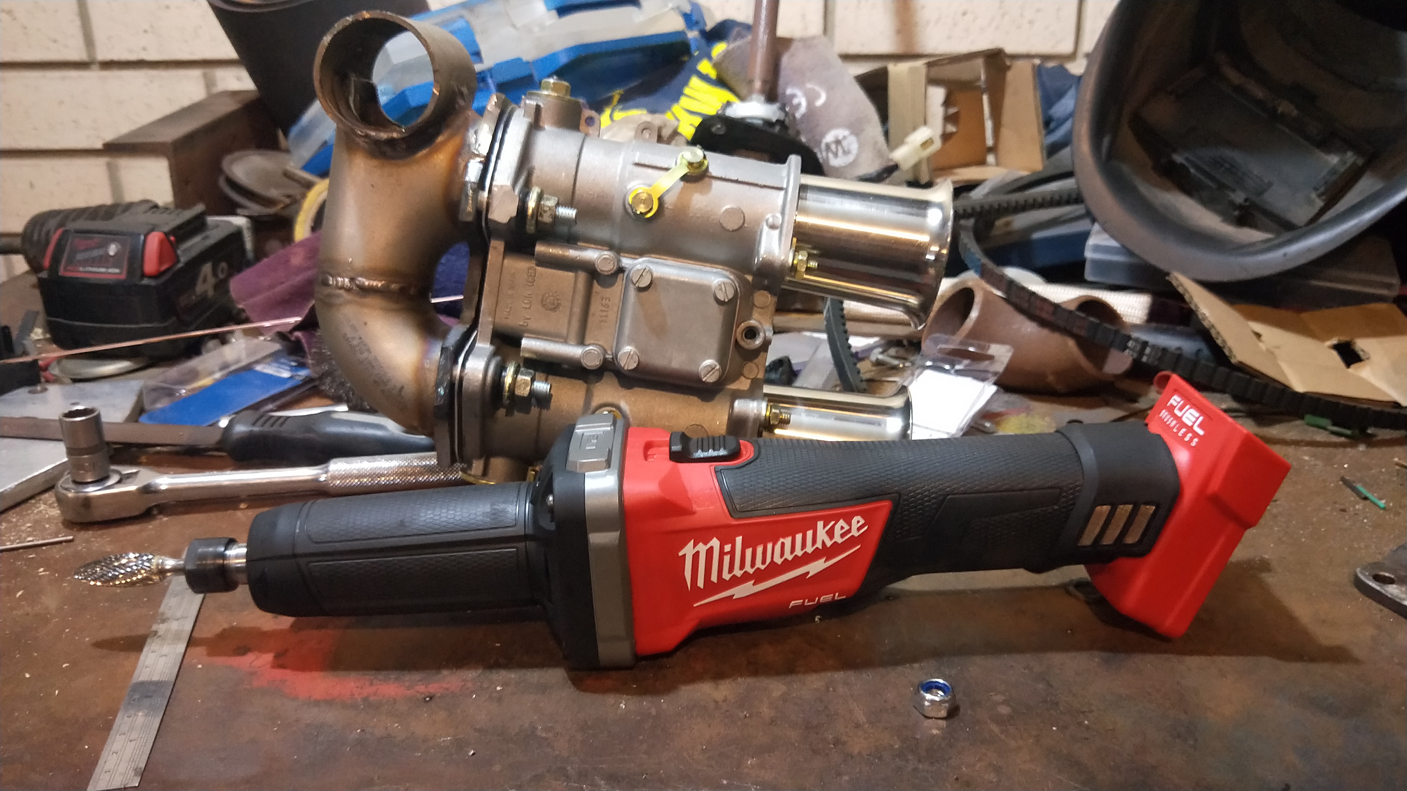

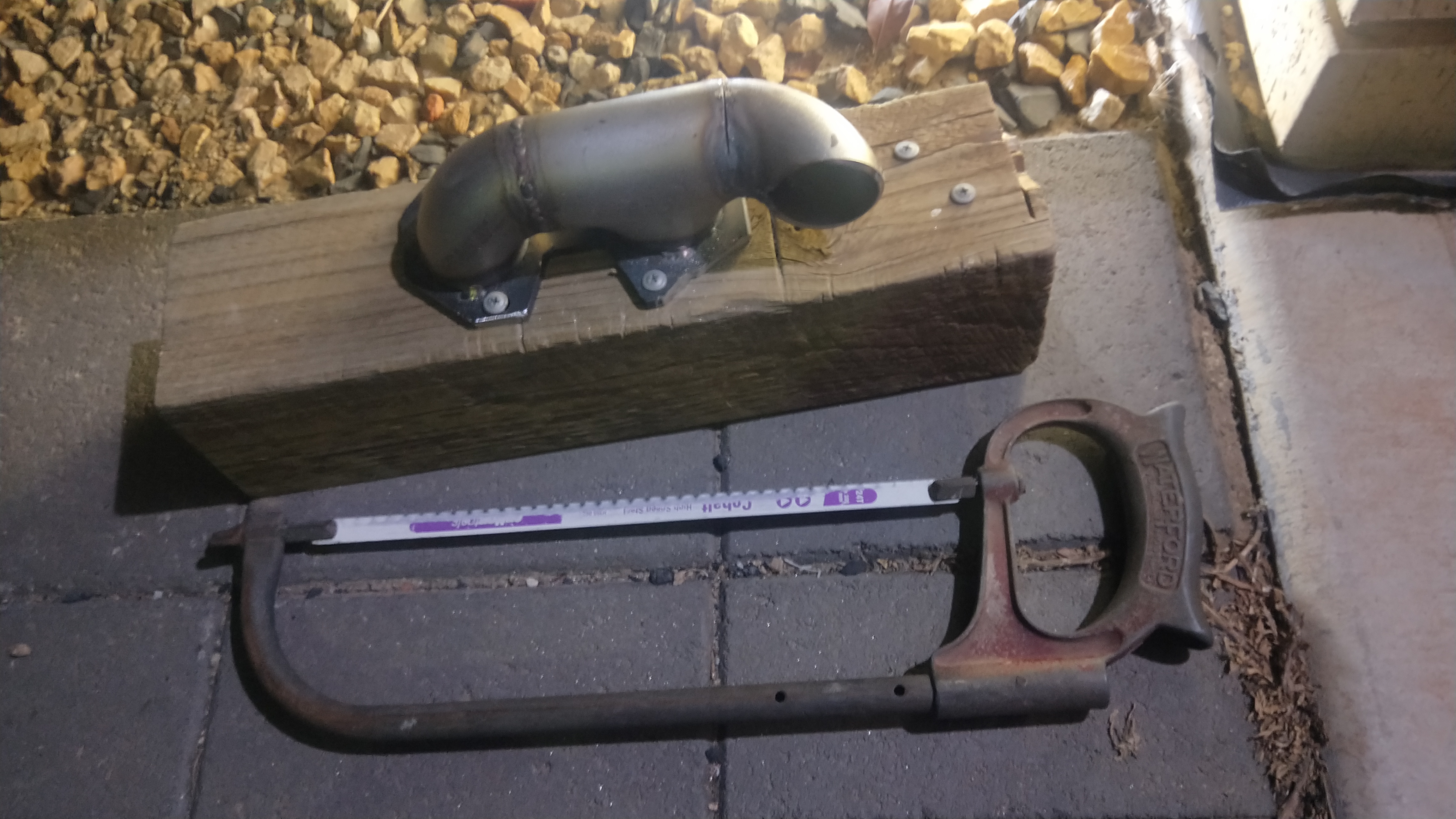

Tonight I spent a tad over 30 minutes chopping thick wall stainless steel steam pipe. That was fun.
Tomorrow I will shape the join I have to make, unfortunately it won’t be pretty but it will function.
Having chopped this back and made an angle I had to, to make the turn. This will get a severe tickling inside for a nicer radius.
This is a big bugger of a hand tool, although it can be handled with one, i recommend two hands. Has handles most of the job with making every radius smoother.
I am enjoying this fabrication Dale. Nice work mate :slight_smile:
