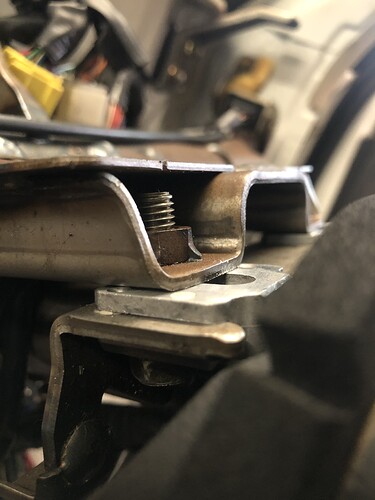

  1. Sight the 4x bolt heads supporting the steering column, you will need to get under and look up! The forward two are in a “U” shaped notch and the rear two have elongated holes . Loosen all of these off around 3-5mm with a 12mm socket and extension.
Can see below the elongated holes fully utilised and how much movement you can get, yes its not much but every bit helps
  1. If you are lucky (like on my m100 you should be able to pull the steering wheel towards the drivers seat until the elongated holes bottom out, gaining around 5mm extra reach. Then simply tighten the 4x bolts back up and put the trim back in place

With the car in pieces atm and a spare steering column to mess with i decided to chase a little more extension to give my knees a touch more room
A quick drill of the elongated holes in the alloy tabs gave another 5mm, and now has the bolt hard on the steel of the column (could get more by opening the steel up a touch but this is as far as im comfortable with due to the mounting on the steering rack spline itself
Also skimmed the raised portion of the alloy mount flat so it sits nicely to the dash bar side
These alloy mounts tap off with a hammer and screwdriver, as theyre only held in with some sort of hot glue and friction…and when tapped back in theyre going nowhere
I will squeeze the steel lower nut mounts together some more later to get more metal under the nut, may even put a wide washer on it too, but it feels solid as currently
