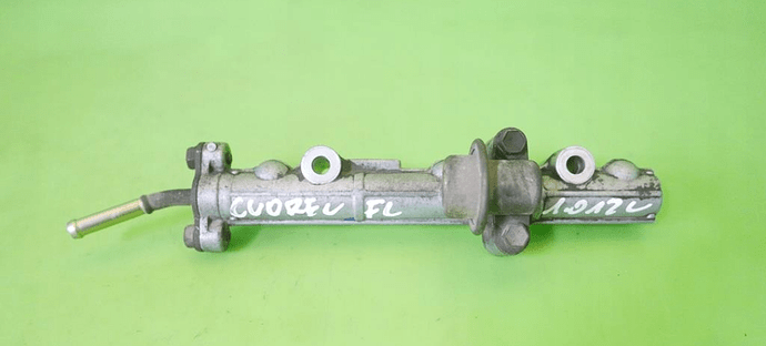

Found old posts by @Mr_Gormsby as I tought people tapping the end of fuel rail
But some of 3cyl rails has pressure valve thingy on it that does not have any outlet or vaccum hose. I’ve found that it can be some sort of harmonic damper.
Short question is: does anyone used this valve-thingy rail to ditch the valve and mount fuel return from here? Its a bit easier to make than tapping the rail body.
Imo last injector can be fuel starve if make like this, but, curious heh.
Ill rather make it flow-throught, just as i think it should be done correctly, it should level the pressure for all all injectors.
Other hand- presure drops are not so big to starve the one part of rail…
How your point of view guys?
