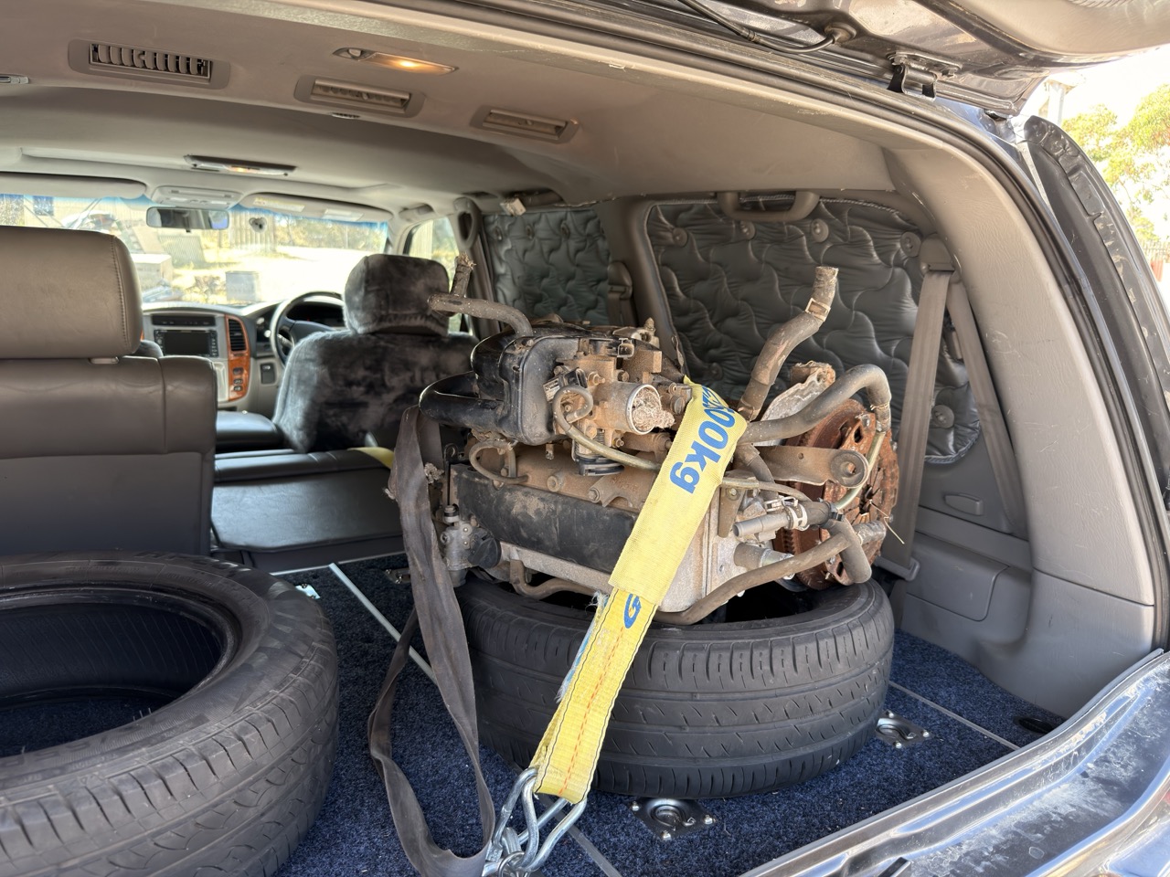

So, with thing secured in the back of the trusty 100 series cruiser, I embarked on a perilous journey that would teach me that even though some things may bolt in and line up, the concept of 80s and 2000s parts playing nice together would come back to bite me.

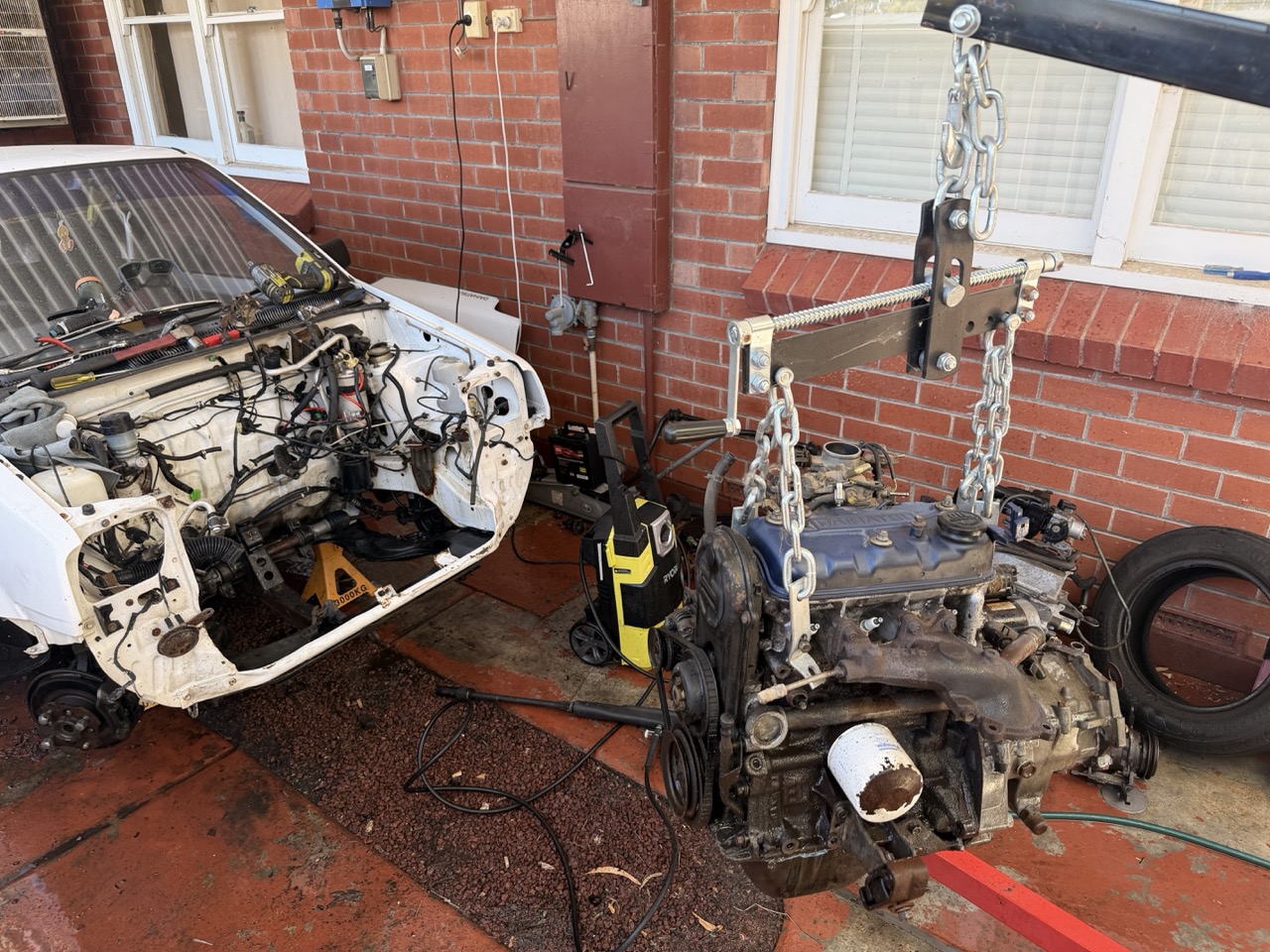

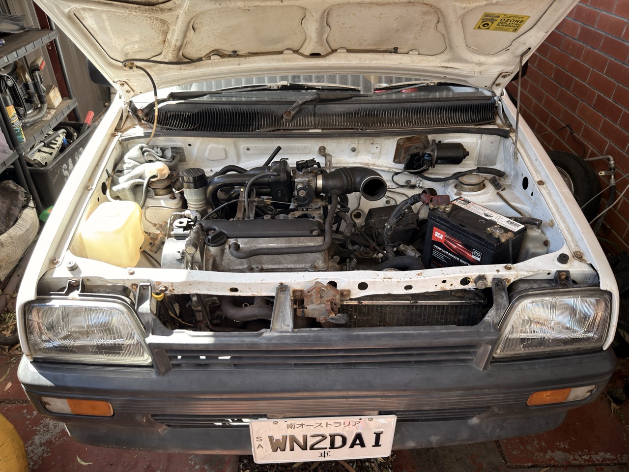

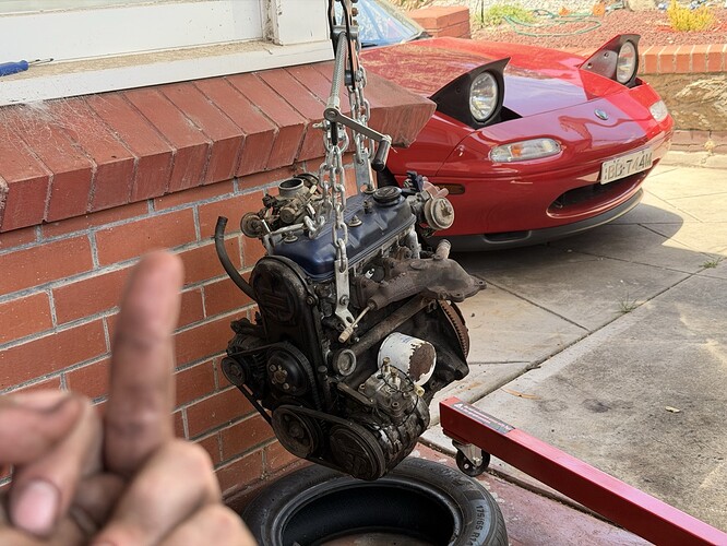

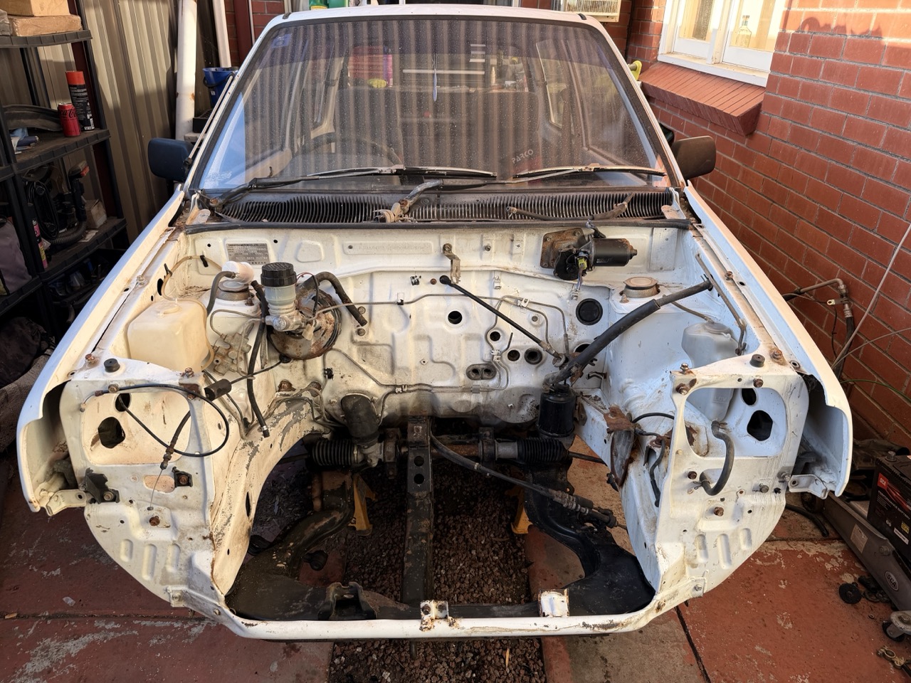

The front fell off which allowed better access to everything. Time to get this leaky old ED10 out.
That was the easy part

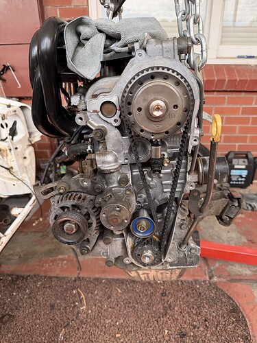

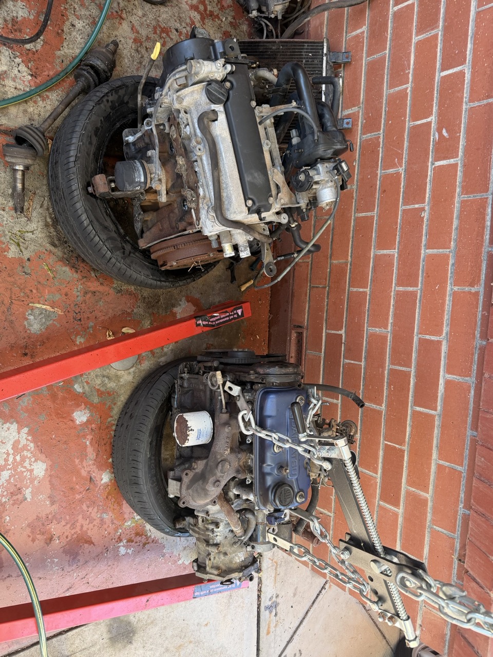

Compare the pair. It’s still crazy to me how different they are yet they bolt in just the same.
And the engine bay after removing everything I don’t need.

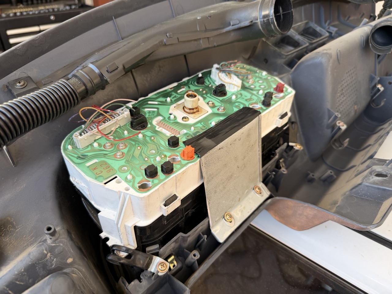

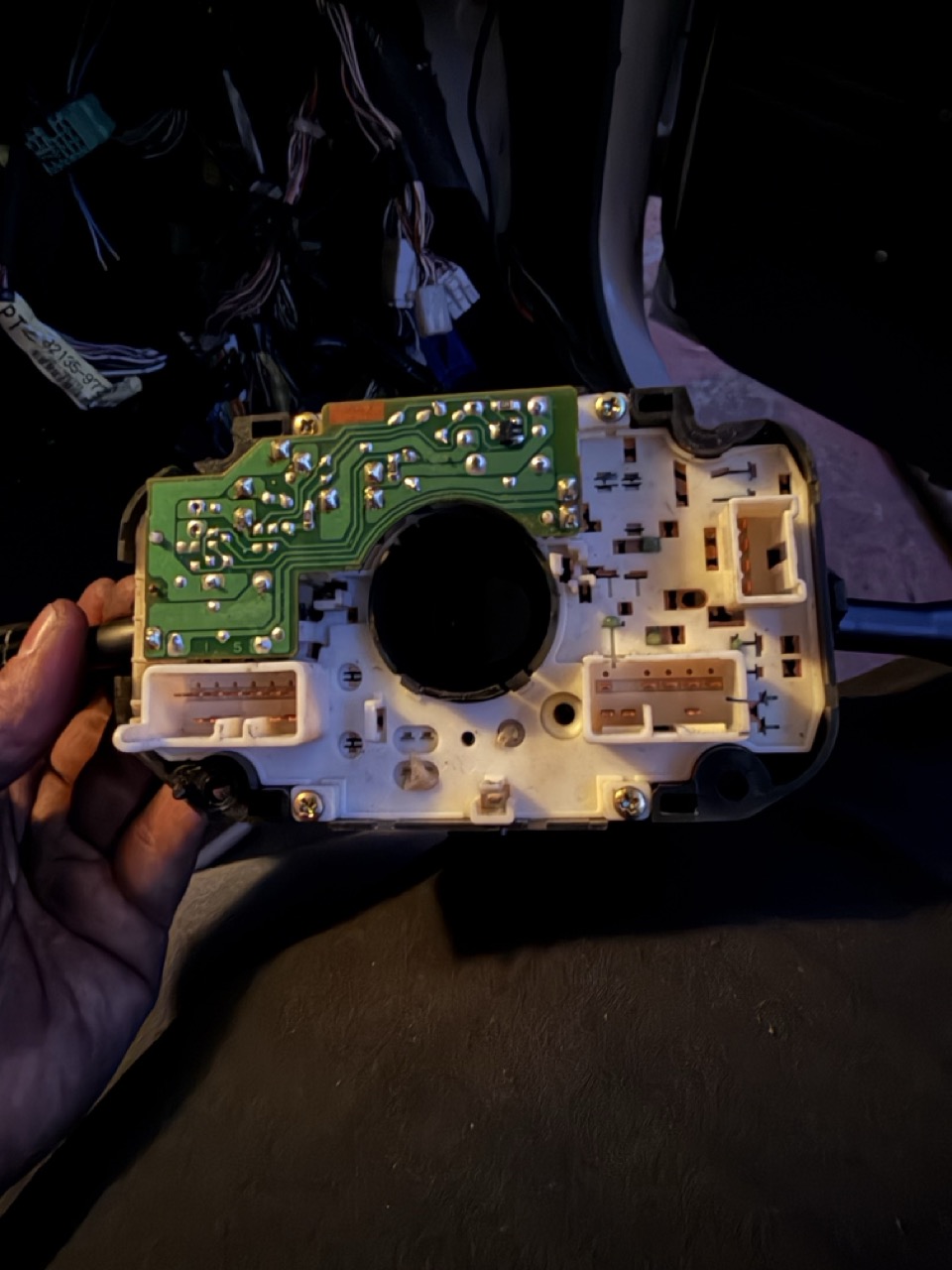

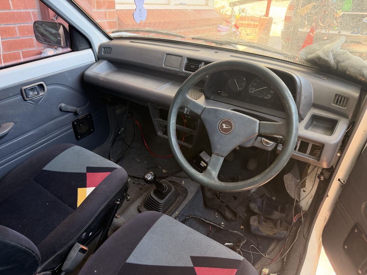

A trip to the wreckers later and I also had a cluster and combination stalk that would plug right in. PLUG RIGHT IN. /more foreshadowing/
Ghetto bracket I made to hold the M100 cluster in place
And a cool steering wheel I found. It’s the little things.
I even managed to make the combination stalk fit the old column surround. Sorta.
After learning my valuable lesson the first thing to do to the EJ was a fresh timing belt and cam/crank seals.
Here’s the old ED10 looking sorry for itself and still managing to leak oil everywhere. It’s trying to ruin my life from the dead.

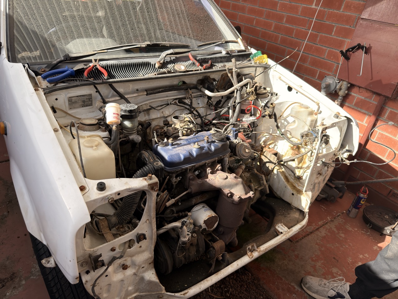

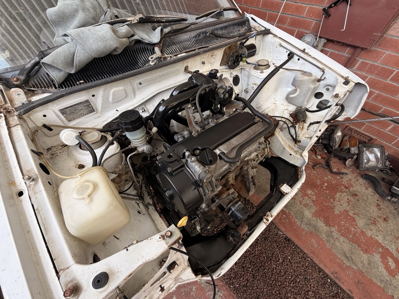

The engine fits pretty well with just some minor contact from the inlet manifold to the brake master res. It looks so tidy without wiring.
And all wired up and the front back on.

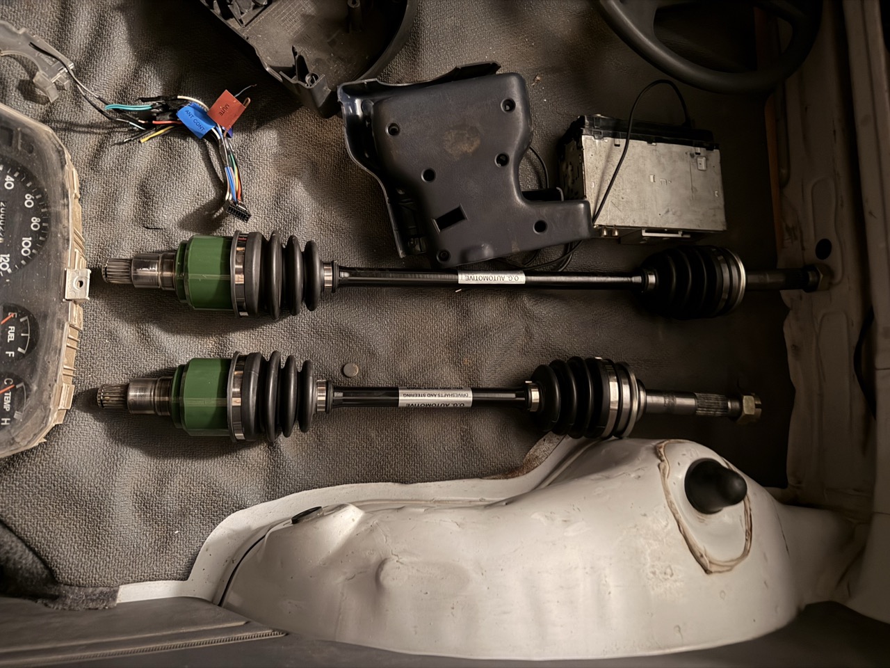

The CV shafts looked like they came from hiroshima in 1945 so I took them to a local specialist to be rebuilt.

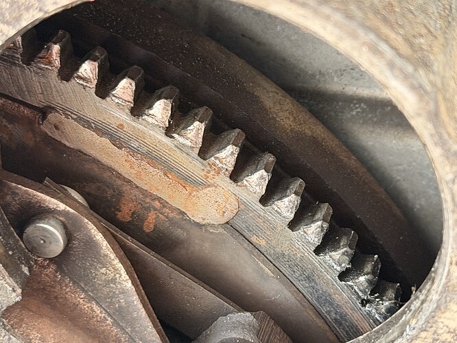

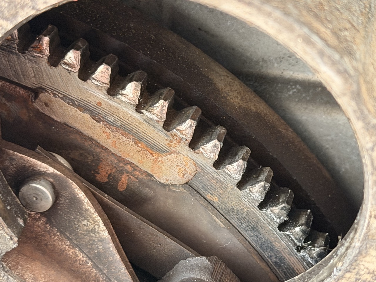

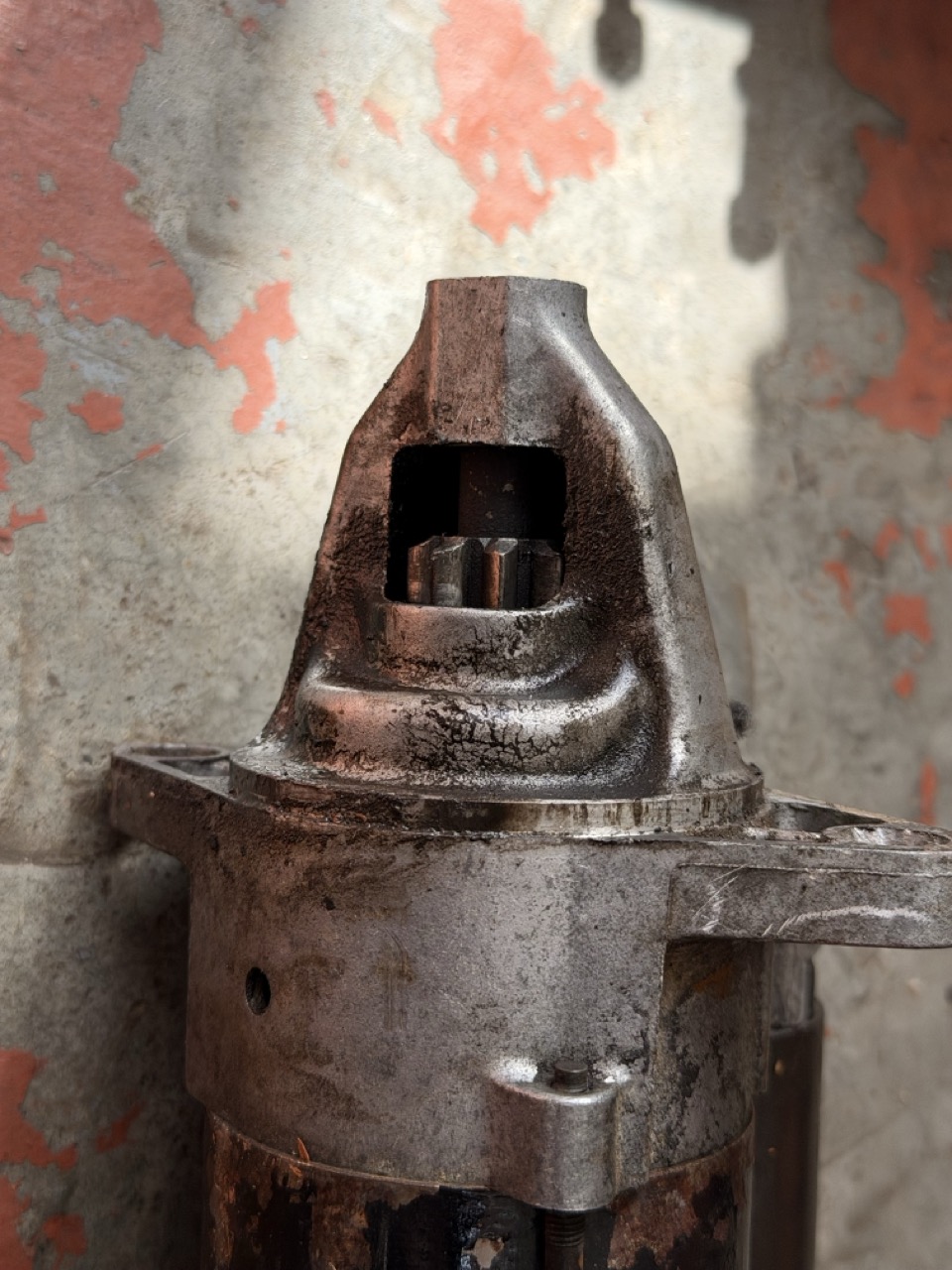

Starter motor/flywheel clearance seems to be different when using the ED10 transmission on the EJDE. I’ll need to space it backwards to avoid interference.

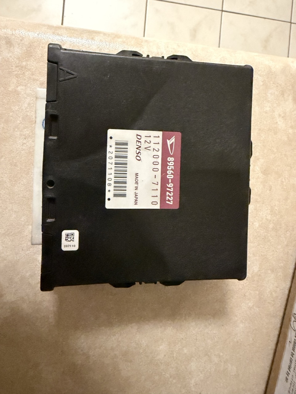

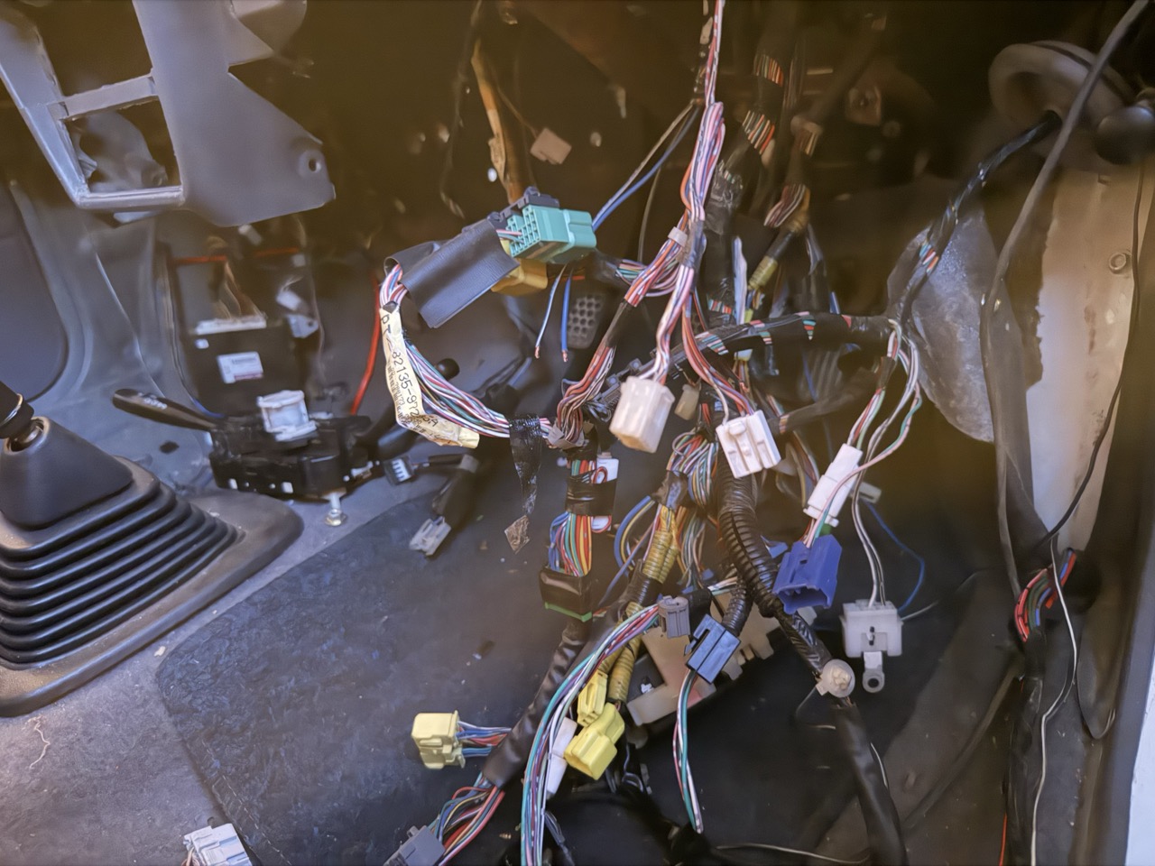

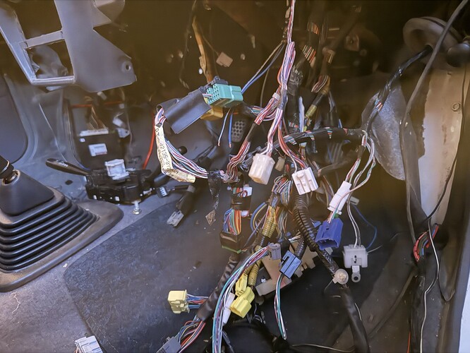

Remember how I didn’t know what the loom was from other than it came from an EJDE car? Well the ECU was the same. After not getting any spark (wiring the 5 pin key barrel plug to my 4 pin key barrel was another headache I won’t get into) a knowledgeable friend suggested I may have an immobilised ECU from an M100 due to it having a certain yellow wire at the ECU plug end. Thanks to a user from the facebook group I was able to purchase another ECU which is apparently not locked to a key transponder. I am yet to fit or try it as I work away as an interstate truck driver and don’t have a lot of time on my one day home a week to fiddle with it but I’m looking forward to seeing if this brings those coil packs to life.
Another fun one is the combination switches. After reading a wiring diagram (again, which I do not know the origin of other than “it’s for an EJDE bro trust me” it seems the plugs I have to go to the combination switches are entirely different to the combination switches I have. Fun and games.
There is so much wiring in this harness and it’s difficult to distinguish between what’s needed and what isn’t. I’m not that great with electronics but I’m doing my best to make this not be a nightmare.

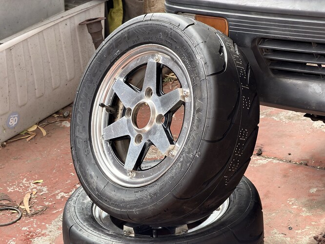

The old tyres were also terrible. Dry rotted and leaking so it was time for a little upgrade. Thank you mini enthusiasts for creating a market for 12 inch semi-slicks. Can you tell I live in the hills?

I’ve done the EJ-DE into L80 conversion I went a slightly different route by keeping as much L80 wiring as possible but if you get stuck reach out. I might be able to help.
As for the intake fouling on the master cylinder I used the intake from an L251. I just needed to drill and tap the head to take a barb fitting for the heater hose and trim a lug on the valve cover to clear the support bracket.
If you use the ED10 flywheel and clutch everything should line up perfectly.
I suggest getting the heavy duty/performance clutch though. Many people say the standard clutch is fine but I’m a bit of a hoon and cooked a couple of them.
I used the standard ED10 clutch and flywheel but talking to a friend they said there’s about 2.25mm difference in bellhousing length which could be the cause for the interference.
As far as clutches go I tried to order an exedy HD clutch for the ED10 from two different suppliers who had it in stock on their website for them both to get back to me weeks later with a refund saying there was a supply issue. With Australian Clutch Services being local to me I gave them a call to see what the go was and they said there was a materials shortage but that they could have one made for me in a few weeks but I haven’t heard back so I just sent it in with the stock clutch so I wasn’t hung up on further progress.
I remember there being a spacer on one of the engines between the flywheel and crank but not on the other and me having a conundrum of whether to put it in or leave it out but I can’t recall what the final decision was.
But whatever I did it lined up perfectly.
On the no spark front just make sure you have the earth wire for the coils connected. It sounds silly I know but it took me hours to figure it out. It attaches to the block near the intake.
for the L80 gearbox the spacer would be out and using the L80 flywheel and clutch.
For the ejde (sirion/cuore/L251, charade 3cyl gearboxes) the spacer in if using the L80 flywheel and clutch.
