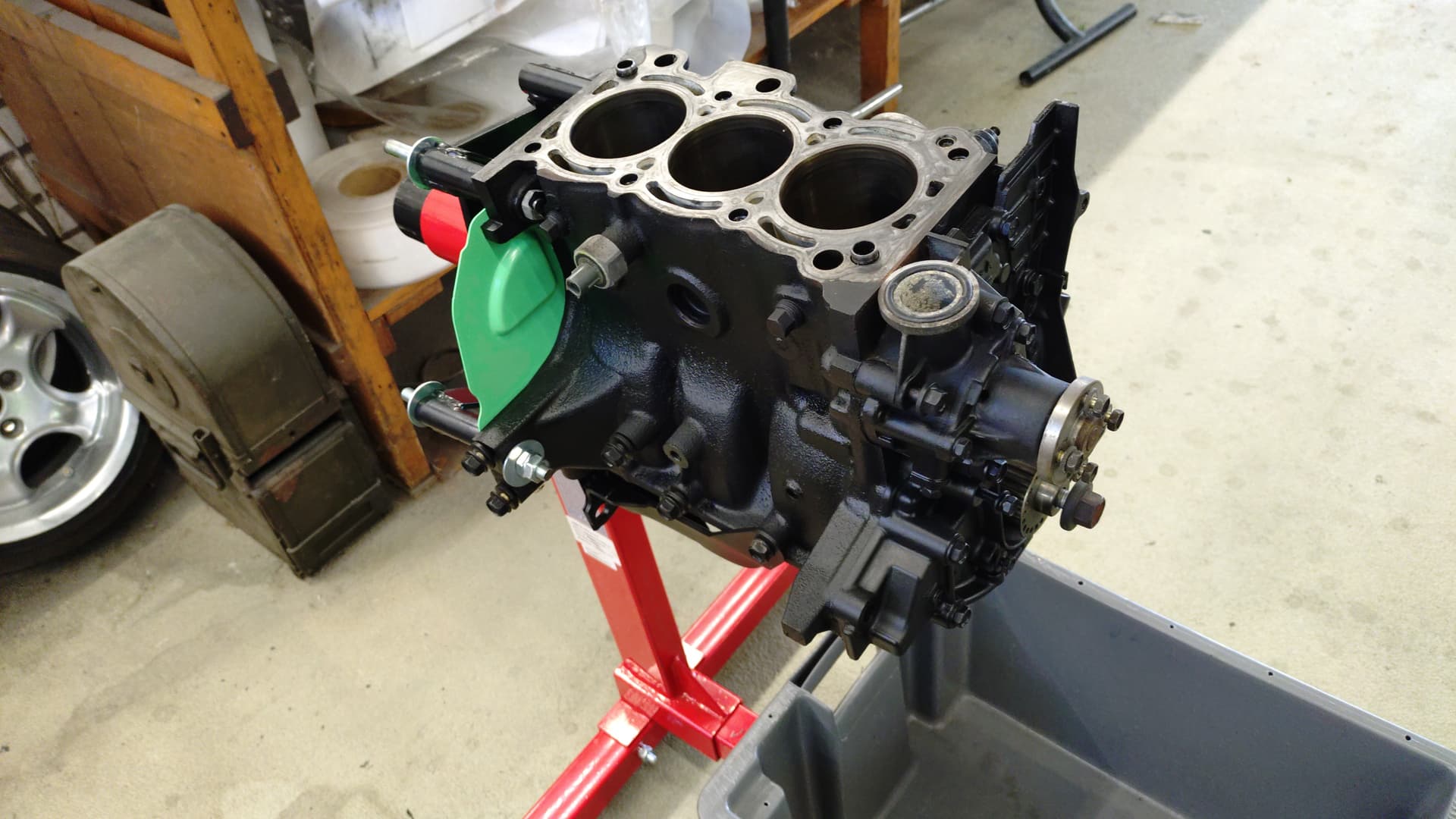

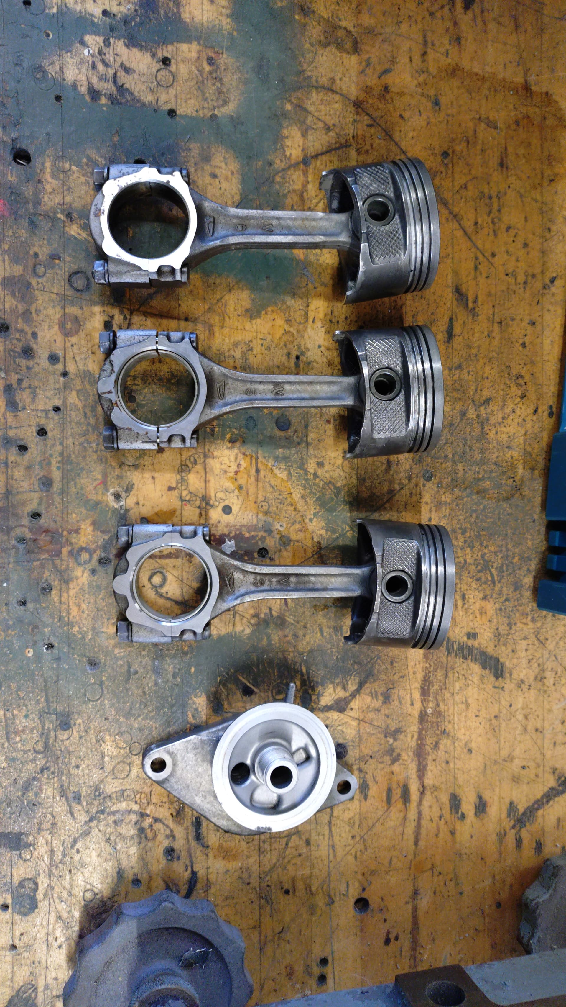

I’m working on an engine rebuild and definitely want to tackle the pistons.
The engine was smoking even worse than a junkie with a joint.
But for an engine with only 137,876 km
I think the oil scraper rings were stuck.
That turns out to be correct, which is what I thought.

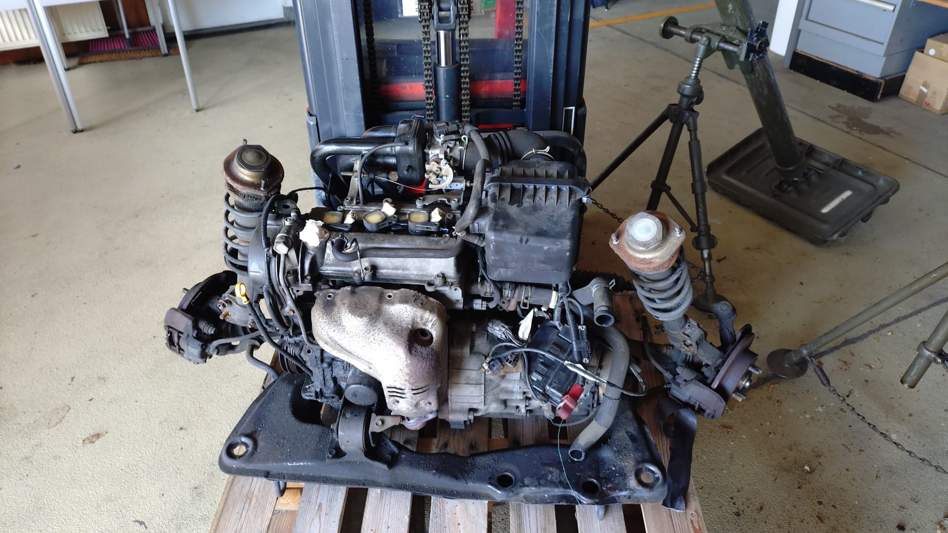

engine of the scrap yard
Time to start.. :hugs::hugs:

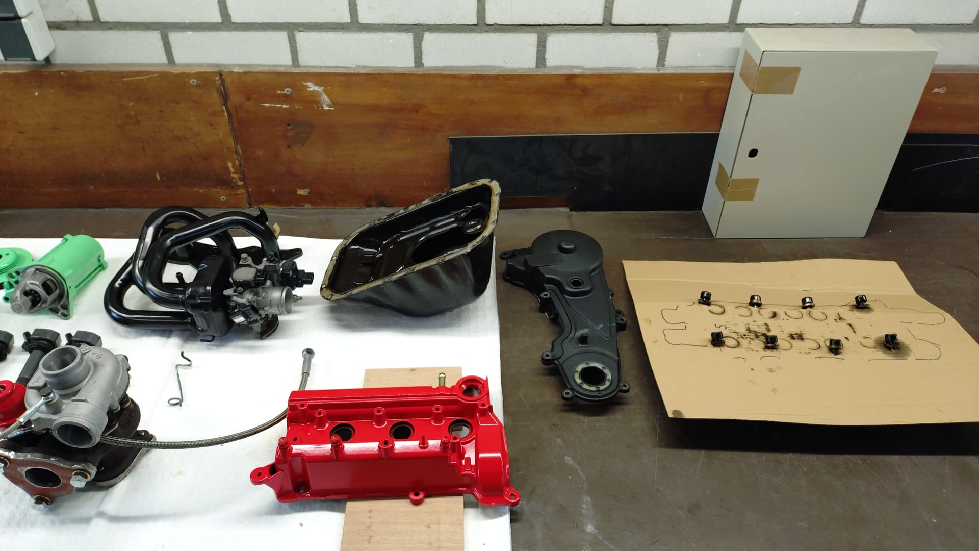

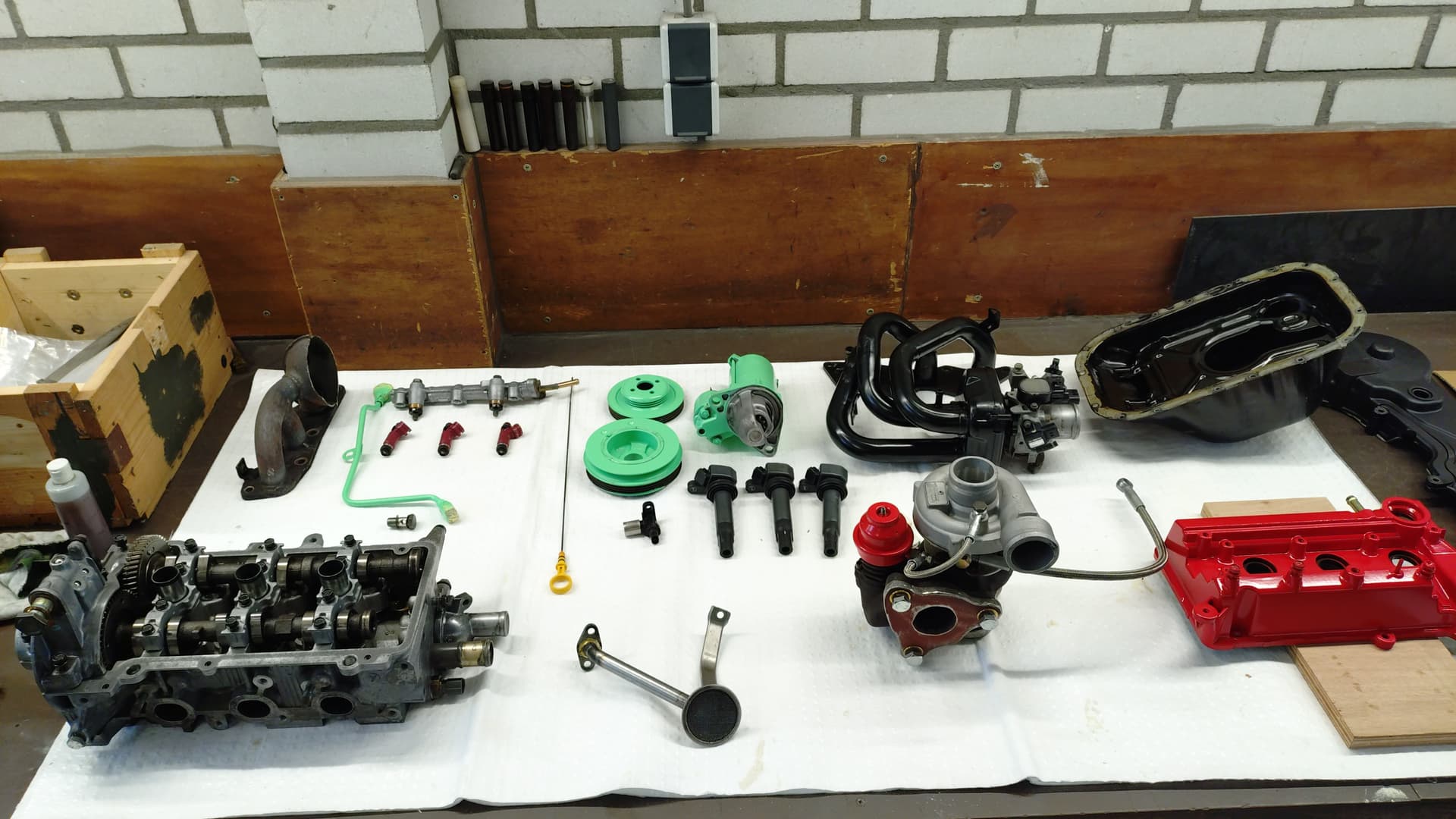

I’m going to completely disassemble the engine and replace a lot of it at once.
Then it’ll be good for a while, which is nice.
Here are some photos of my progress.

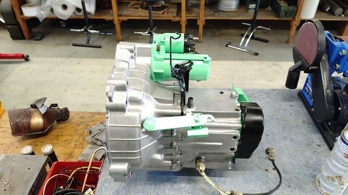

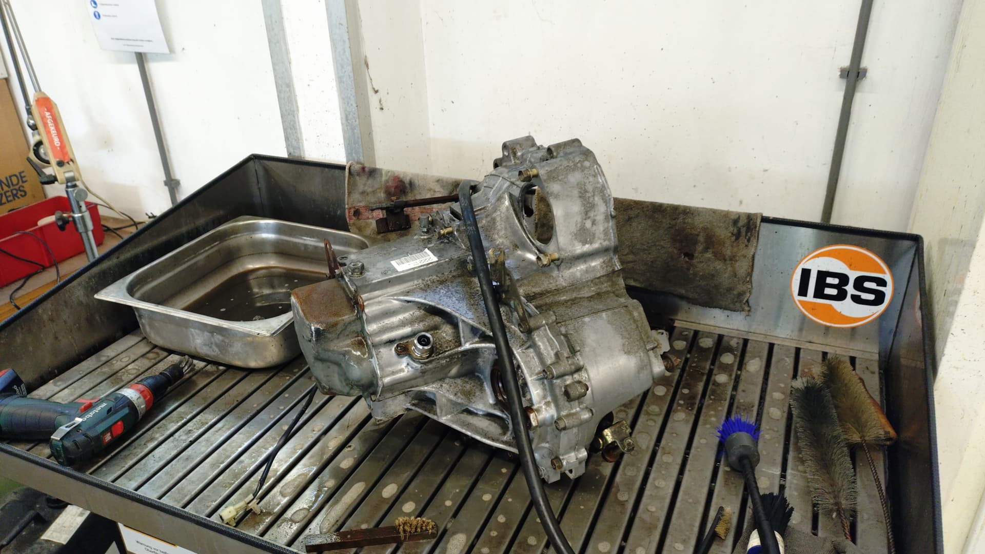

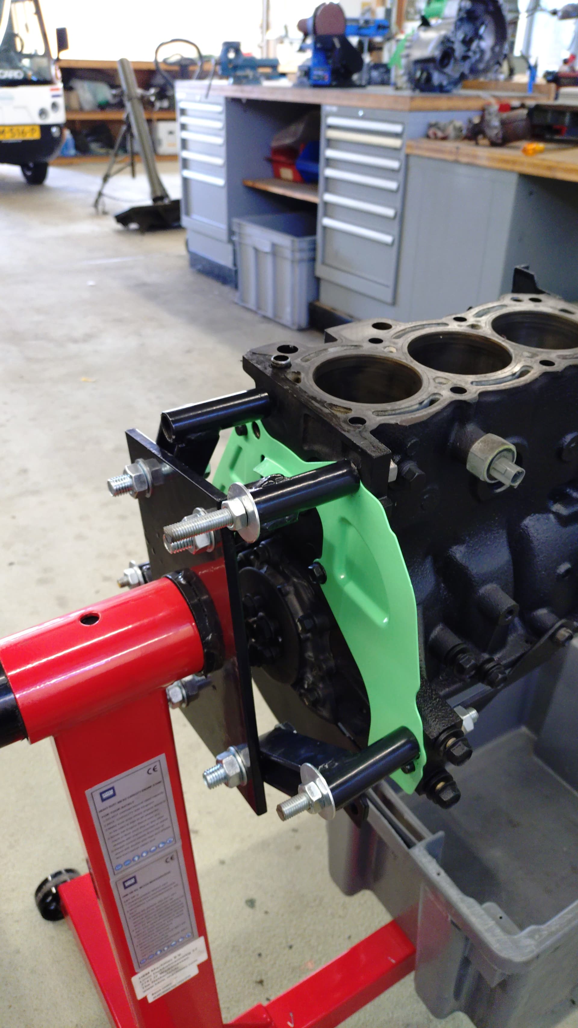

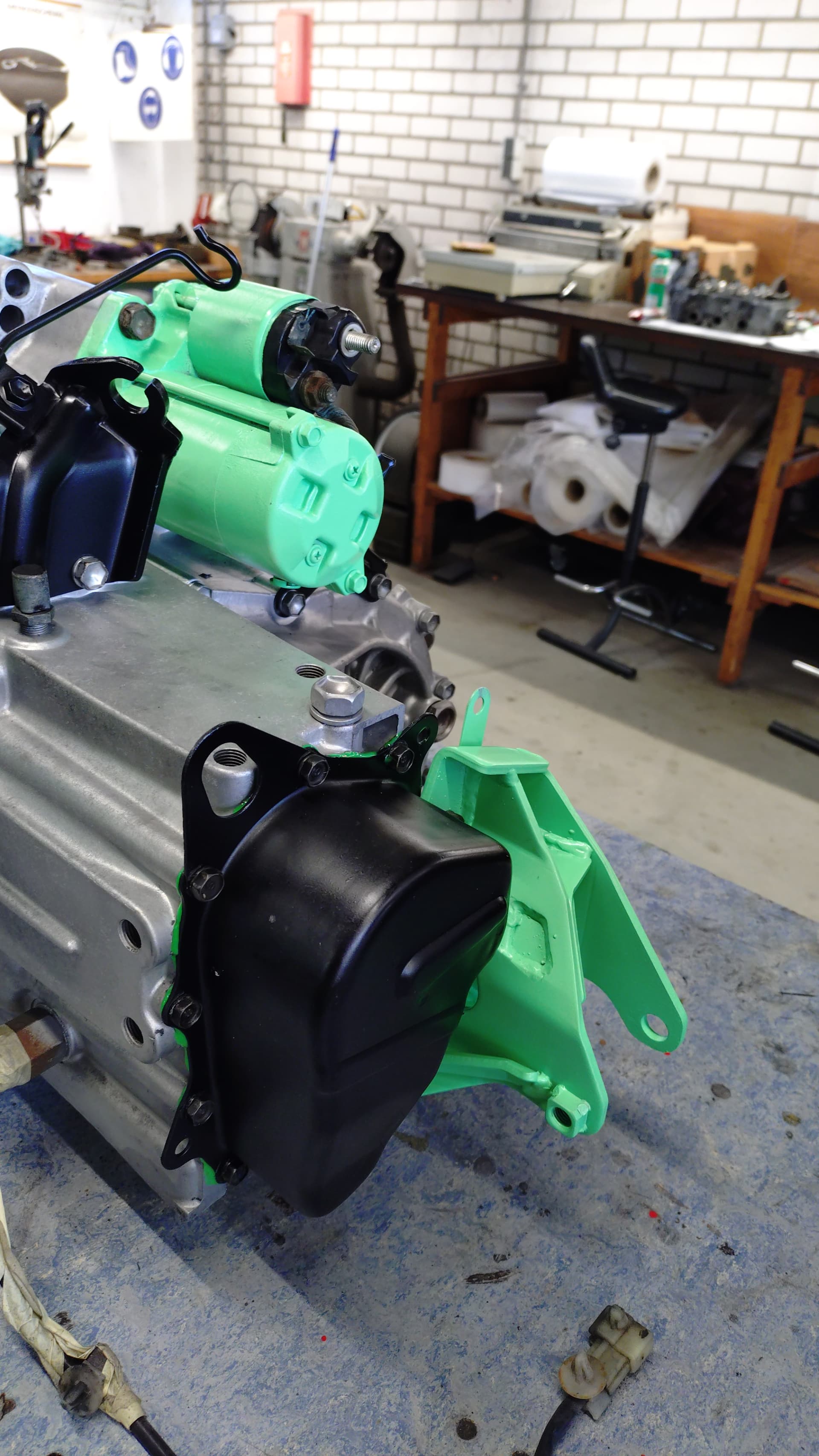

and of course I also tackled the gearbox

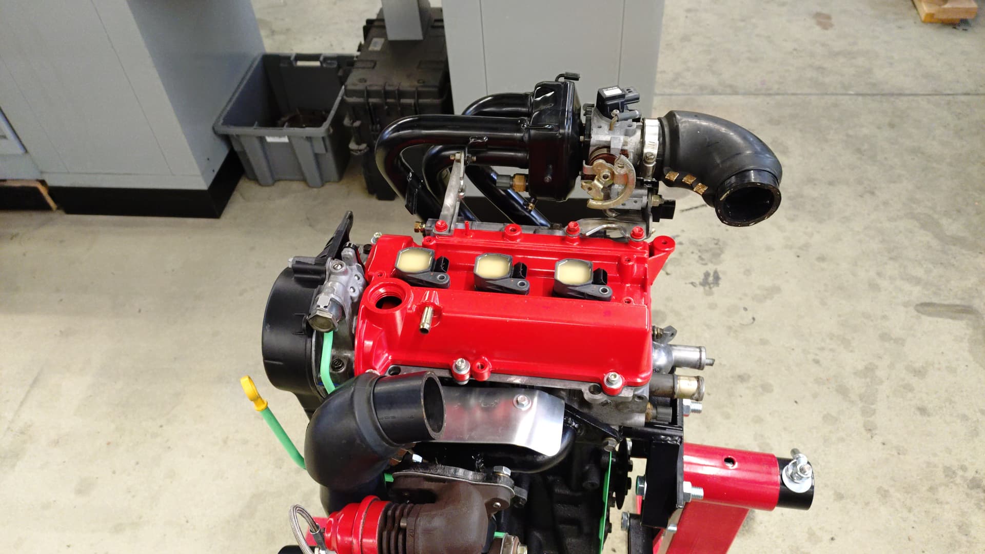

Oke a small update

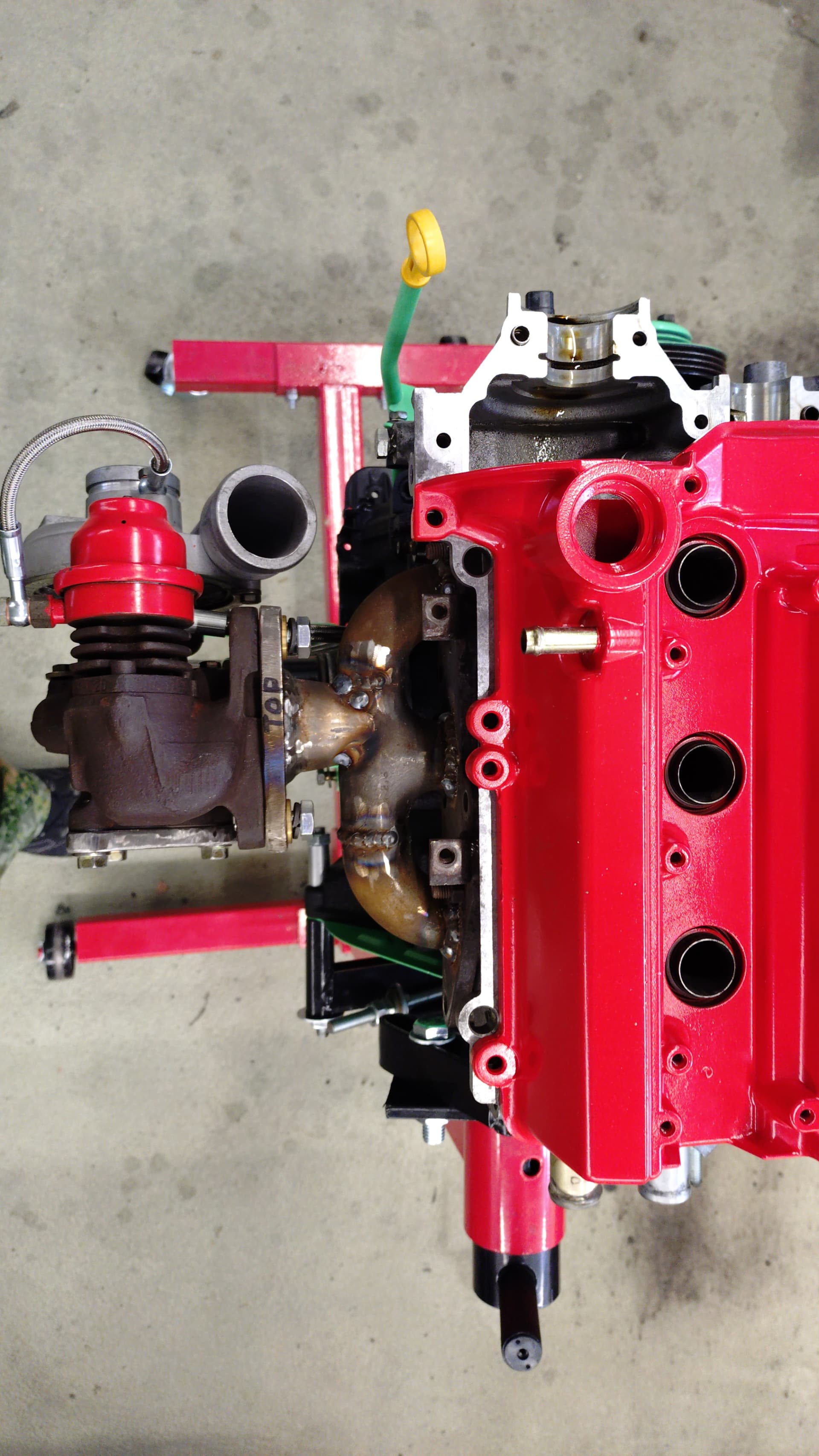

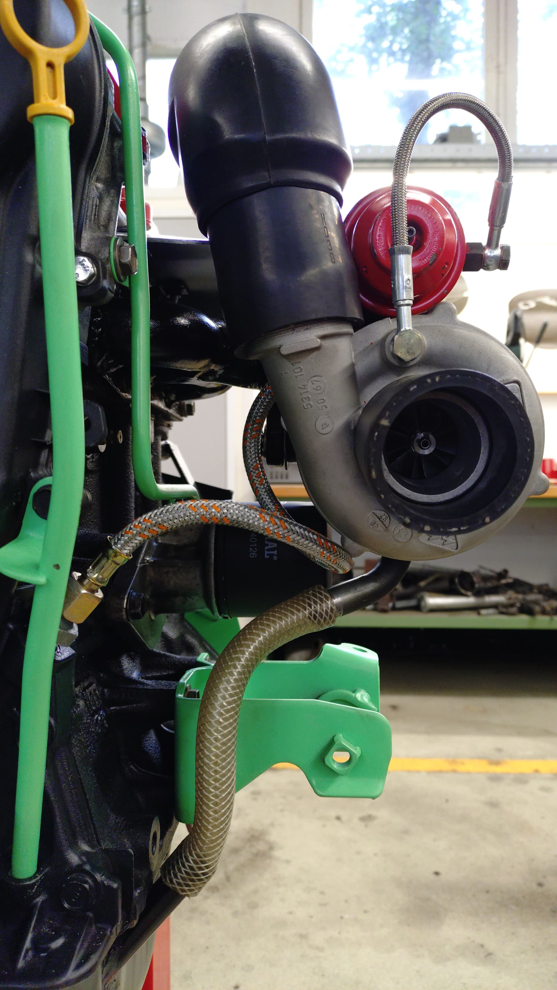

Still have to weld the manifold, but mockup is compleet.
Where do i take the oil from for the turbo??
Is there a good spot on the engine.

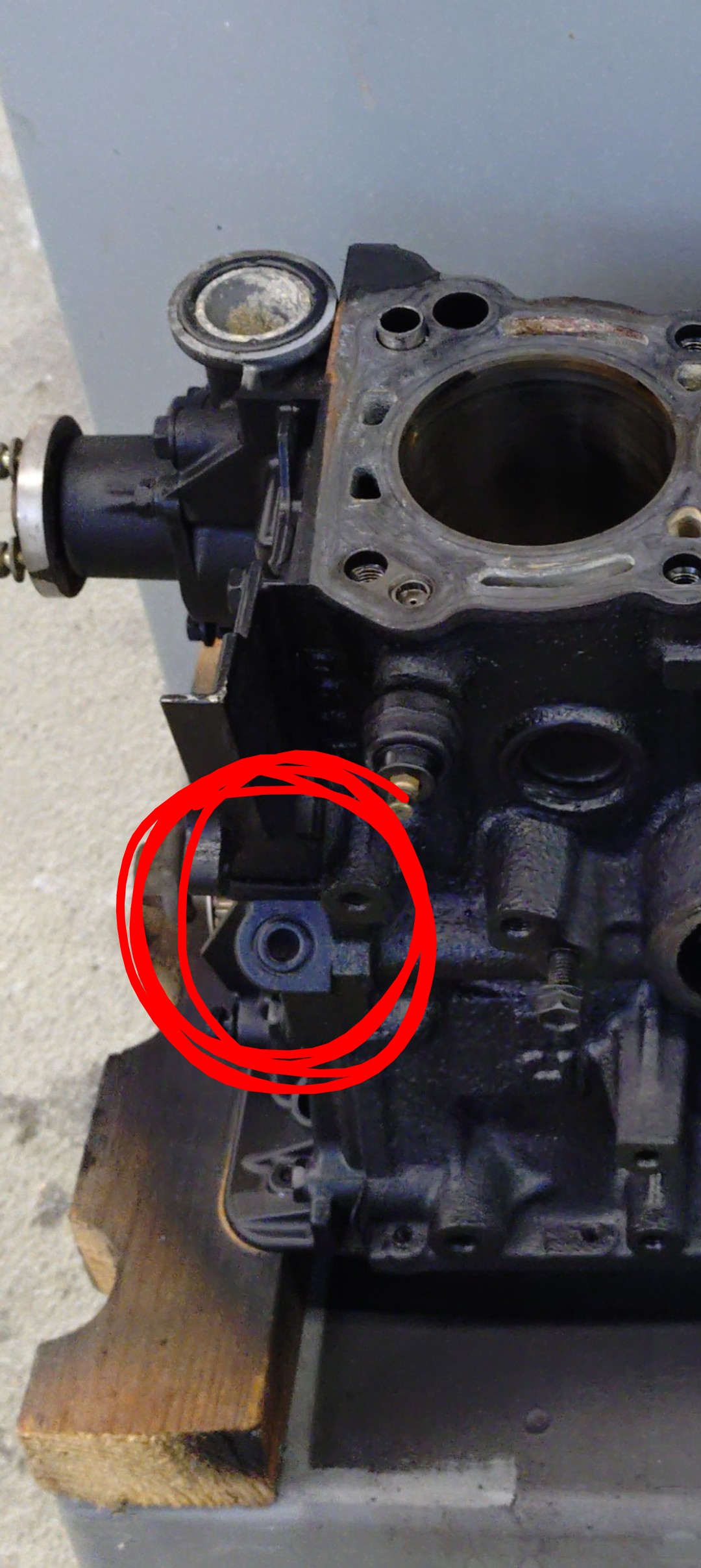

okay I have a question, where is the best place to attach my oil line for my turbo.
I don’t know where the best place is on the engine block, or should I make an attachment point somewhere.
Can anyone help me, I have no clue.

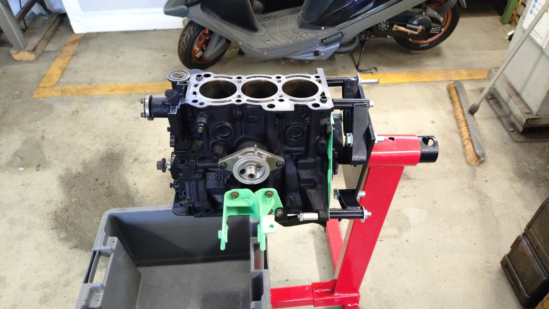

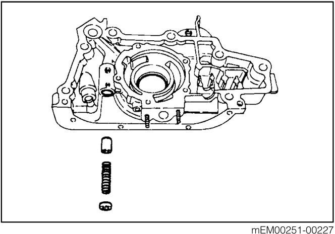

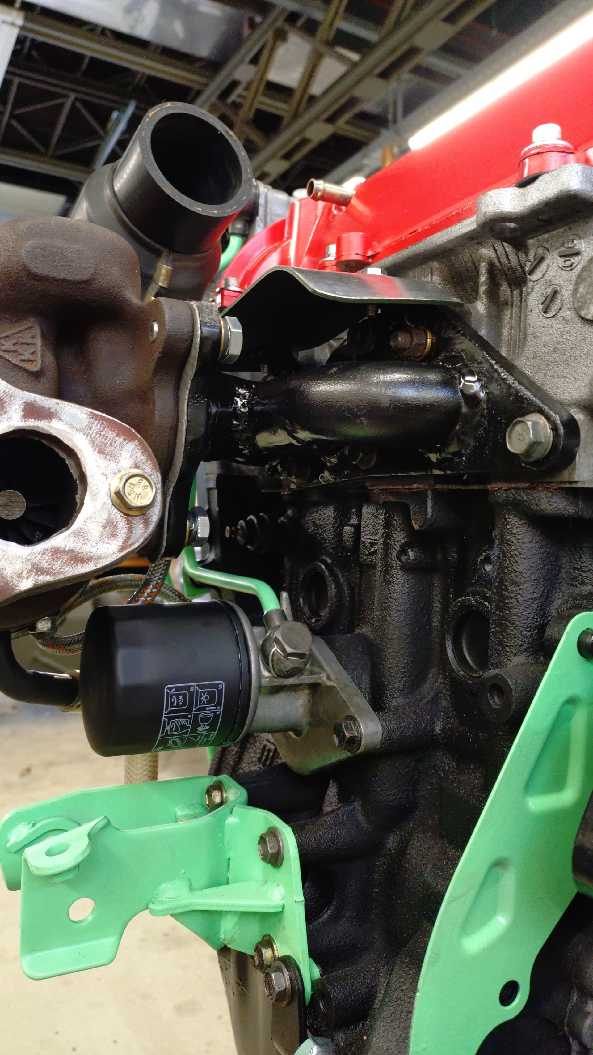

Is this a good place to place the oil pressure side of the turbo??

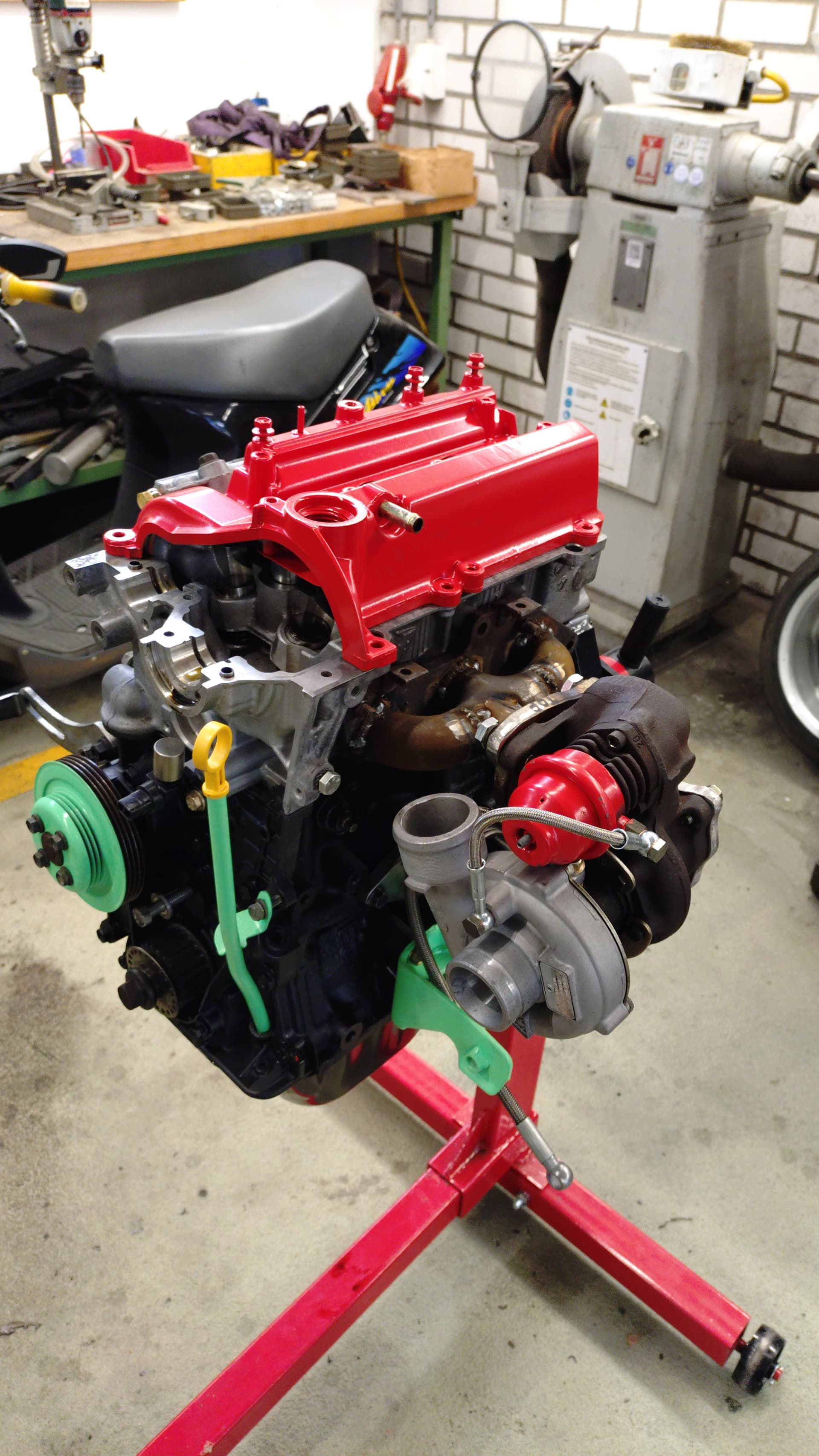

Here is a update on the engine.
In that top image, where an external line running from that casting behind the oil filter is connected, is this connected to your turbocharger?
In that second image, I’m almost sure that where you have that pressure hose connected is where an oil pressure spring regulates an oil control valve. I’ll jump over to Windows 10 where I have a pdf showing what’s in that circuit
Yes thats the spot, do you have a pic or image.
can you show me where it should go?
This is the place that i am using mow.
There is no spring behind the plug, there never was one.
No need to worry. That looks like an unavoidable drilling for connecting the oil circuitry. In other words, it’s safe to connect your turbocharger’s line onto it.
The pressure spring is located within the aluminium oil pump assembly, as shown in an ED’s illustration:
Okay, I put an extra plate ring in there to increase the pressure a bit.

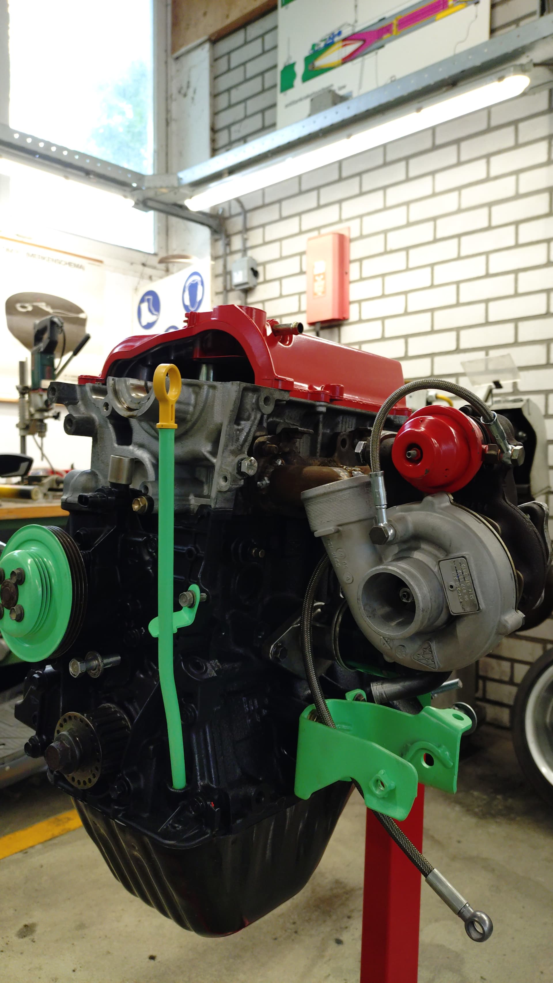

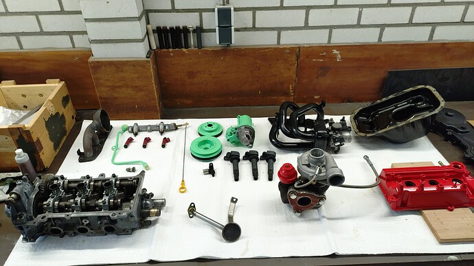

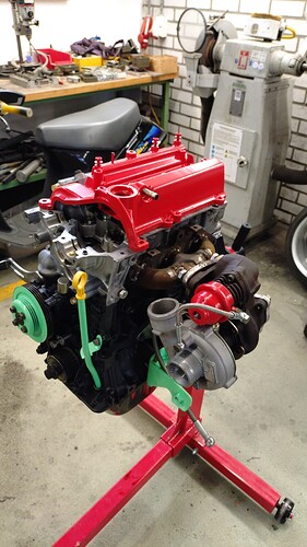

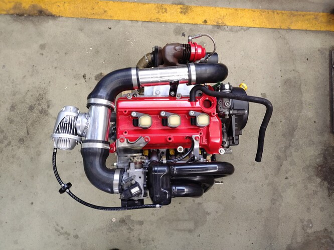

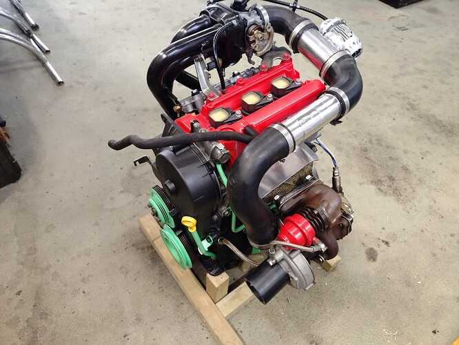

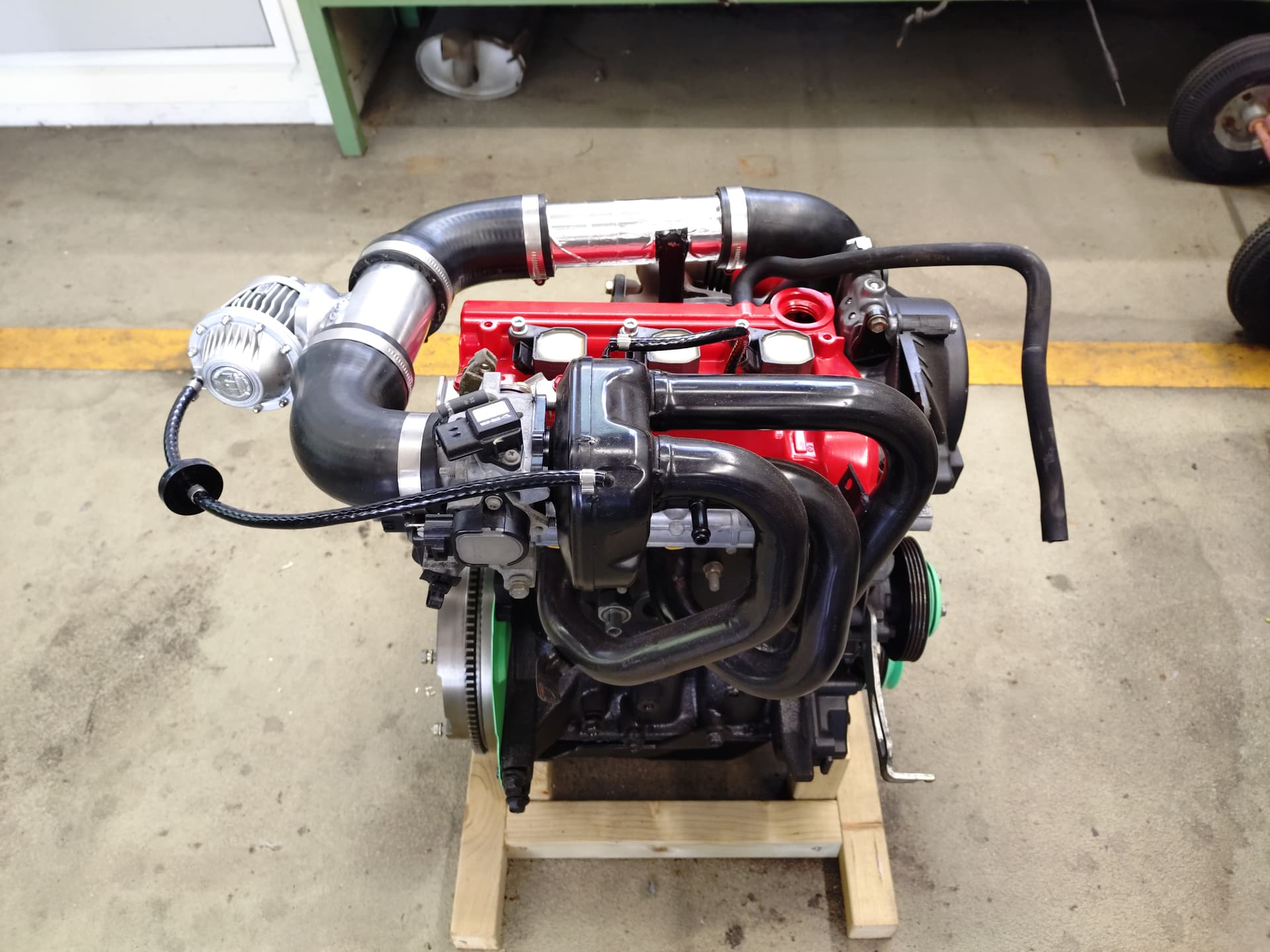

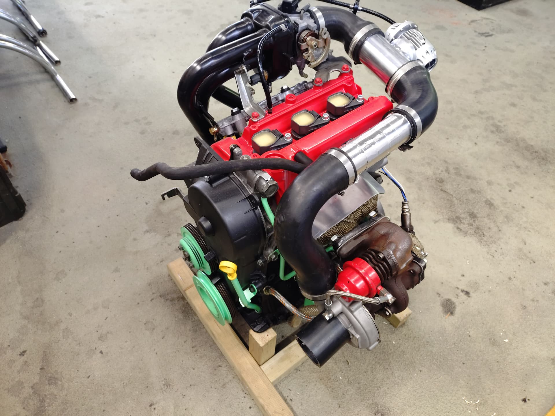

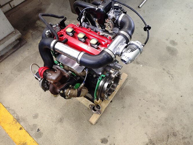

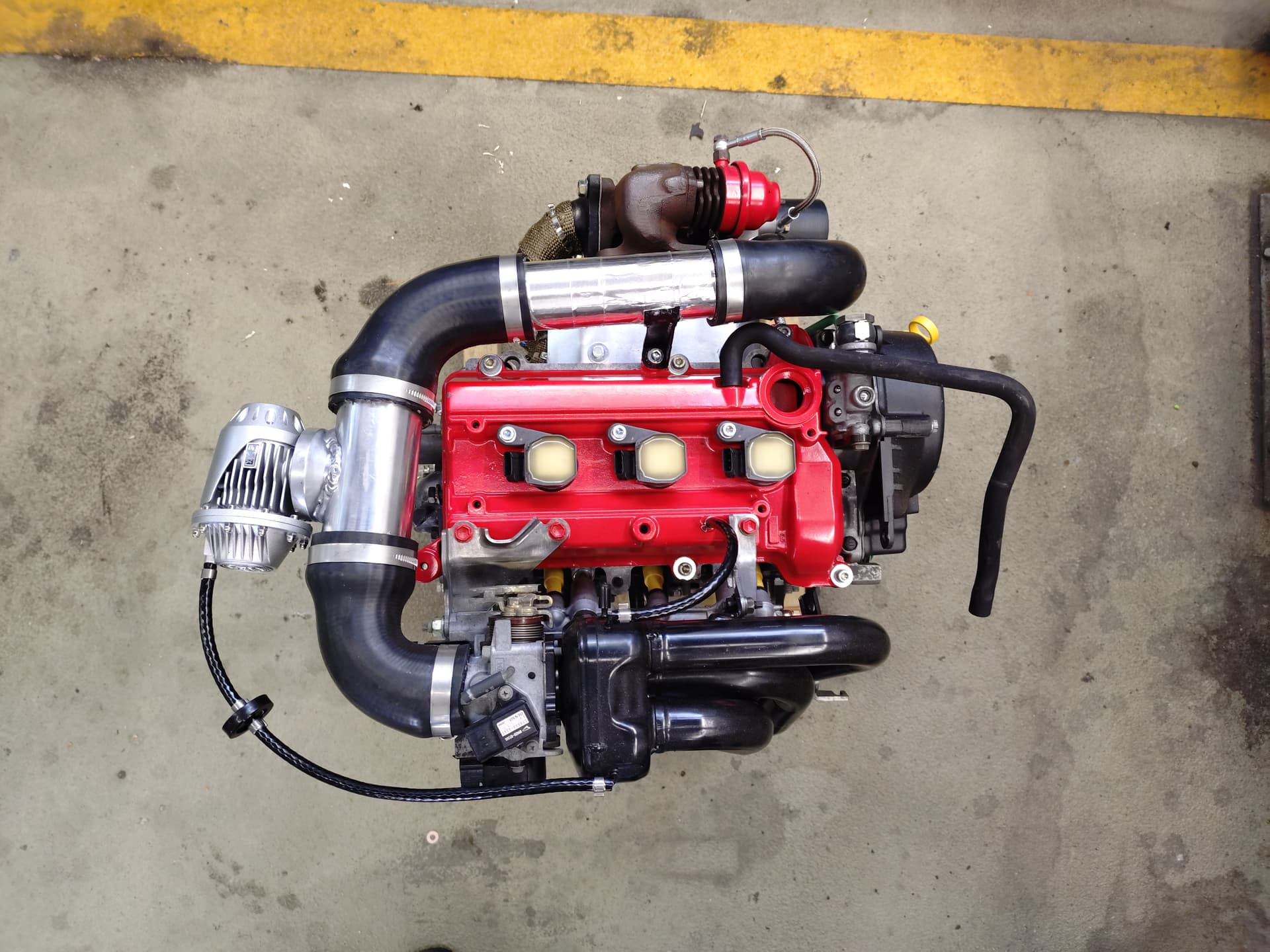

Oke here is a update on the engine, looking forward to driving it :face_with_hand_over_mouth::face_with_hand_over_mouth:
I tried to use as many new parts as possible. But sometimes they have to come all the way from Japan or Malaysia.

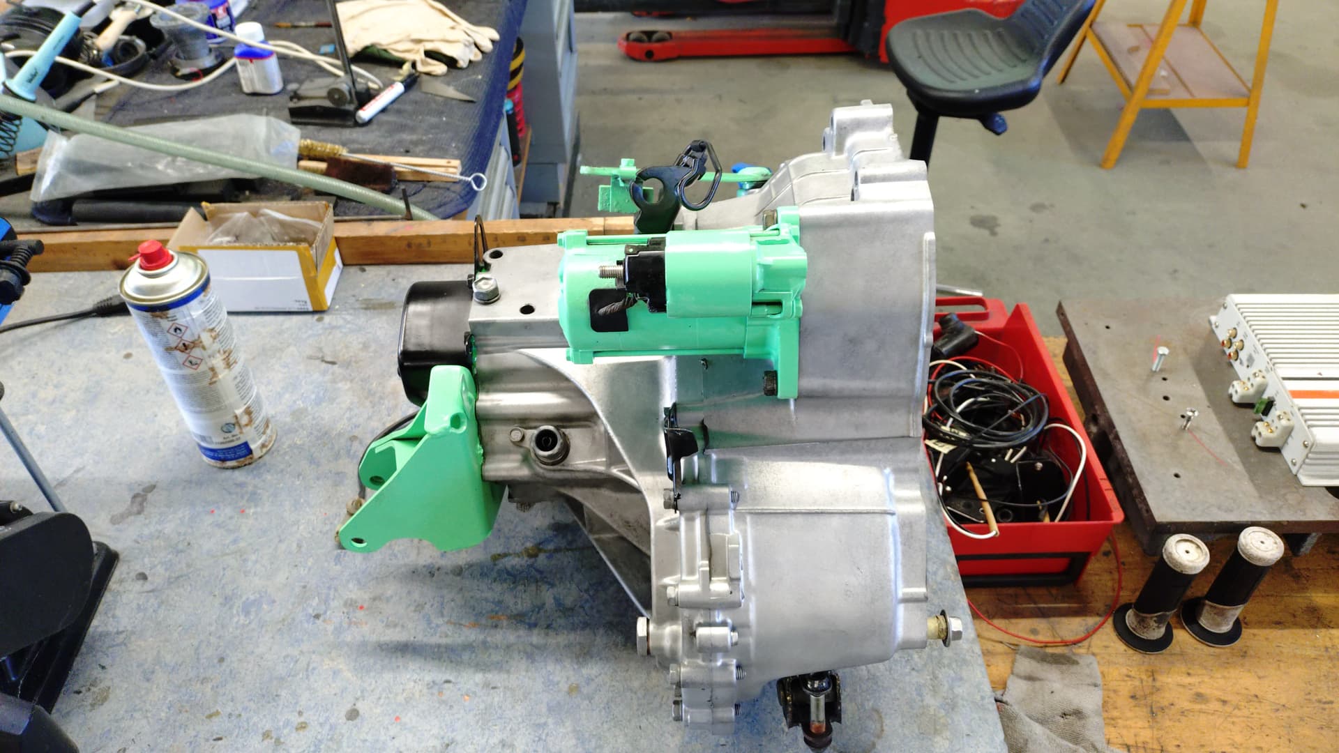

Now just the clutch left and I can start installing.
The subframe is also being worked on, by the way; update to follow.
that looks great. Love the multi colour and the BOV

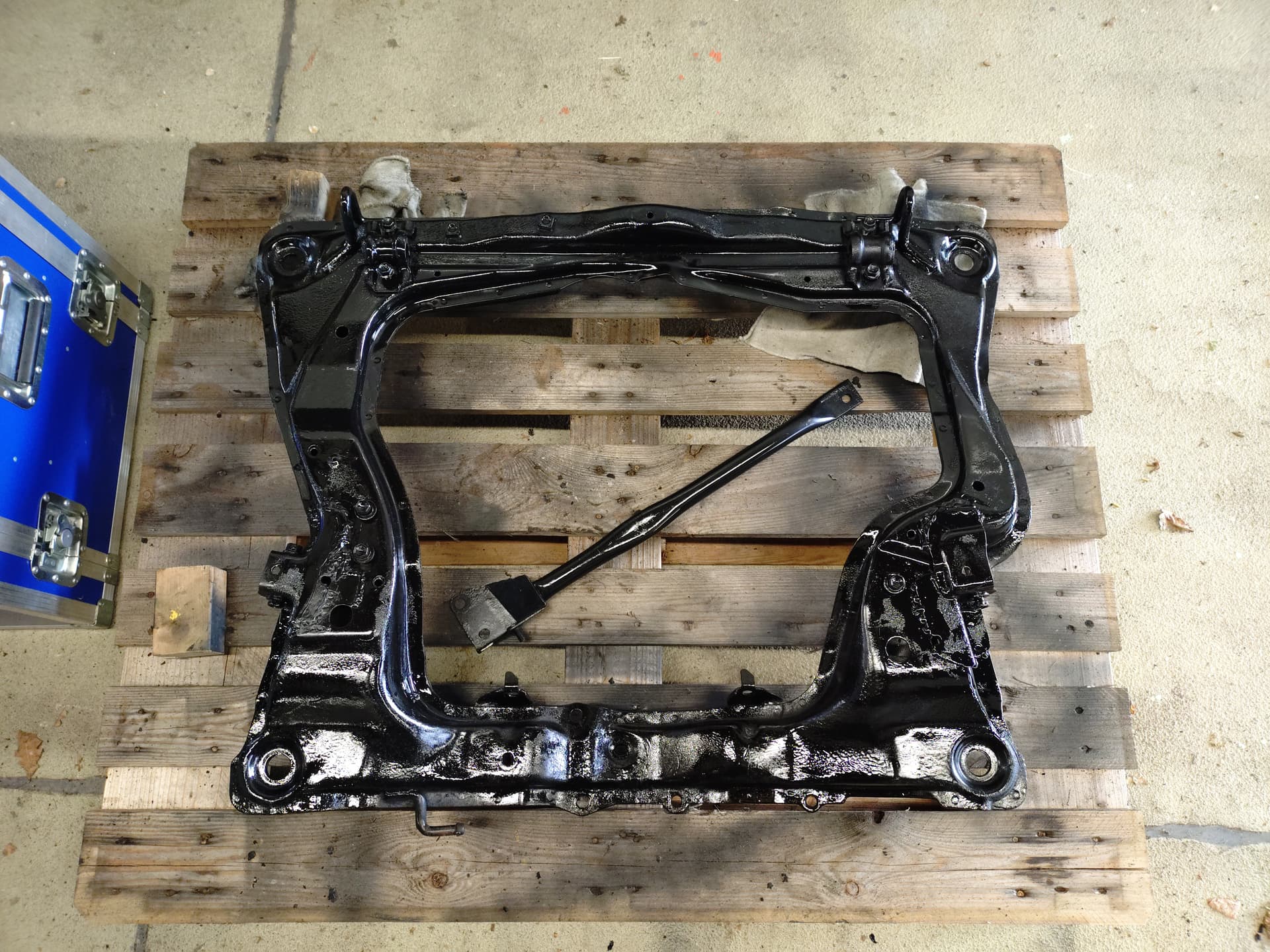

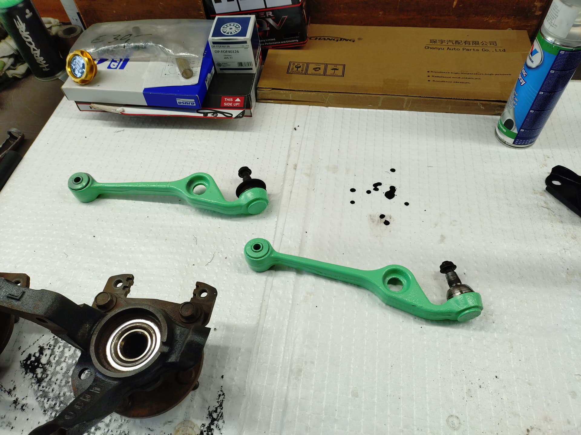

The subframe is on its way up…
Reinforced the subframe on the lower arm connections.
I thought four spot welds was a bit too few, so I just welded it all the way around.
