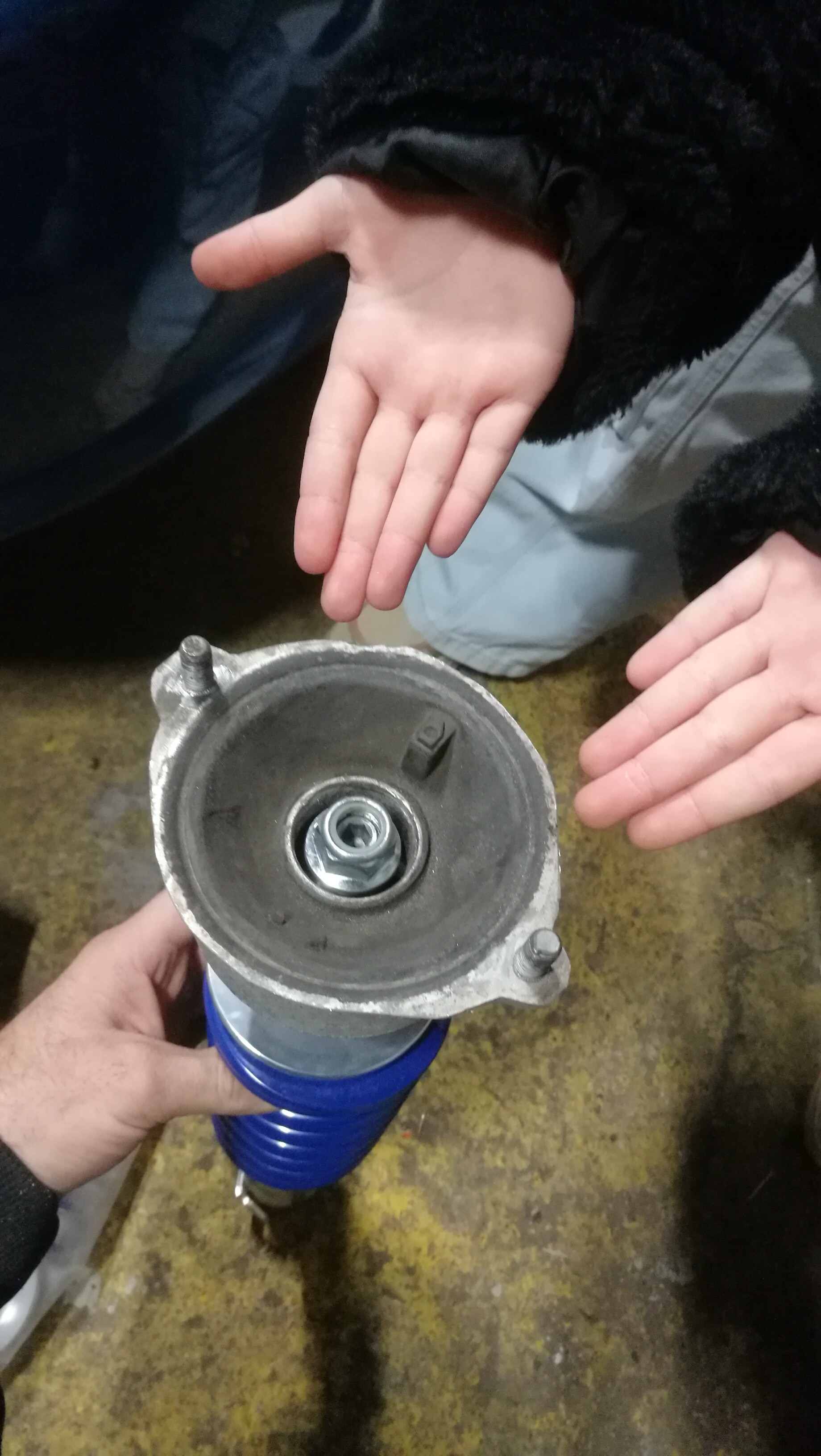

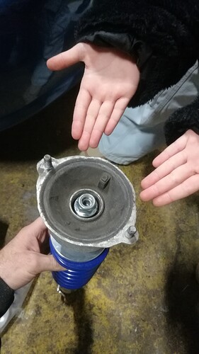

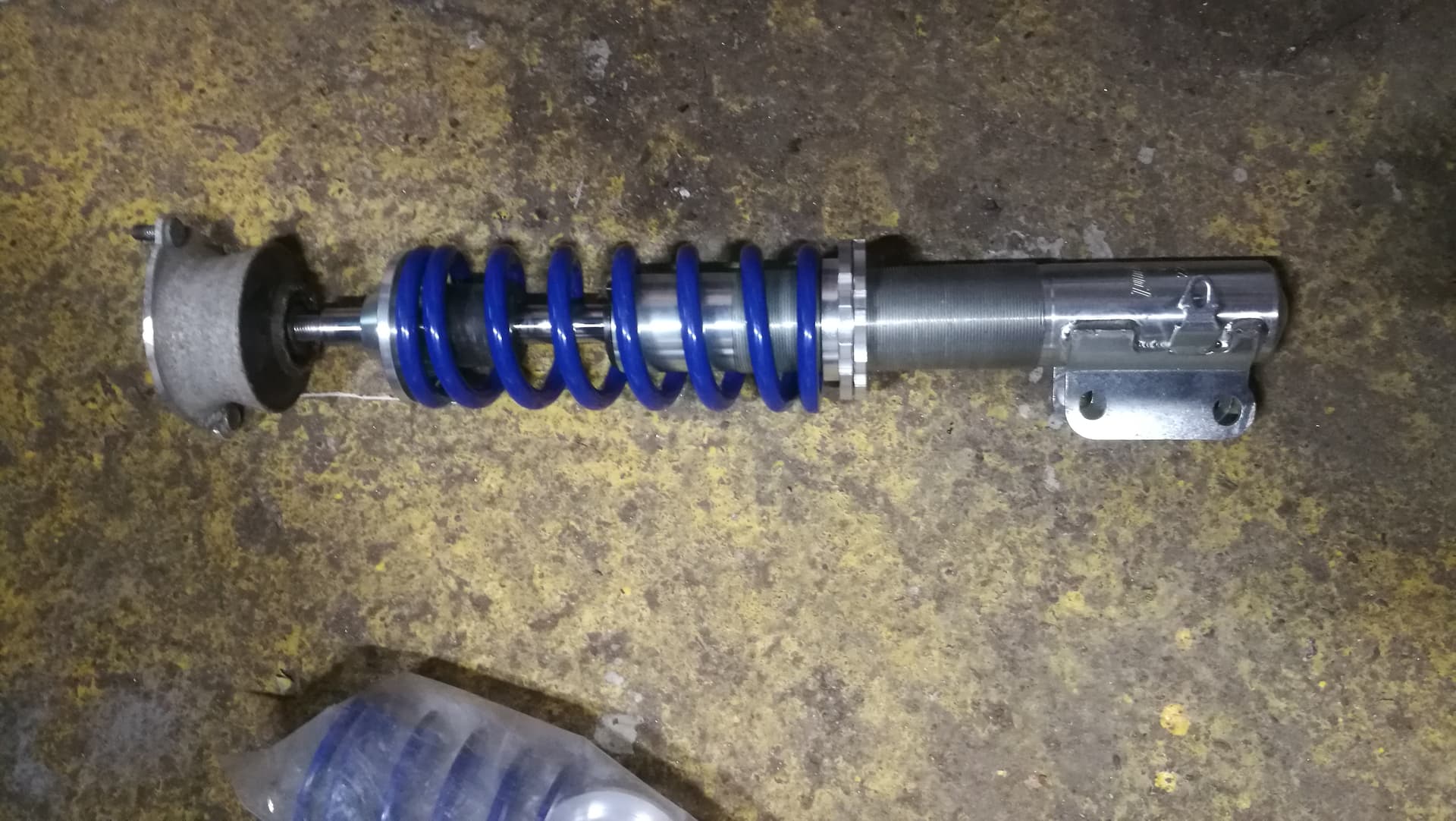

First tackle was promising but kinda dissapointing, heres few things:

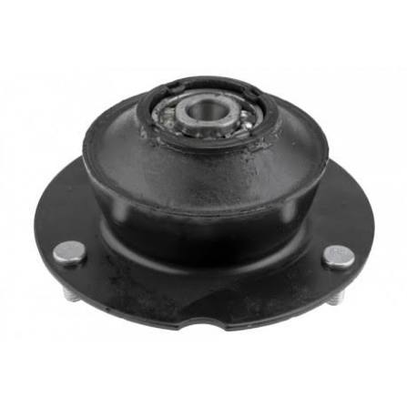

-As topmount im using heavily trimmed bmw e46 hat, it has integrated bearing (like that one, wanted to use it in micra back in the days)
- Leg mount to knuckle has exact same width
-one screw needs to be redrill/trimmed but not much space to make camber adjust
-bottom of the leg is very close to cv joint rubber boot, but only when car is jacked up
-legs are much thicker than stock shock, 7x15 ET40 wheels dont fit :frowning:
-ditching the helper spring and move spring all way up doesent help much. Wheel have only 0.5cm of space , also camber seems to be almost positive. I dont know how its possible that Malasyan cars have so much camber. Maybe they re using camber plates at the top.
Overall I’m thinking about gave up the polo way and use “lovering kit” way instead. In this case lover spring perch is above tire, so theres more space for wheel. I wanted to avoid bolton overfenders.
Thinking about test fit daewoo matiz legs. It uses similar suspension setup.
Anyone tried these? Someone mentioned that succesfuly fited polo legs, wonder how he did it and what wheels does he use. Look like theres about 20mm wheel spacer is needed to move wheels further from the spring
That top mount pictured has a replacable ball bearing. All you would need to do would be to grind off the tabs that hold it in and then replace the bearing with one which shares the same outter diameter with the omount pictured and the inner diameter of the strut’s shaft you plan to use
Thats no needed butch, bmw tophat bearing has exact size as polo shock thread. I chooosen it because had hard time in micra to fit top bearings from corsa. Machinist almost broke boring bar. VAG shocks always has bigger shaft diameter compared to japanese, or even Opel.
This bmw mount fits perfect at this coilover. (Ta tehnix/ tuning art, etc.) Also this integrated bearing provides no headache with those flat-type, or plastic bearings that rolls at upper spring perch. Always had problem to sit these correctly during my workshop past…
