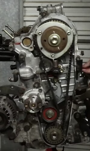

It looks like some of these Chery engines are missing 2 bosses on the transmission side and when they are included, they are not drilled (weld in and drill?). But outside of that and some valve cover weirdness, this looks incredibly faithful to the EJ. They copied everything down to the webbing.

[quote=“shanescott, post:7, topic:6919”]…some of these Chery engines are missing 2 bosses on the transmission side…[/quote]That the second and third image you posted shows either or, why not get the one which has undrilled bosses? You could then bolt on your Daihatsu bellhousing, thereafter drilling and tapping both virgin bosses, using (I forgot what you call this sort of punch) a punch which will self center. They are available in all usefull diameters. We used to use solid ones. The following is principally identical in function, with the exception that it’s spring loaded:
it’s not clear, as to if your China engine will be included with those dowel(?) sleeves used for precision aligning your engine to its assigned-to bellhousing. The three pins mandatory for bolt-up should suffice, so that you should not need worry about adding these to your block. Drilling for these will require even more meticulous accuracy than for the bolts themselves
