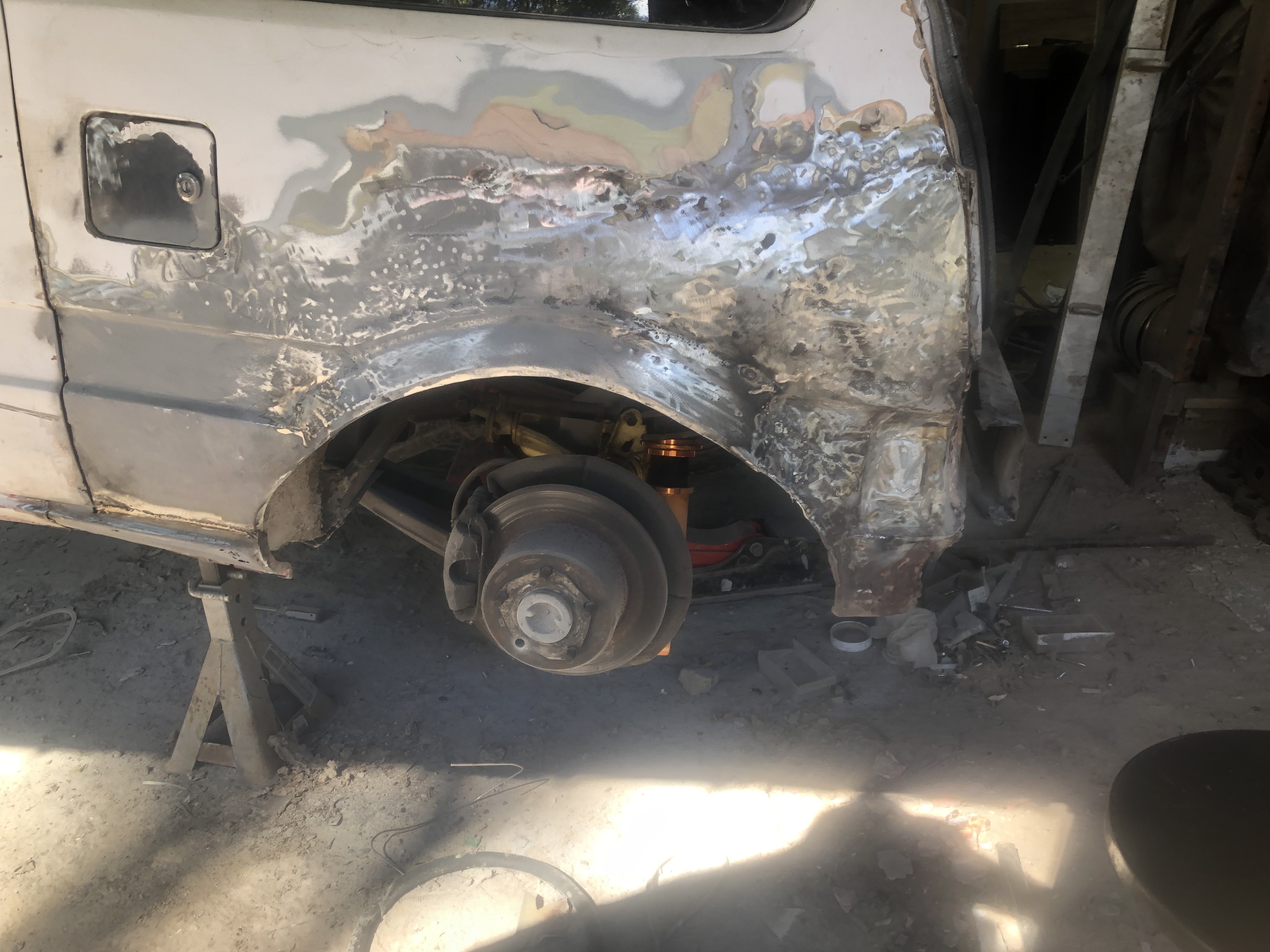

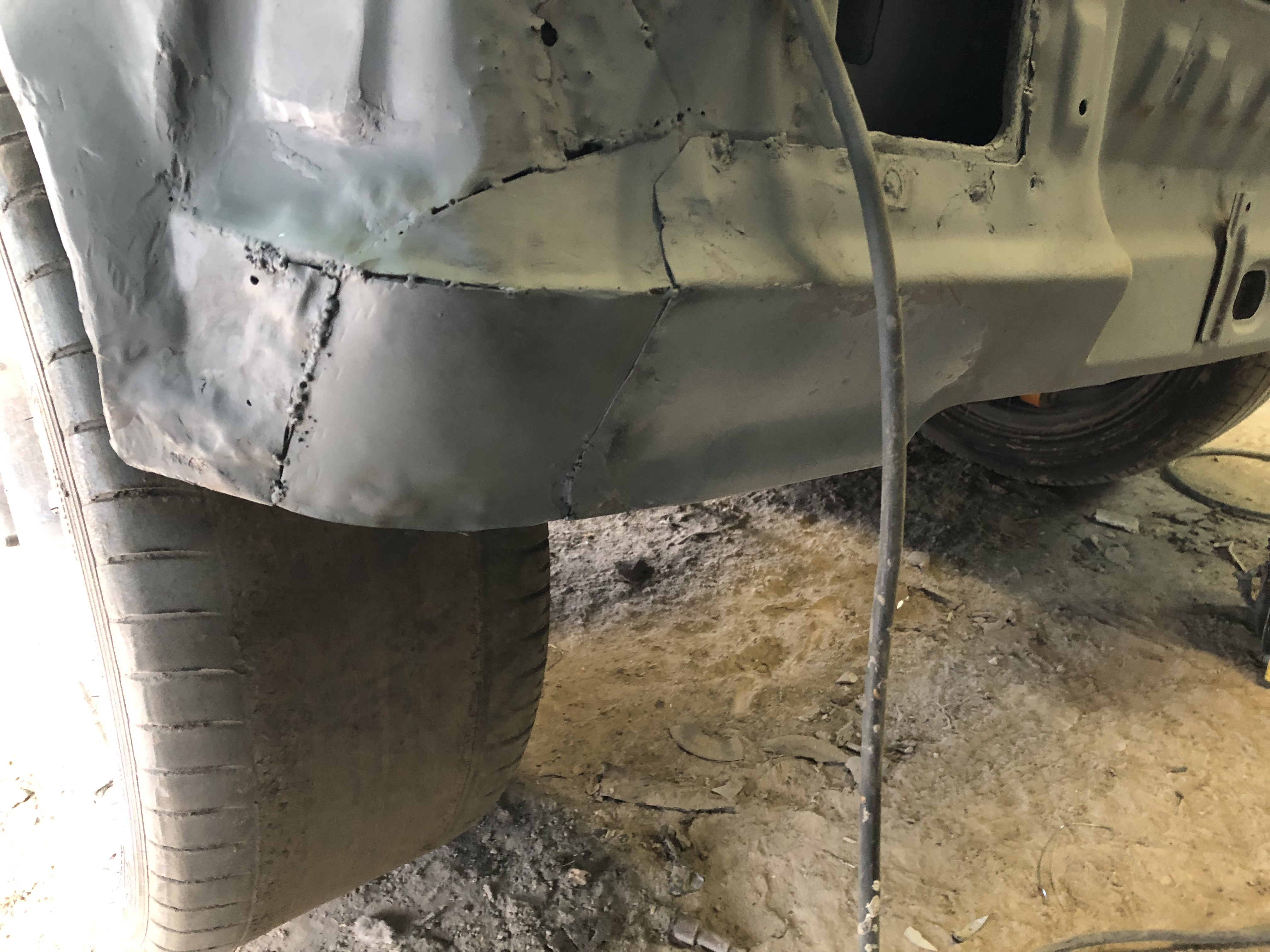

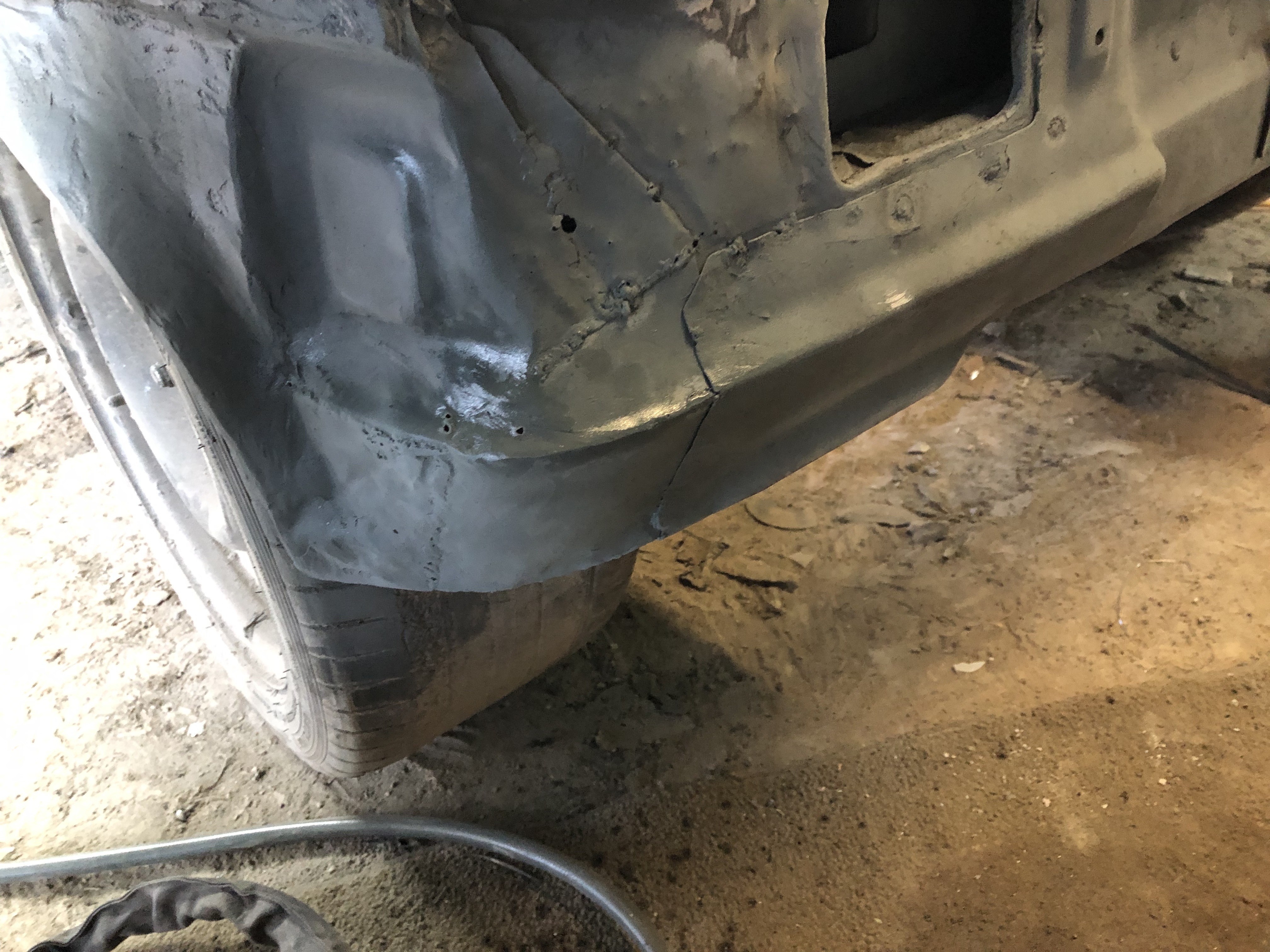

As for the car I’ve been stripping the front end and cleaning up what’s rusted in the past decade. Mostly it’s why was left after being burnt and with no real protection between the joints and a bit of moisture rotted it out.

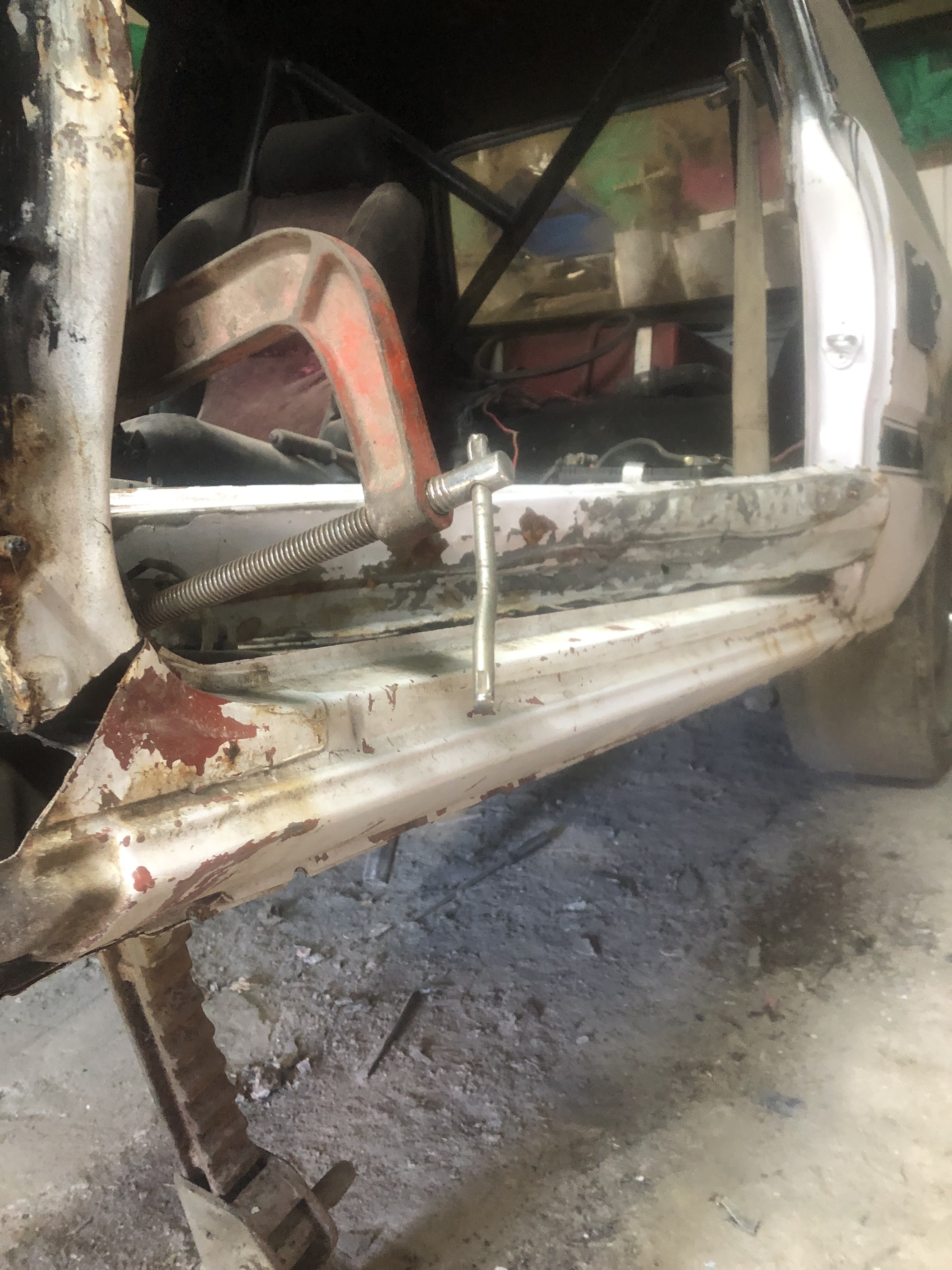

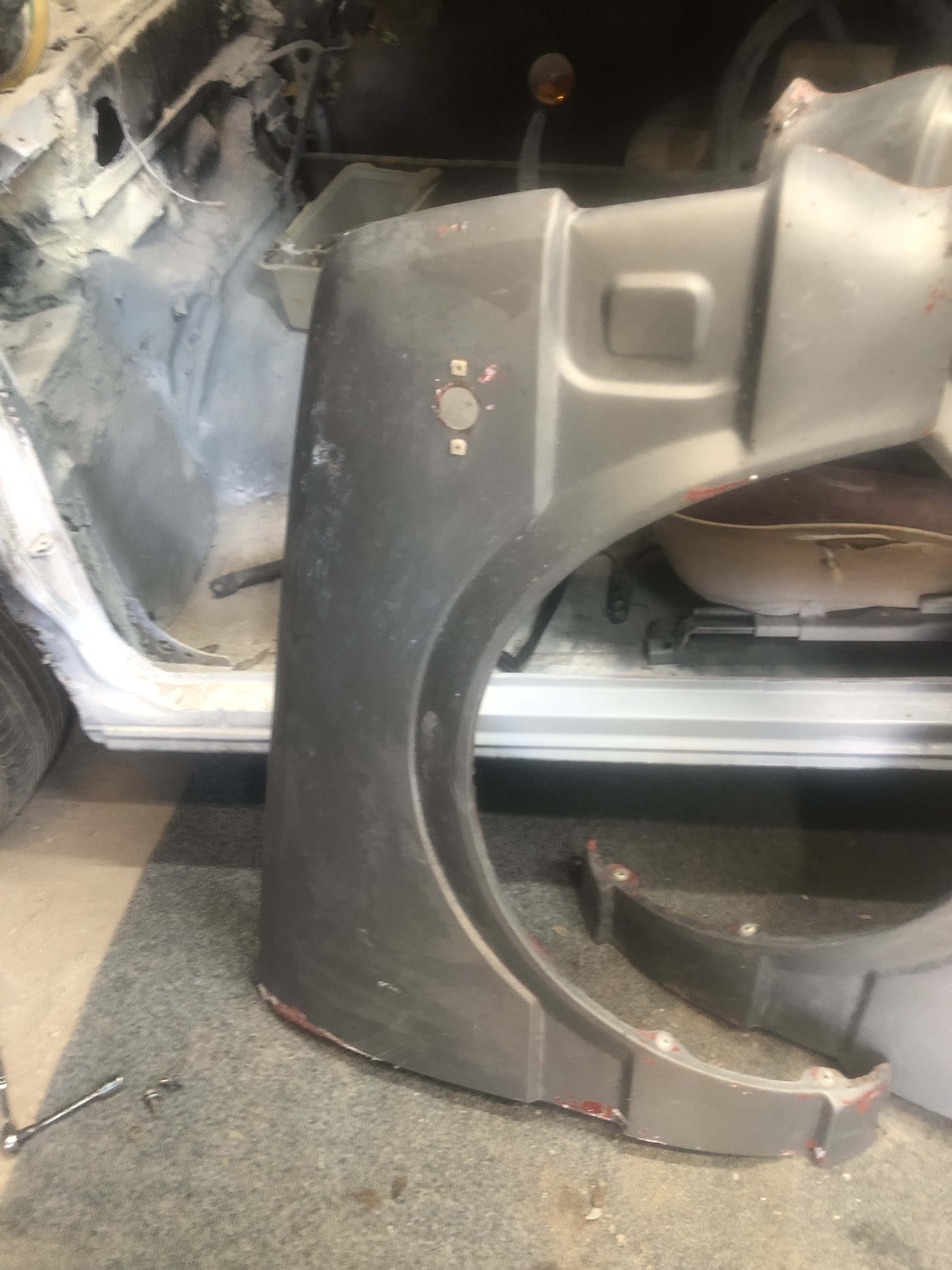

Replaced the inner guards at the top and around the lights. Fixed a lot of panel damage from the catch fencing. Replaced the passenger sill panel and need to the drivers

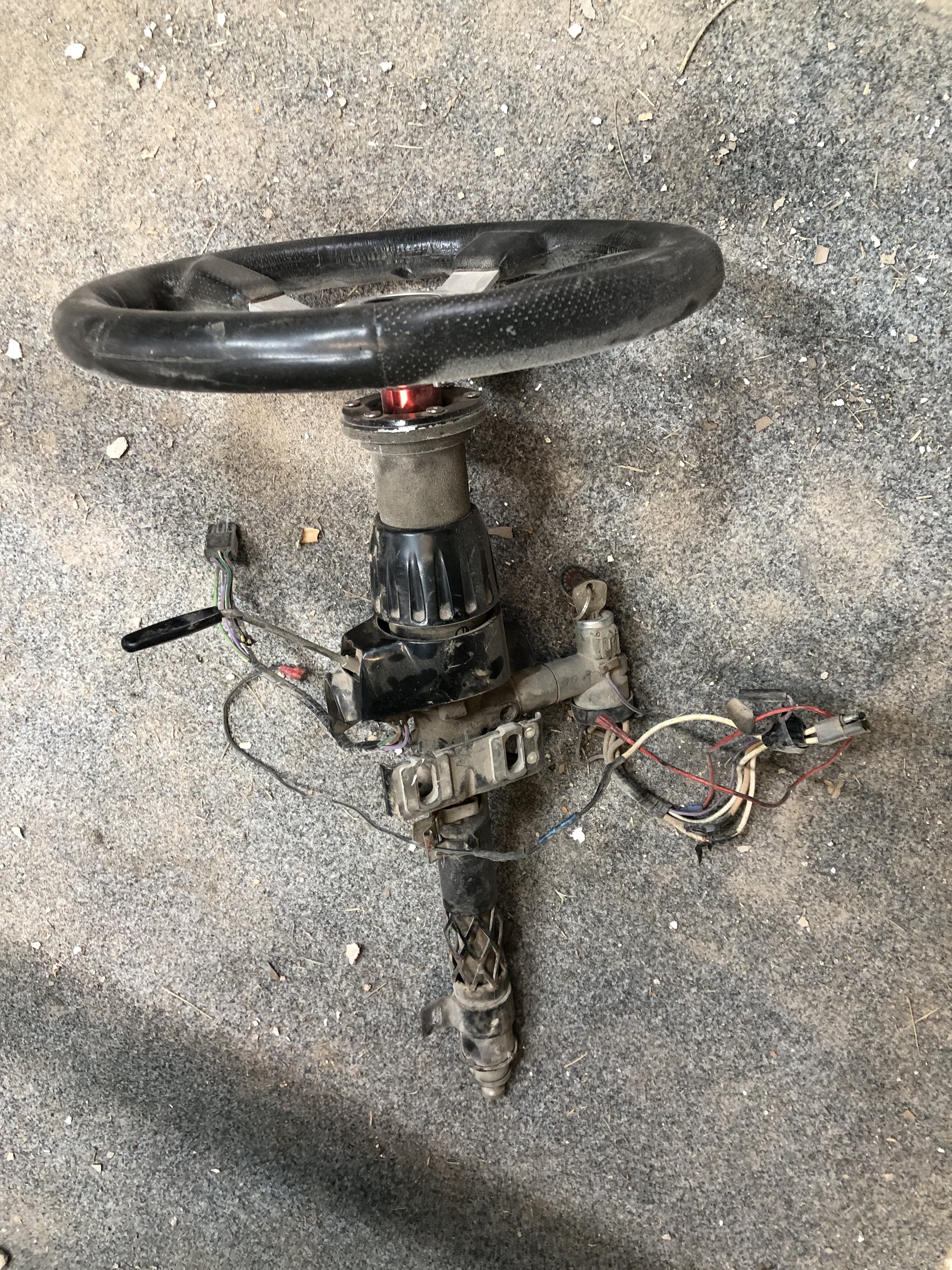

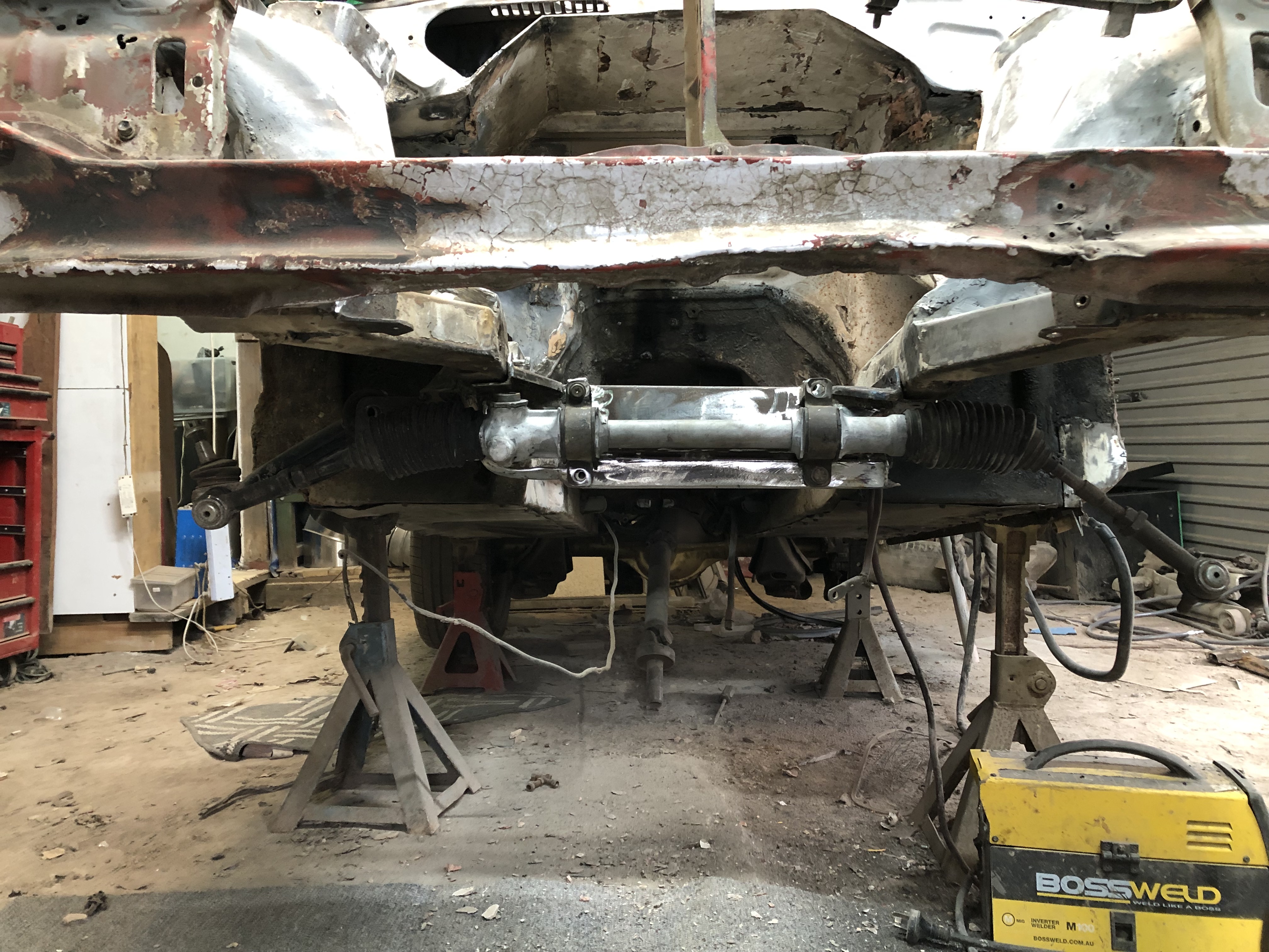

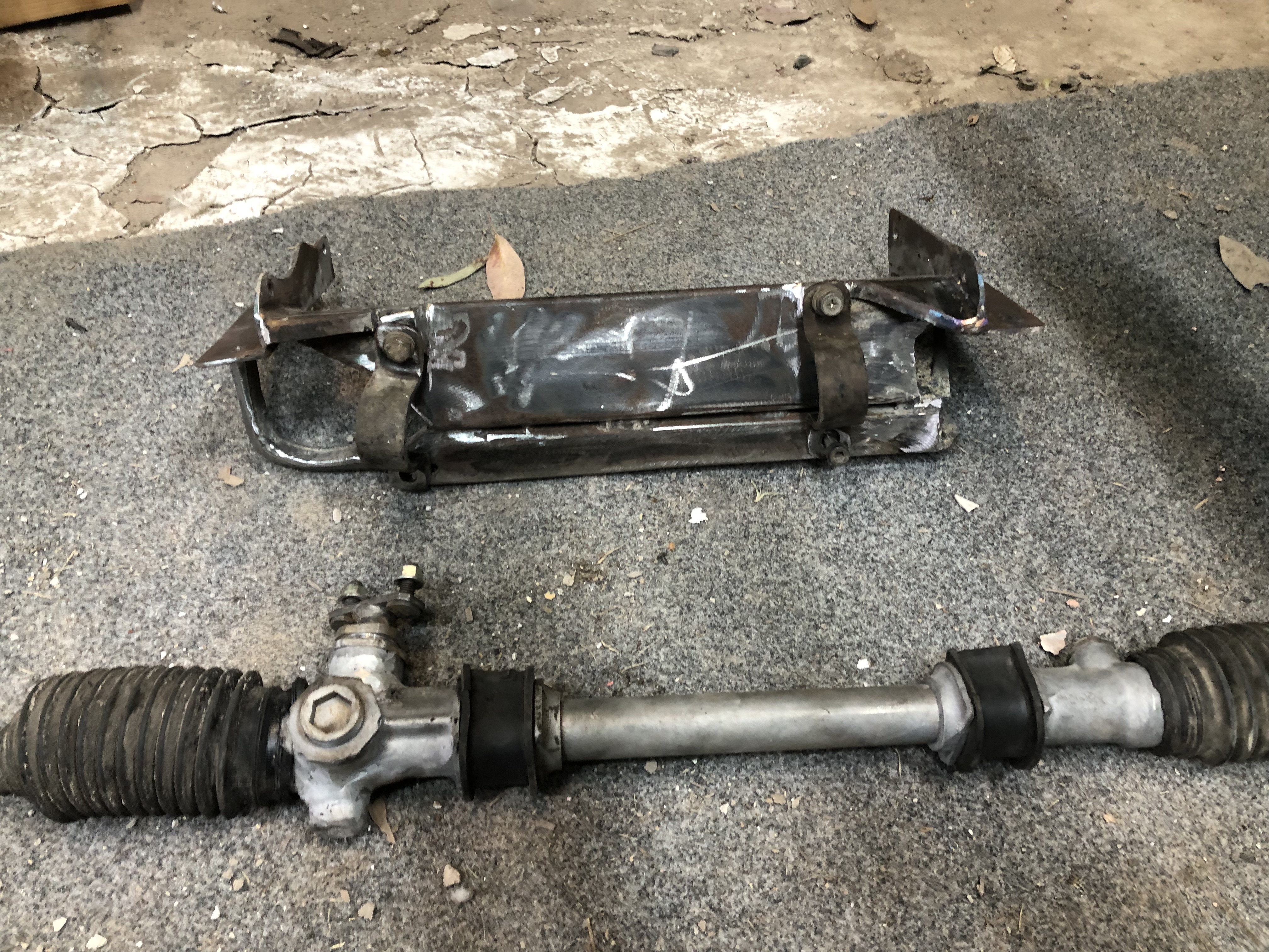

Finished fitting jag steering column and revised my steering. Moved the rack to the front which would have been easy if I had lhd rack. Surgery was done on the rack to say the least.

Ok just finished off my rack mount ready for paint.

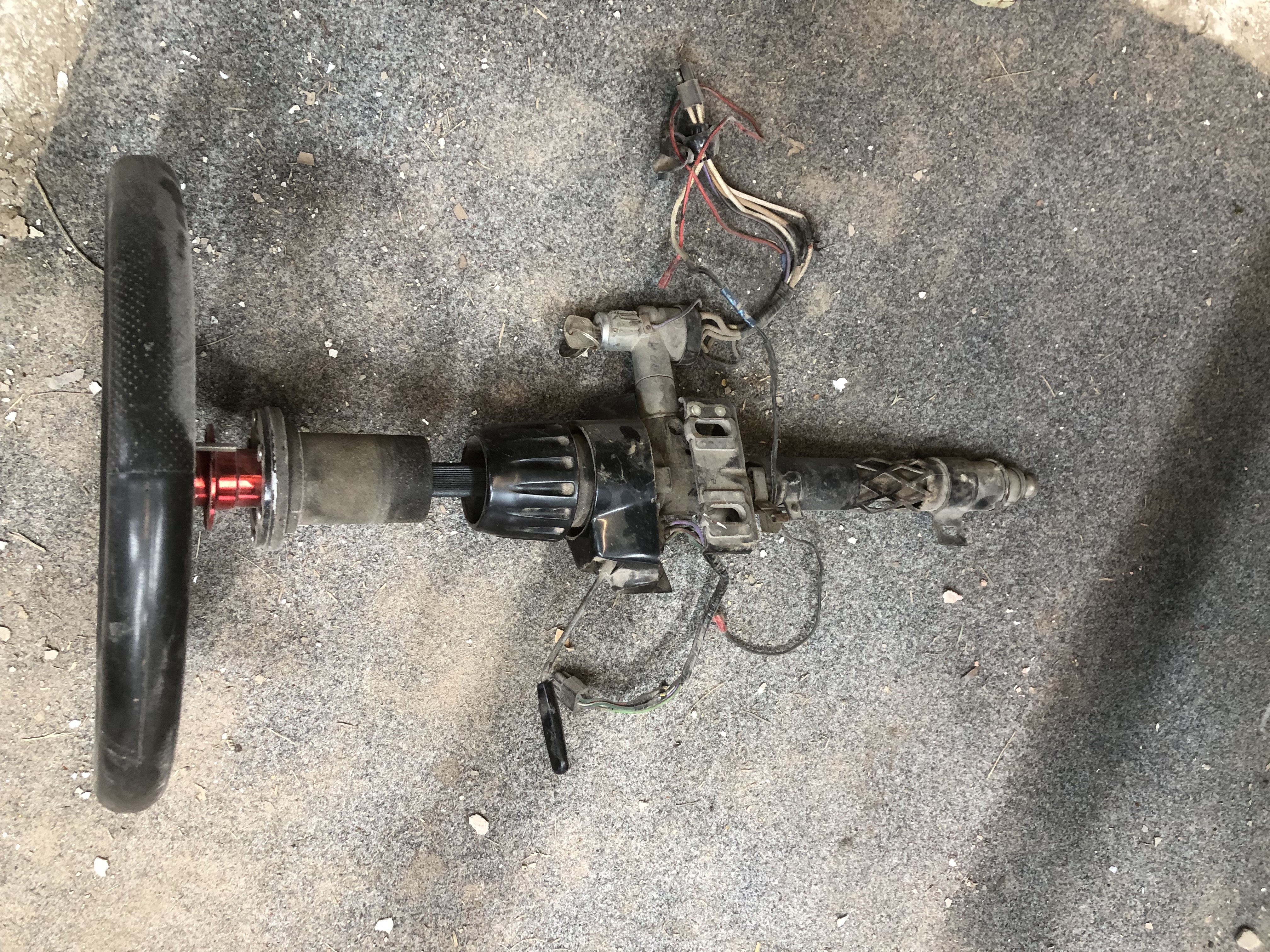

Pictures of it roughly fitted and of my jaguar column I’m using. Ignore the quick release as I no longer need it after discovering the standard mk 2 jag column has factory adjustment for the column length . Quite neat too, undo the large nut and pull or push the wheel to where you want it, then tighten it back up .
It will make it a little easier to get in and out and I can delete a quick release as that’s a headache for registration
That’s brilliant feature to have on such an older car.
I’ve had the column for a few years and only figured that bit out about a month ago. Something I never thought to even look for on it. Even stuffing around with a couple of peoples jags over years I never knew it existed.

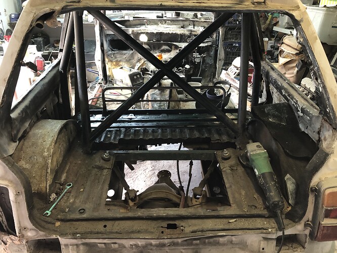

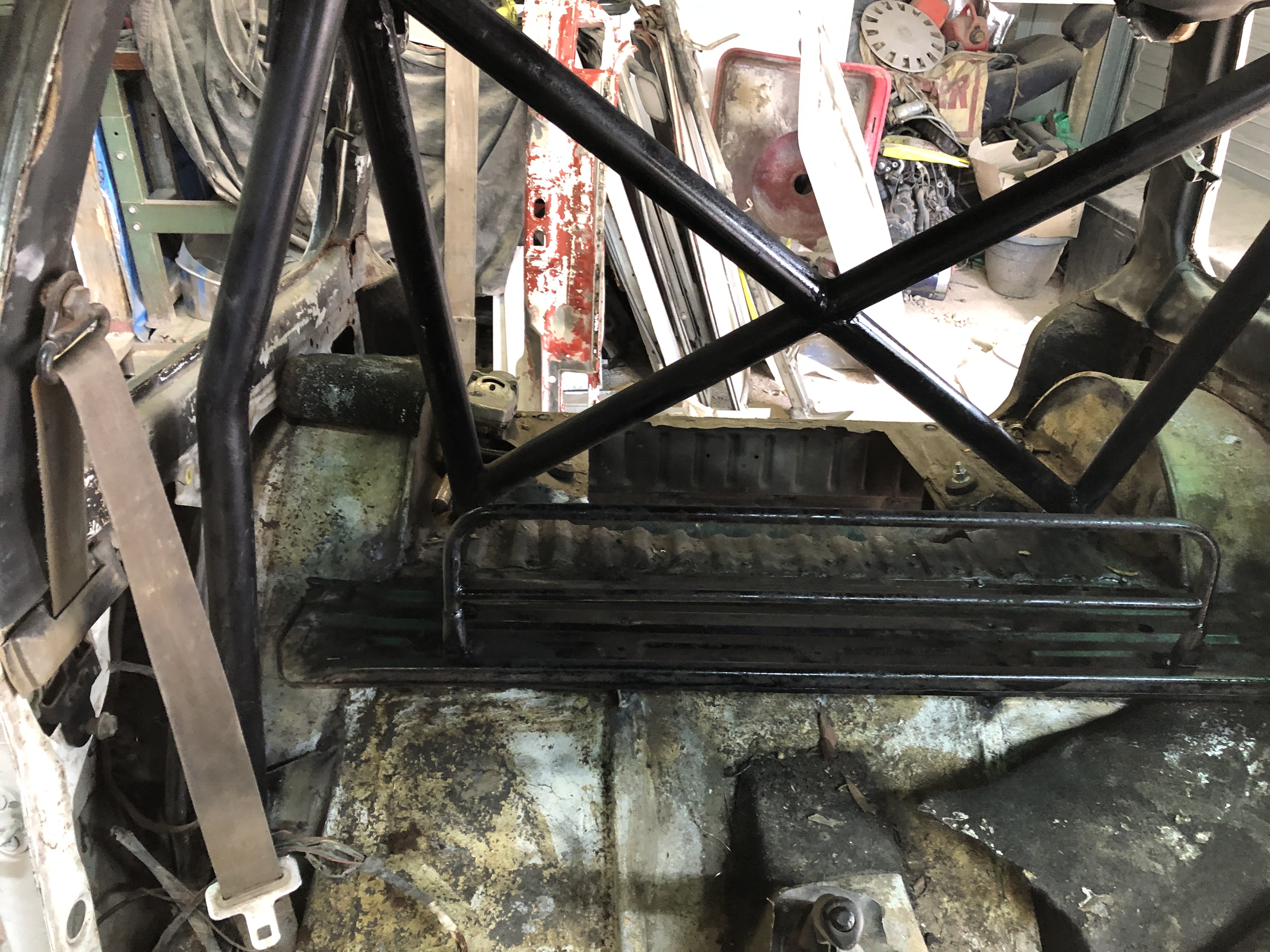

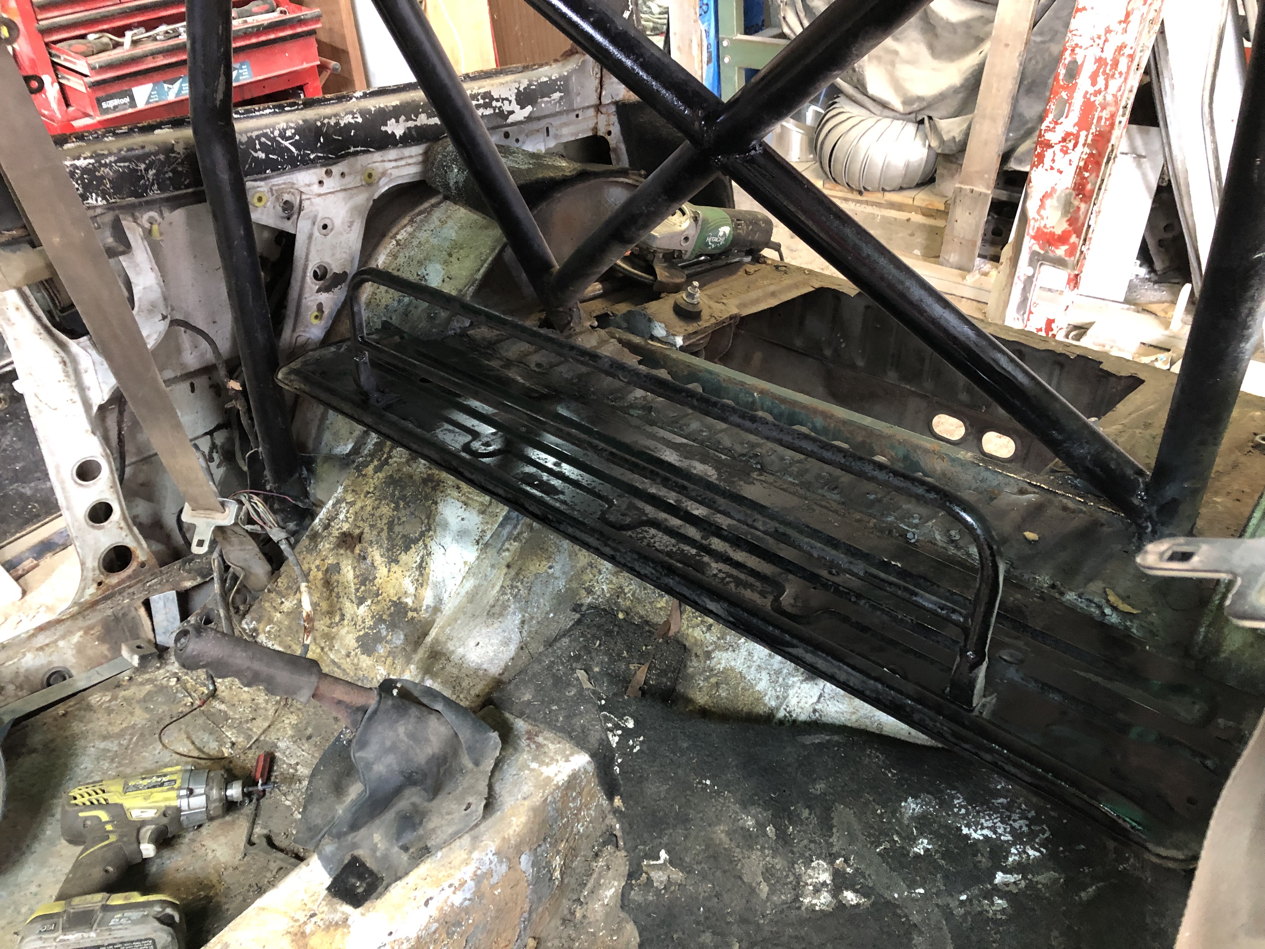

Well I fitted the foldable panel with slight mods to finish my floor and give me the little rack. Not that there’s a lot you can get in back but with a new fuel tank that will sit flush you can get a few bags of shopping in there :grin:
And for anyone taking notice I finally got the last bar of my cage fitted in after over ten years.
And it’s coming up to 15 years since I started this little project.

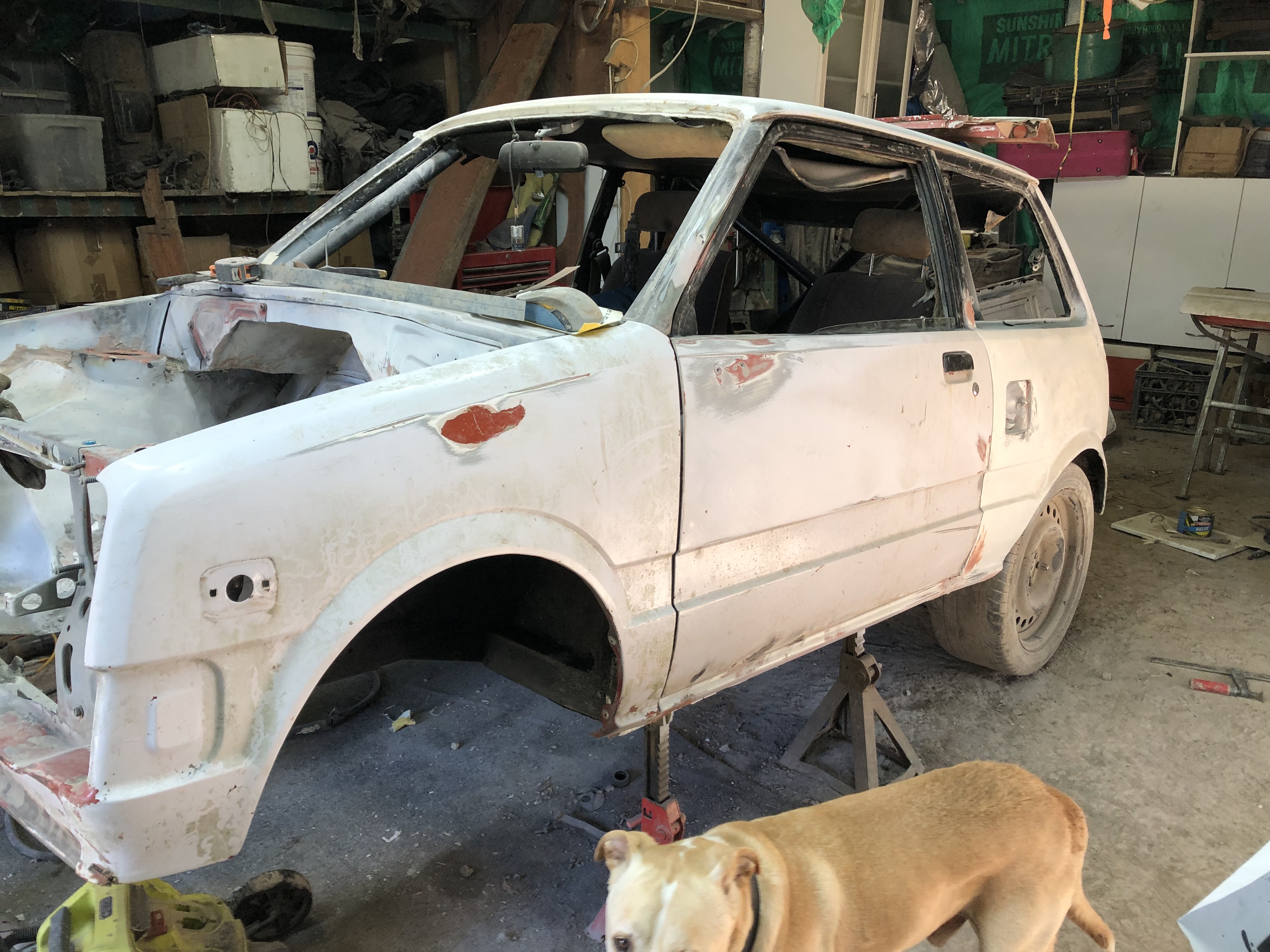

Passenger side of the car is starting to come together for panel fitting and adjustments. Need to do a mount for the bottom guard bolt still.

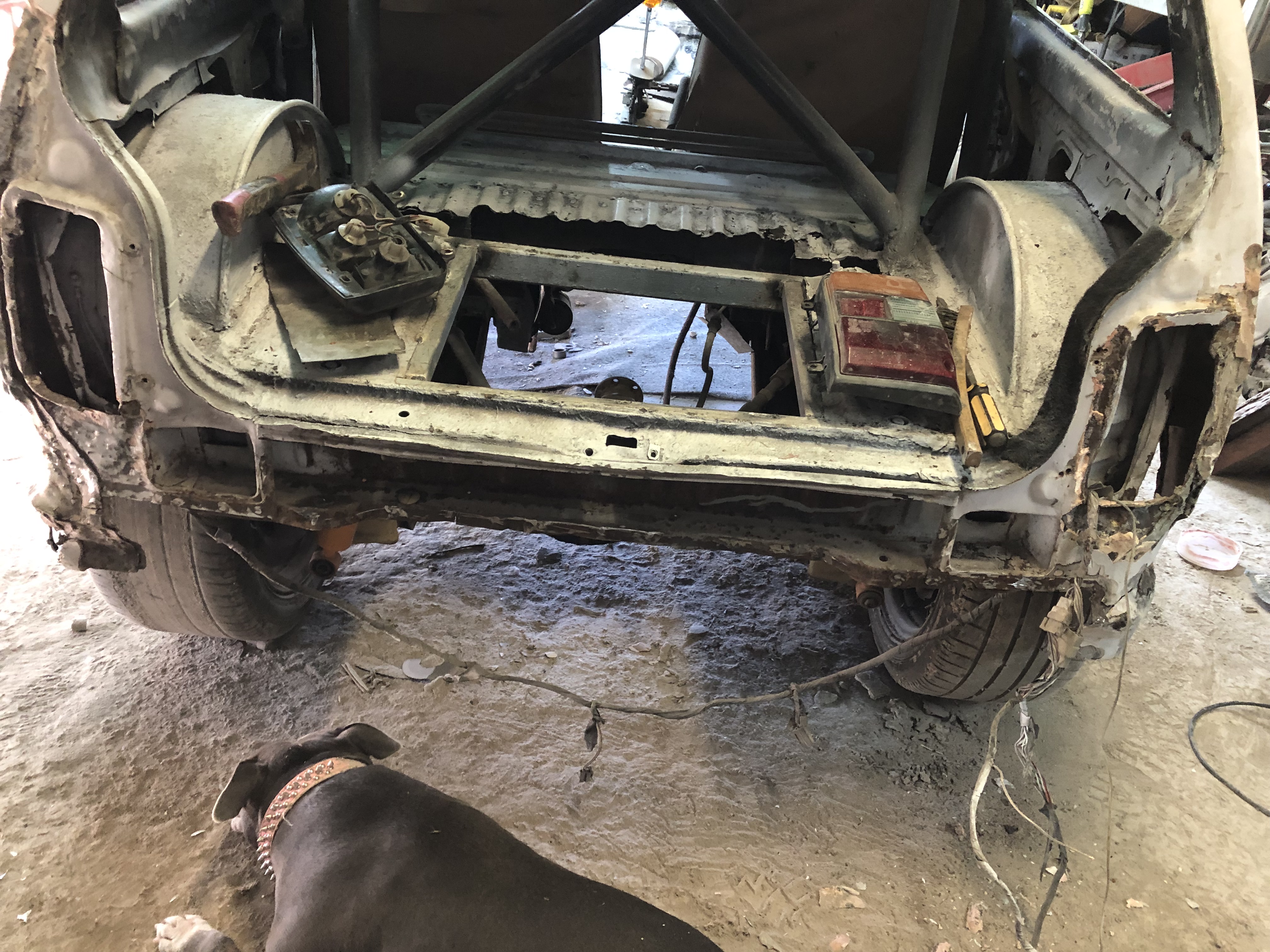

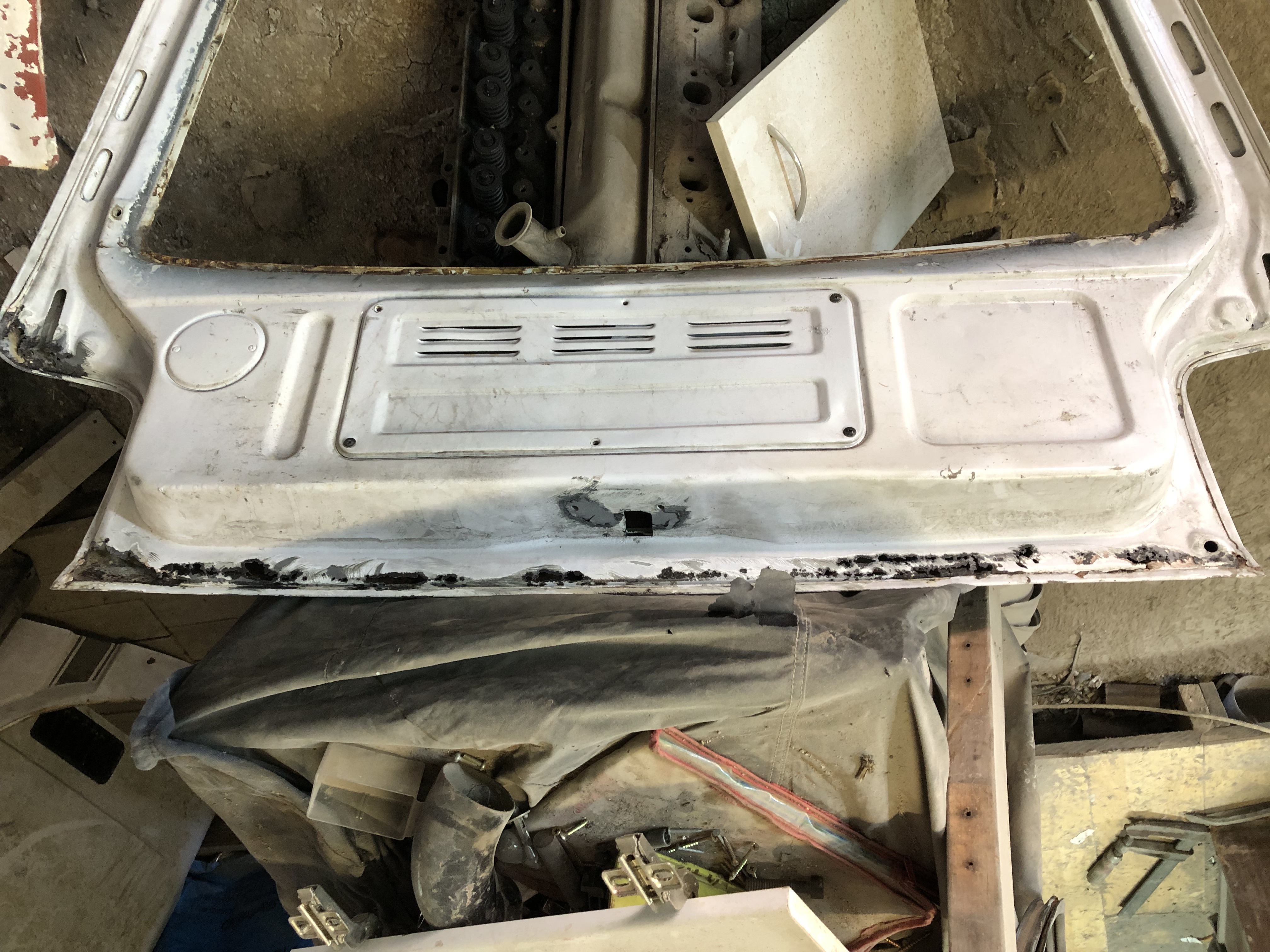

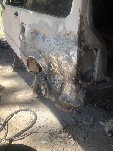

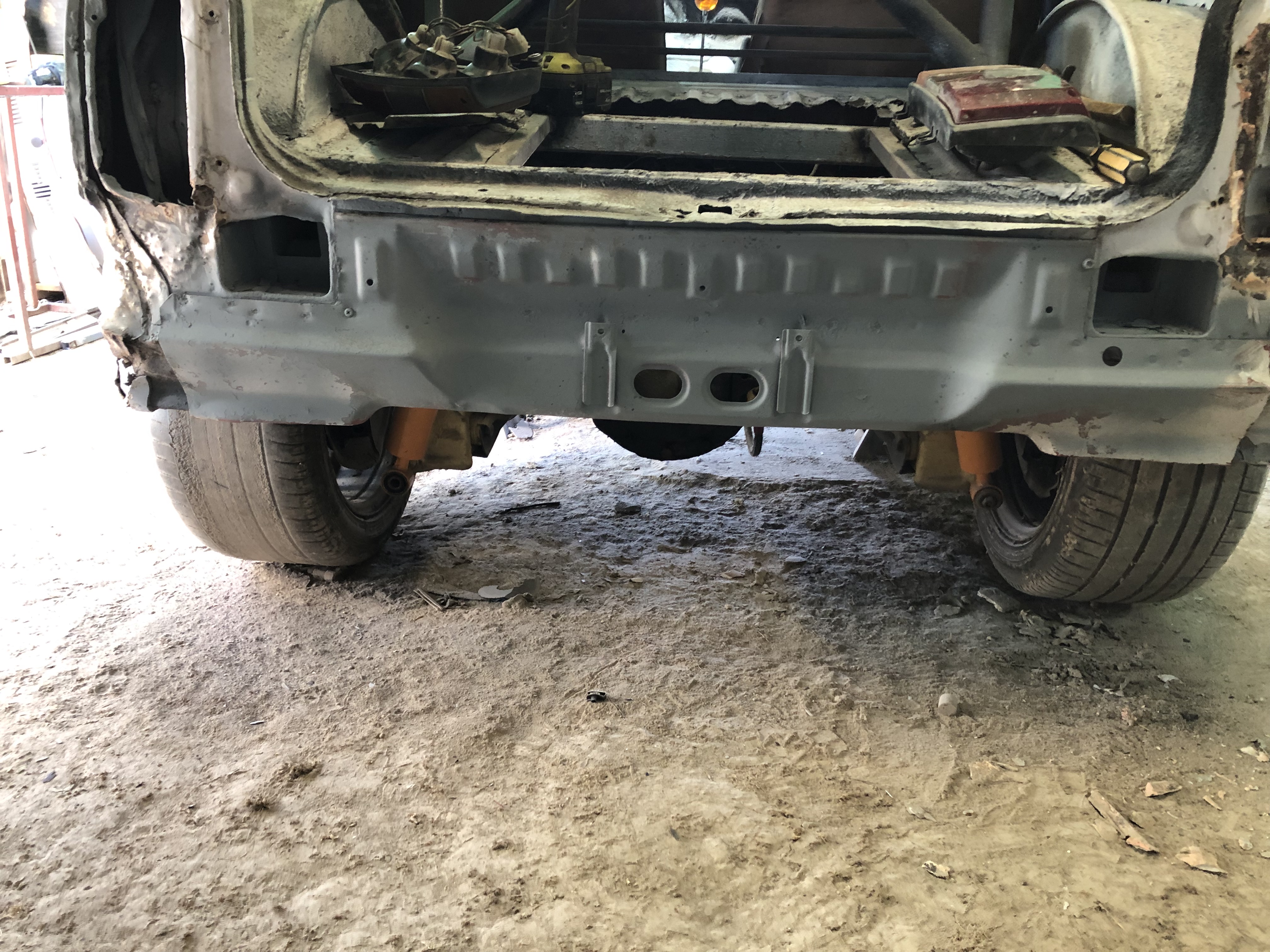

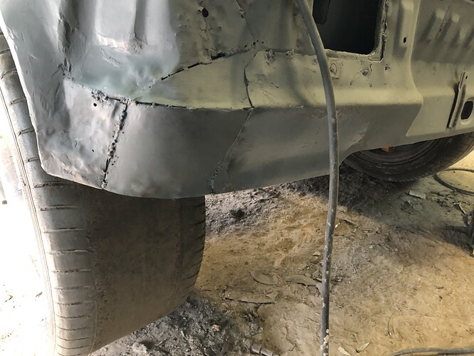

Starting on the rear bodywork. Replacing the rear beaver panel. Second last panel to replace from the original car that burnt. Only the wiper cowl is left. Car of Theseus I guess :grin:
Rear tailgate need some rust repairs and this was the best of two.

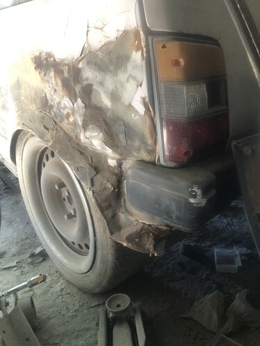

Rear beaver back in place and I’ve worked one corner just starting on the other
I’ve been stripping the panels to see what’s under all the paint and being surprised it’s reasonably good .

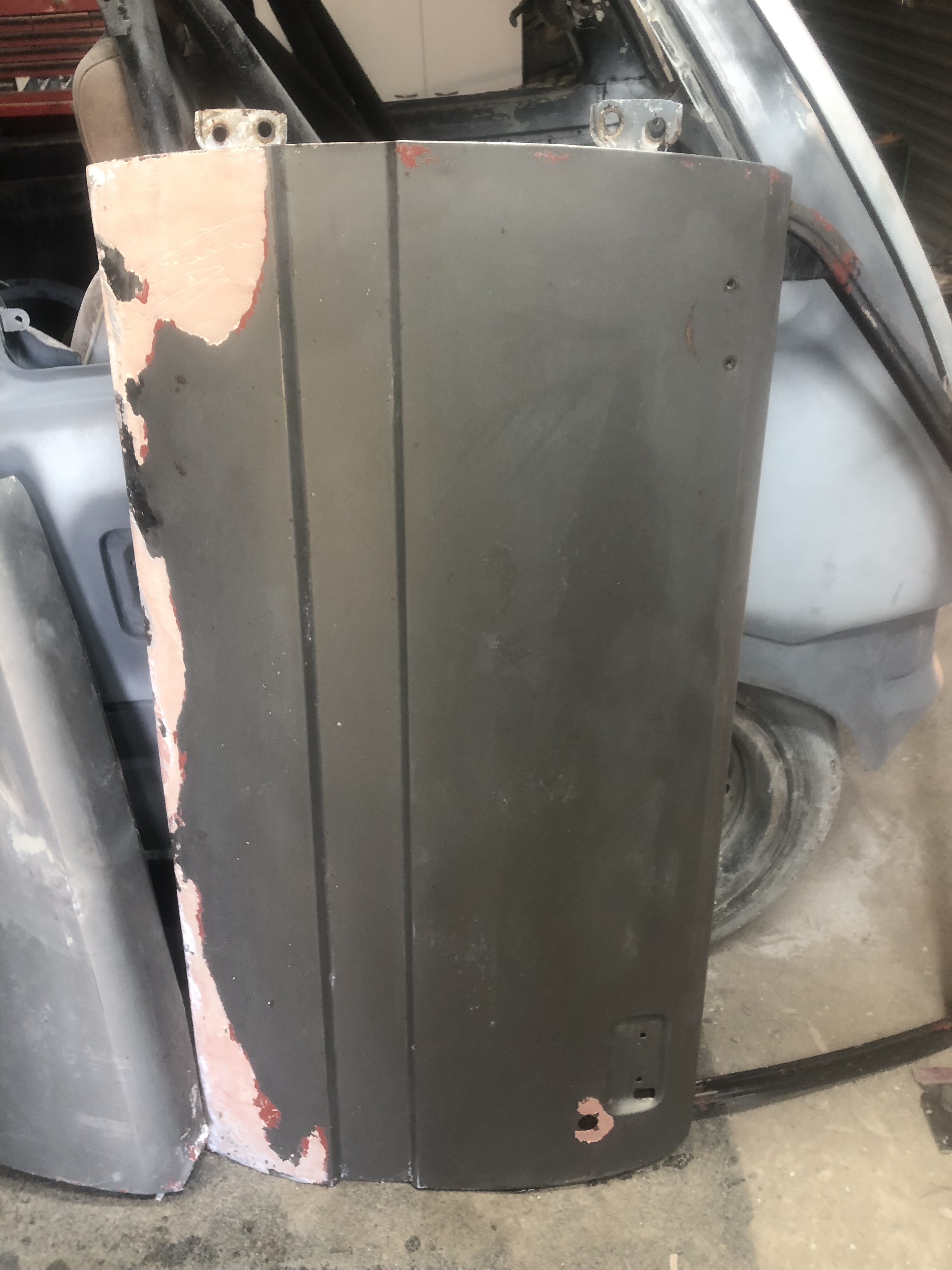

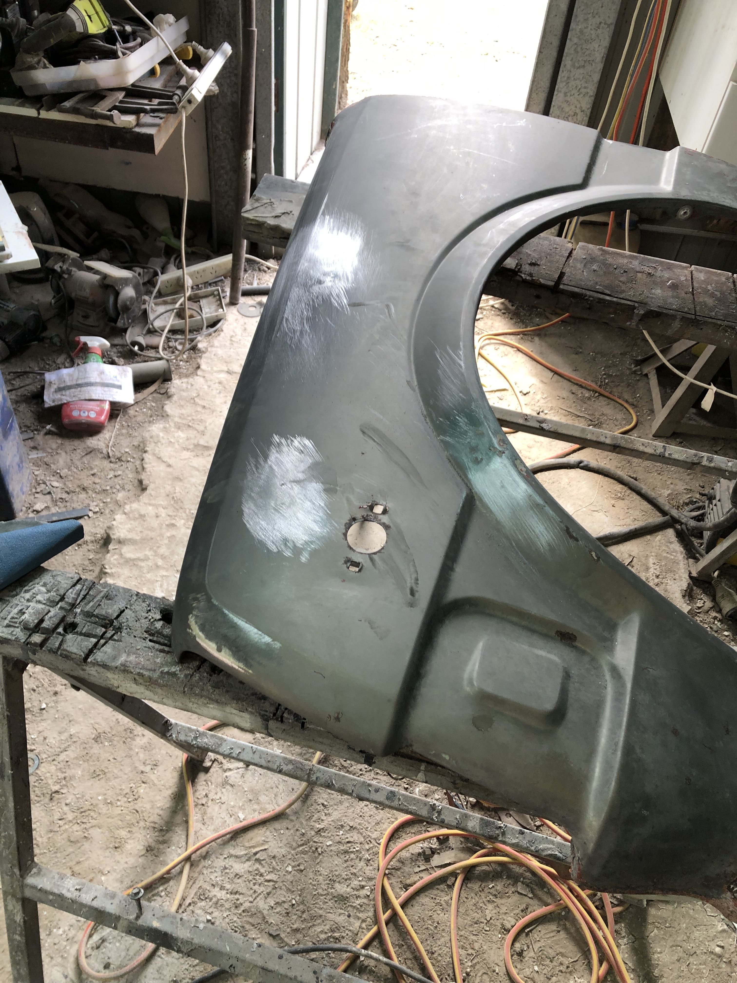

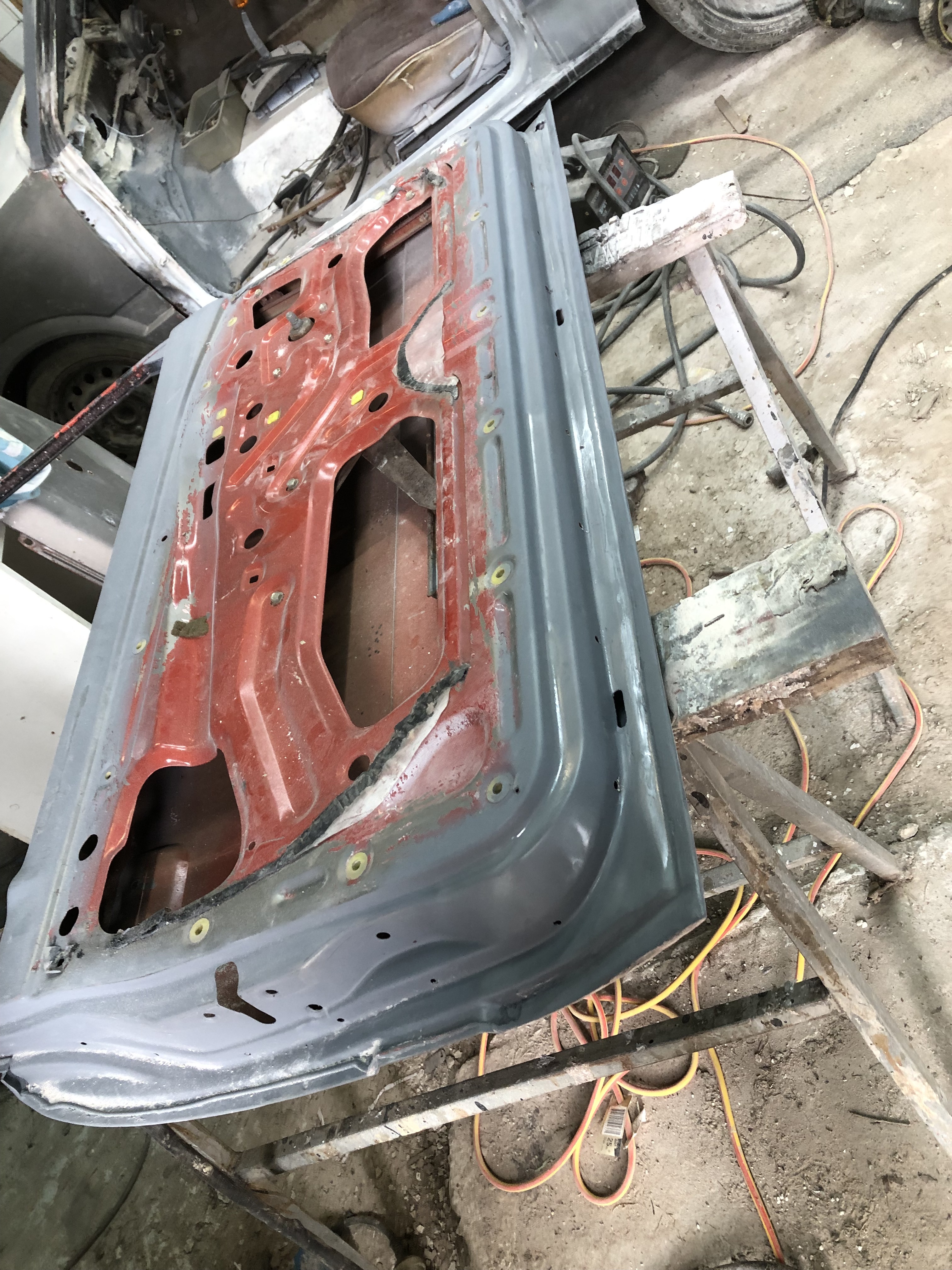

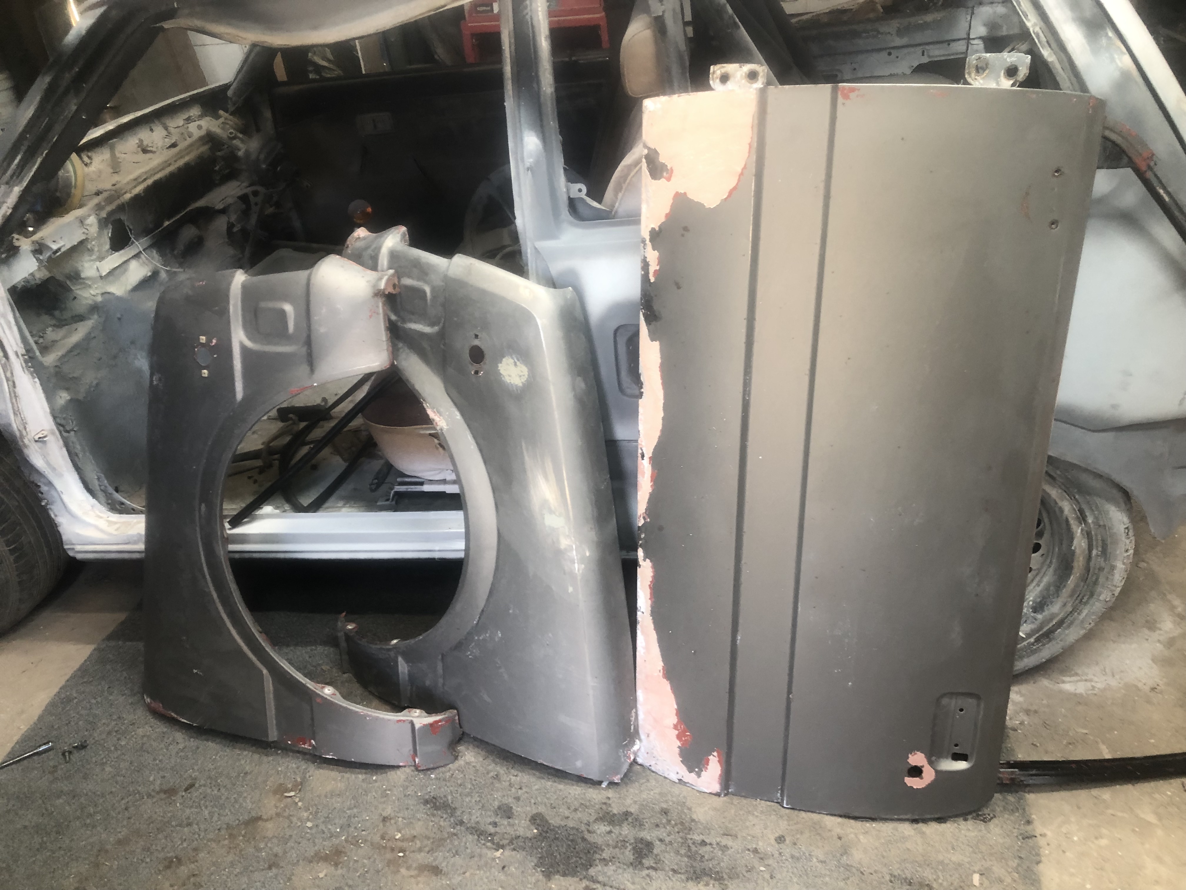

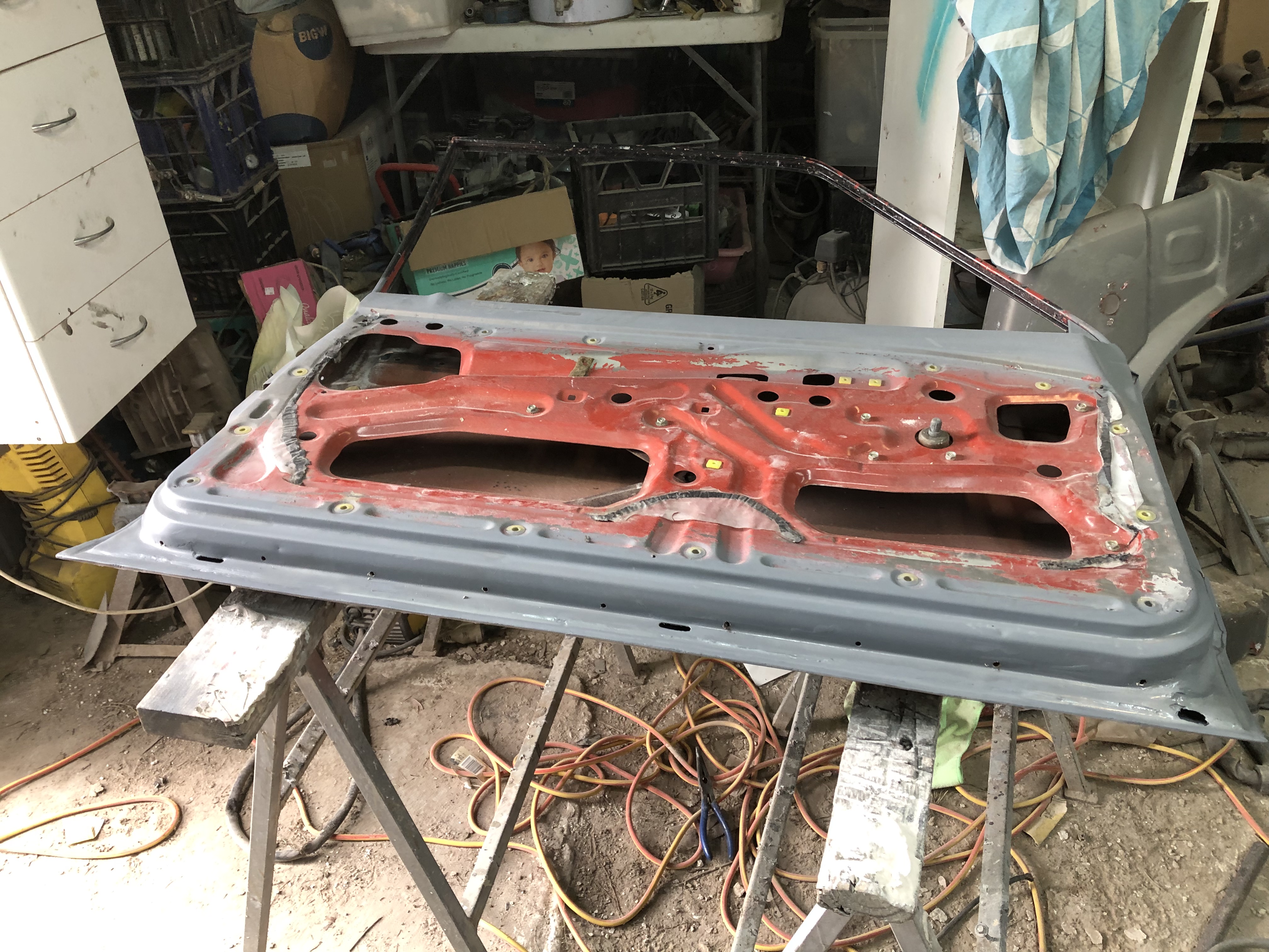

Anyhow repaired the passenger door and done a bit of file finishing in the guard to remove all the little dents

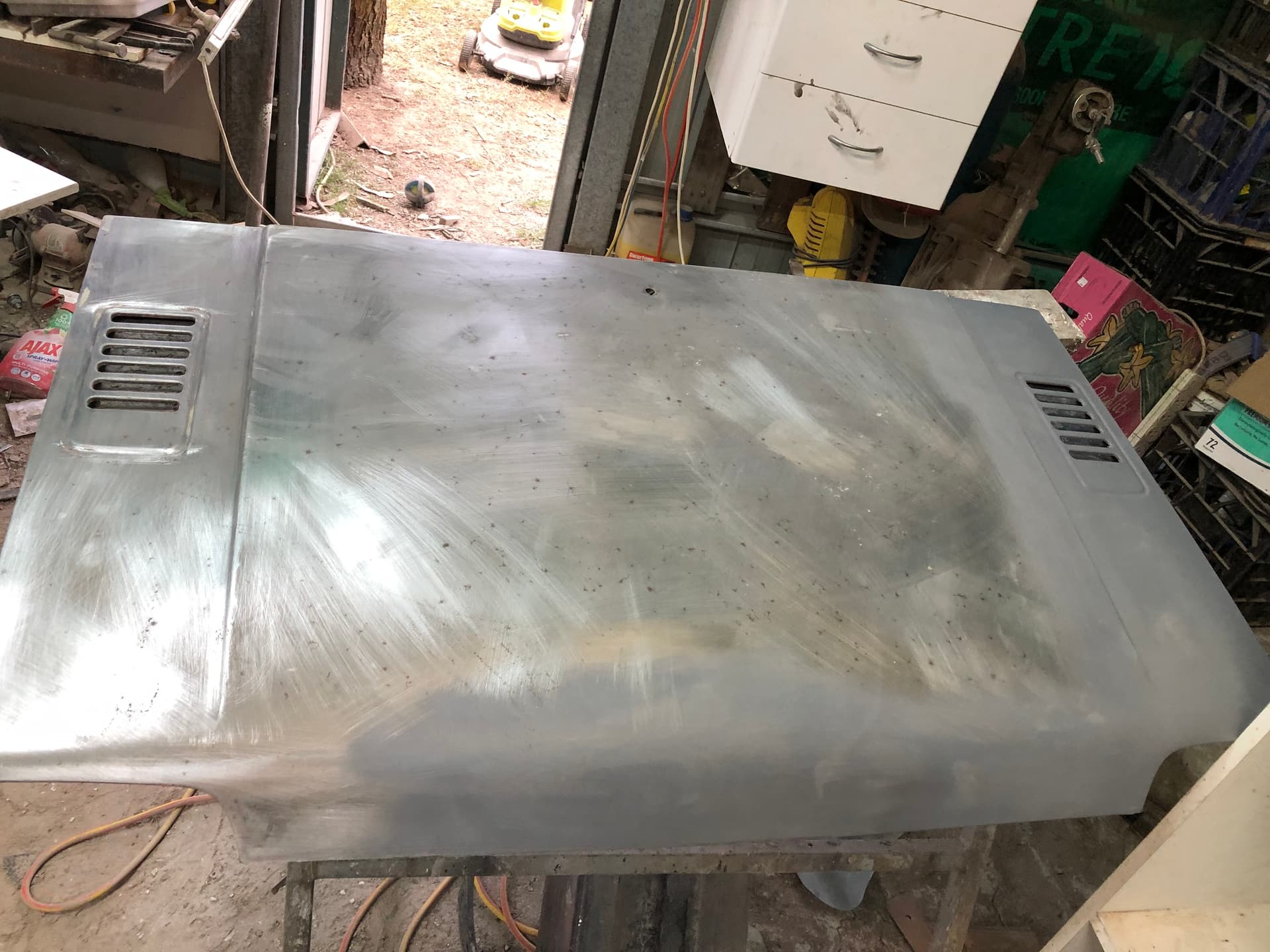

With redoing all the repairs the proper way will probably save me a few kilos in weight too, plus this is the last time Im doing it so I’m taking everything back to metal. I have found it necessary tho as I have found surface rust under the factory paint that has been sealed off but will be an issue further down the line if any moisture gets to it.
Should last a few years, first car I did still had good paint and panel many years after going through a lot of hands

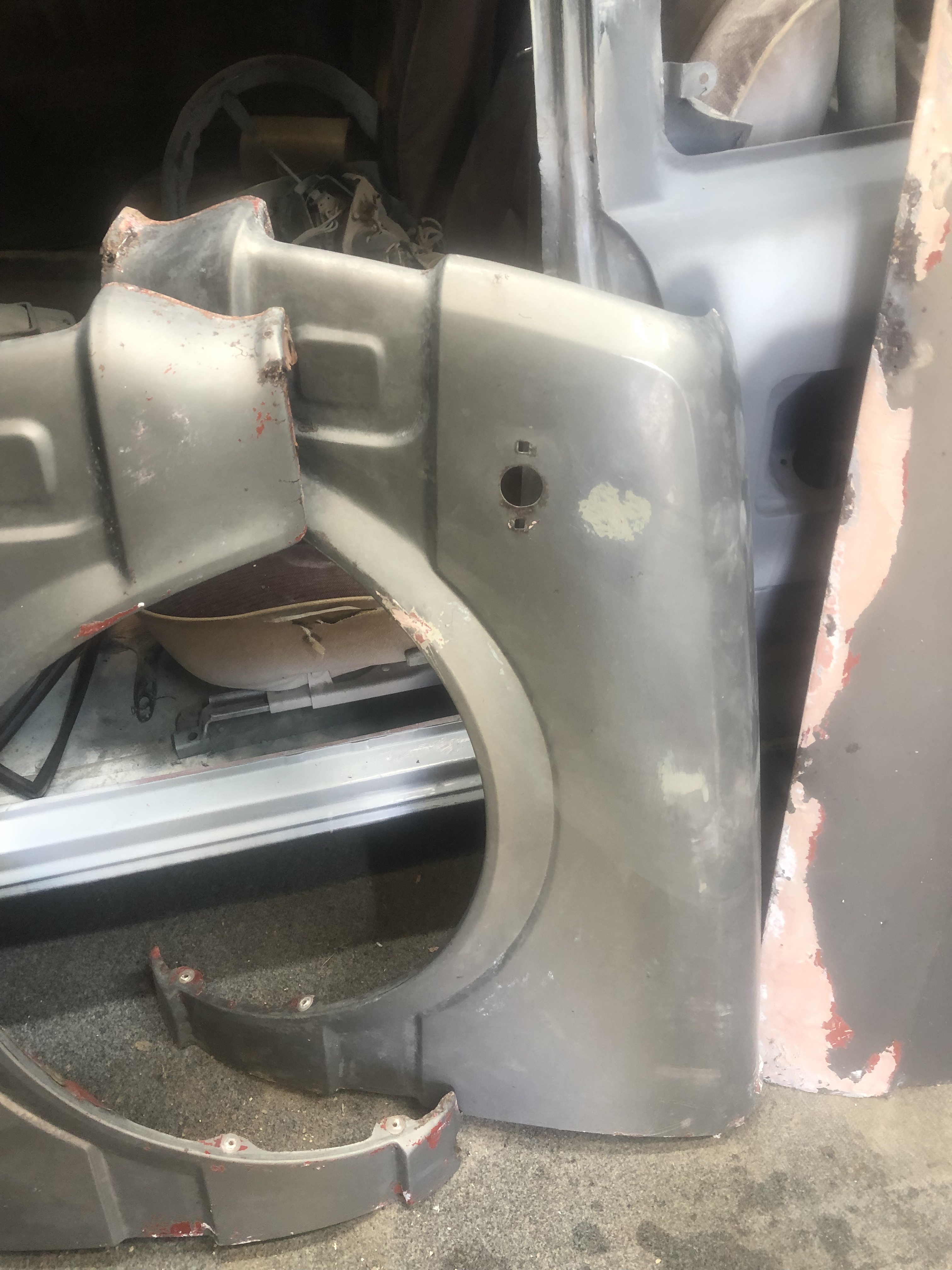

Here is the bonnet after stripping and you will see the brown dots everywhere that are surface rust that wasnt visable in the paint. Looking at when stripping and the age of the car and knowing what happended to rolled steel products back when we exprted them at that time that japanesse manufaturers started stockpilling raw coils out in the open until the needed to use them. A lot of the panels from japan around the late 70’s to late 80’s possibly into the 90’s where stored like this giving them factory rust. They treated it and them primed and painted the panels with no visual affect from it. Having worked on a lot of Jap cars in the late 80’s and 90’s you would notice this.
All in all it had little difference to anyone over the engineered life of the car. Just a pain later on. You get some panels that have holes all through them that have rusted from the reverse and found the easy spots where the surface rust already is and break through there.
