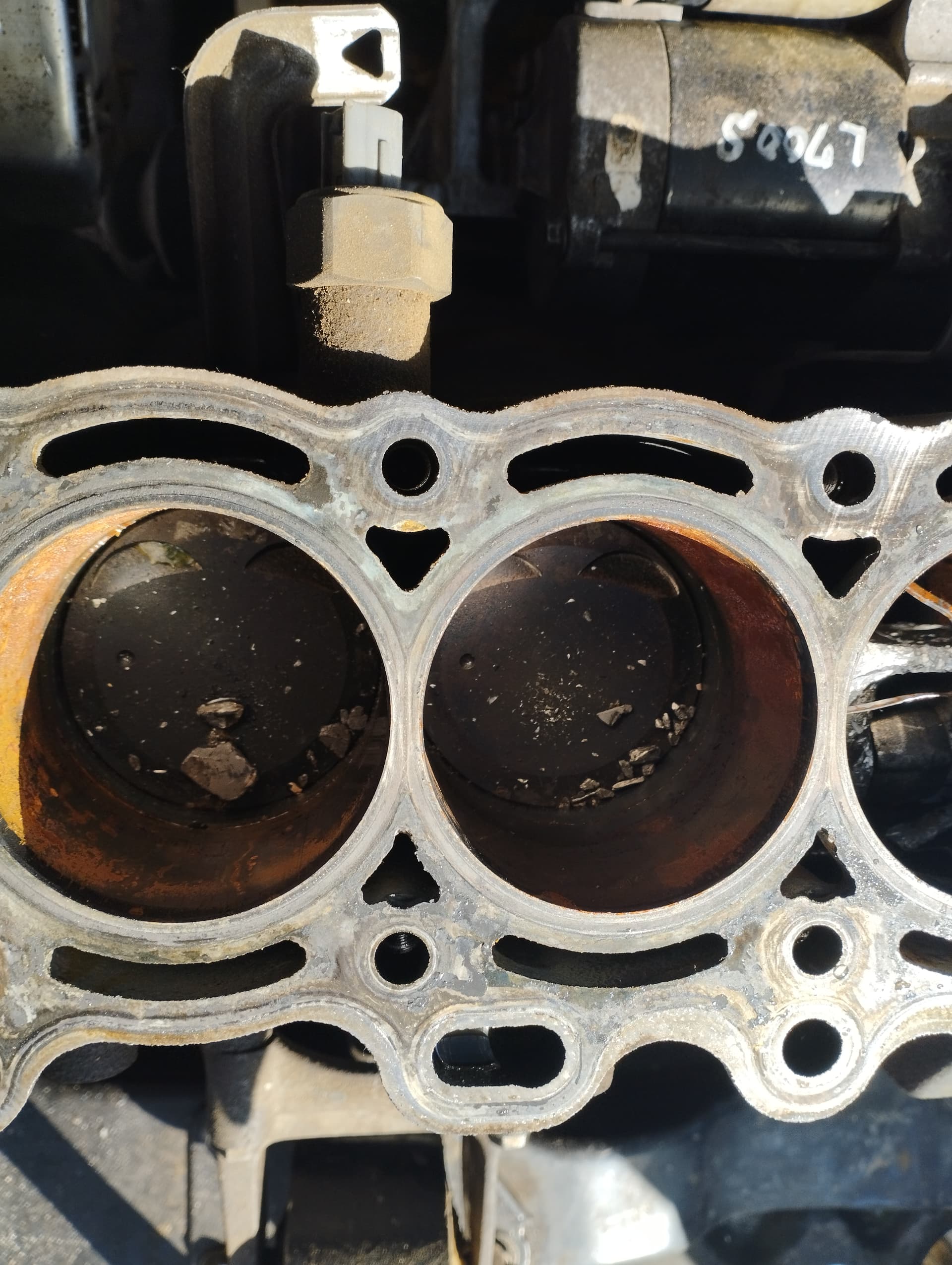

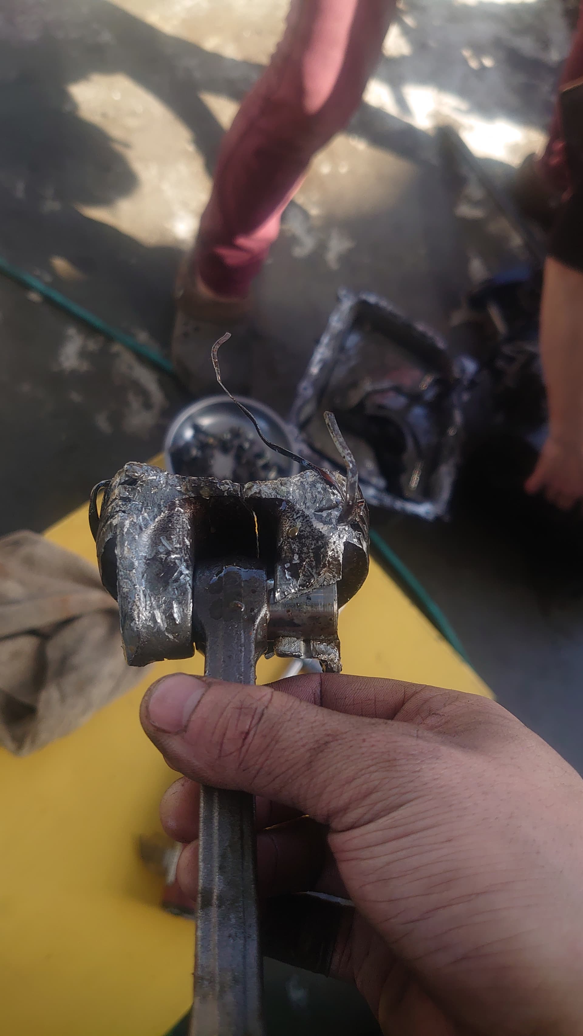

I drive a Toyota Duet (Daihatsu Storia). The engine is a K3-VE2. This engine has blown once. The current engine specifications are a 3SZ-FE engine head, a K3-VE2 intake cam, and a 3SZ-FE exhaust cam. I’m thinking of turbocharging this engine in the future. If you have any advice, please let me know!!
