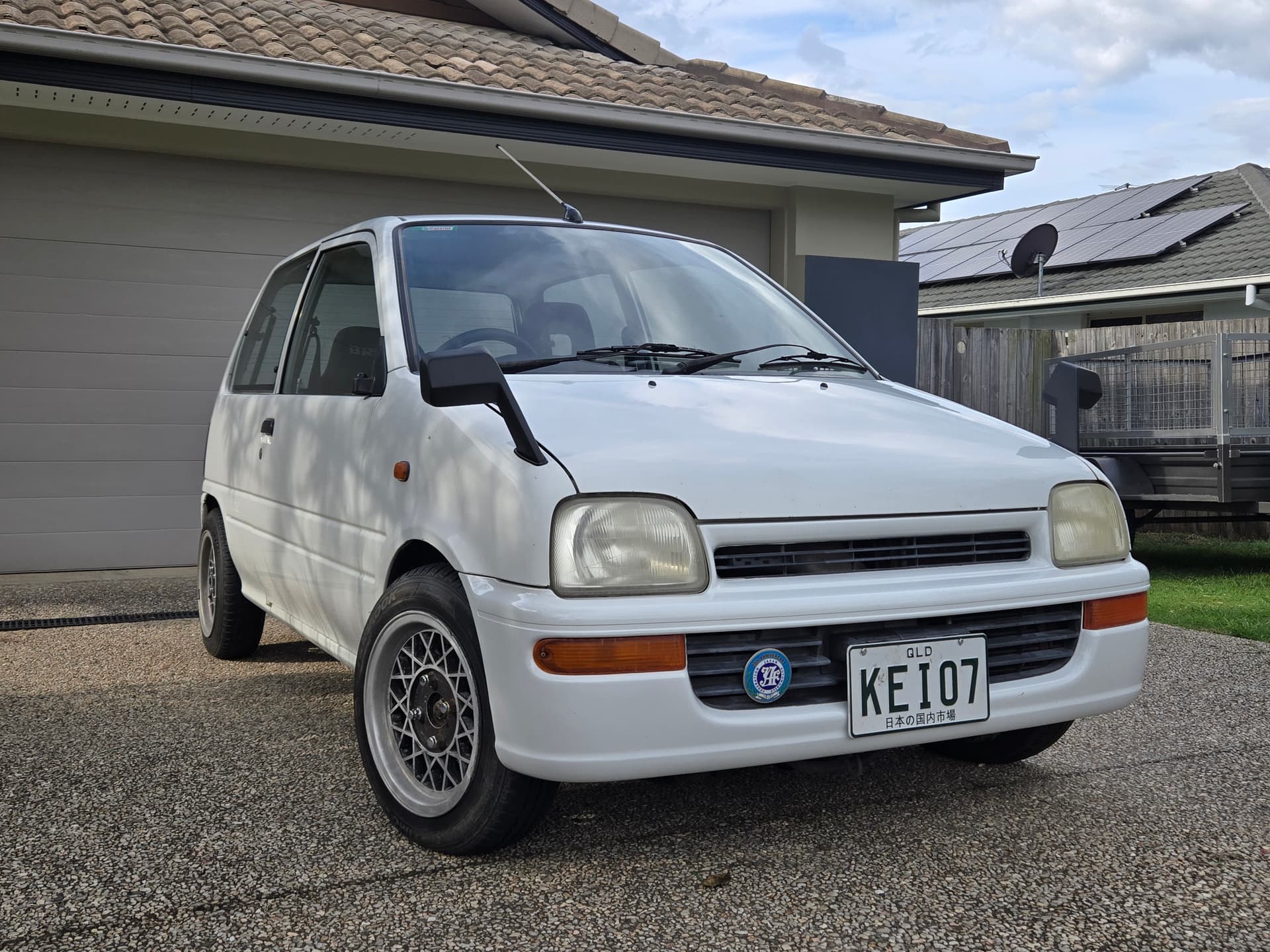

This is my little buzz box. Pretty stoked picking this thing up! Has a bride drivers seat and a crx passenger. Coilovers up front and very RARE choppies in the back!
660cc of pure happiness, also came with a NOT FITTED turbo kit. Keen to build another engine (1 litre??) And make it track worthy!
Welcome. Great L200. Glad you have joined us. When you say “track worthy”, what do you expect? They really aren’t a track car or worth going down that route in serious way. Short comings are four turns lock to lock steering, expect $2000 or more to the steering “quick”, the only Dai gearbox will be from a Sirion and then the ratios aren’t great, will need an LSD (good luck finding one), drive shafts won’t be cheap if you want strong vibration free ones. There are limited decent tire options in a 13", nothing in a 14" and getting a 195 15" to fit takes a lot of fab work. The front end needs proper radius rods and not rely on the sway bar to locate the control arms. If you want to do something within Motorsport Australia stick with motokhanas and khanacross. Outside of this, I am sorry to say, it won’t be competitive and there are better cars with better fun for return on investment. When I got to the point of realising I needed a Sadev gearbox to be competitive and the class I wanted to run in wouldn’t allow a proper radius rod most progress halted. Have a good look through the race car builds here. I’d recommend keeping it as an occasional track day car and briskish road car. Go L700 front control arms with M100 hubs, uprights and brakes. Applause rear disc conversion. Get the sprign rates right, that means front at std and rears 400-500lb/inch. An NA ejde with a light EF-EL flywheel and a gearbox from a an M100 or L700 and get an lsd. Stick with a Nangkang AR-1 185/60/13 and make the car work around them, they’ll be great for everything but wet days when they won’t get any heat into them.
