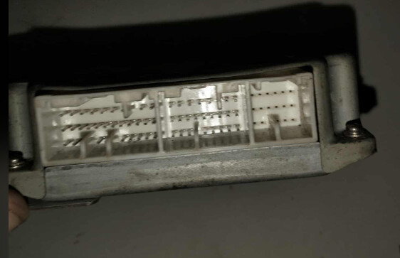

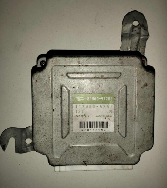

Here is the pictures of the L7 ecu that I said I would take.
The plugs are the same as the black ecu’s but there plug hole on the right has no pins.

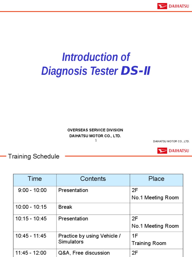

It was the scan too, you had to find either the Denso DS21 or Denso DS-II. Then you could reset the rolling code to program a new key to the immobiliser and ecu.
and if anyone happens to find one here is a manual for the ds 11
