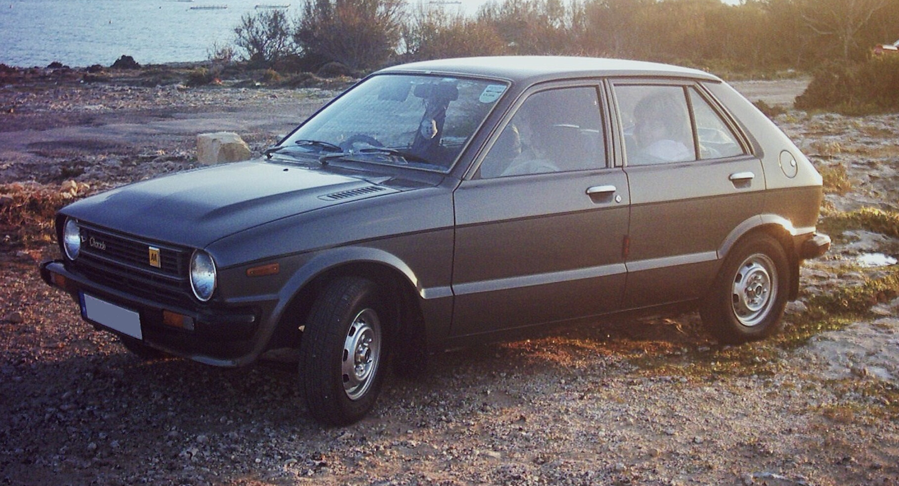

Hello everyone. We’ve owned a 1980 Charade G10 for the past 40 years (my father owned it even before I was born). The car is now in pension and only used for an occasional joy ride every now and then.
A big challenge I’m facing is to find parts to keep the Charade going. The car has drum brakes all round, and finding parts for the front brakes is a nightmare as in most countries the front brakes are disc brakes.
I am currently on the lookout for the parts needed to convert my Charade to have front disc brakes namely the front knuckles, hubs, disc brake and calliper. If anyone happens to have the parts or can guide me to somewhere from where I can source them, ideally in Europe, I’d really appreciate the help.

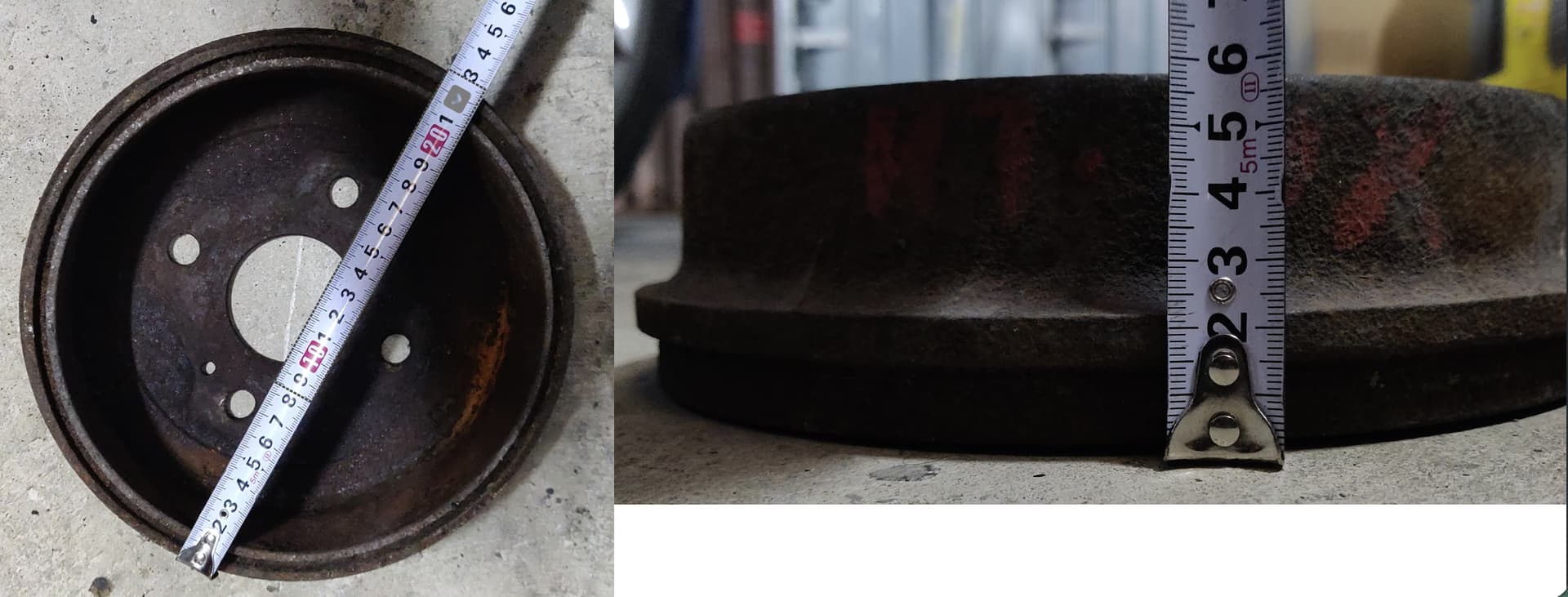

The problem I have at the front is that the drum brake have warped and they don’t have enough material to engineer them round again. I’ve been trying to look for new ones for years but couldn’t find any.

Thanks for your time in looking into this! I came across this while doing my research but I’m doubtful how compatible they really are with the Charade’s break as the measurements seem to be off from what I have.
Looking at the measurements of the Hyundai drum, the overall height of the drum is 72mm and the outer diameter is 216mm. The PCD for the Hyundai is 114.3mm.On the Charade, the overall height of the drum is a shy more than 55mm while the total diameter is around 230mm. PCD for the Charade is 110mm
The inner dimensions is what counts
