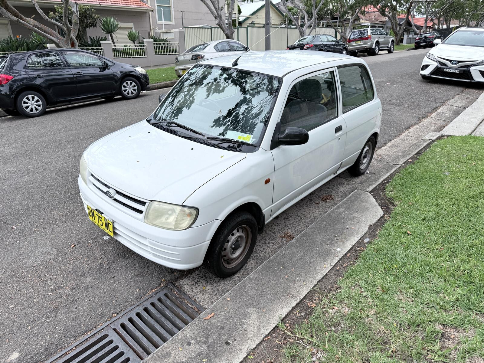

Just introducing myself to you all and my (new to me) 1999 Handi L700. I love how raw this thing is and I plan to do a lot of modifications over the years to it. For now I just wanted to say hi and introduce the car.

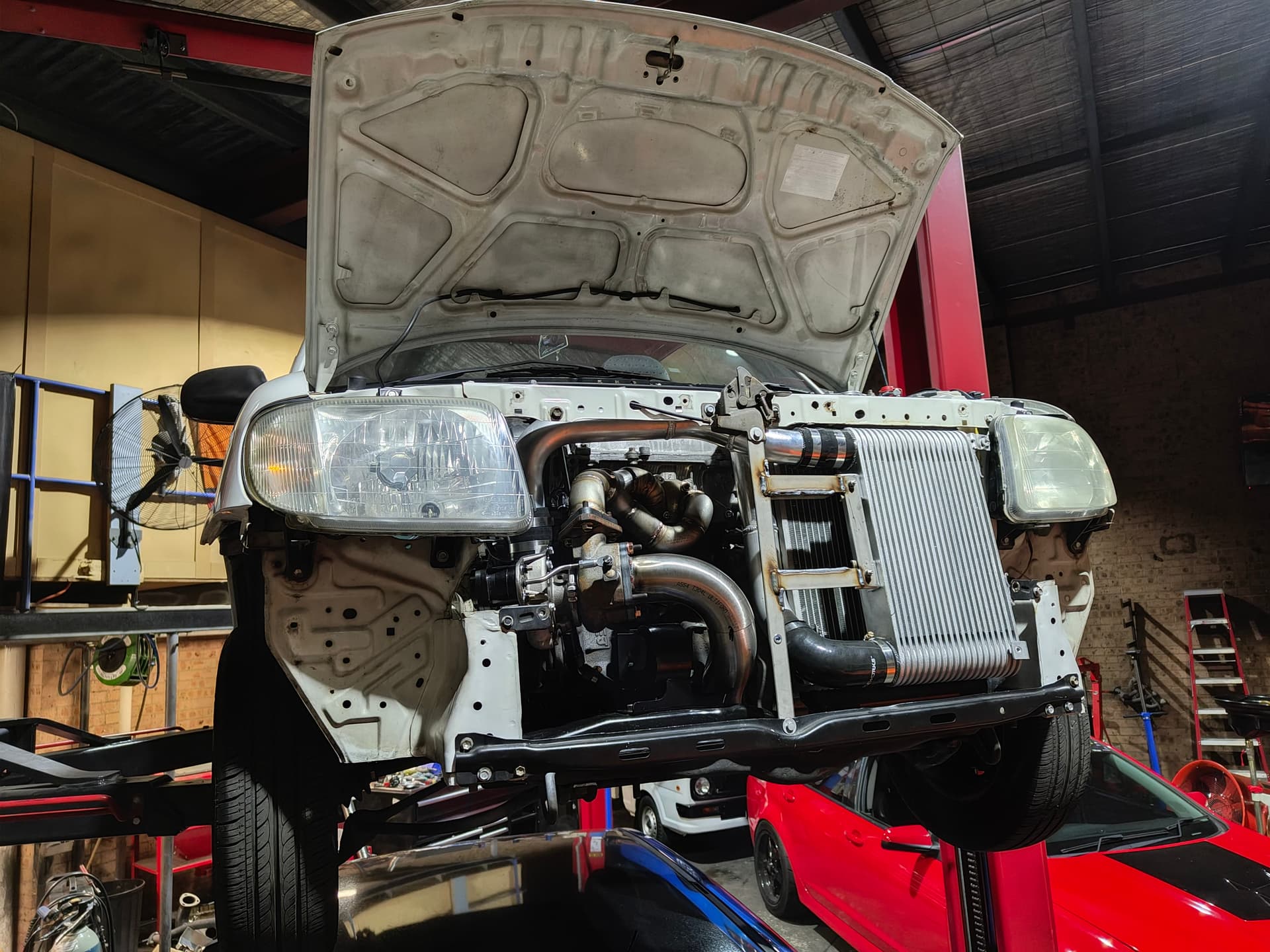

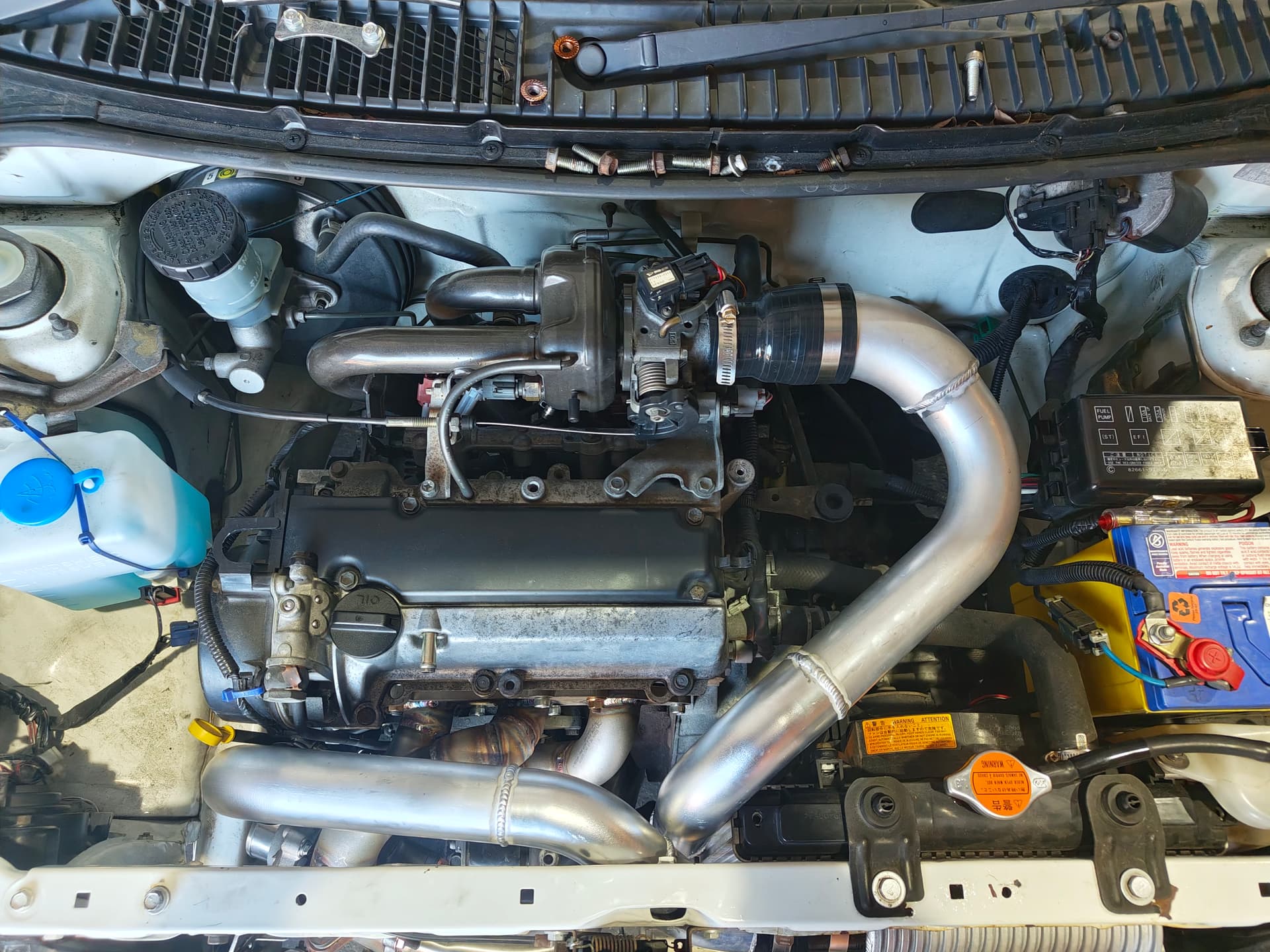

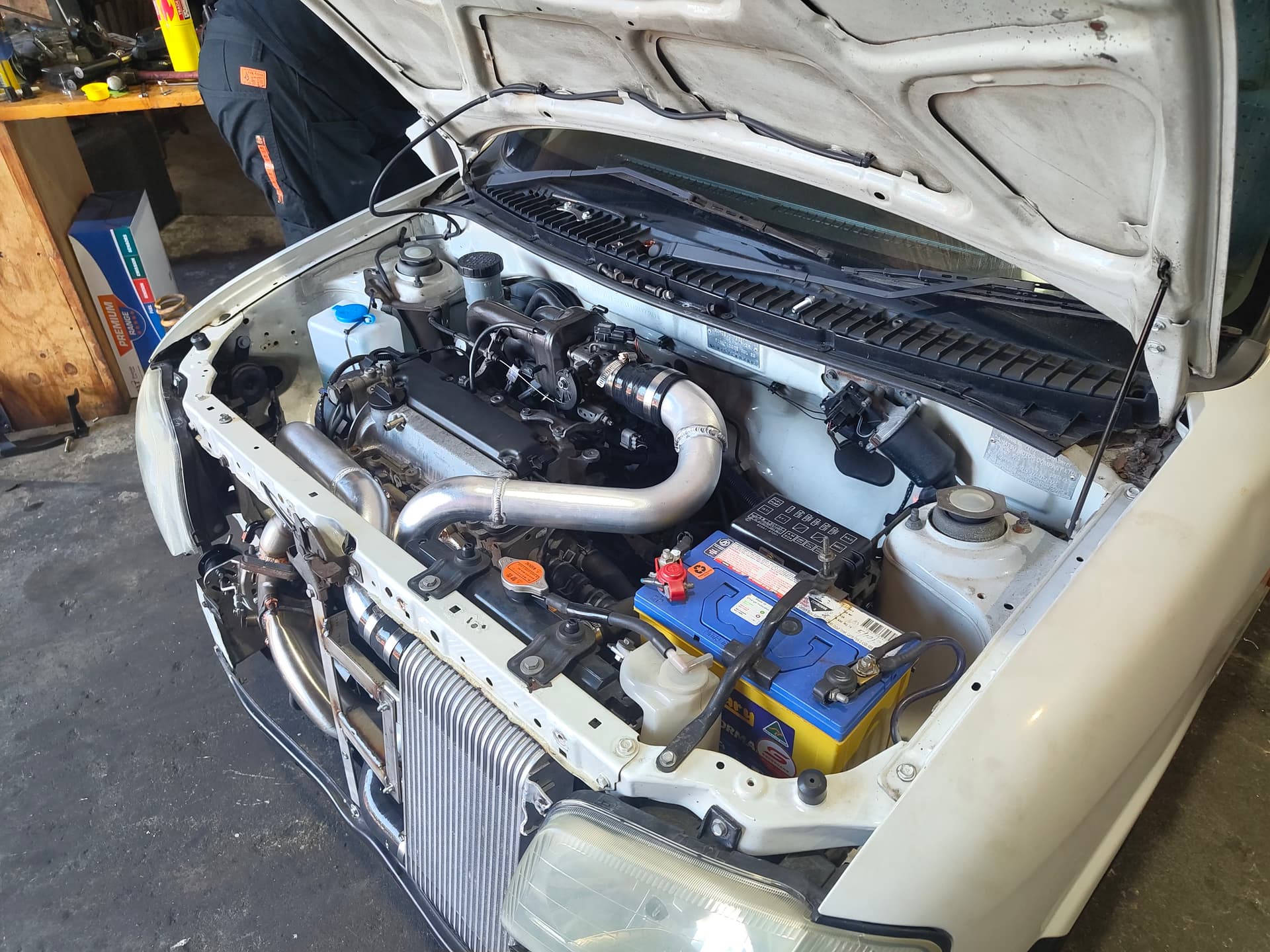

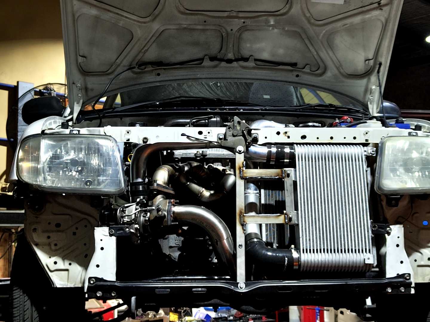

he turbo setup is now well underway at Macarthur Motorsport. Custom manifold and dump pipe are done, intercooler is mounted, piping has been fabricated, and the front end is starting to come together.
Seeing the turbo hanging out the front of something that weighs next to nothing is pretty wild. The workmanship has been excellent so far and I’m really happy with how the fabrication is turning out.

that setup looks good
What ecu are you going to run in it?
Hey mate, ECU will be a Haltech Elite 550 :blush:
