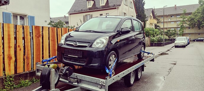

Hi, I recently bought a L276 from Germany and imported myself. Want to know parts that are interchangable with other dai/toyota products. Its a 1.0 complete version missing its oem wheels
