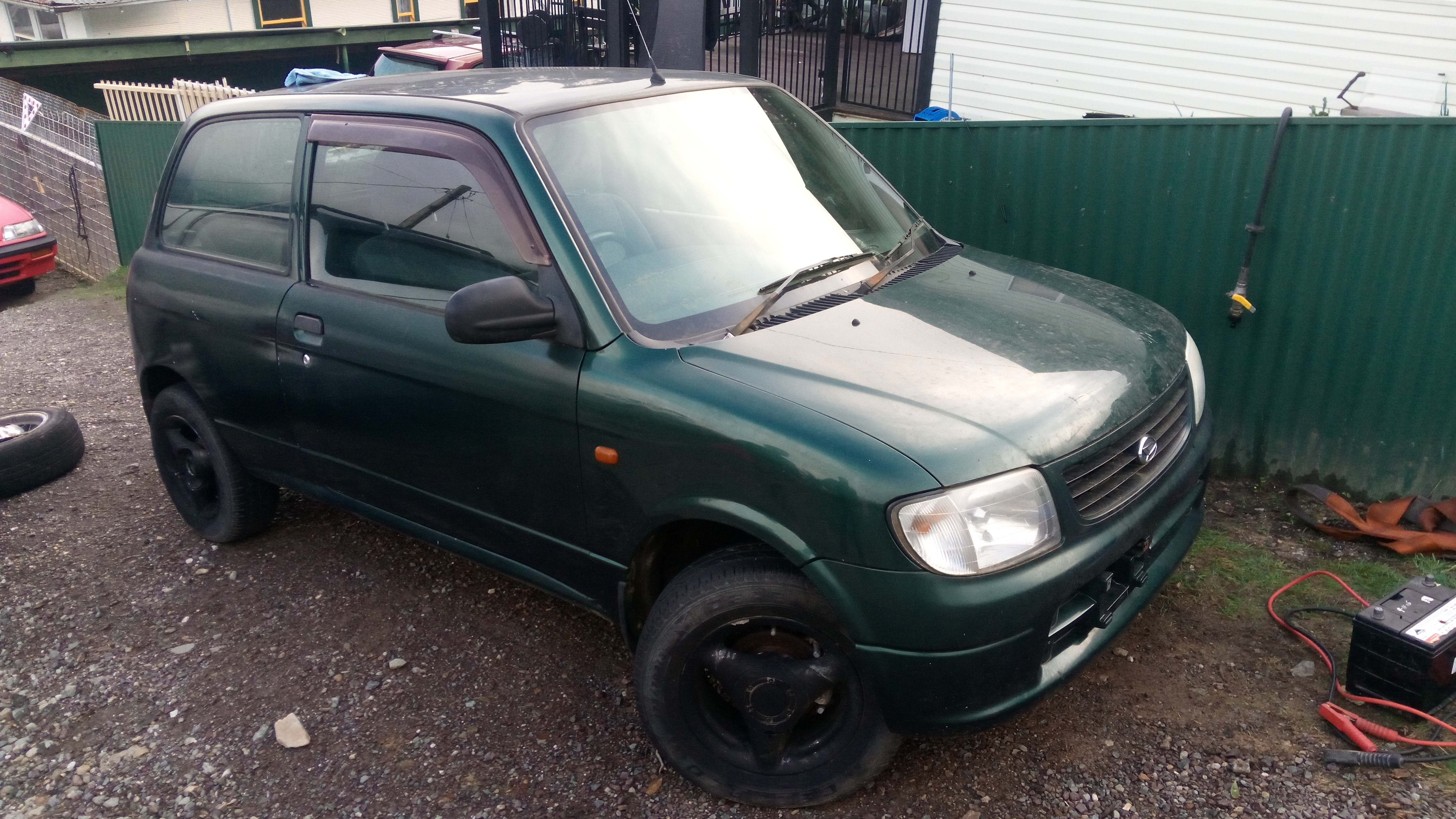

I just bought a 2001 Daihatsu Cuore last week and it was a non runner was told needs a new head gasket. I have always liked these little cars i even test drove one new at the Daihatsu dealer all those years ago. my last Daihatsu was a G11R turbo Charade about 12 years ago. Anyway a big hello to all from me.
Picture of said car from the place i got it from.
