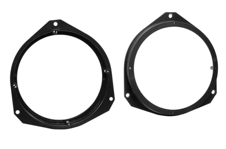

Okay thank you. So i should look for something like this to make sure the speakers fit the pre-drilled holes in the door correct? Theyre kinda hard to find for 5.25 inch so far, you reckon i could make them work without rings?
So this is the issue I ran into, and abandoned the project in the end!
You could make your own out of MDF, or probably have some made up by a 3d printing firm if you provided them with dimensions or mock up a file for it? Actually, this might be a great real-world use case for AI if you ask it to make you a .stl file for a 5.25" speaker adapter to fit a 3-screw design at 120 degree spacing and a 4-screw design at 90 degree spacing.
I reused the old rings on the oem speakers by pulling them apart and reused them as speaker bracket
