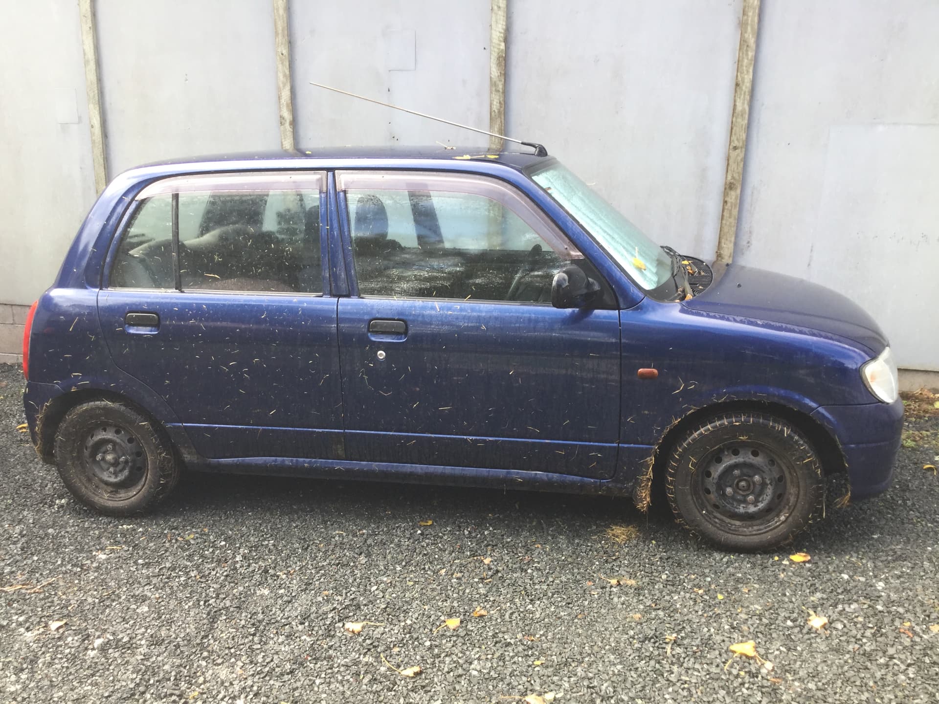

I bought my Mira in January 2020 for $500, my first car.
Picture below is how it currently looks. (End 2025)
January 2020: Starting things off, this is how the mira looked the day I got it.

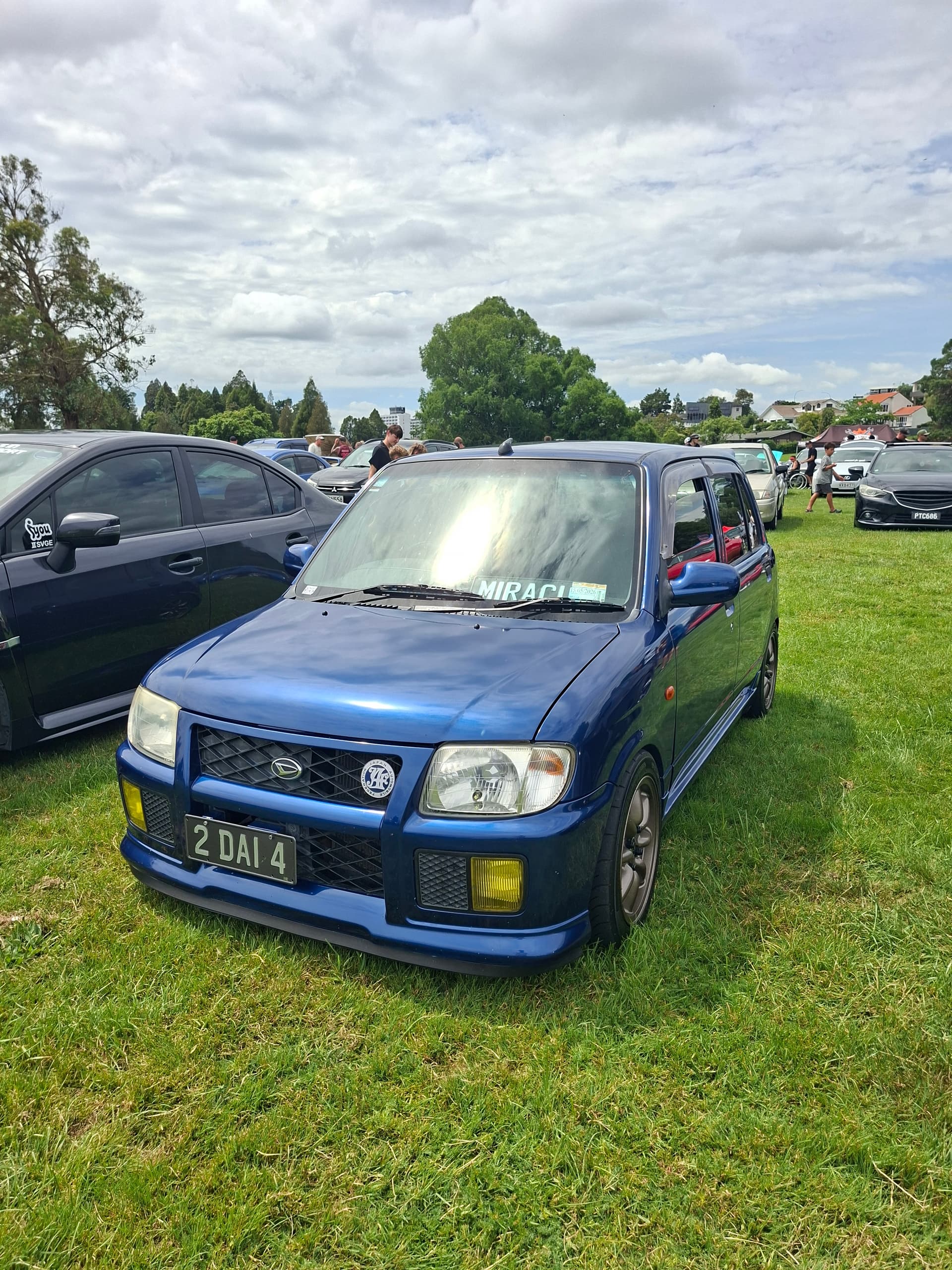

October 2023: Update on my mira - not much had changed until the past couple months, been wanting something to make it more interesting and recently got the opportunity to purchase a tr bumper and a spoiler, so happy with how it looks
Also the move struts started leaking causing it to fail a warrant, spent a long time trying to find some more but couldn’t. So instead managed to find some lowering springs from Malaysia to use with the standard struts. These give the car a 40mm drop from factory height or 10mm lower than it was before with the old setup.
The interior has also had a few small improvements - sirion steering wheel, sirion handbrake cover and a new suede shift boot fitted into a sirion shift boot surround. And later on also bought some chrome sirion interior door handles

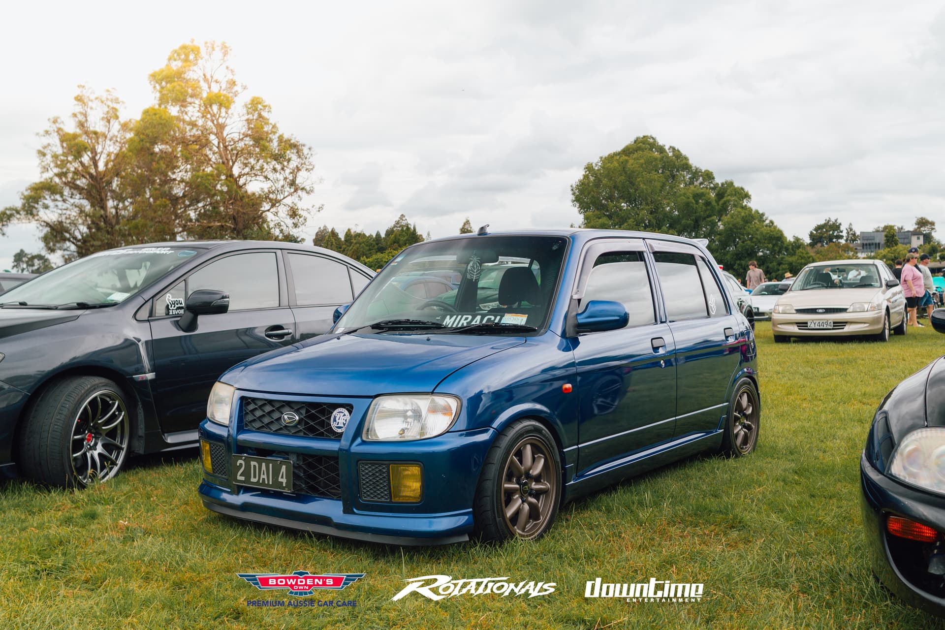

January 2024: Picked up another set of these Black Racing Watanabes, much tidier than the other ones I had on. Good opportunity for a nice paint job in bronze. Specs on these is 14x6 +40.

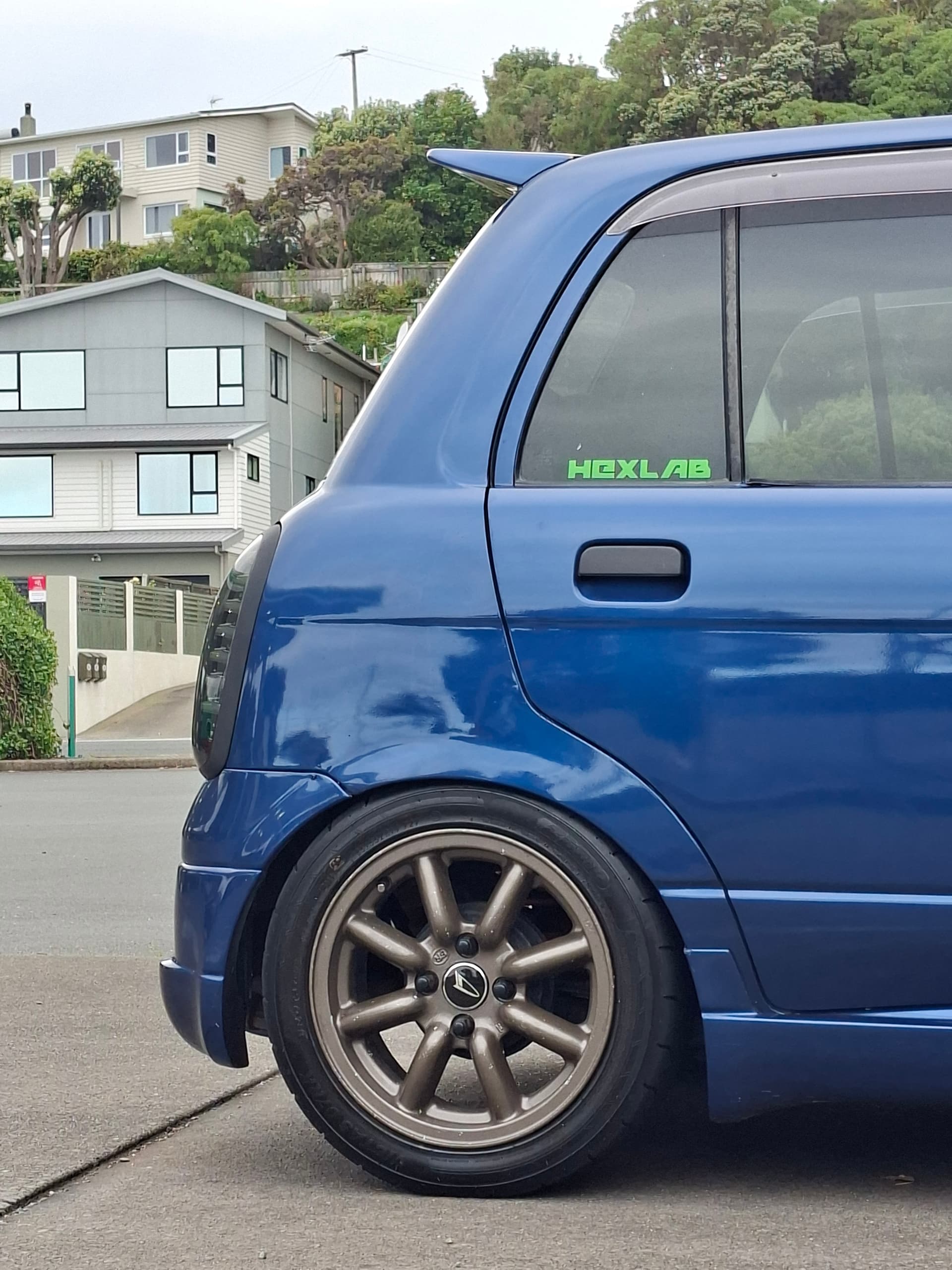

July 2024: Had an opportunity to buy some YMR sideskirts, didn’t turn that away as I’m always pretty keen on finding rare parts to add to the car. Painted them up myself and chucked them on, like the look alot.

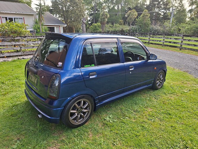

August 2024: Added a rubber lip to the front to match the height of the sideskirts. And found an oem fog light switch out of a terios. So finally got the fog lights all wired up and working and looking proper.
And thats pretty much the final look, happy as with how it is!

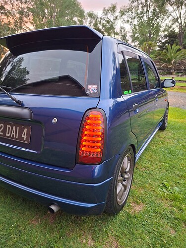

Dec 2025: Another year has gone by since the last one, so how about another update on this! The Miras had a full respray now. Lowered the front some more using a combination of the move shocks and l700 lowering springs, Zestino semi slicks in 165/55 14 and a YMR rear bumper to match the sideskirts. Looking fresh!
