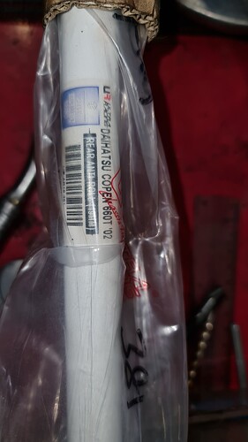

We have also received the upper and lower rear top bars, the lower anti roll bar that was on the rally/Copen and the front stabiliser bar.
We are now searching gor the brackets for the rear sway bar.
