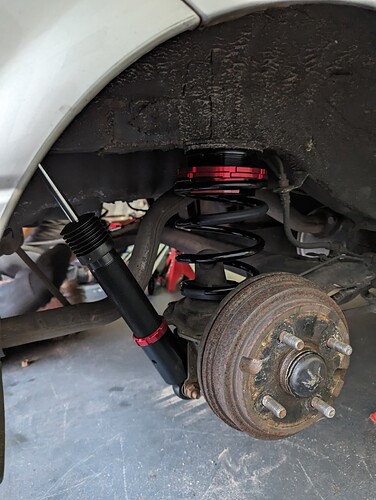

I’ve been driving around on lowering springs on the stock struts for a while now since one of my top mount links broke on the selfmade set. Those coils were pretty good for the price but overall it wasn’t the best. Beside that I had no way to lower or adjust the rear.
I did what I said I didn’t want to do. Buy a set of BC Racing coilovers. Why? I was done with trying all these make-shift options and getting mediocre results. The set was more expensive than the car, but oh well. It’s not like I can still make the “cheap car excuse” after what I’ve done to it :eyes:
(I should do something about that brake cover yikes)
Overall the quality seems to be really good. Better than expected if I’m honest. I like the colours as well, pretty.
They were easy to install with some friends and do a few test fits before we tighten everything down. I put mine 3cm above the minimum setting, so I still have some play. But I think the height looks good now.
As for the driving experience; wow. Cornering is just amazing. What a go-kart.
The rear is a tad stiff right now so I’ll have to adjust that a bit and see what I like. It’s set halfway but the rear is super light so no wonder. The front is on the full stiffness setting. Love it. I’ll have to get used to it for a bit and test it out. I’m still holding back as I’m not able to predict the car well just yet.

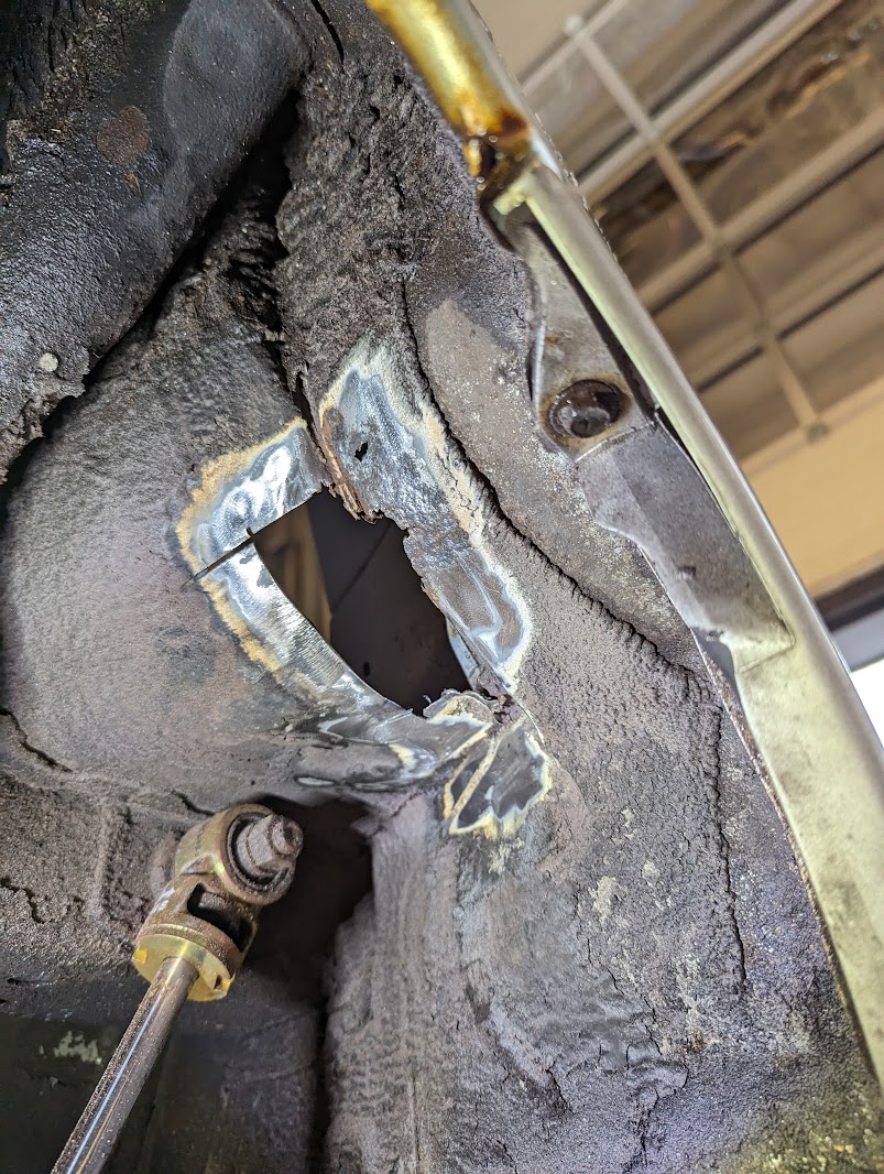

This weekend a friend helped me weld up the last couple of spots!
Protected everything after. I’m going to take some time to redo some of the undercoating in those places later. there’s still some work to do to make the inside pretty, but it’s good enough for now.
At least there’s no puddle of water in the back of the Cuore after I drive in the rain!

[quote=“marc0tjevp, post:90, topic:6067”]…I’m going to take some time to redo some of the undercoating…[/quote]My experience with undercoating is that it retains moisture within the carriage. Especially, at seams where one piece of sheetmetal is welded to another. At these joints, it’s not rainwater which enters. But rather, condensating moisture produced by surrounding air cooling down overnight from within. I have simply melted off undercoating at these joints and will avoid driving my vehicle through salted roads in winter
